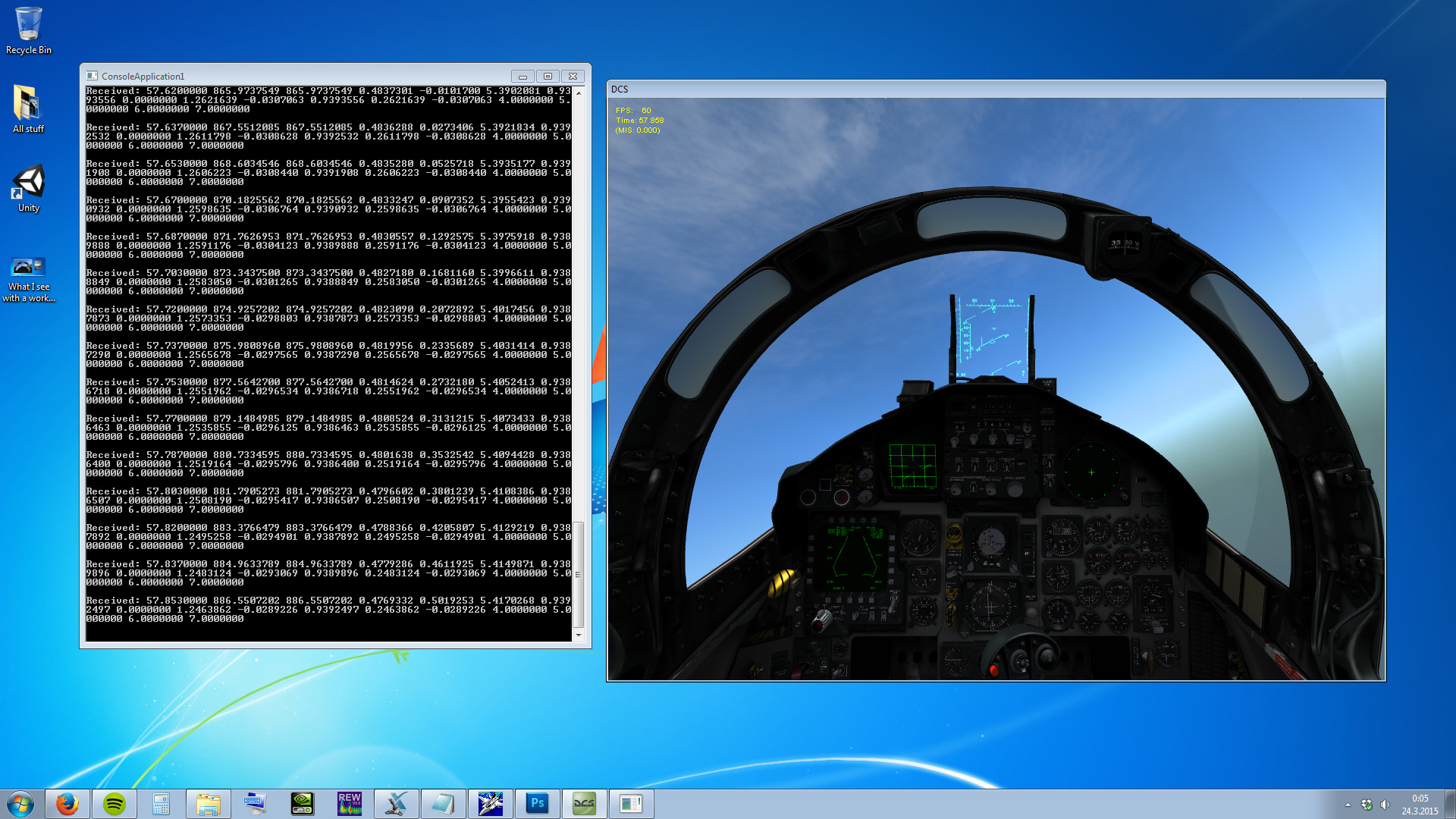

Postby laurivs » Tue 24. Mar 2015, 00:02
This is what I see.

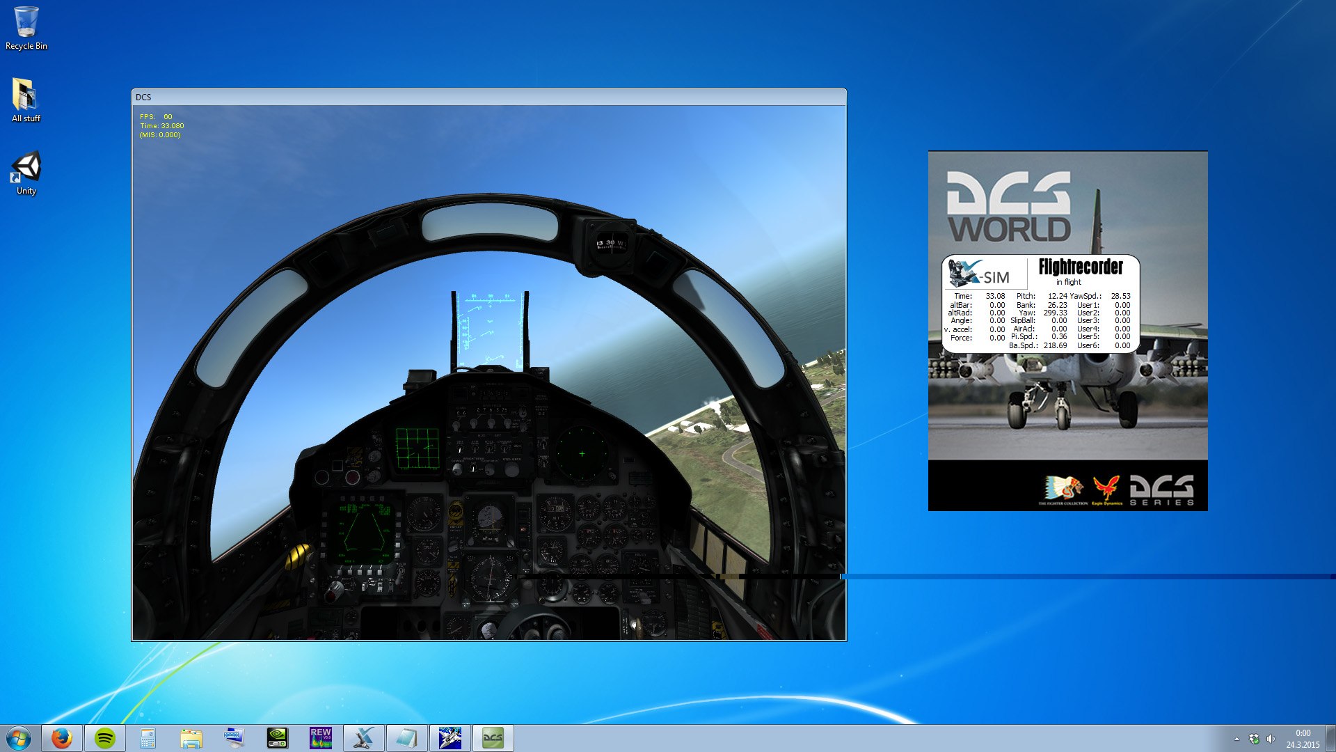

Postby laurivs » Tue 24. Mar 2015, 00:09
At least the raw values from export.lua with 7 decimals seem ok.
With the current DCS plugin workaround I can't see all of them in the plugin window(see my previous post), maybe you can?
