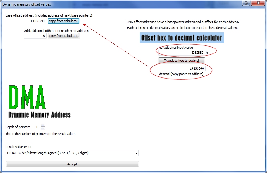

Second difference: No memory offset, now it is a dynamic pointer.
The tutorial shows how to get the exact address of the values that are shown in the nolimits 1 overlay. In nolimits 2 you have also the overlay with pressing the button F2. However this address change if you restart the game or computer. So there is a memory address where the dynamic value is stored. This tutorial give you the found values of nolimits 2.0.2.2 and the demo (two different offsets).
The good thing is: the offsets of the memory locations are the same in demo and fullversion and should be the same in upcoming versions. So you need only the First memory location where the new address is stored and enter this values in all three values. You can also use the here downloadable memory driver setup .csd as setup help.

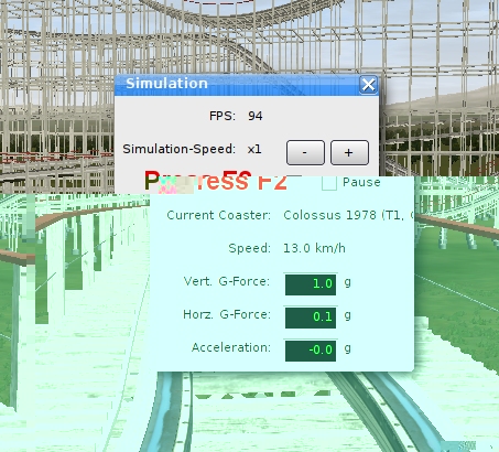

Now you are attached to the memory of nolimts2. You now have to open with F2 the nolimits motion data dialog box.
You see there a vertical G-Force. This is the earth G-Force and will stay 1.0 in normal start position. We use this value because it does change very good for searching with cheat engine.
Hint: Remember to remove the 1G with an offset math plugin in the math setup of X-Sim Converter application to get real vertical G-Force change.

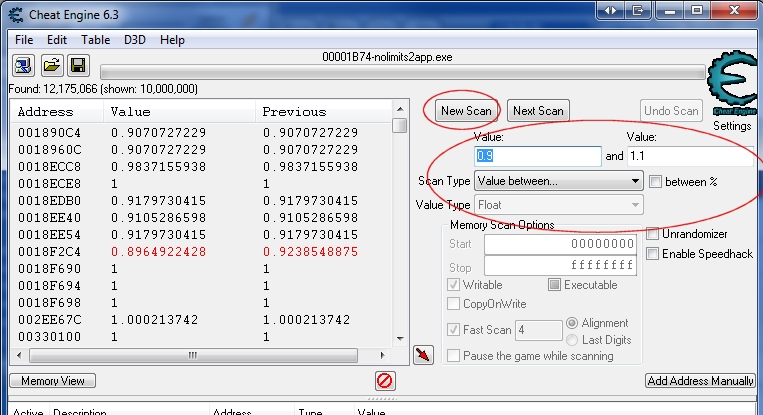

Ok, now press P for pause and start a new value scan in the cheat engine. Depending on what number you see in the vertiacl box, you must enter a range of that float value to find it. If there is 1G you search all float values from 0.9 to 1.1 in the game memory.

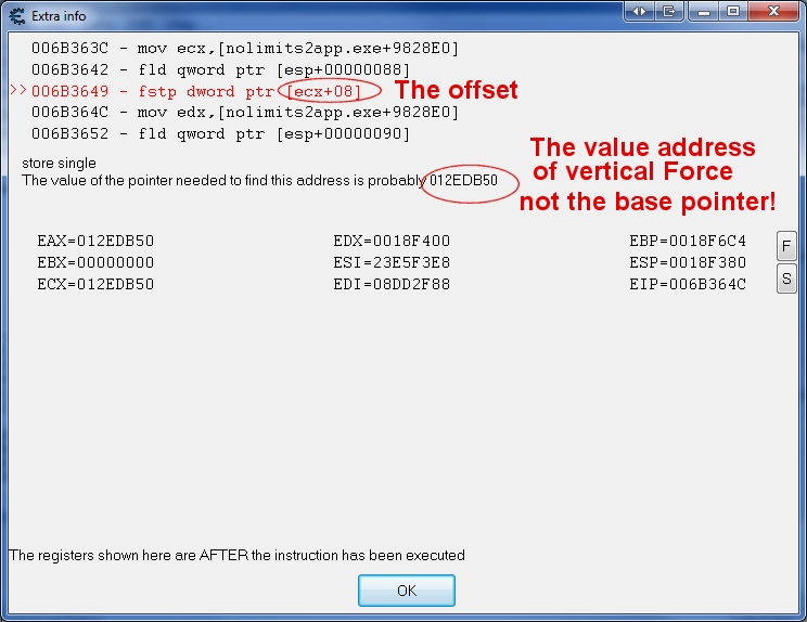

Ok, first step done, you will see the results in the left listbox. They are much. So unpause the simulation and run the coaster until the 1G change big to over 2. Do not use values lover zero, the cheat engine has a bug here. Pause the simulation again. Now we have for example 3.1G. Insert the next scan from 3.0 to 3.2 (or your values) and press the next button. The listbox do now get less values. Do this until you see the end of the values in the box. Then run the simulation and look if one of the values do make sense to the box. It is only one value that is left and make sense. Rightclick it add it to the addresslist on the bottom. Now righclick this value in the bottom listbox and select the menu entry "Find out what accesses this address. You get a box with different other pointer accessing this found value. Choose the ECX access in the list. The offset +08 is already in your memory driver sample file but write it down if changed.
Ok, now select the ECX entry and select more infos. You will get now a box and you must write down the red marked offset value and the pointer address. This is not the base pointer but we can now search for the base pointer with this value.

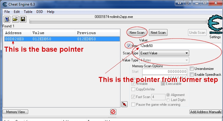

Close the dialogs until you get back to the cheat engine main dialog and make a new search with your found pointer address. Setup the search as you see in the below screenshot.
Now search the memory for that exact 4 byte value, which is a simple memory address, and you get exact one result. This is your base pointer and this is the value you have to change in the X-Sim memory driver to get NoLimits2 running with a higher version than 2.0.2.2 or a lower version of it. Change all three. If the offset does not fit, change it. But normally this offsets stay the same. Do not forget to move (dragndrop) the entries on the right top listbox to the lower listbox. Else the values are not sended to the converter application.
