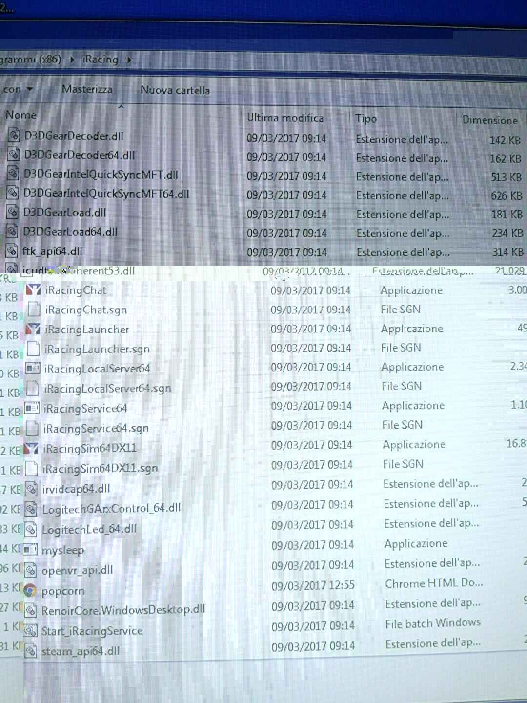

After last update 2017 season 2, x-sim can not find the program launch, with this updated 32-bit and DirectX 9 versions of the iRacing software are officially removed, now it supports DirectX11 and 64bit only, I have no idea how to change xsim to give the launch command .

Program is the final executable and parameter is launcher:mylauncher.exe

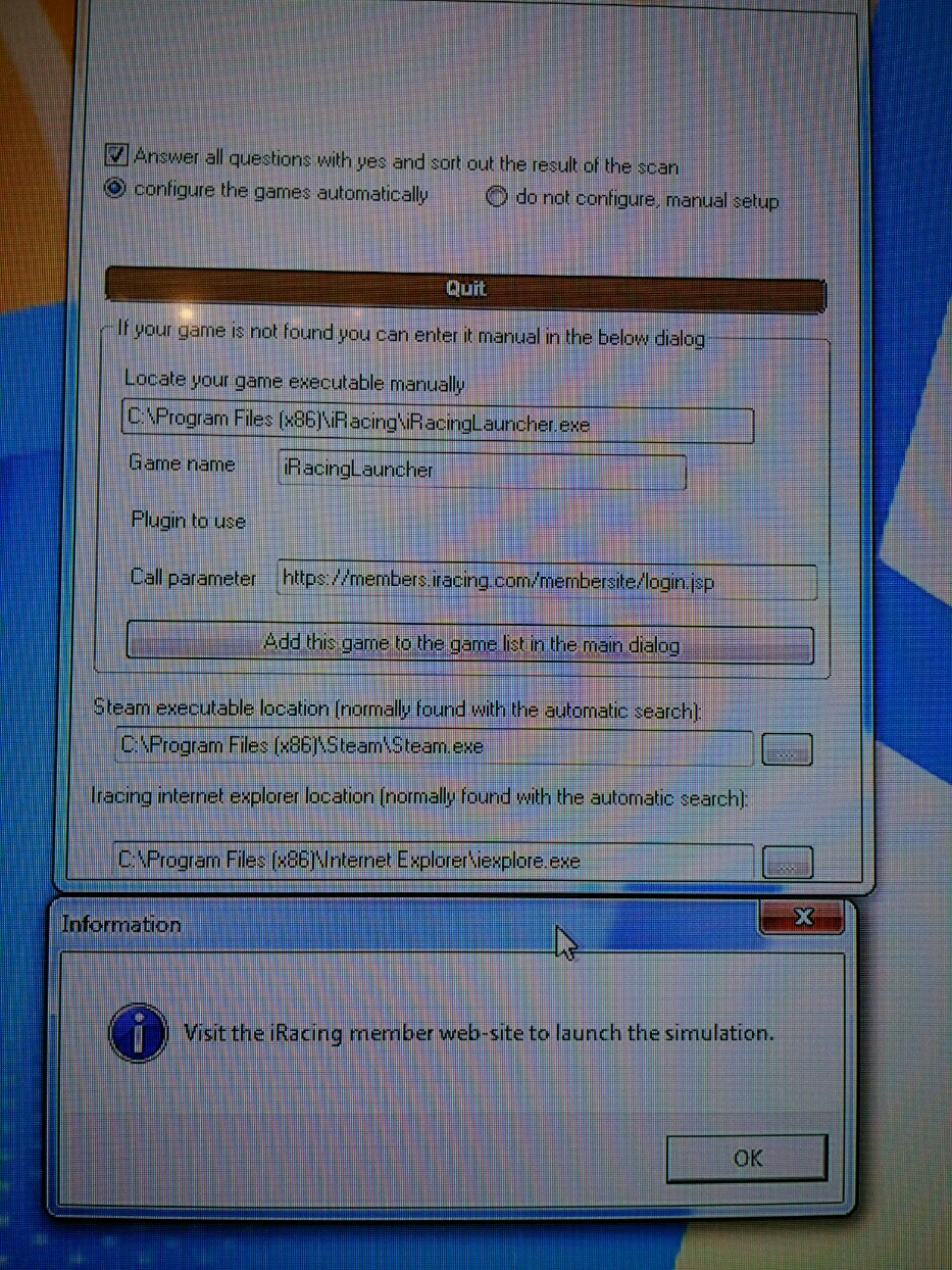

the game now works with new executable but I get error as photos before take me directly to the log in page does not work automatically search
enter these values, press play game and then open your browser from iRacing
do not press ok on the play game window extractor should remain no gray blue
we await update
thank you
il gioco ora funziona con nuovo eseguibile ma ottengo errore come foto prima mi portava direttamente alla pagina del log in, non funziona ricerca automatica
inserite questi valori, premete play game e poi aprite dal vostro browser iracing
non premete ok sulla finestra play game in extractor deve rimanere grigi non blu
attendiamo aggiornamento
grazie

Postby sirnoname » Sun 12. Mar 2017, 13:57
No Update needed.
You can write, try and share a autosetup file for this?
old is:
Code: Select all
// X-Sim 3 game configuration script
title: iRacing startup exchange
games: iRacing
startup_file: iexplore
game_executable: iRacingSim.exe
game_parameter: http://members.iracing.com/membersite
new maybe (you must decide which browser etc. ...):
Code: Select all
games: iRacing
startup_file: iRacingLauncher.exe
game_executable: iRacing.exe
game_parameter: launcher:c:\programs\firefox\firefox.exe
The manual is there: http://www.x-sim.de/documents/Howto-gam ... cripts.txt
-> game_executable is the process running if iracing is started, I do not think the iRacingLauncher is the main program.
The play game button stay grey as long this executable is found in process list in the task manager.
-> launcher: maybe a link.

Sigue sin funcionar.... he probado unas cuantas cosas y nada... os dejo lo ultimo que he probado
games: iRacing
game_executable: iRacingsim64dx11.exe
game_parameter: launcher:C:\Program Files (x86)\Internet Explorer\iexplore
