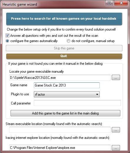

here a short FAQ for this game and how to setup this game in the beta phase. It is a rFactor mod, so there is a native X-Sim support without the need of a new release. It is a heuristic setup.
The problem here is a very often restarting game executable, so the extractor think it has stopped and disable the grey play button and stop sending (game stopped message). X-Sim can work around there in many different ways.
The best way is the usage of the motion driver auto detection.
Open the wizard and insert the game parameters:
Insure the rFactor plugin is selected.
Now copy the rFactor plugin from:
C:\Program Files\X-Sim\Plugin\wizard_scripts
with name: xsimplugin.dll
to your GSC plugin folder.
Now select on the right side the Game Stock Car game and answer two times with yes. This will auto choose the rfactor plugin in the motion driver.
Now press the middle button "create a new profile from the right ..." and you get a profile in the middle for your game (maybe without converter setup).
Then you open the motion driver and insert this (you can write into the empty boxes):

Tested - and it works very good! Thx for the easy solution :!:
