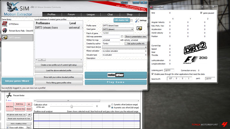

ok after downloading 11gb of dirt again and let xsim do everything still no data... In outsim game paused is always marked. And listenport is 20778. I don't know what i'm doing wrong.

Also tried to change to 20777. Registry clean was made at new xsim installation.
I think i am missing something. I settet up the Converter like in the Bassshaker Thread with Freq an Vol Axis. Loaded this profile in the executer. There i take the codemasters Plugin and run the game. Did i make something wrong?
I just see when i open Converter there is no own ip showing. Firewall is settet up for xsim.

Your pass trough is enabled for some unknown reason. This is not default.
It sends on the same port.
After a change you must restart.
It is not possible to exchange plugins. You have to take the one that comes with X-Sim.

thanks for your help again. Is just marked the box out restarted and it worked. I thought i have to enable this because it was enabled at default. Outsim shows the values but i think they are not sendet to the converter because there the values will not change.

it is a brand new install of x-sim and it was enabled by default just showed in the picture above with the wrong port :shock:
