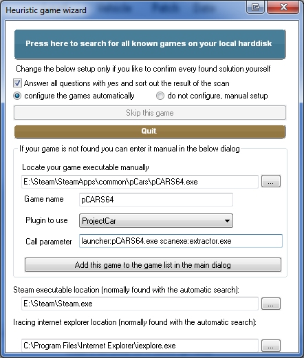

Example open game wizard and added this manually:
Plugin V5
64 bit
55% CPU Load in practice, I use 1280x1024 windowed mode. (sorry I do not have a highend PC)
56% running without x-sim.
Bad thing, you have to close the extractor after the game has finished ;)

as I already the game I can"t modify the fields as you did in the screenshoot .Do I make a new search with manual setup checked ?

Postby sirnoname » Tue 18. Aug 2015, 00:00
Example with steam 64 bit start:
56% CPU load.
Same with close detection, you have to close the extractor.
Re: projectCARS
Postby sirnoname » Tue 18. Aug 2015, 00:02
No, simple open Game wizard and press advanced, select game with ... and fill the rest. Press add, thats it. You can have multiple entries. Dont use the existing one (from autodetect) and do not try to edit the existing one.
ps. I did exchange the notepad workaround with the extractor exe. If using notepad you can control of course the program close detection.
You may use steam.exe and close after a game steam to get back the blue button if you like.
With 32 bit you can add the pCars.exe file and it will be detected. Only a 64 bit program exe cannot be found from a 32 bit X-Sim. However I think about a scanwindow parameter to solve this as the scanexe parameter is at the moment.
