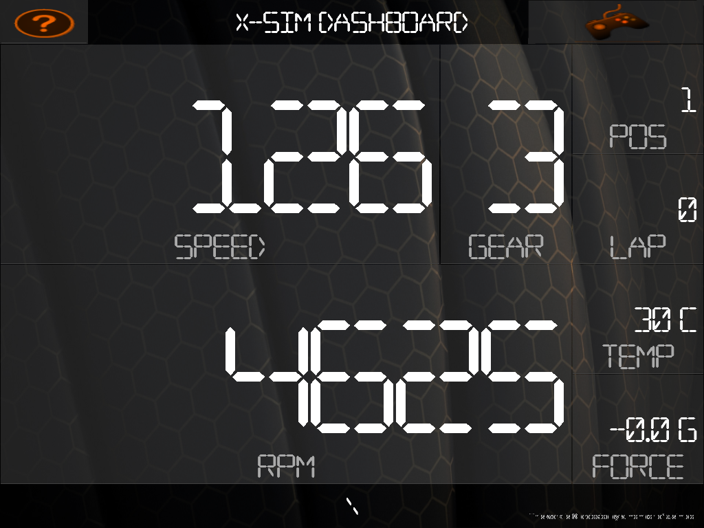

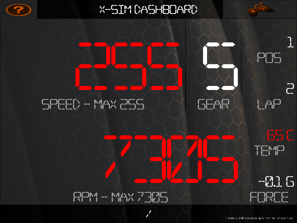

Postby thaparser » Sun 5. Jan 2014, 18:25
played around a bit and came up with this https://www.dropbox.com/sh/dfa6iuri3x7v ... IAGK/x-sim
it is a dashboard app for iOS (if you have it jailbroken). works as expected with race07 and should work the same with games that provide telemetry info: gear, speed, rpm, temperature, etc.
to use it, configure the Extractor network cluster with the IP address of your device, start the xSimGauges app and tap the game controller icon (top right). after that, if it receives any data, a small dial center bottom should 'spin' 2425. it auto-adjusts max values and changes colors to red when close to max values for speed, rpm and temperature 2424.
enjoy!
