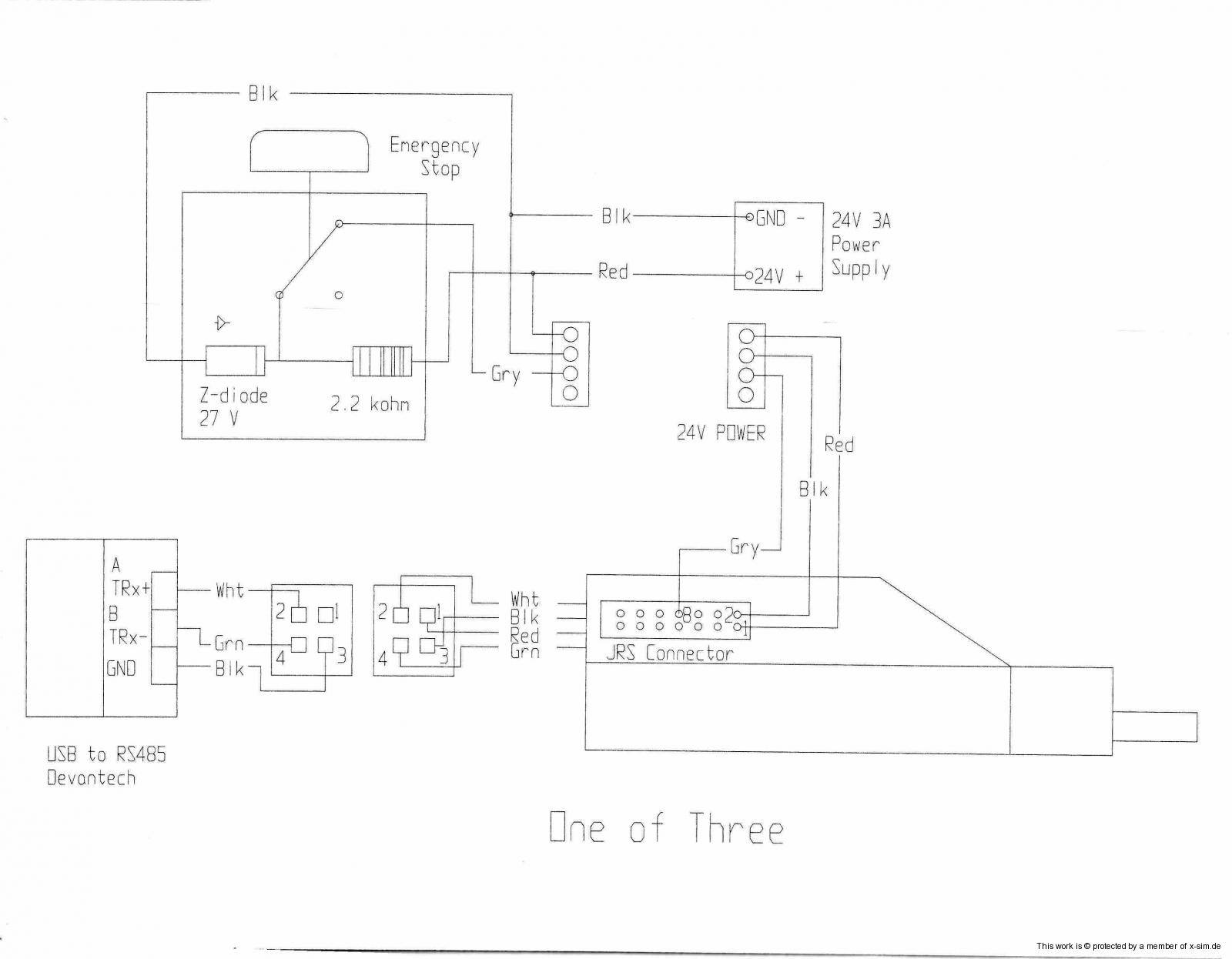

This will not work, not the rs485 part and not the ilk part.
RS485 are two wires, the ilk will get pull up (all three) and switched to GND in activation case.

Thank you sirnoname,
I am including here a revised version of the wiring diagram, and I hole I got it right *
The SCN5’s I have are serial numbers A2000882 F +G (PNP) and A2000883 F +G (PNP).
The wiring id configured as (four pin terminal connected to SCN5):
1 . RED
2- WHITE
3. BLACK
4. GREEN
The JRS terminal was modified and only pins 1, 2 and 8 are wired. The harness to the JRS was shrink wrapped and only wires red, black, and grey are connected to a four terminal connector.
1. RED
2. BLACK
8. GREY

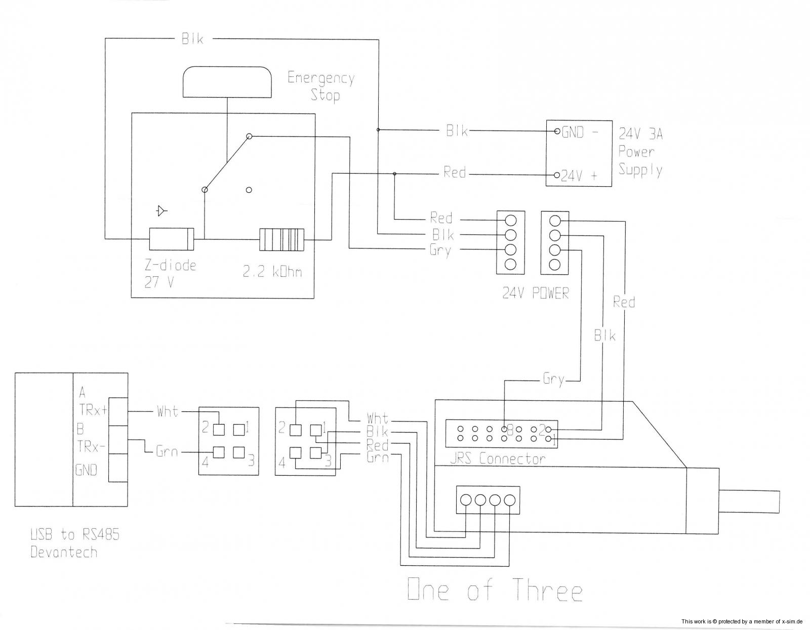

As written, you do need 2 wires for RS485, no GND.
The switch has do pull down the 24V from ILK to GND.

Thank you again for your prompt answer and patience. I did the correction, eliminating the ground from the RS485. Hopefully this will be right *
What power should the 27V zener be? There are several options, and if possible, I would like to select the correct wattage.
