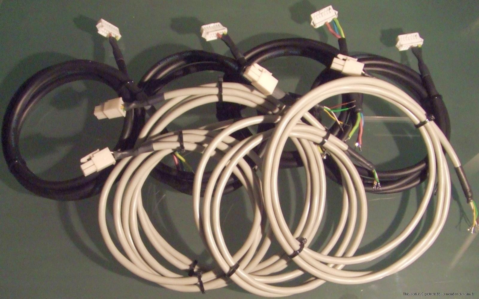

can someone help me with the plugs for the scn5 actuators. the plugs from mirai are exaggerated expensive! i know that ich can use for the powercabel a 1,5mm² cable and for the datacable a null-modemcable, lan or rs232. but in this case i would have to cut the plug. that is plan b.
i search for the plugs for the scn5 cables.
i an old fred from * scn5-scn6-hardware-thread this guy got this kind of plugs. did anyone got this plugs and make this cables. did anyone know were i can get that stuff?
thx
best regards
seppel
seppel

Re: SCN5 / SCN6 Hardware Thread
Postby sniegavirs » Thu 18. Apr 2013, 22:51
Maybe you could show some picture with the plug you need!? That would explain your needs more precise.

Postby seppel » Fri 19. Apr 2013, 11:50
here the pic from the * forum
1426
thats the cables for the scn5 actuator.
