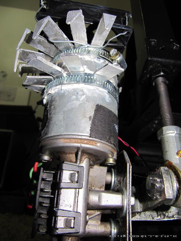

I made this heatsink and it works very fine.
1215
regards!
