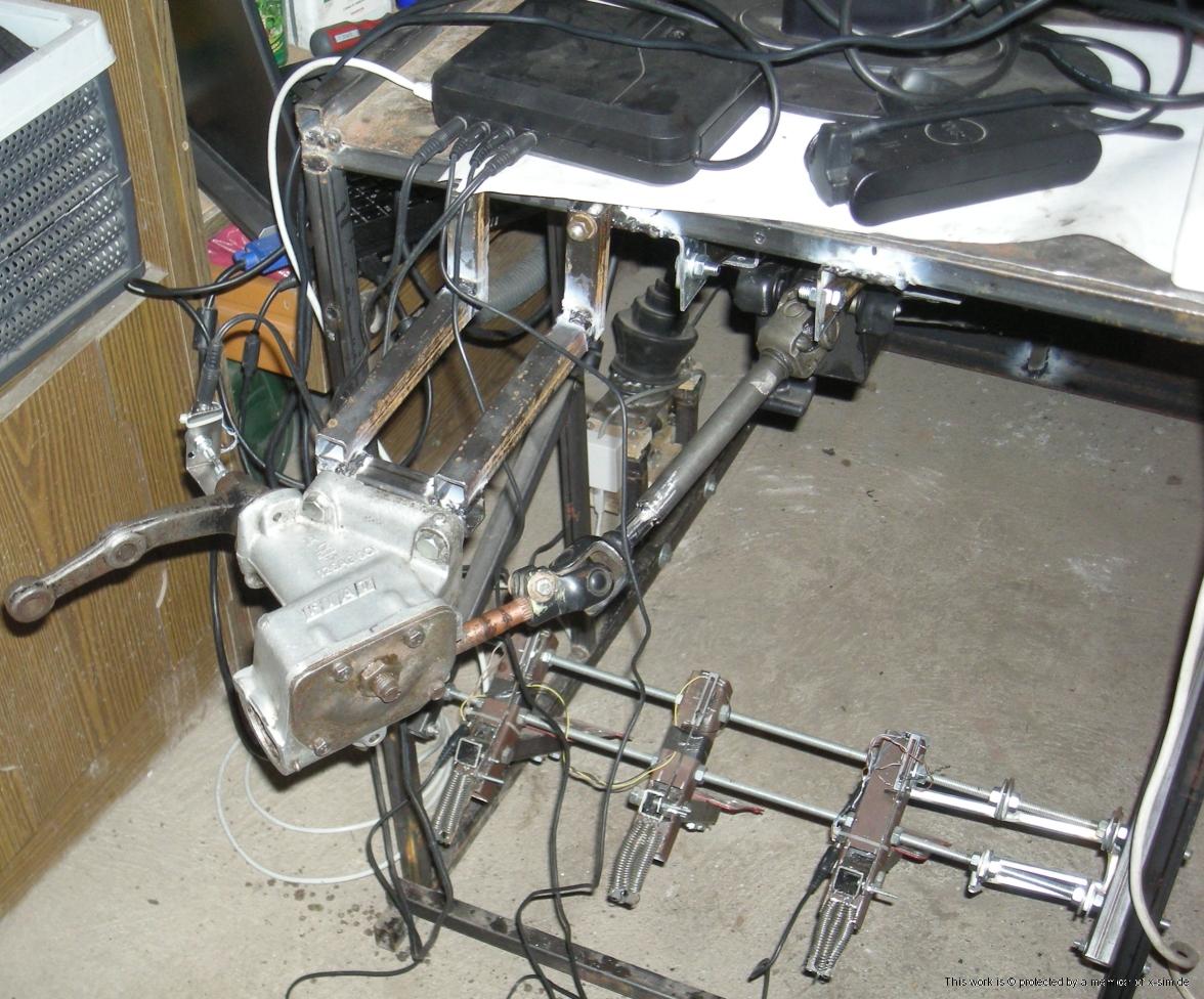

Please see below the cockpit without the seat. The wheel is from VW, gearshift is Skoda, handbrake is from Lada and the pedals are DIY.

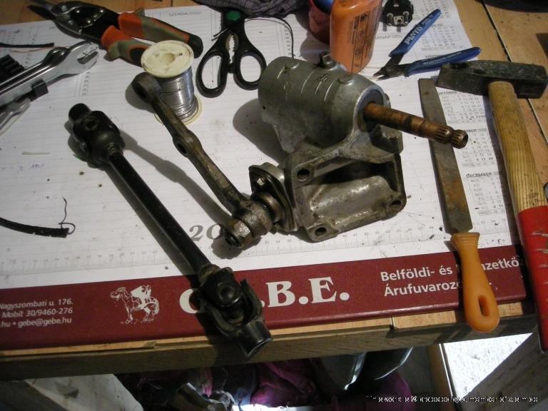

Please see below details of the wheel. The wheel is connected into the wheel drive (polski fiat) with a wheel rod just like in any car. The pot turns by the wheel drive.

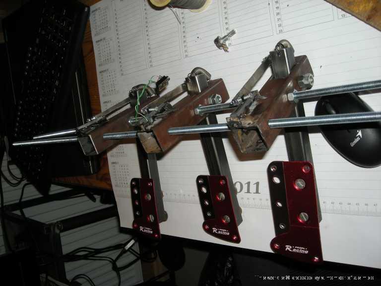

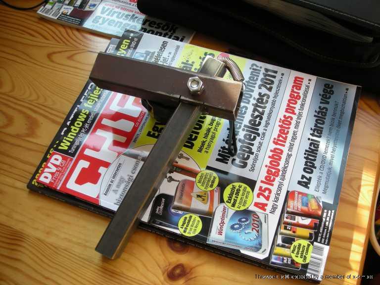

Please see below the details of the pedals. The pedals are made by me. There are slide pots sampling the pedal movement.

And at least how it looks like together. The seat is from a BMW. Actually it's under construction for motion simulator with two wiper motors.

This wheel is the version 3. I always had the problem that I could not realy have a rod with bearings. Hence I needed to turn the wheel with caution. The first version of the wheel used a bicycle wheel hub, but went wrong when I asked someone to try it out. :D
The second version used a metric shaft or rod, with gears. Well that was pretty fine, but I wanted something more robust. So when I calculated the prices, the wheel drive at the junkyard was much cheaper than a selfmade rod with bearings and gears.
This is why I use it. And actually it has the same angle just like a car (more than 3 turns), however only a part I use due to the speed of the racing games.
It's quite heavy indeed, but I have enough metal to hold it. :D

Please see below some early stage images of the pedals.
578 580 579
The 4th pedal was a great help to my leg. It makes comfortable, to have a rest on it.
I do not totally understand your 2nd question. There's a handle on it which was used to connect to the car's wheeling system. There I have a turning, so I put there the pot.

i miss spelled my second question... i wanted to write "where did you got the plastic gears, that connects the wheel shaft to the potentiometer, i saw in your pictures that you have two plastic gears to transmit the spin of the shaft to the pots.

I've found the plastic gears in an empty laser toner cartridge. :D I used my pocket knife to free them out. ;) They were used in the wheel version 2, and now they are working in the handbrake.
