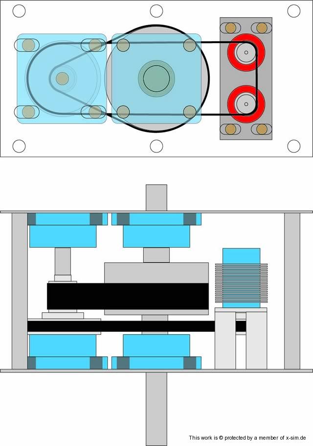

My DIY Force Feedback Steering Wheel is inspired by Fanatecs Elite Wheel.
Two RS-550 DC motors and of course beltdrive.

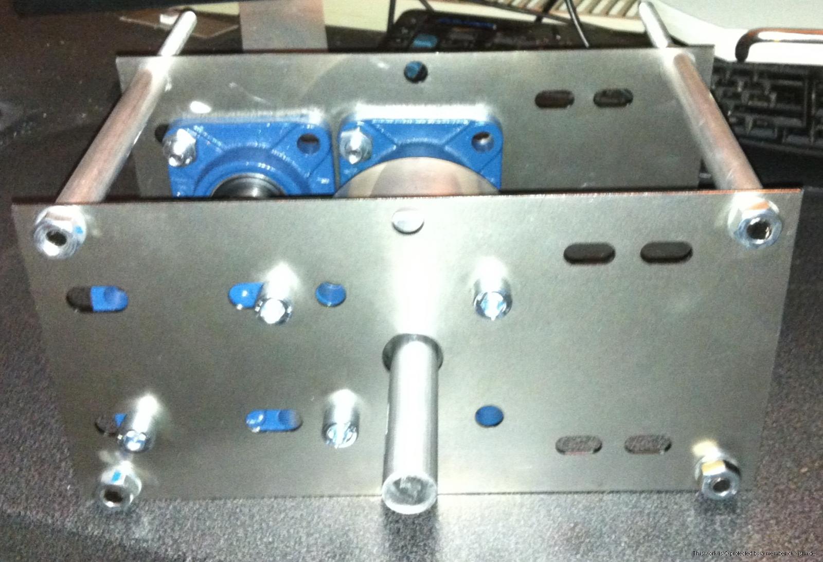

I recieved the first parts for my DIY Wheelbase.
2616
Front and backplate are HQ-Lasercut.

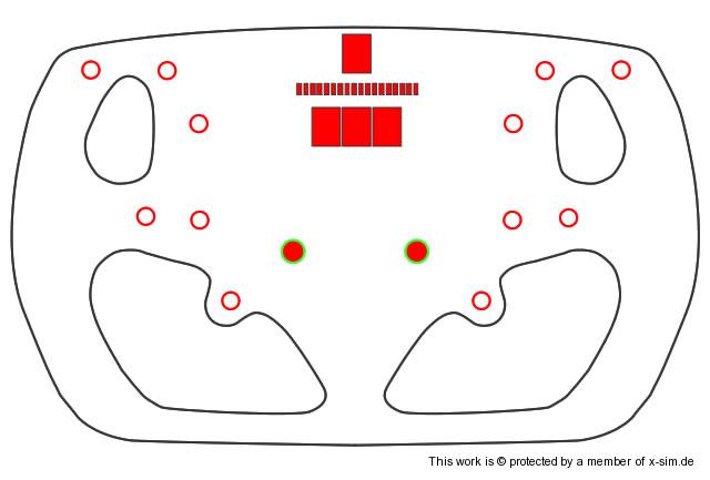

Design of my Formula-RIM
2615

Great! It looks very smart!
What is your estimated total cost?
Eager to see more
Mat
RacingMat
Posts: 456
Images: 147
Location: Marseille - FRANCE
Been thanked: 130 times
Re: DIY Steering Wheel Base
Postby dennisnojack » Sun 16. Mar 2014, 00:23
At this moment (like on image) round about 140 Euro (incl. BU0836-LC and Arduino Mega).
I still wait for the toothed belt pulleys (2 x 15 tooth, 1x 42 tooth, 1x 20 tooth = 25 Euro) to calculate the costs for the 2 belts (between 10 - 30 Euro per belt).
Two RS550 cost 15 Euro.
BTS7960 cost 16 Euros.
Hub for wheelhub 15 Euro.
The wheelhub for standard Steeringwheels 10 Euro.
I think 250 to 300 Euro....
Hope that i can test it next month...
