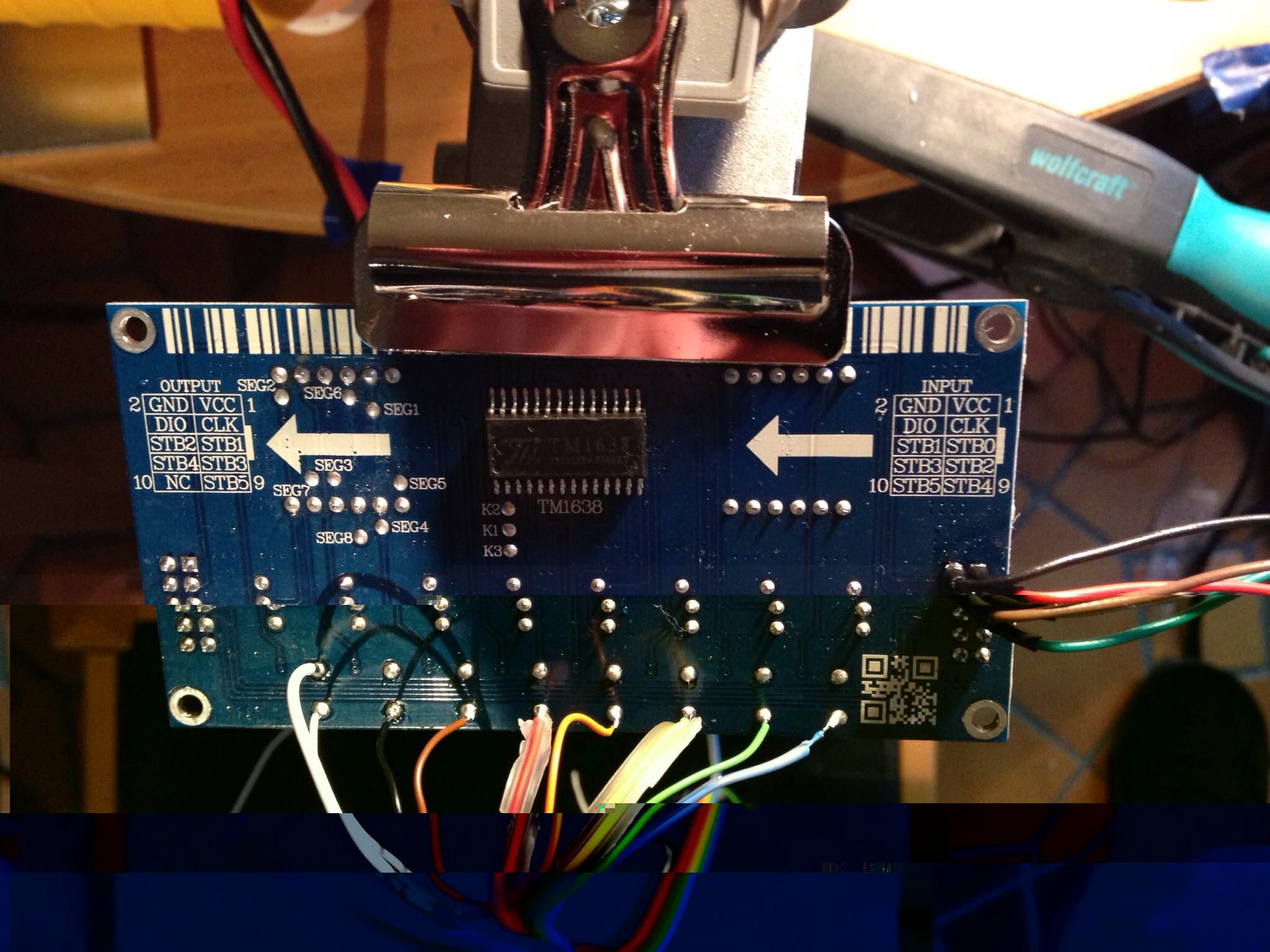

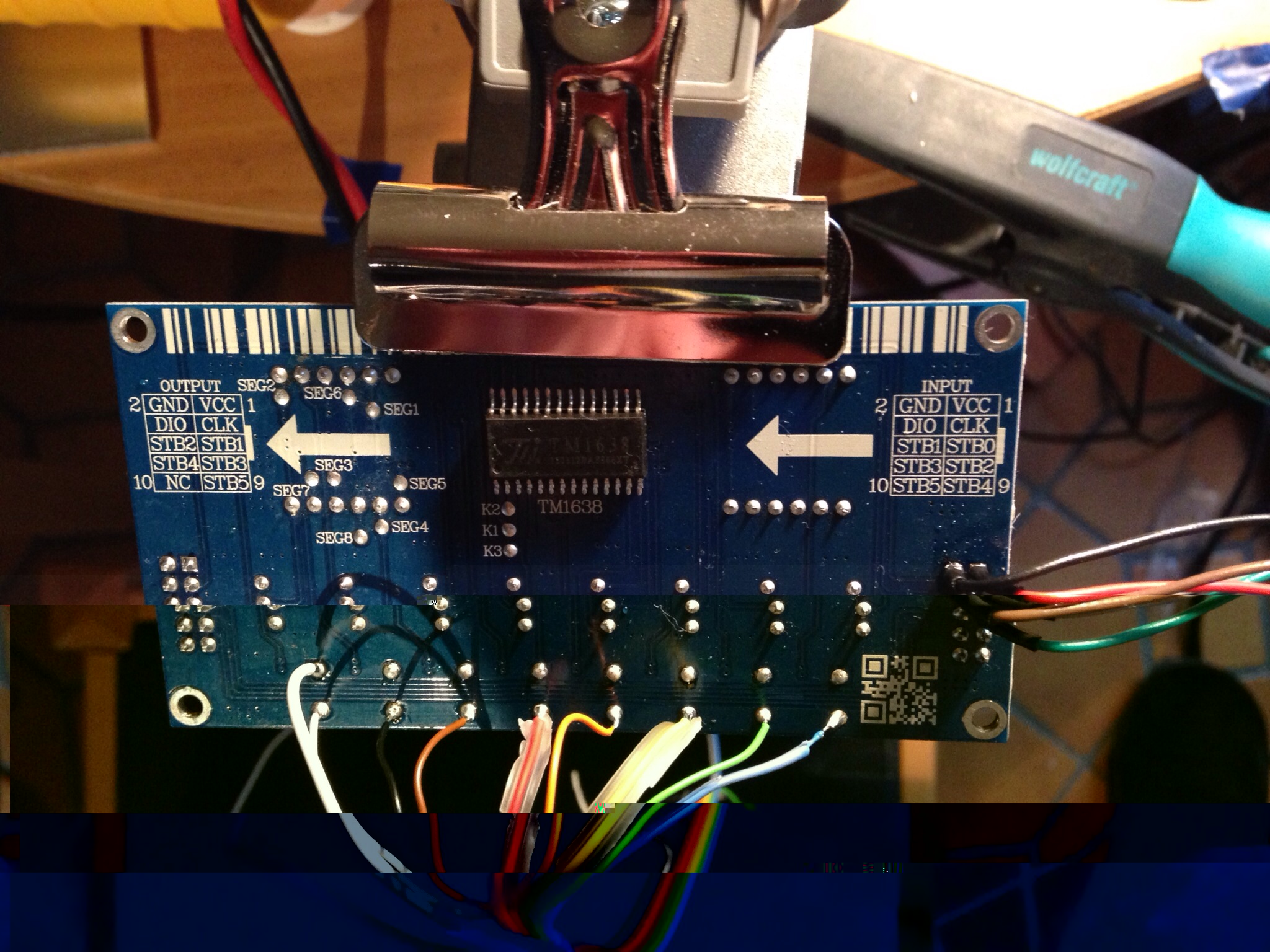

A little bit news from my dashboard.I fixed it on a aluminium plate.My goal is to make a aluminium cover and windows for digits and leds.
As Prodigy wrote I had to solder all the wiring behind the board (see photo attached) to achieve my further finishing.
Wiring

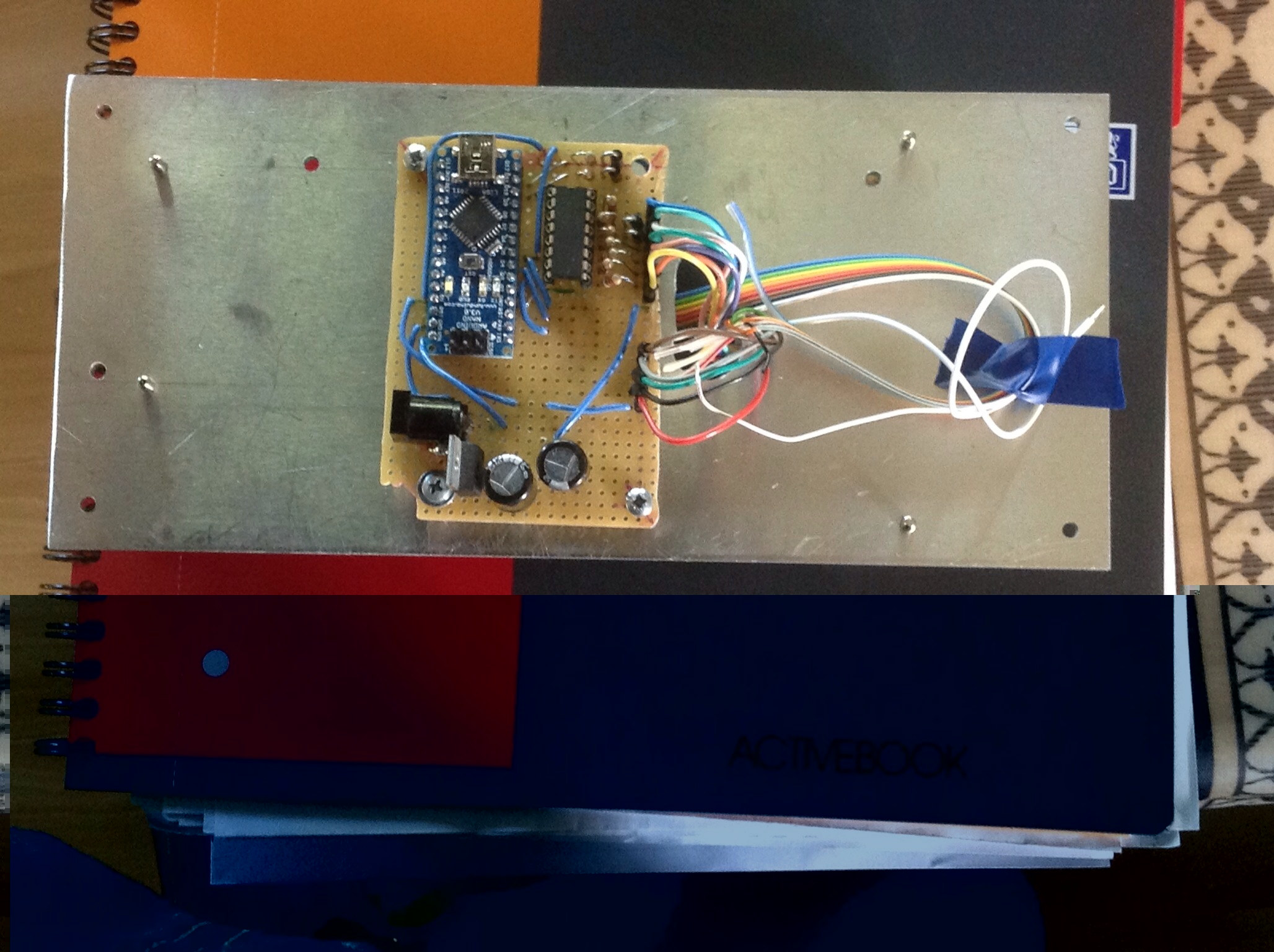

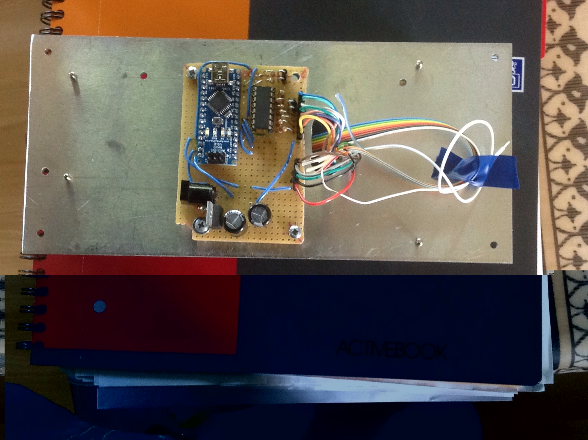

Edit 4/06:
I just add a picture from the back .You can watch the arduino nano and the decoder for the big digit.
Backside
