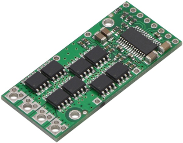

Postby vicpopo » Thu 26. Jul 2012, 18:22
tronicgr wrote:My h-bridge was designed for use with low power wiper motors, that's why I recommend in the fist page of the amc1.6 project that a better solution for other DC motors would be using the Pololu High Power Motor drivers that I verified them working well under higher loads up to 25A. If you take a closer look at them they are using almost the same technology like "Speedy's" design with double mosfets.
Thanos
Hi Thanos,
Did the pololu support high current peak ?I couldn't put a ampermeter already on the circuit , but when I look at what's happening unloaded ,I can suppose that in inversion direction in full load ,the current could be very high!
Regards

Re: Thanos AMC1.6 USB Motion Controller
Postby tronicgr » Thu 26. Jul 2012, 19:12
Hi Gilles,
The pololu site says: "The motor driver can tolerate peak currents in excess of 200 A, and the continuous rating is 25 A"
I had ammeter connected on my sim before, and the max current that was passing from the battery cable that was providing power for both wiper motors was averaging around 10A with 20A peaks.
Watch my old video where I had my DSMhb1.2 on my sim with me on it (90kg): http://www.youtube.com/watch?v=WVItAoPYUtI
Pay attention on the minute 1.30 that you can see the ammeter (the bottom gauge). Its range was up to 30A, never reached it.
Oh, and the temperature sensor on the mosfets... only 2 degrees over the room temperature!! 24 degrees Celsius.
