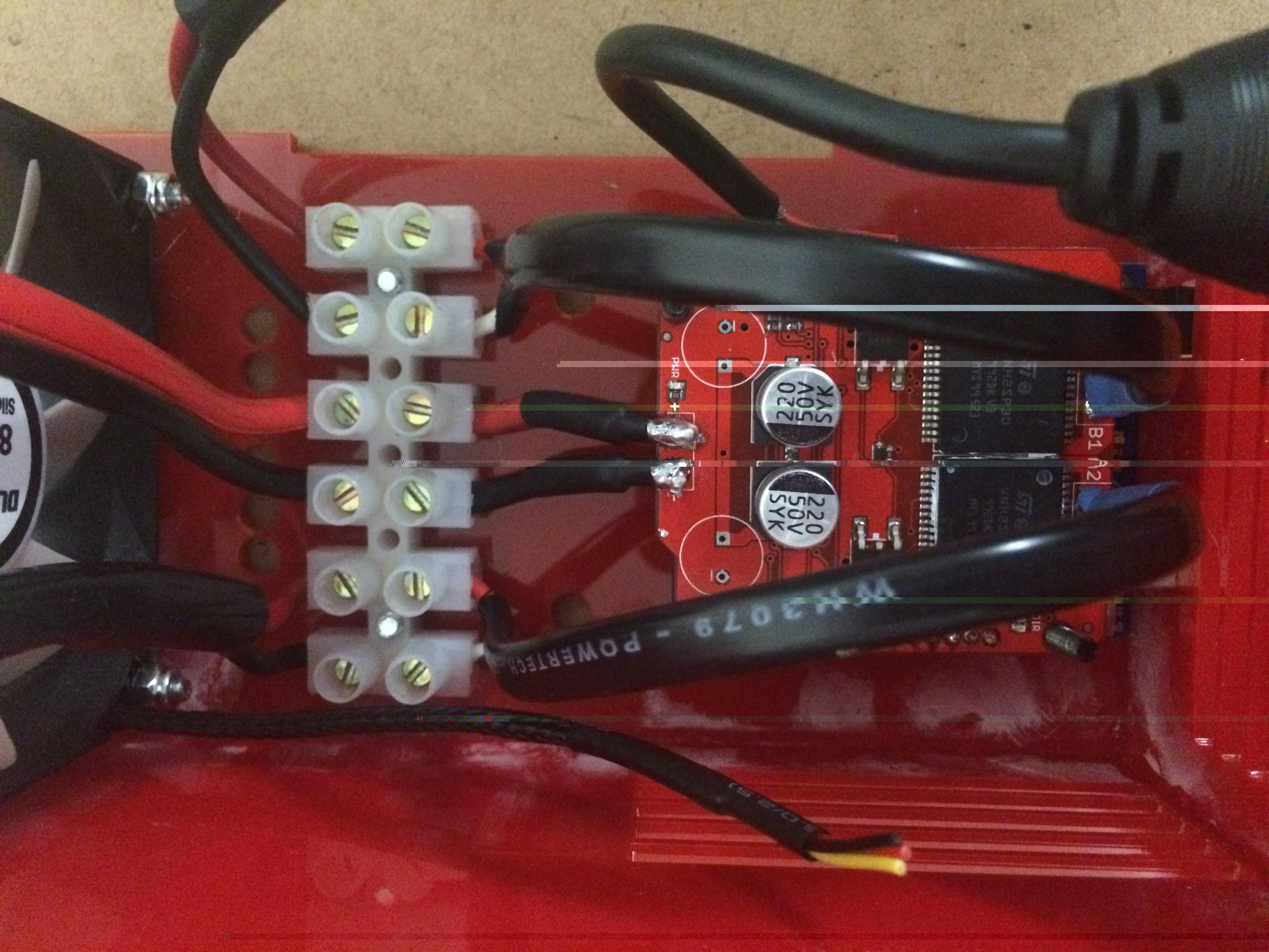

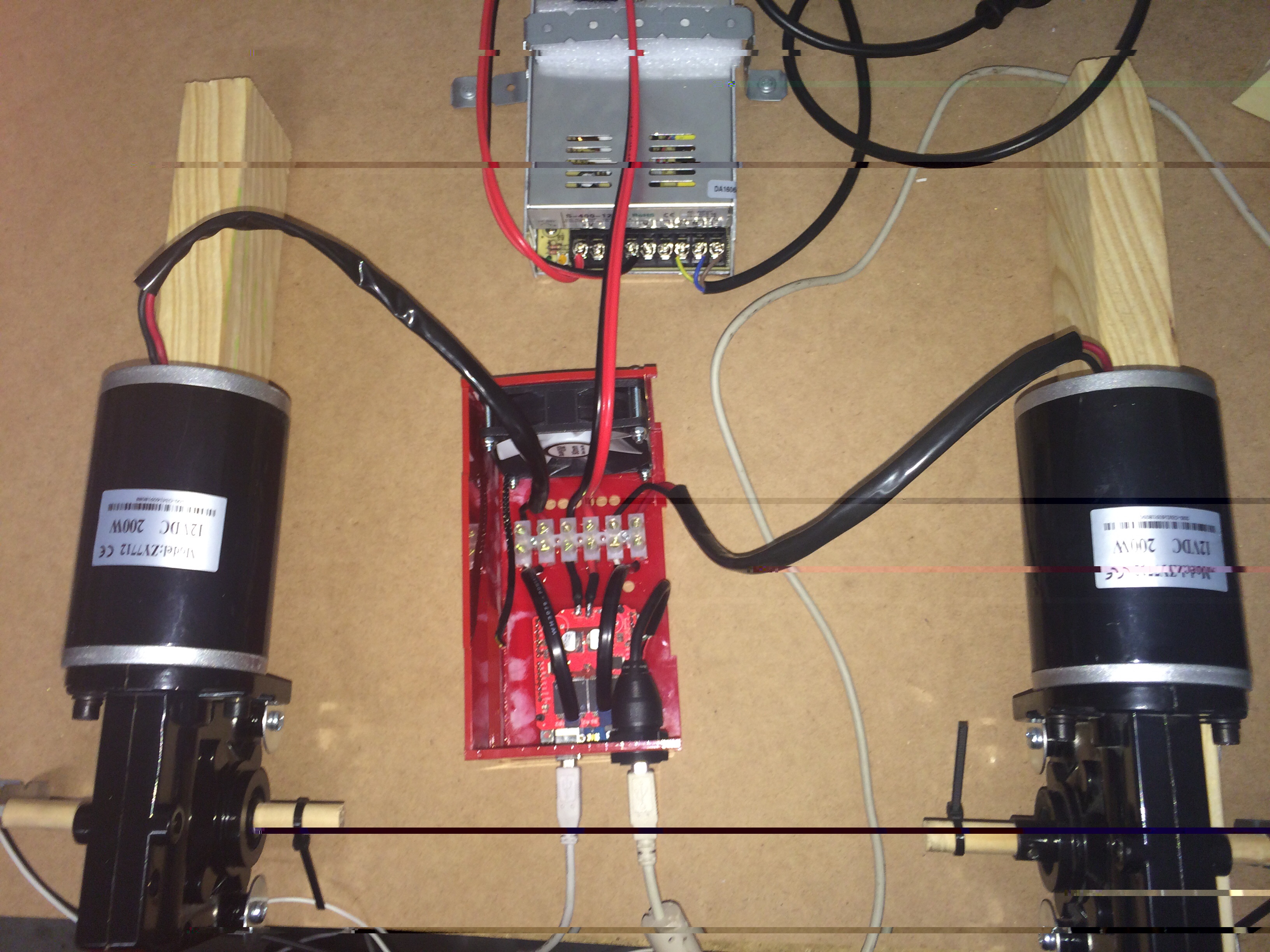

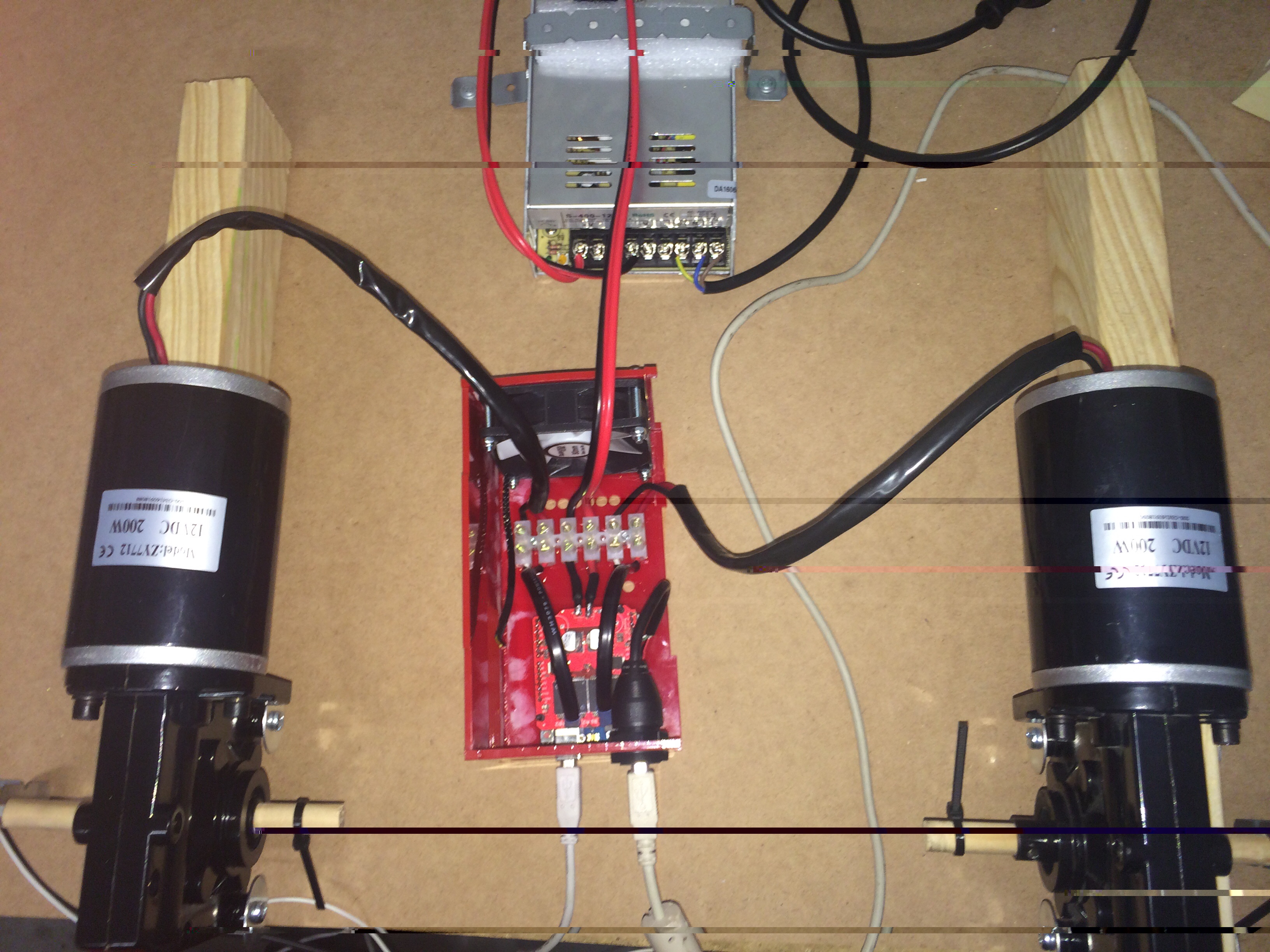

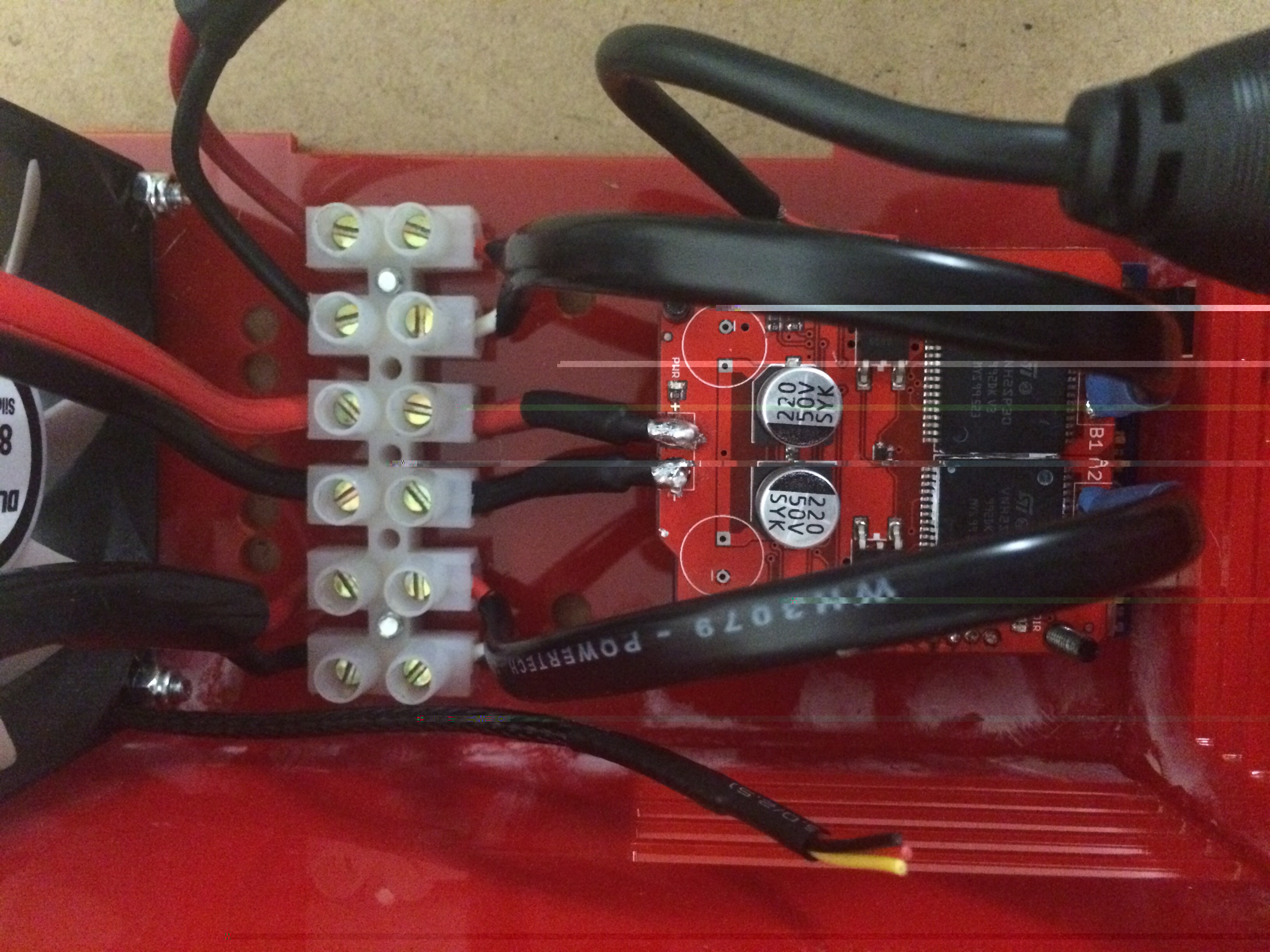

Re: Arduino Open Source X-PID firmware incl.360°option
Postby LinkRacer » Mon 31. Oct 2016, 12:08
You can see left right motors and wiring
Power supply wiring in the centre
I don't see how the wiring is wrong

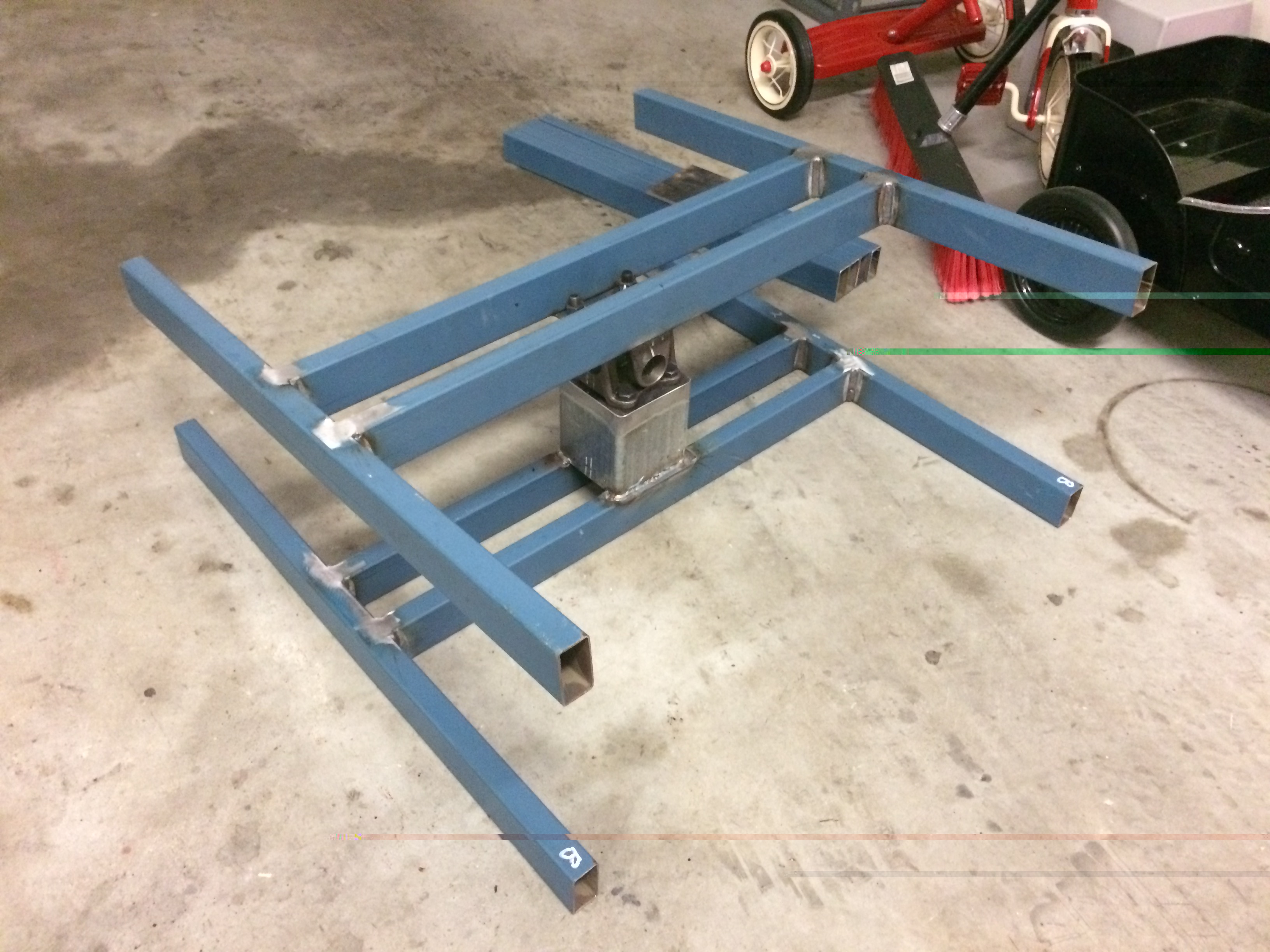

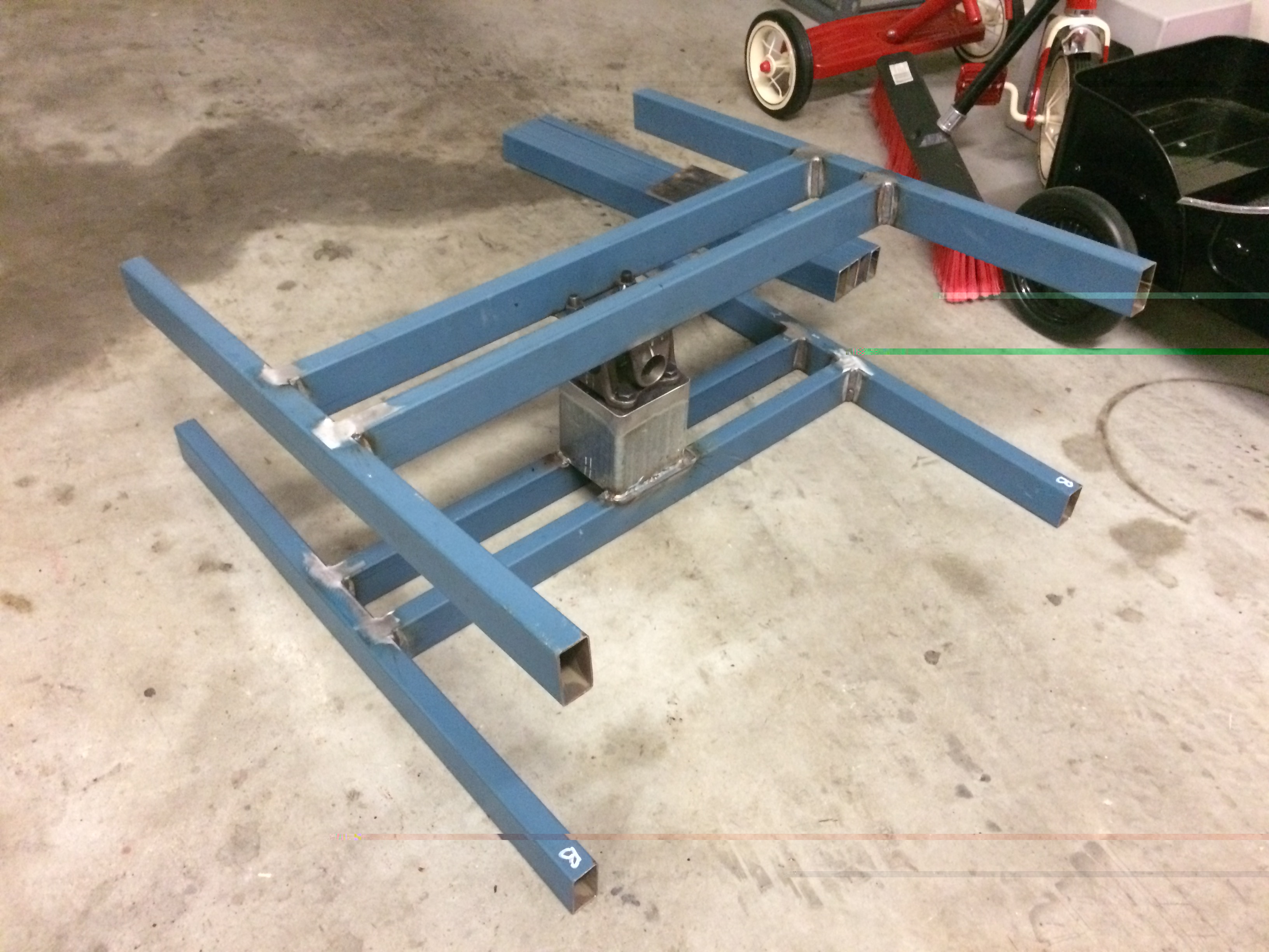

Since my last post I tuned the xpid settings and it works great, just need to finish my steel motion platform to test it properly.
