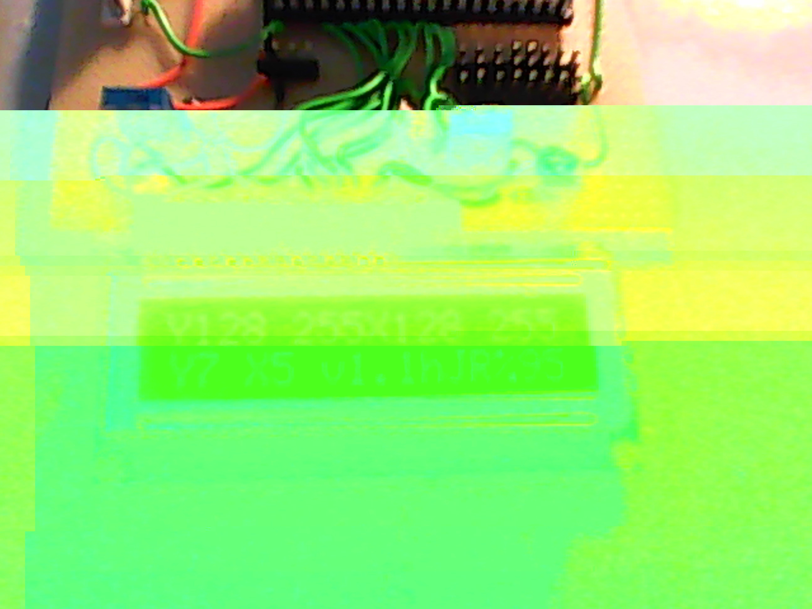

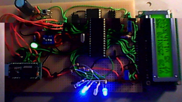

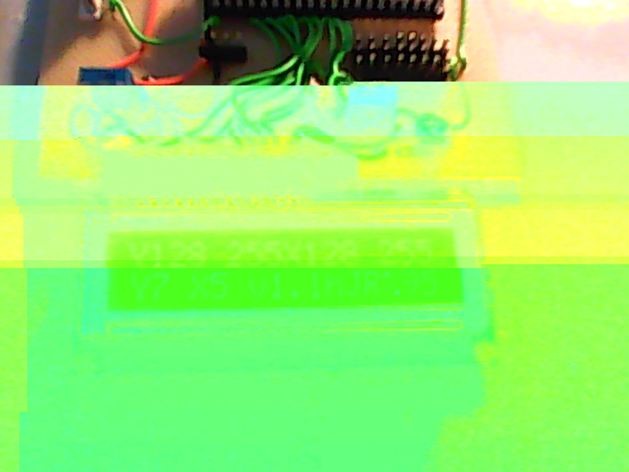

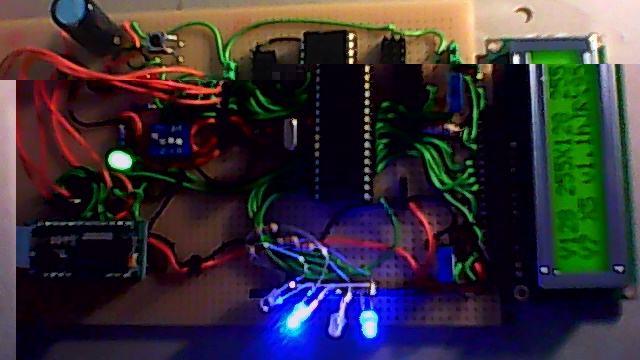

Hello all,
my AMC 1.6 works for 2 Days , now it maks some Problems :
1) with and without Pots the Position from the Xand Y-Achses goest to the max ?
With every Firmware :(
Witch Problem is this i can flash the AMC 1.6 and all Axes goes to max ; what make it wrong ?
Please help me, i found any answer
Thanks for each help !!! :)
ps: sorry for the bad qualy
gears
Christian
TheXRacer
Posts: 56
Images: 9
Joined: Sun 27. Jan 2013, 20:33
Location: Germany
Has thanked: 5 times
Re: Thanos AMC1.6 USB Motion Controller
Postby TheXRacer » Sun 12. May 2013, 14:20
Oh, my AMC 1.6 Works
My Atmega 644 was not correct in his socket :lol:
