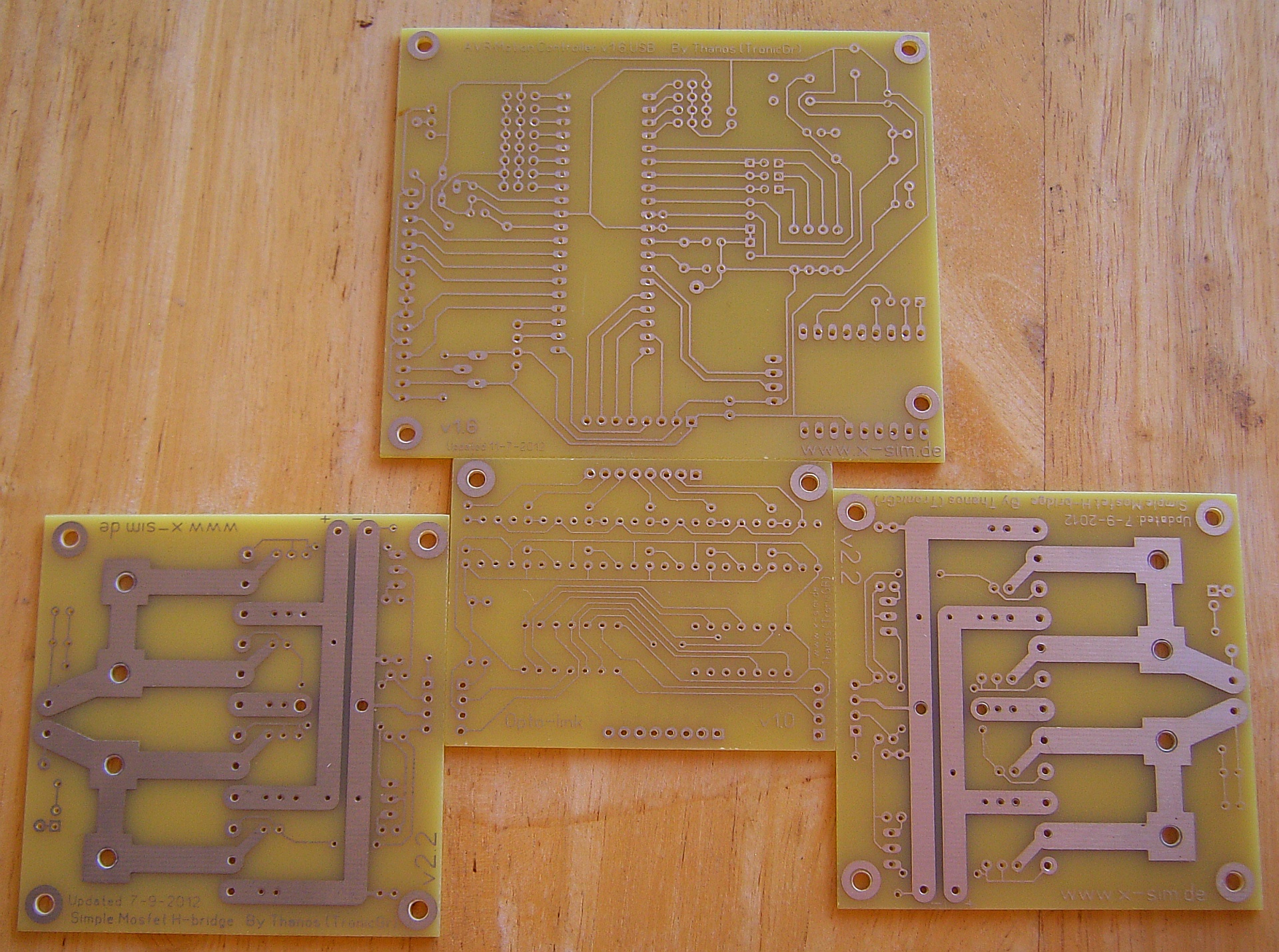

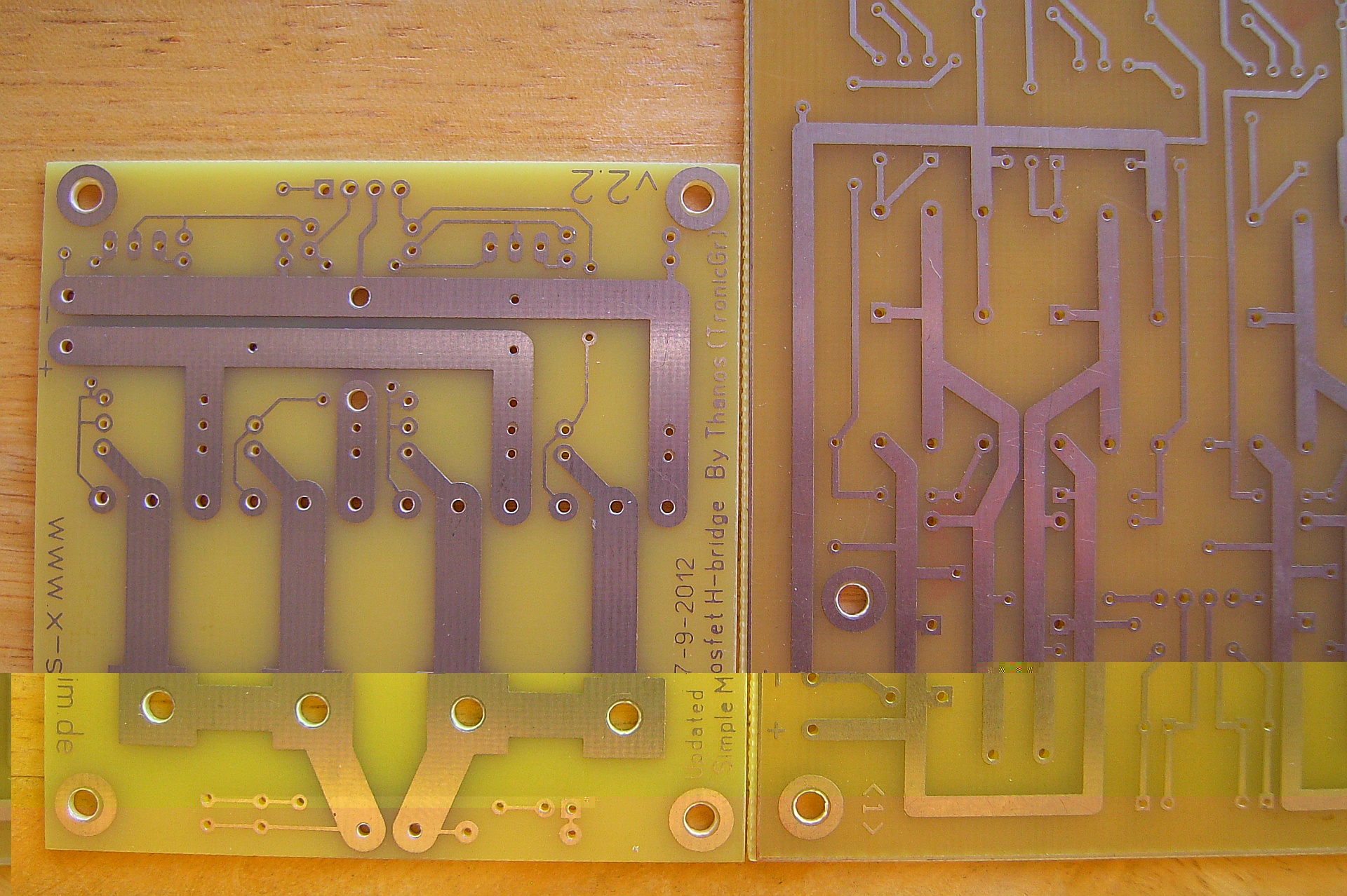

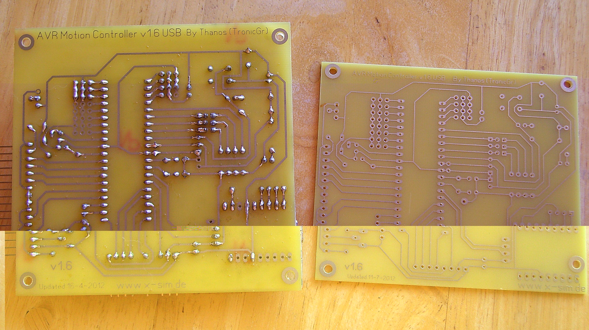

Today I received from Gilles (France) the two-layer boards of AMC1.6, Optolink and SMh-bridge2.2 I mentioned in older posts. I'll try to have them ready soon to test them all and try to make a little assembly guide for them as I do it. I hope I have enough parts left for all this.
The new AMC1.6 board is a little smaller, more compact connector for the PWM and directions, less wasted space.
I made the power tracks as large as I could for the SMhb2.2. See it next to the old DSMhb1.2. These thick tracks are rated 14A and even more if they get reinforced with extra solder.
Thanos

Well done on the pcb :D
Thats some groovy tracks there!
