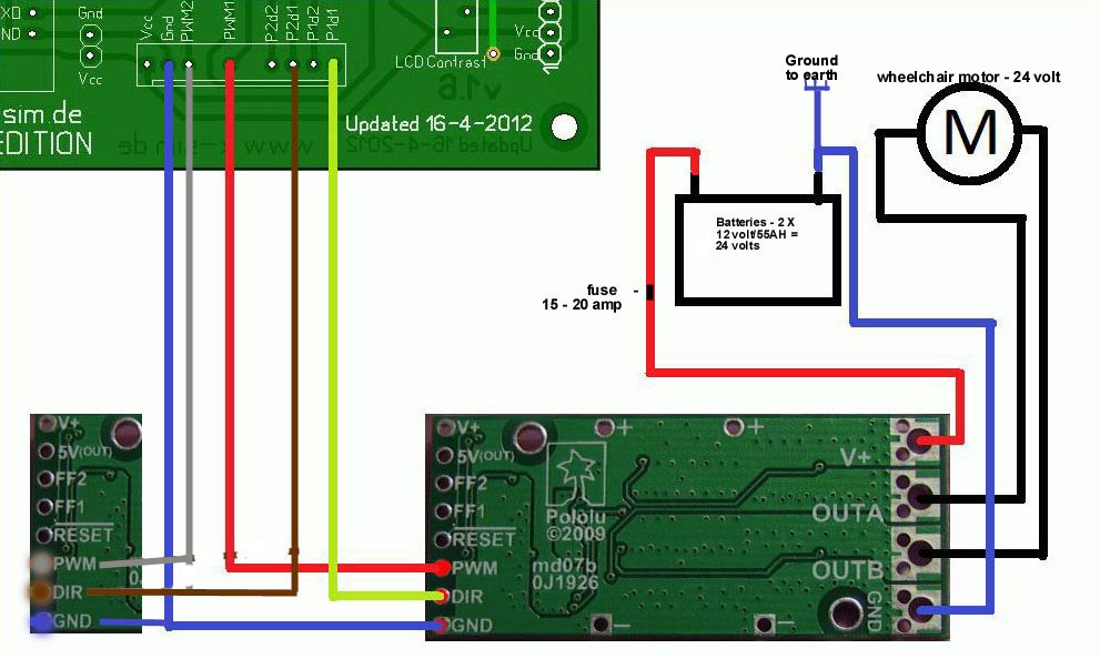

It's very strange. Please show me the wiring(connection) diagram between AMC and motor driver.

Ale, the second attachment is for you! The ground to earth was added after the latest blow up!

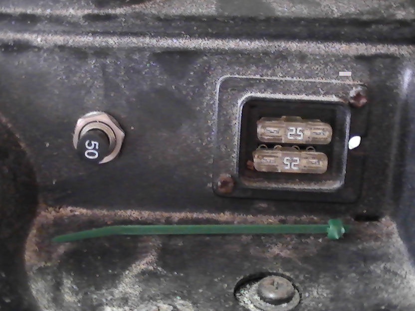

I don't know the amperage rating but the wheelchair had two fuses rated @ 25 amps and a circuit breaker rated at 50 amps. I don’t know if fuses are split between the right and left sides. Or, maybe one goes to the onboard charger. See attachment

fuses on wheelchair
The ground to earth was added after the blow up

Connecting diagram is right. But I can't see where is "power switch". You wrote
If I flip the switch to the simulator first, then I hear a pop,
Can you build diagram with all power supplies and switches? How you power your AMC board?

IF, the motors are well under the operating Amp limits of the boards you are using, then you would need to try diagnosing deeper into other possibilities.
Hope this helps bring you closer to solving your board melting issues.

Postby prilad » Wed 7. Aug 2013, 12:10
Hi guys.
I think this problem may be solved by placing two pull-down resistors ( from 1K to 10K, one for every PWM lines) between PWM line and GND.
This will hold the line PWM at a low ("zero") level until the end of the microcontroller initialization.
And I want to ask jsmith2307 - how many PWM inputs has your Pololu? Two (PWML and PWMH) or one (PWM)?

Postby jsmith2307 » Wed 7. Aug 2013, 16:00
Greetings, :D
Ale, I've got both PMWH and PWML. I only use PMWH.
On the heat bridge side or the avr 1.6 or both?
crs2012,
Find out what your amp draw from motors are.
THEN
you can determine what motor controller you would need
THEN
make sure you have the motor controller configured correctly for the motors you are using ( using the board's software or hardware PINS )
THEN
continue on with the PID settings once everything is stable.
I'll do this!
