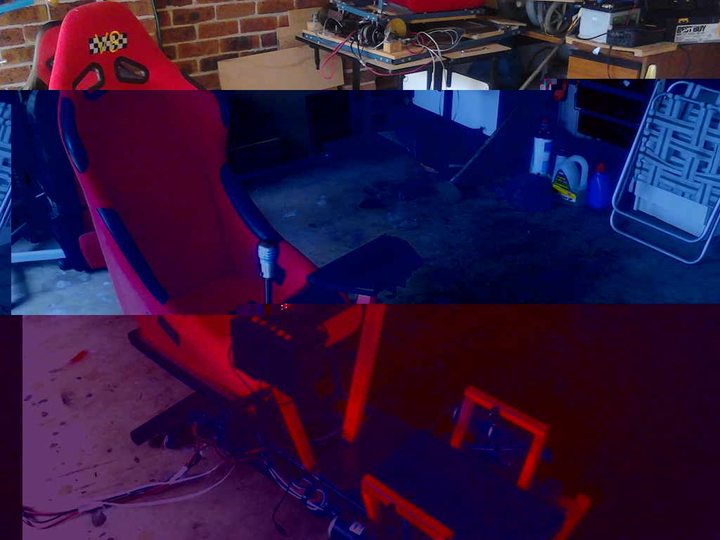

Hello, I get about 70mm total movement up and down actually. But depending on where you mount the motors, at the head , you get more movement.
Now with a sim, it needs to be on a balance point and not supporting the whole thing on the motors.
With the motors at 650mm forward of centre point and spaced at 450mm ( too narrow) on my big foot mount motor sim, I found the lateral HUGE and longitudinal short and sharp, but nothing a good profile fiddle couldnt sort.
I had a bloke on it 6'6" at 140 kg and it moved him with ease.
The motors do get hot if you run them at full power in the Pololu JRK http://www.pololu.com/catalog/product/1393 I ran them at 34 amps continuous and 40 amps peak.
http://www.youtube.com/watch?v=zwHcnh6vdrA a 110kg , but under 6' driver buddy.
motors near my knees on a previous frame http://www.youtube.com/watch?v=ZbN8XF027lc more movement at head height.
I now run them at about 3/5 power and they still kick hard, but the motors only get warm.
Bobbuilt has the same motors, yet to be mounted to a sim , with 120mm ctgc levers ( i think) and he is astounded at how fast they move.
On a seat mover and or full frame mounted at the shoulders, they would be pure nasty!
I mount mine lower as I needed to build a shorter length sim.
Hope that helps.
