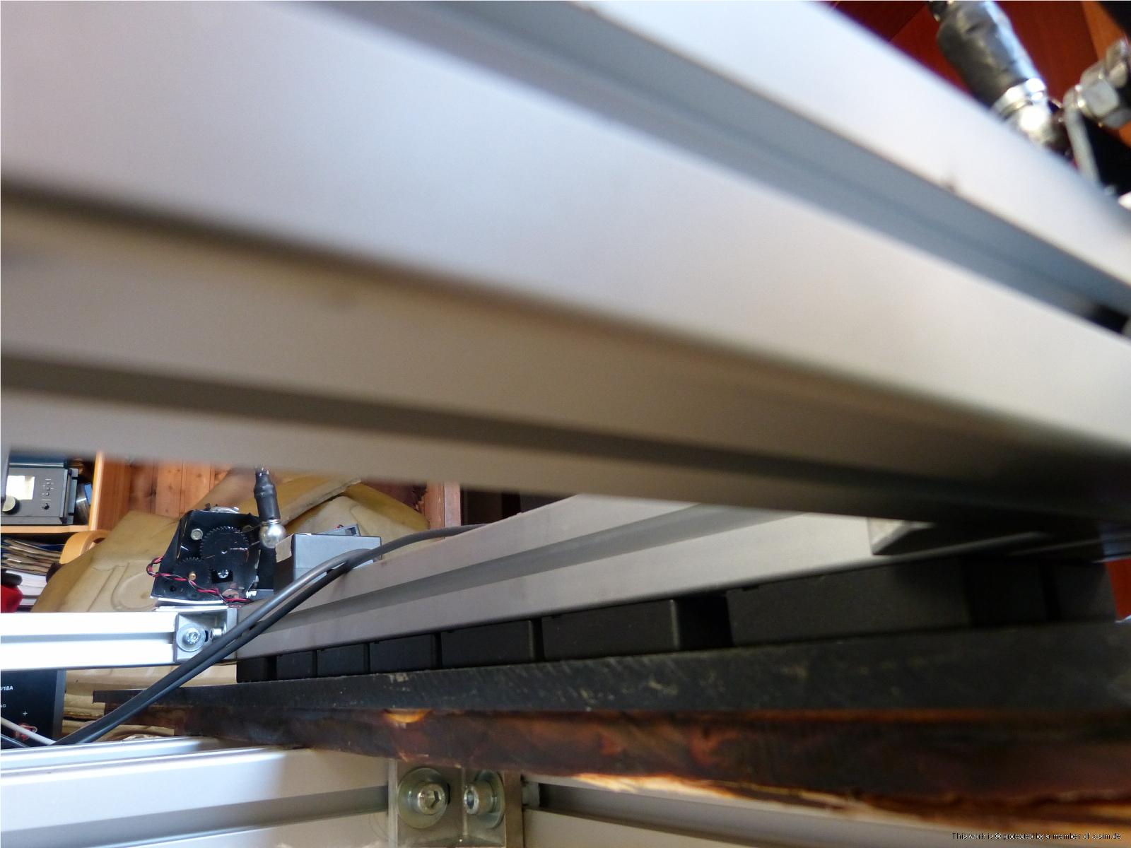

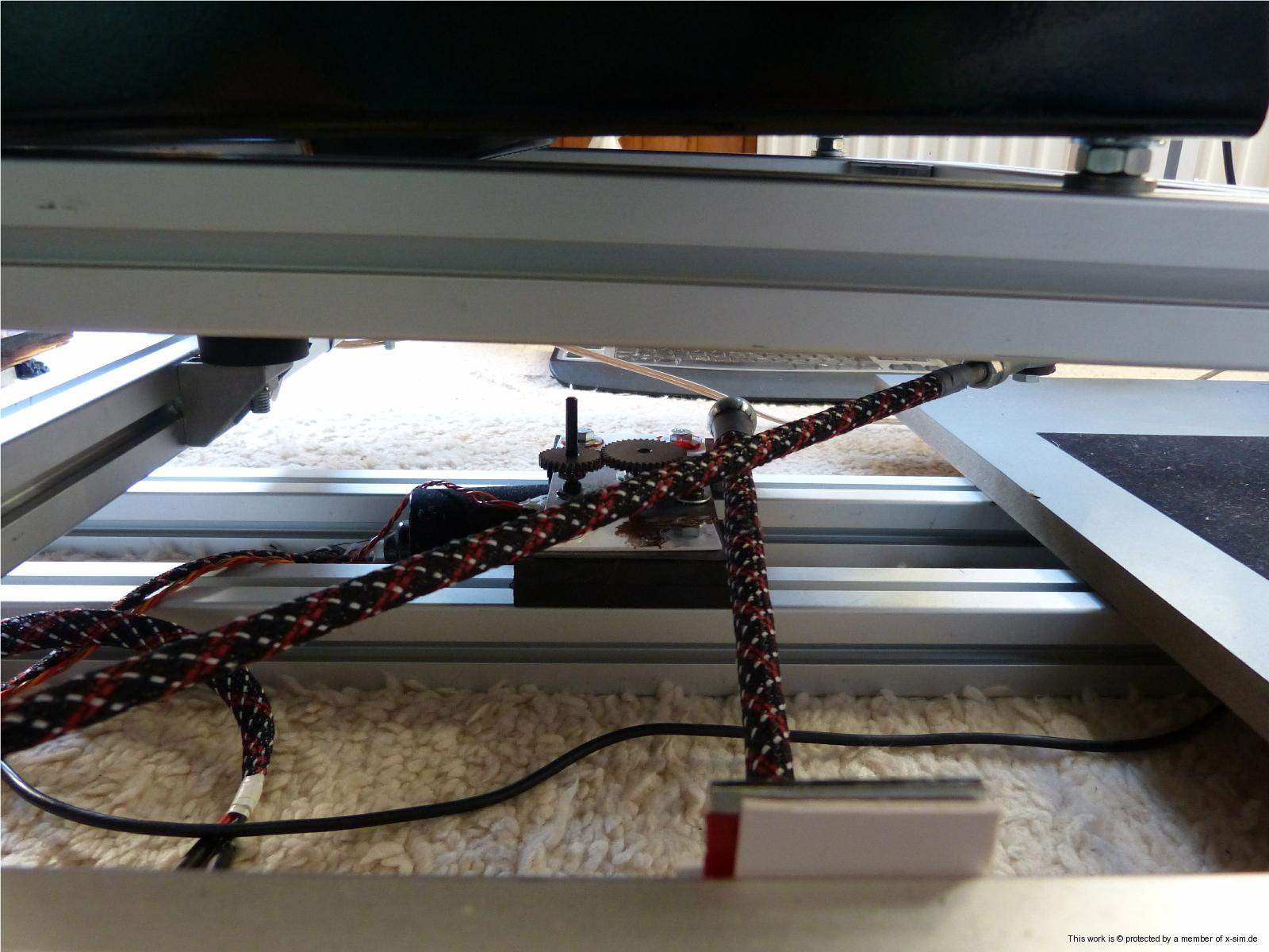

perhaps you know my video where i explained my tl build:
I have some pictures in my thread too:
http://x-sim.de/forum/viewtopic.php?f=37&t=289&start=50 --> page >=6
You have to look your bearing's (front/rear) will support your + the sims weight. For example my rear bearings support 100N each - if your weight is 75kg (+77kg simweight) you would need at least 15 of this type of bearings. Or you will look for an other solution.
If you use a "wheel bearing + housing" of a car in the front - this will support much more weight than 150kg...
123312291223
