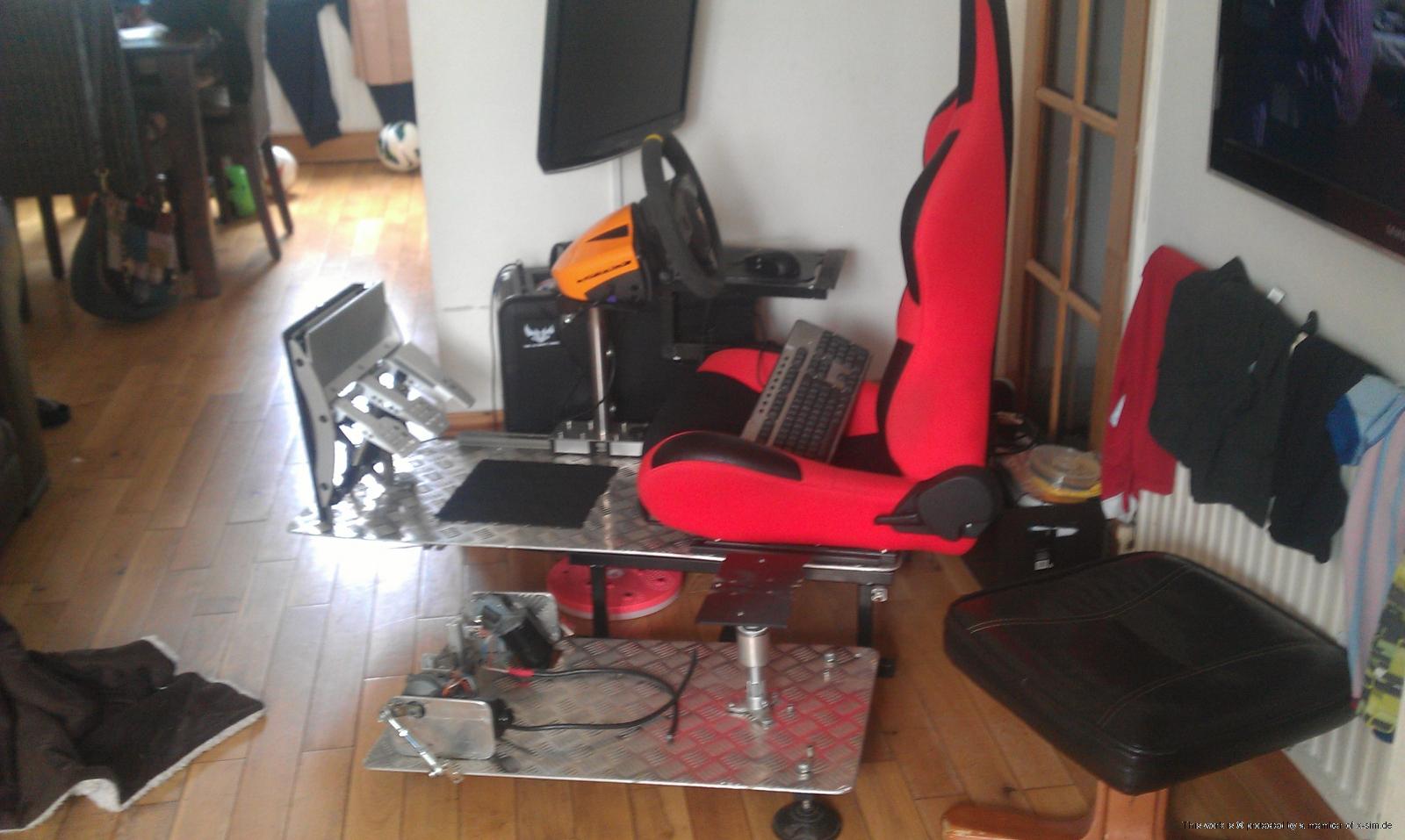

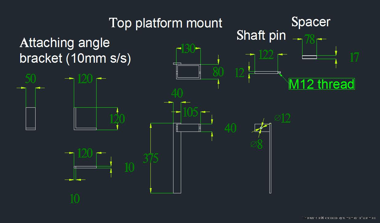

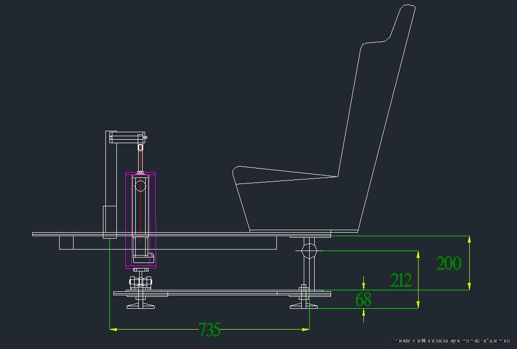

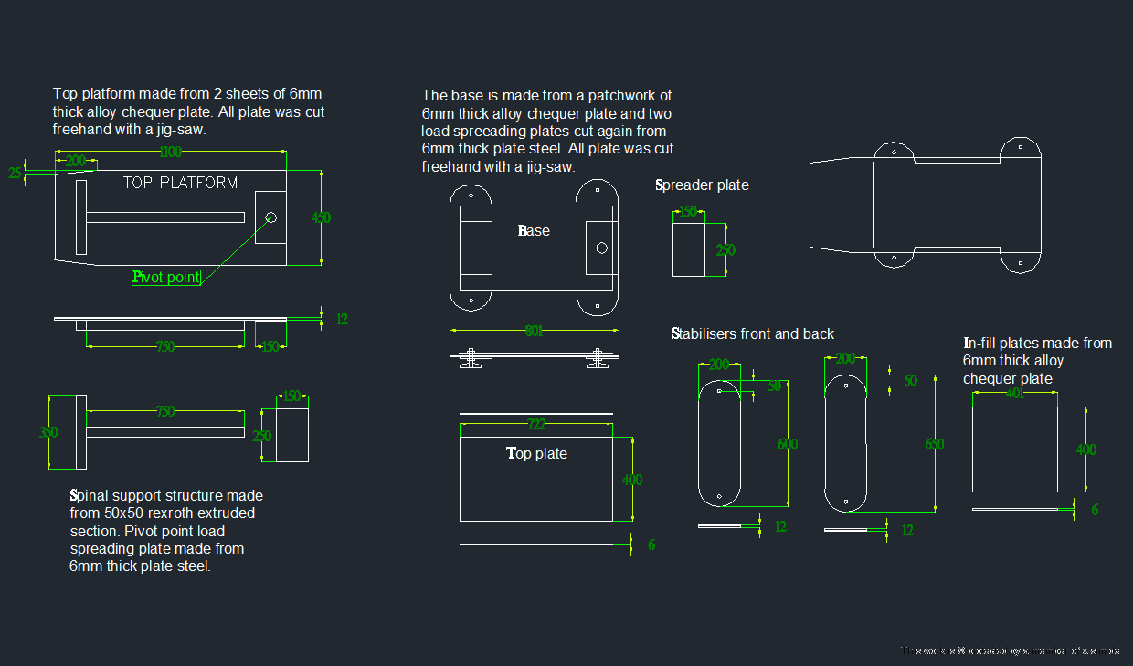

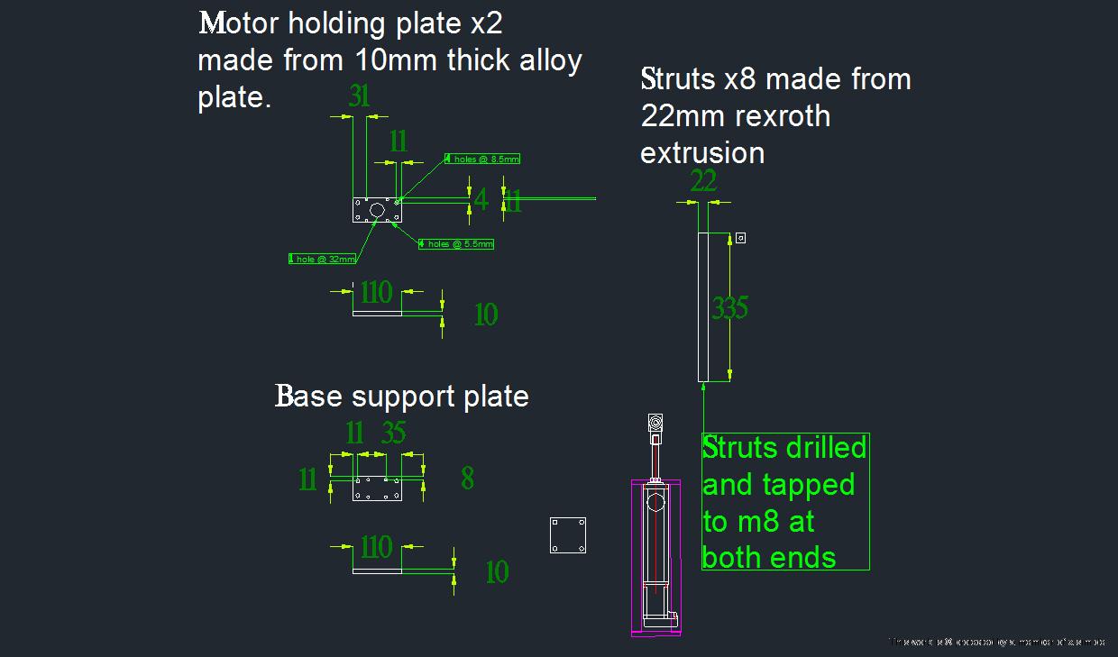

Here is the basic design and dimensions of all the main mechanical components that go toward my platform build
2737
28232825

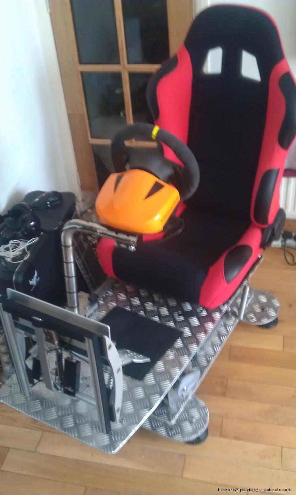

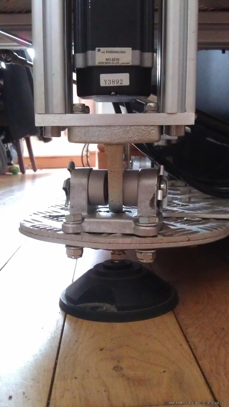

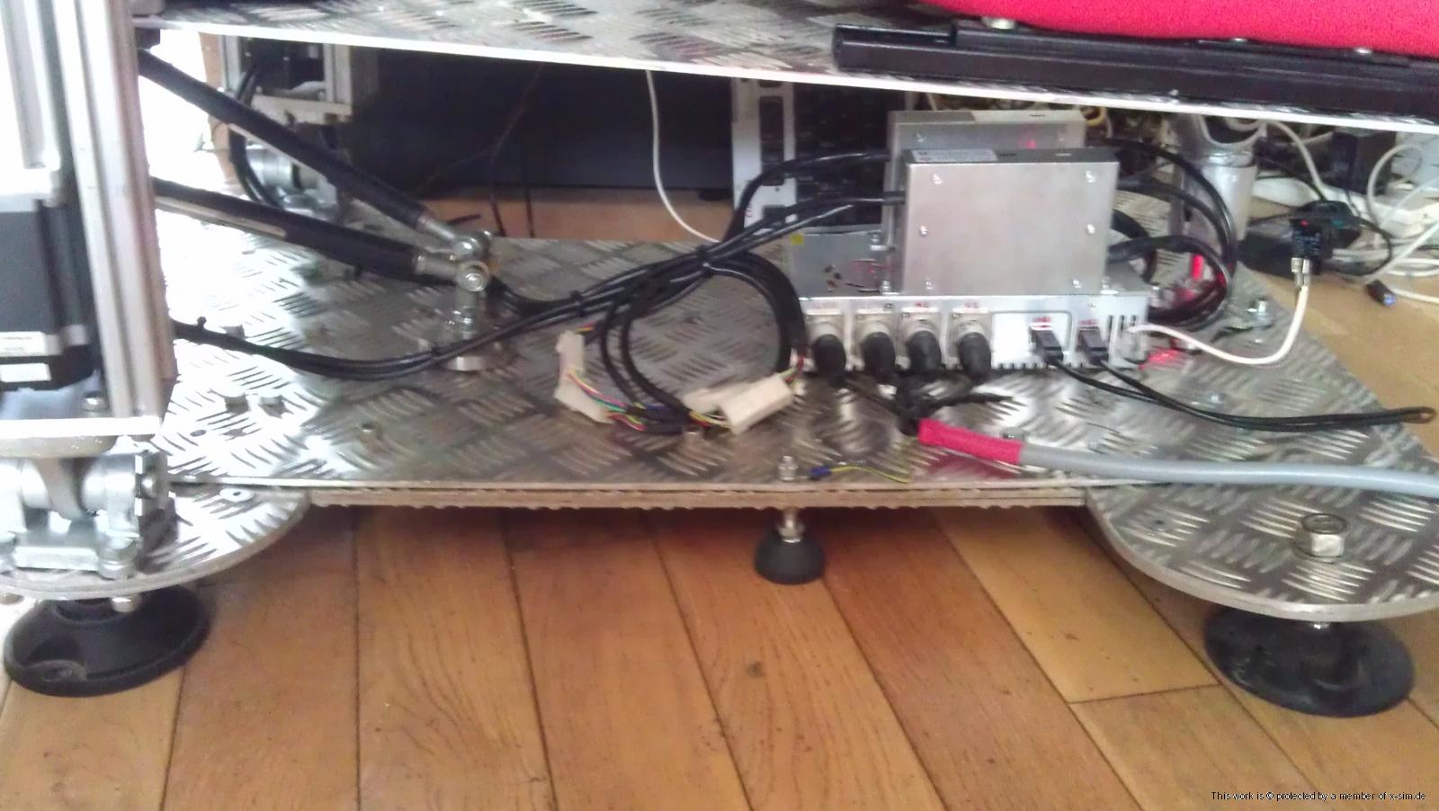

These images show the platforms before the upgrade coming together, notice the single plate base and position of the pivot
I widened the base front and back by adding the out-riggers. I discovered the need for widening the position of the feet when I started testing my old wiper motors... it was not very stable at all.

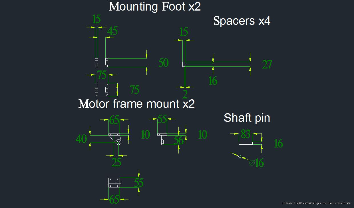

Here are the components I made to mount my scn6's
27382732
27412735

273928172816
Here is a sketch of the articulated pneumatic mounts I used to attach the drive to the base
27402822
Here I have shown the general geometry and distances relating to pivot point and drive connections between base and platform.

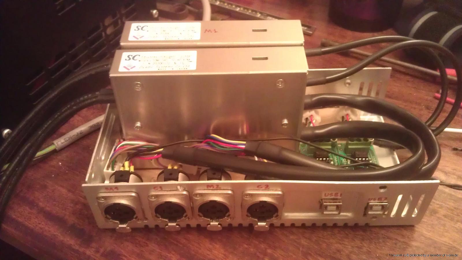

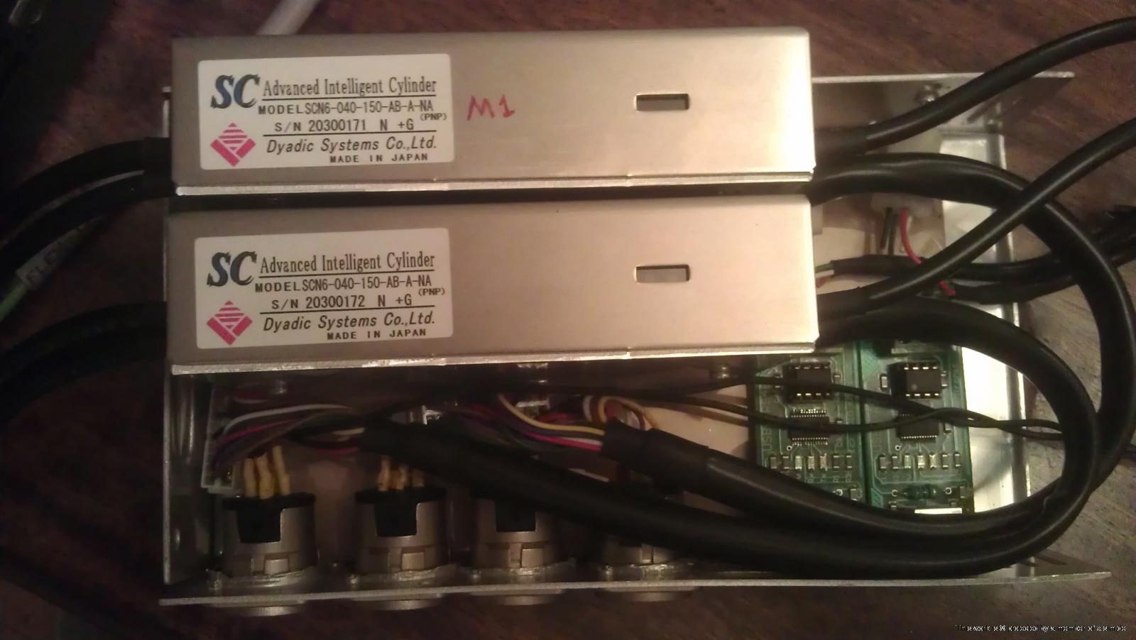

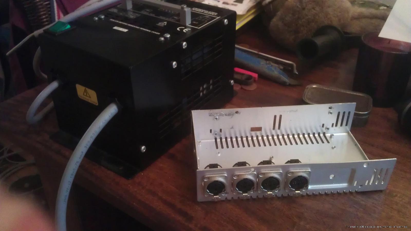

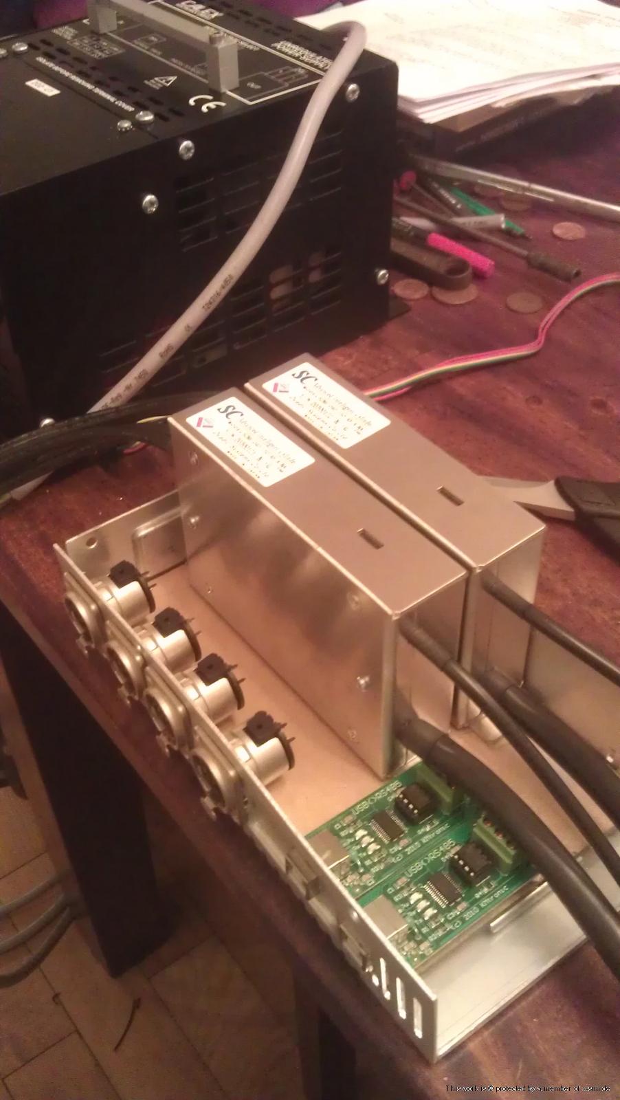

First job on my electrics was to build a housing for the usb/rs485 converters. I used up some old 3 pin xlr chassis mounting sockets as an isolate point.
2800

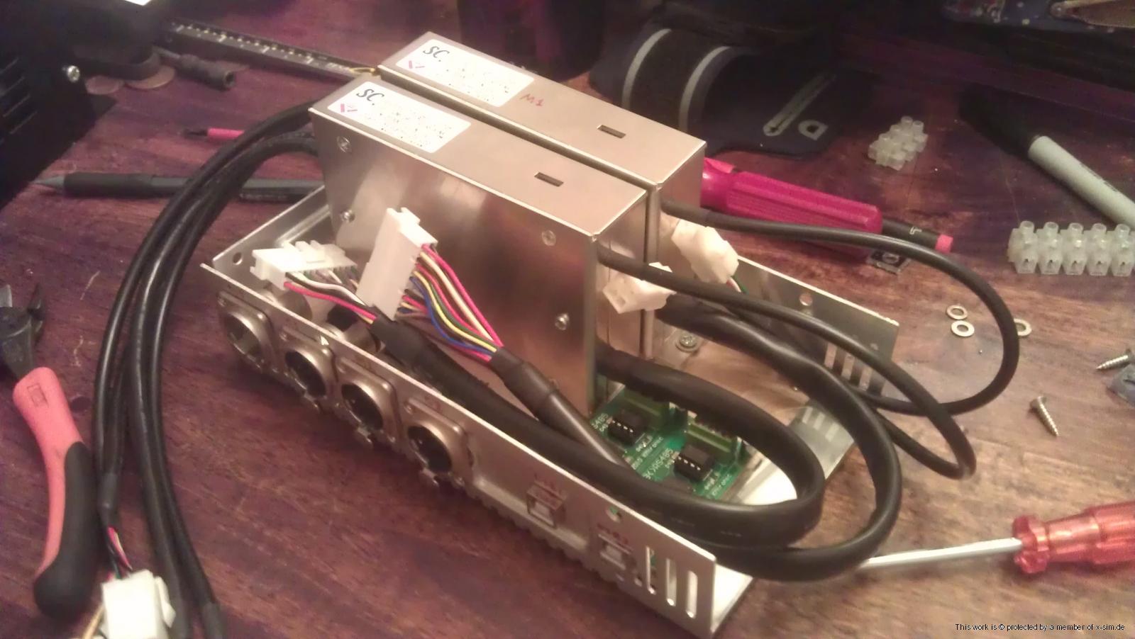

I then fitted the converters, drive cards and soldered everything up
28022803280528062807
You will notice that the drive cards are very close to each other in my first attempt. This was a mistake I made and you will see that they are now sited outside the psu case and very well spaced indeed.They get very warm very quick if too close to each other but fortunately I spotted this before any damage was caused. Beware if like me you like to tightly package things. It does tell you in the user manual to space them carefully but unfortunately I missed it. Here is how they are *
2734
