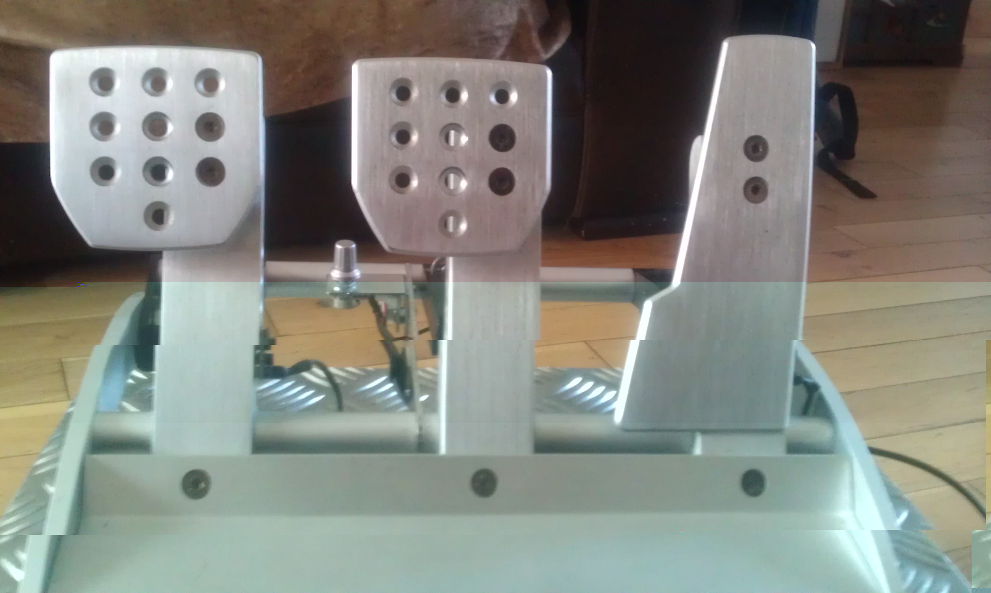

I spaced the pedals too as I'm a bit clumsy and kept hitting the clutch by accident.

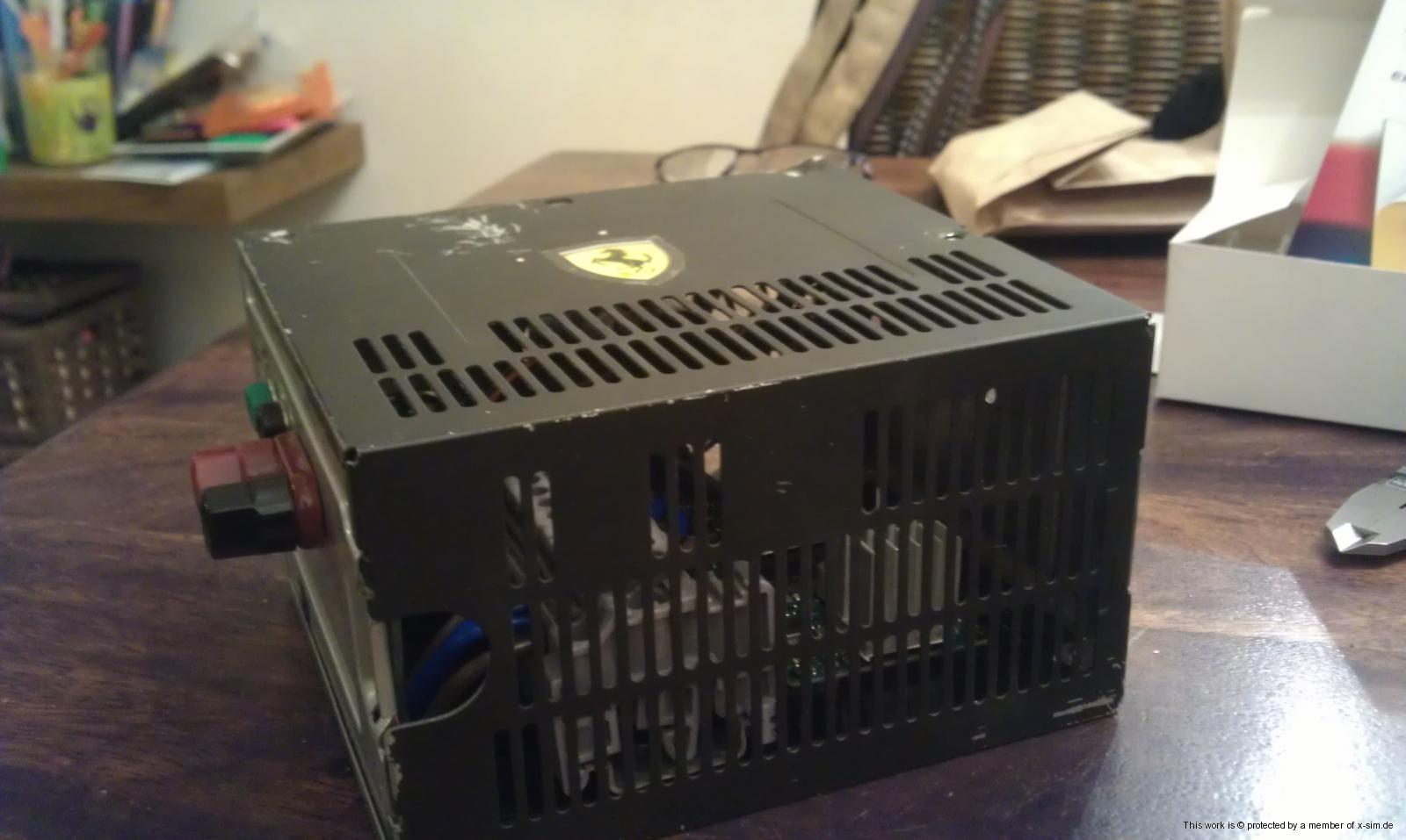

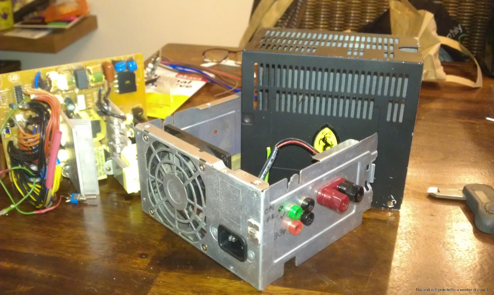

I butchered an old ATX psu to use as a polulu cooler and general jb.

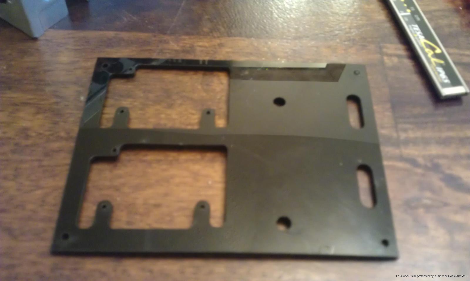

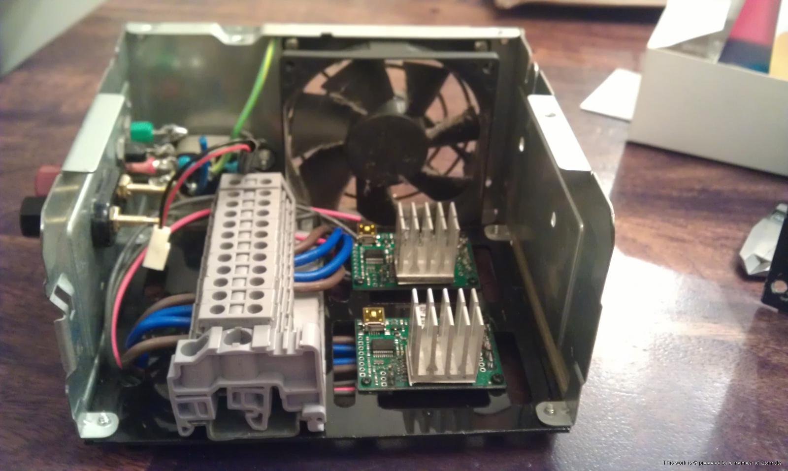

I cut out a polyprop support and mounted my 12v12's with heat sinks in-line with fan air flow, should get rid of the heat no problem. Have a few more posts to fit, some switching and some lights before mounting. Maplins again tomorrow... what joy!

I think I might steal that as well :lol:
Great solution Carl

Same Problem with the pedals here.
But I think it is the small lower part of the gas pedal.

already done the jrks in old pc psu box with fan on it already

Thanks for the kind comments everybody. MotionDave,I agree, the gas pedal design is very odd indeed. I might swap it out or modify it before inverting the pedals.

No i never bothered with fan speed control . I just used a fast fan only.
