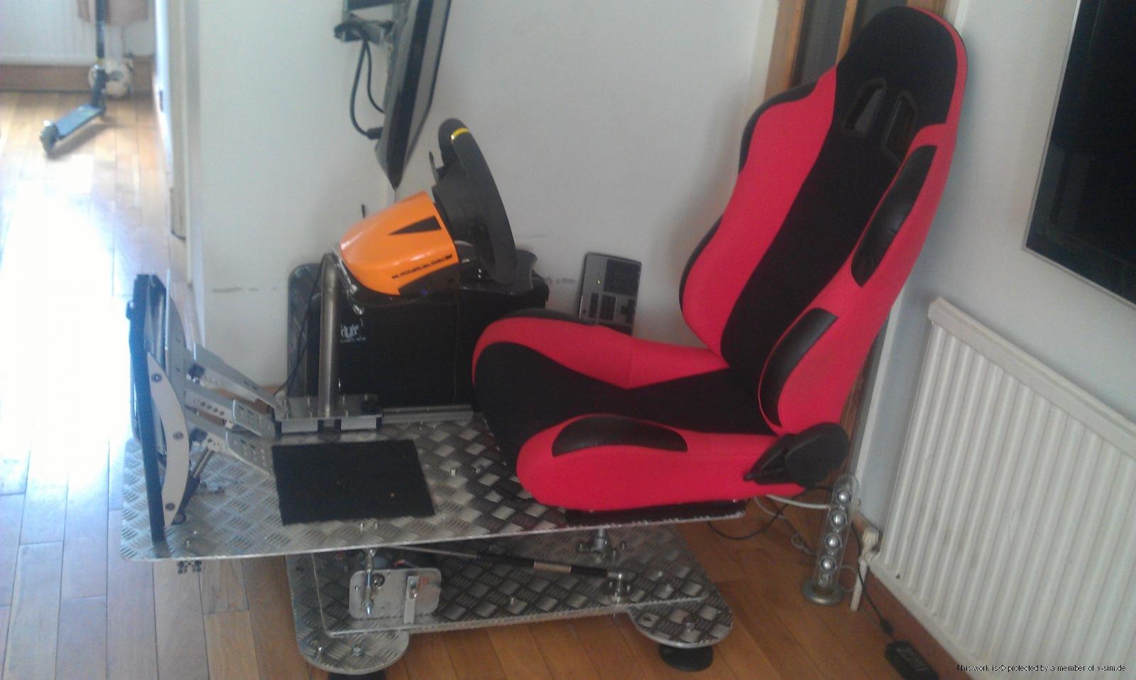

Well despite the lack of posts I have been a busy boy these past couple of months. I am where I want or think I want to be mechanically and now need to install the electrics. All the alloy chequer plate has been cut by hand using a jig-saw... well two jig saws actually as the first died half way through. I have the vibration white finger to show for my effort. I will post some cad drawings at the end with all my dims.

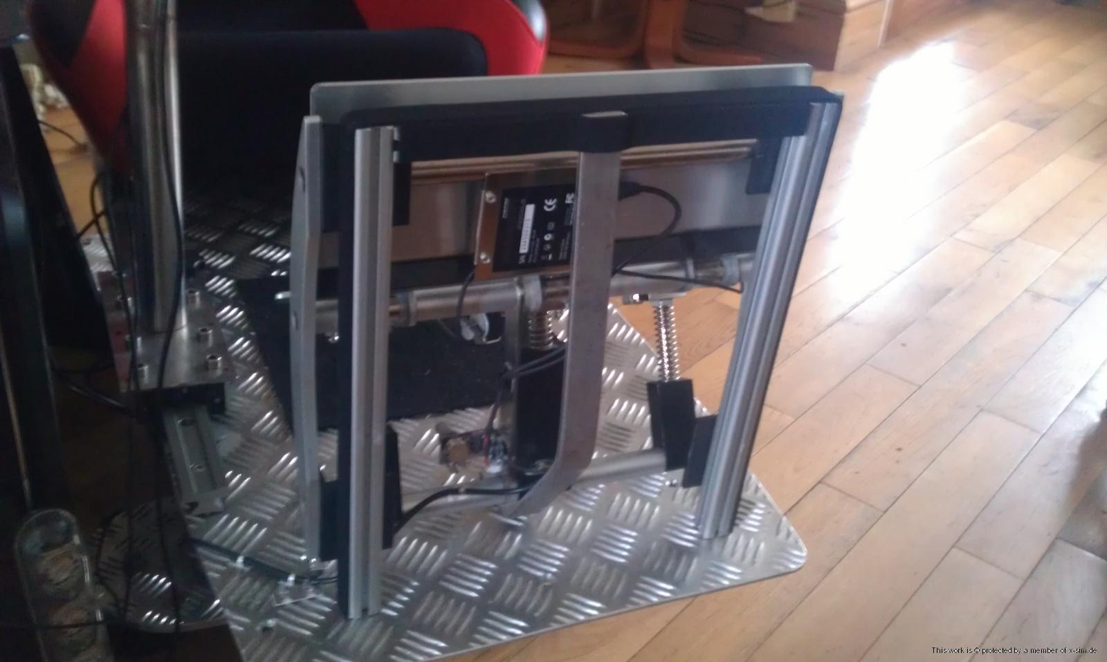

1886
I inverted my pedals and mounted them on a rexroth goal post frame. I showed this view to illustrate the reinforcement flat bar I formed out of stainless steel. They are rock solid and give great feedback. I had to remove the spacer blocks to get them to the right height.

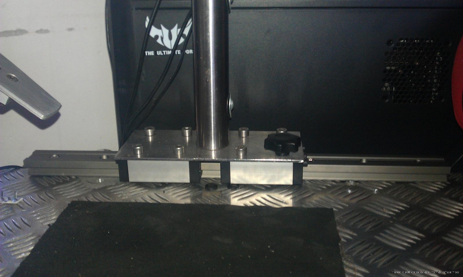

1885
I mounted my steering column on a linear track to make it adjustable between me and the boy. Spreading the mount across two bearing slides gives it great ridgidity.

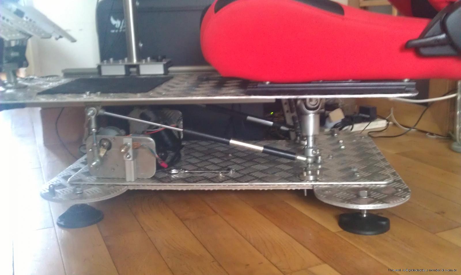

1884
I fitted some gas struts to give the motors a little boost and provide damping. I chose to anchor them at the motor linkage point but this might change.

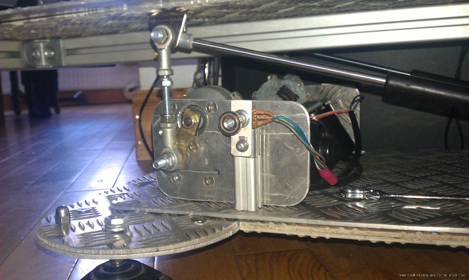

1889
I have fitted a bottomed out rod which is too long purely to give lockout on the platform whilst Im developing the build. What you may notice in this pic is that I had fixed a rotary magnet onto the shaft of my pots. I had tried to use a magnetic clutch directly driven from the other side of the wiper motor which I drilled and affixed a new positioning shaft but the shaft extension kept failing under test. I decided to scrap that idea and make a linkage as Floriske did.
