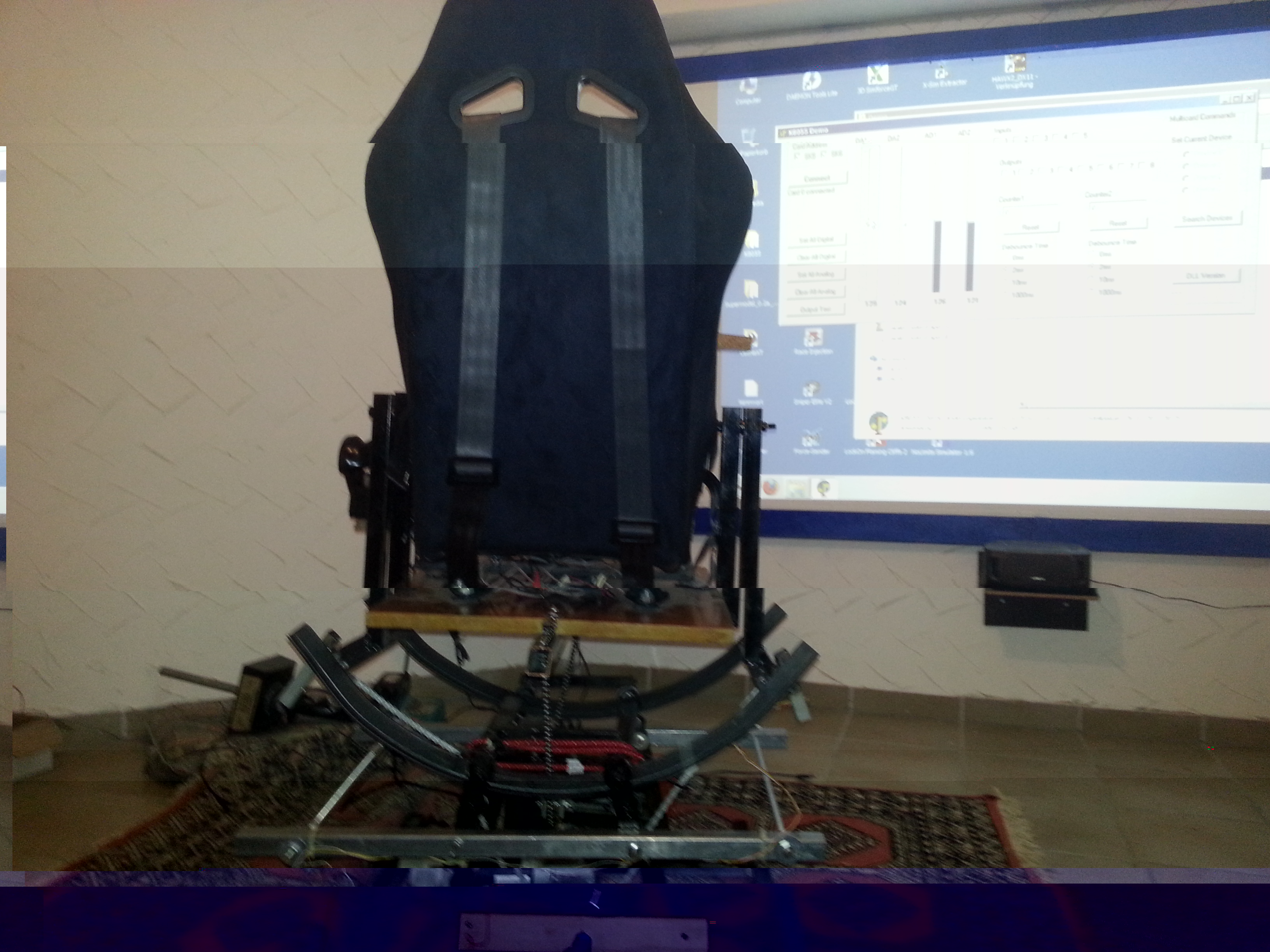

Hello Friends

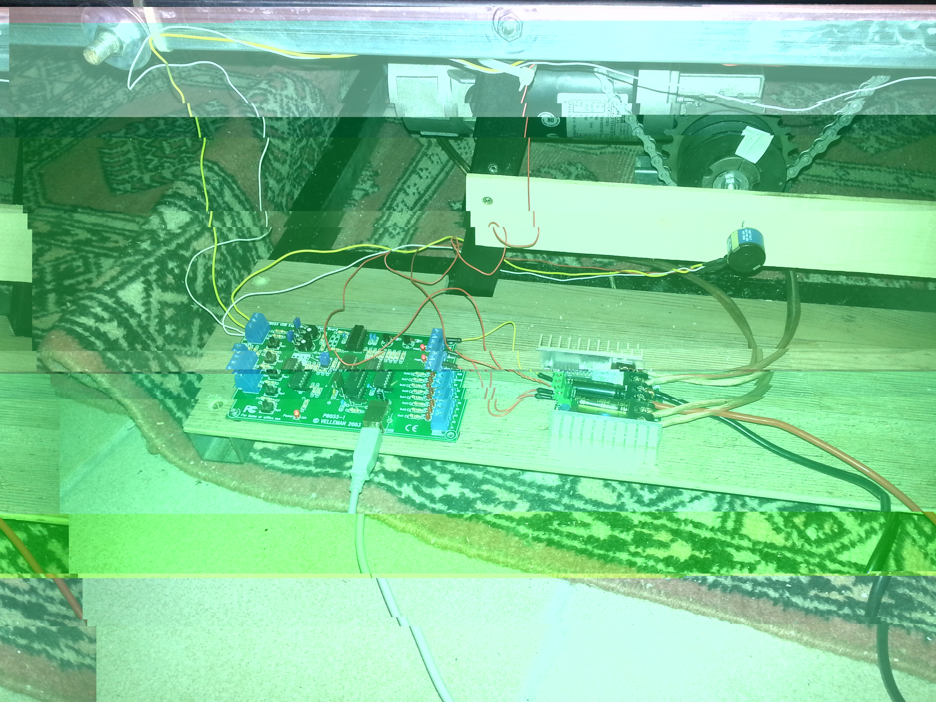

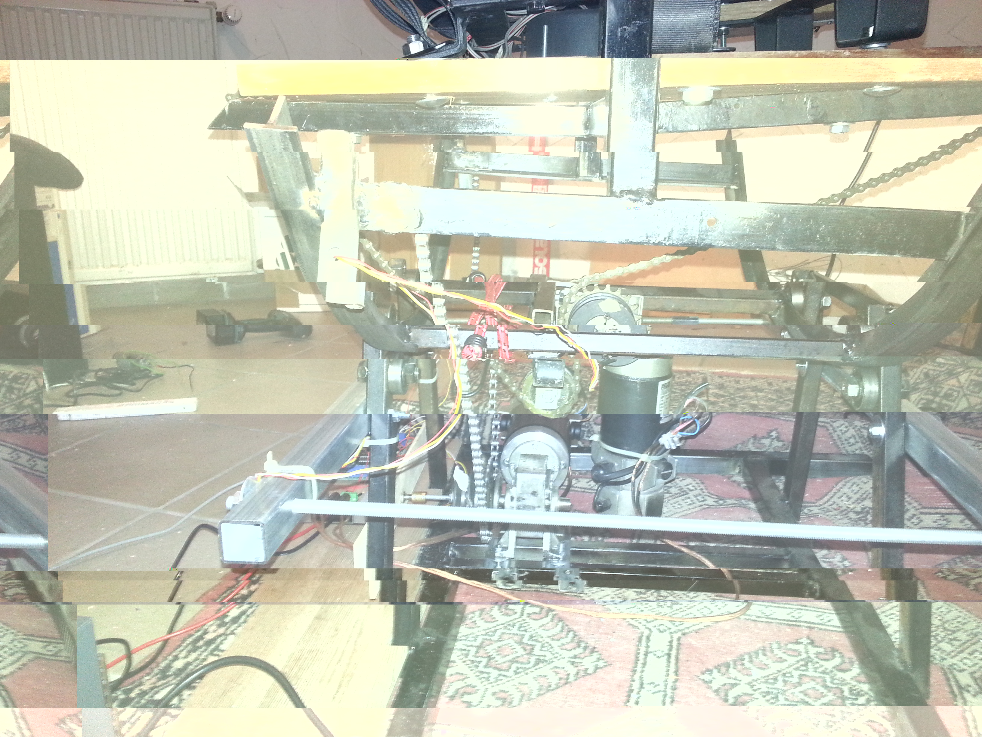

I want you to introduce my selfmade Simulator.
Using: (at the moment)
1x K8055
1x Sabertooth 2x25
2x Wheelchairmotr 180W, 8 A, 24V
Power SUpply 24v 40A,
Input: changeable from Microsoft Siedewinder FFB Wheel to Hotas Cougar Flightstick
Tests with Vellemann Demo succesfull.
Some Problems with X-Sim because Potis Vellemann etc.
I like Flightsims , Coasters and Car driving
This is for what i need this kind of sim.
So i decide to take Motors instead of actuators because my favorite is flightsims
i try to ad a little video für the motion
but you have to know that i am a totally noob in electric.
here the youtube link http://www.youtube.com/watch?v=-LntV7NA ... e=youtu.be
Here are som pics

Re: My Simulator
Postby menix » Tue 12. Feb 2013, 16:14

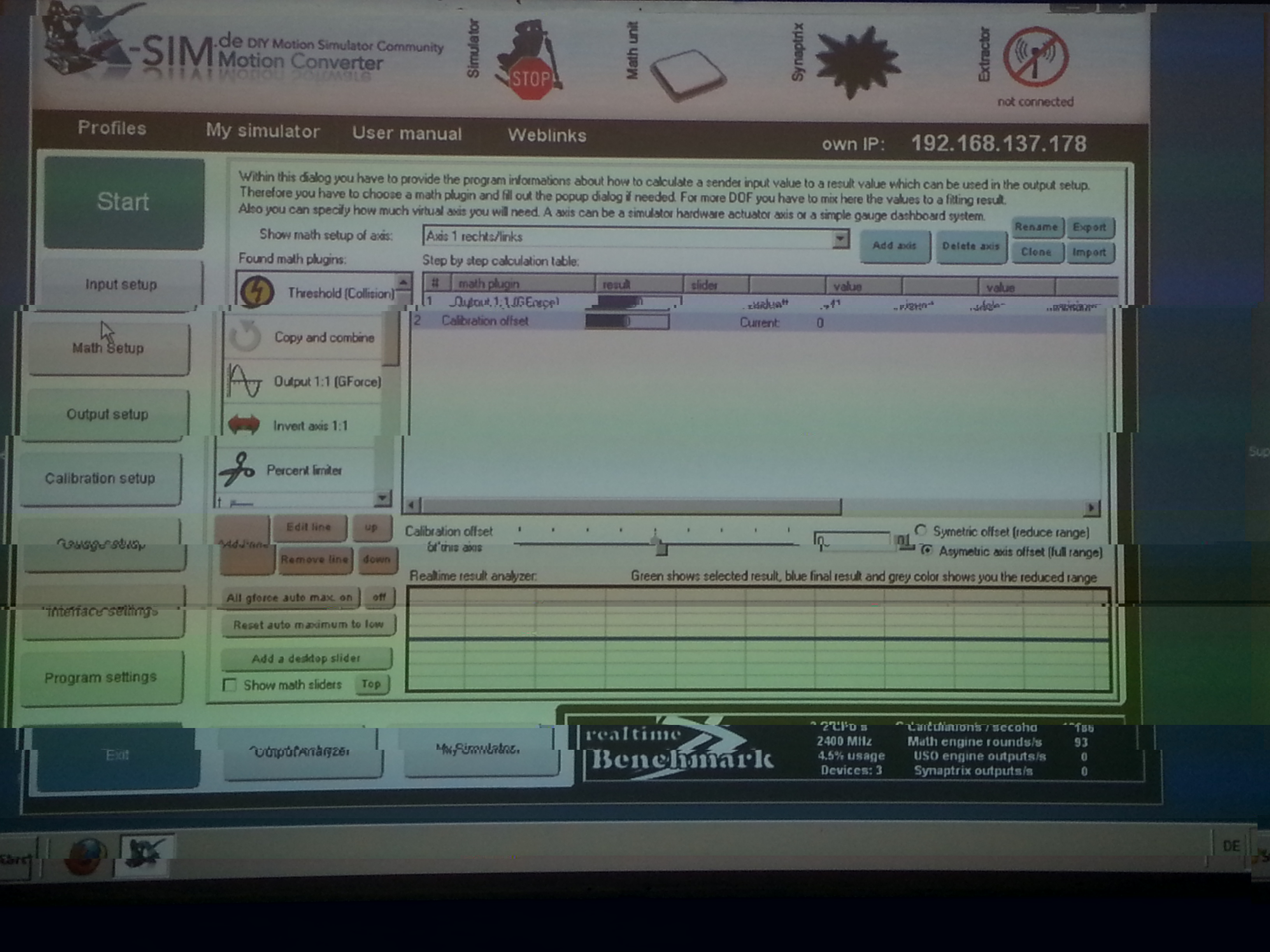

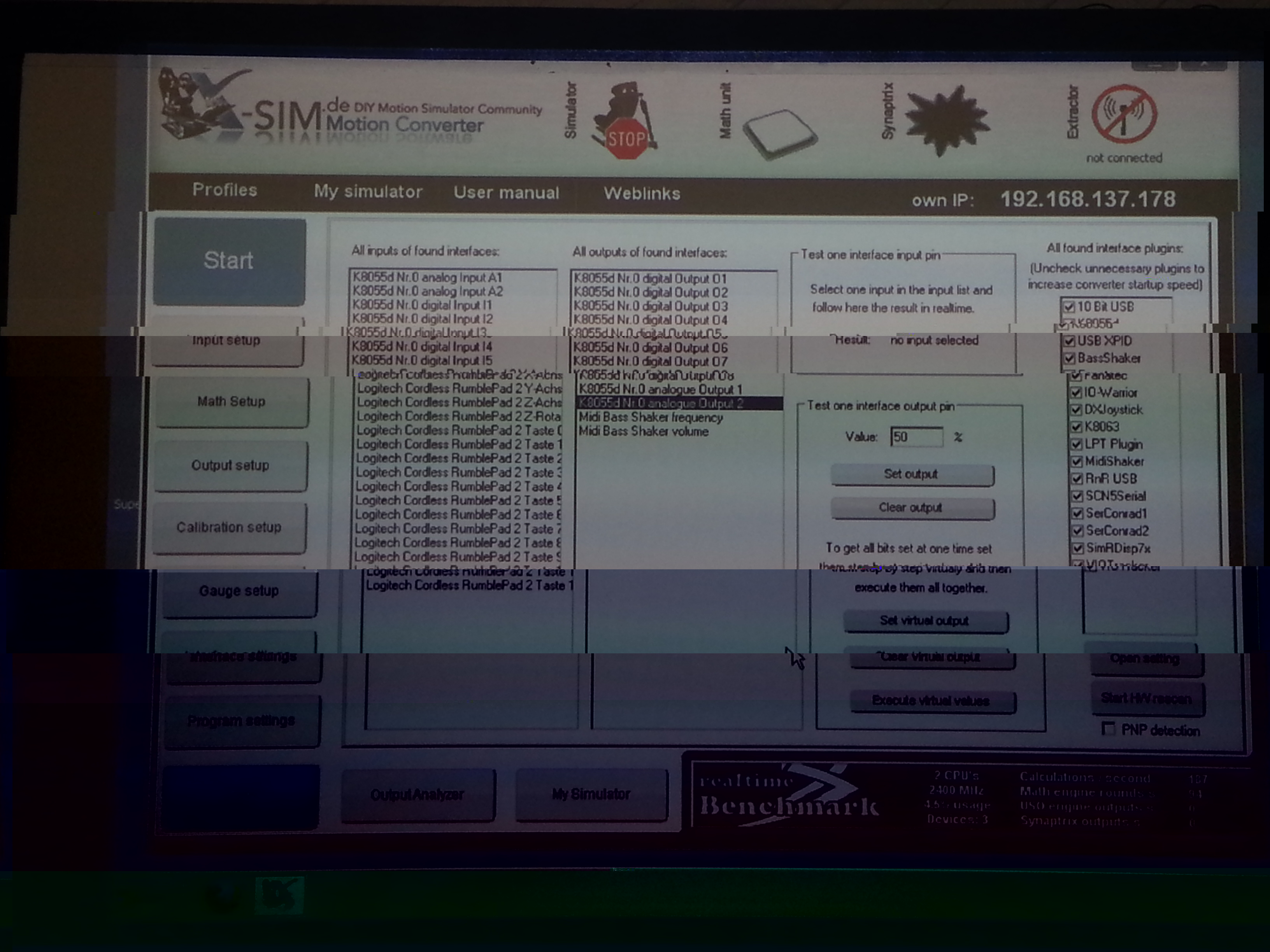

Waiting for my new Potis. I havent known that the Potis must have a full Rotation for good movement, mine are 10 gear potis without gears.
So i decide to buy 3 gear Poti with a 2:1 gearbox to have exactly the movement i want.

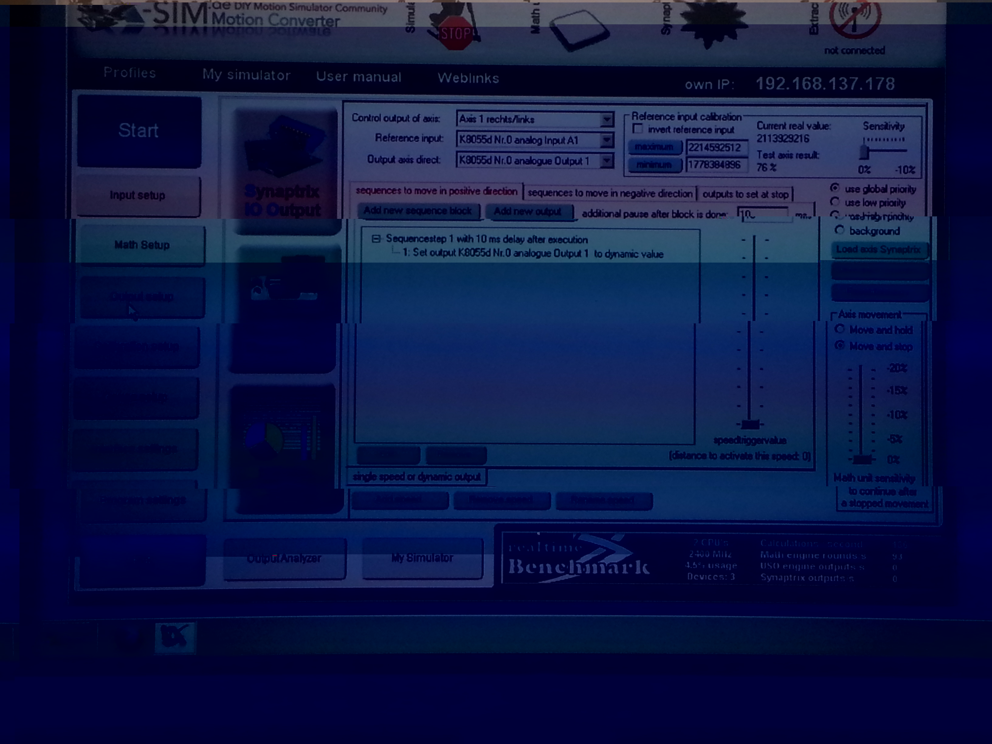

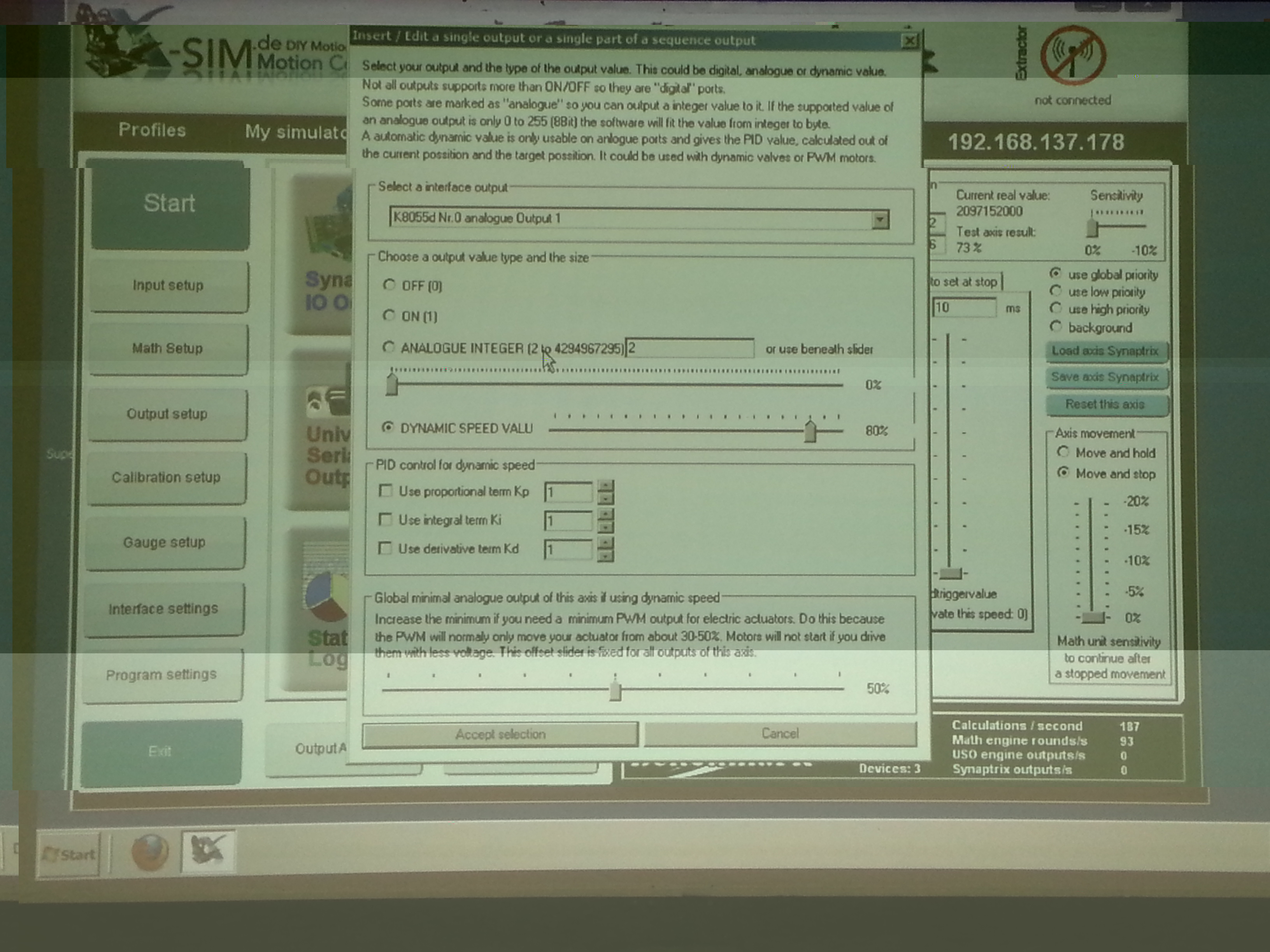

Some pics of my X-Sim Setup, i dont know if its right or not
Comments are welcome

Re: My Simulator
Postby menix » Tue 12. Feb 2013, 20:29
i took my settings from kevin.
but i have still the problem with my 10 gear poti. So i have to wait for the new one.

Postby menix » Thu 21. Feb 2013, 07:19
here a small update with my new Pots
