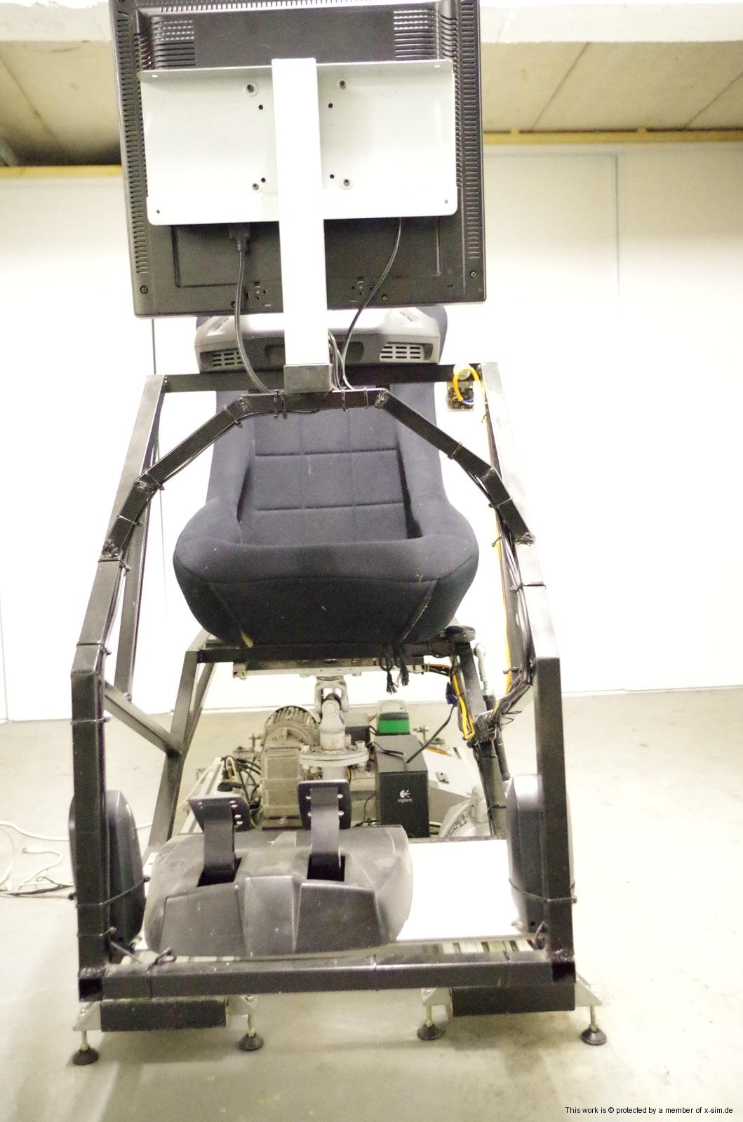

Chassis:

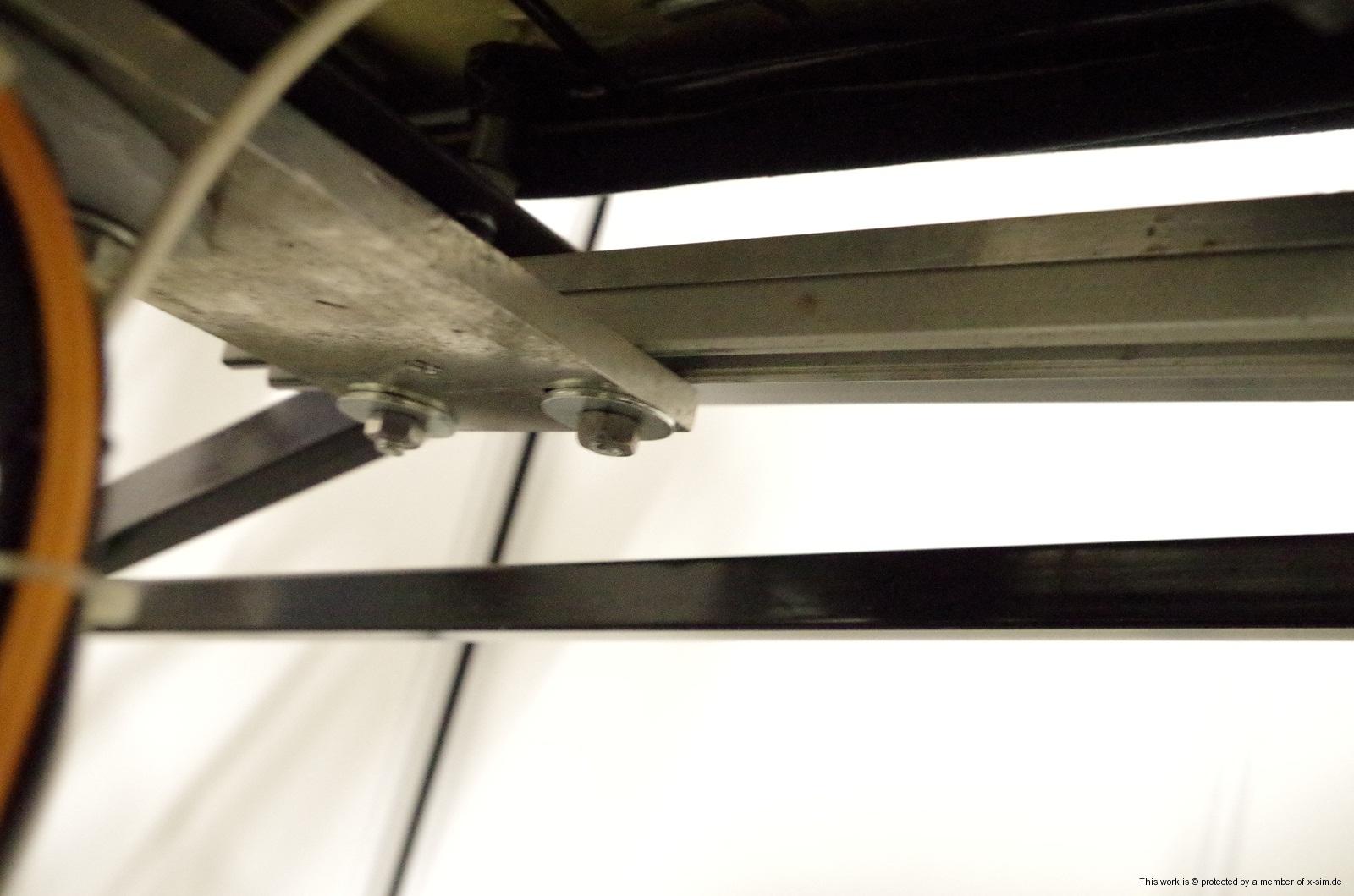

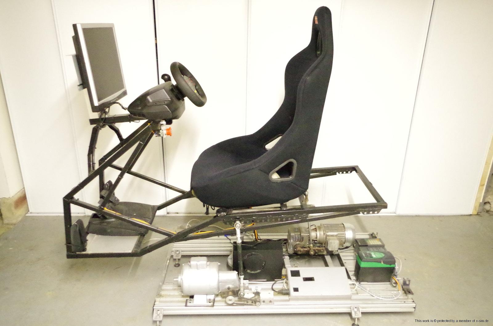

Size 1300X690

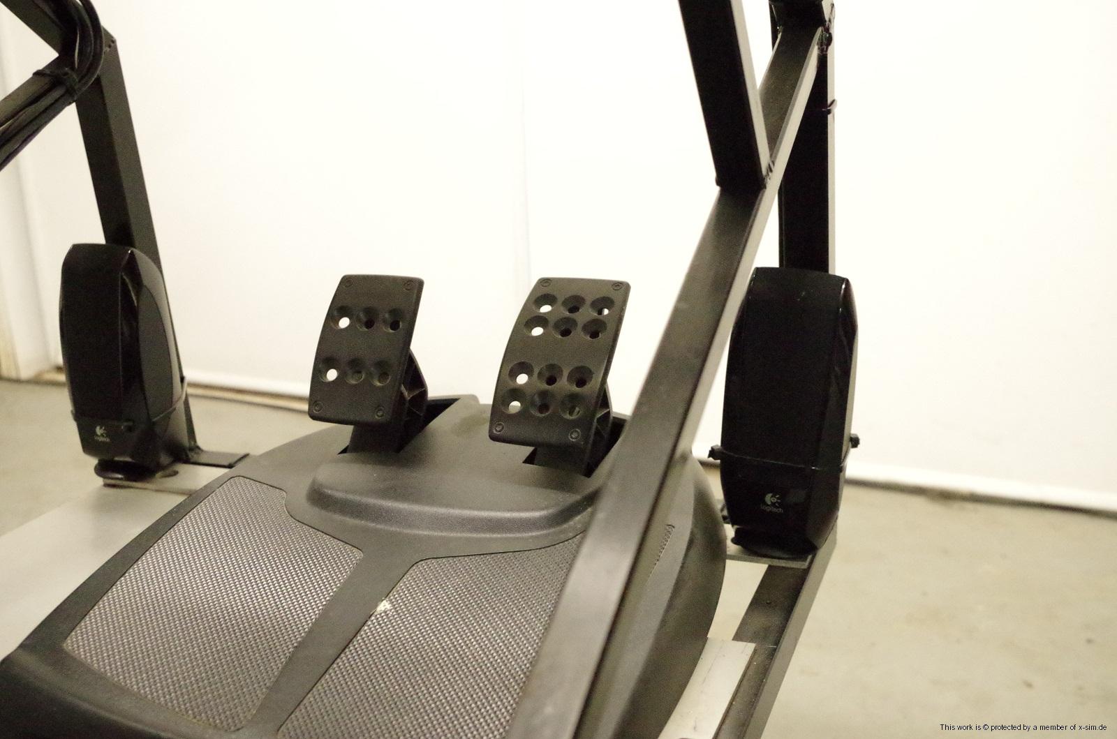

The basis of the simulator is a profile Bosh (1300x45x180) into two parts assembled by two aluminum profiles (600x20x20), the advantage it's adjustable position.

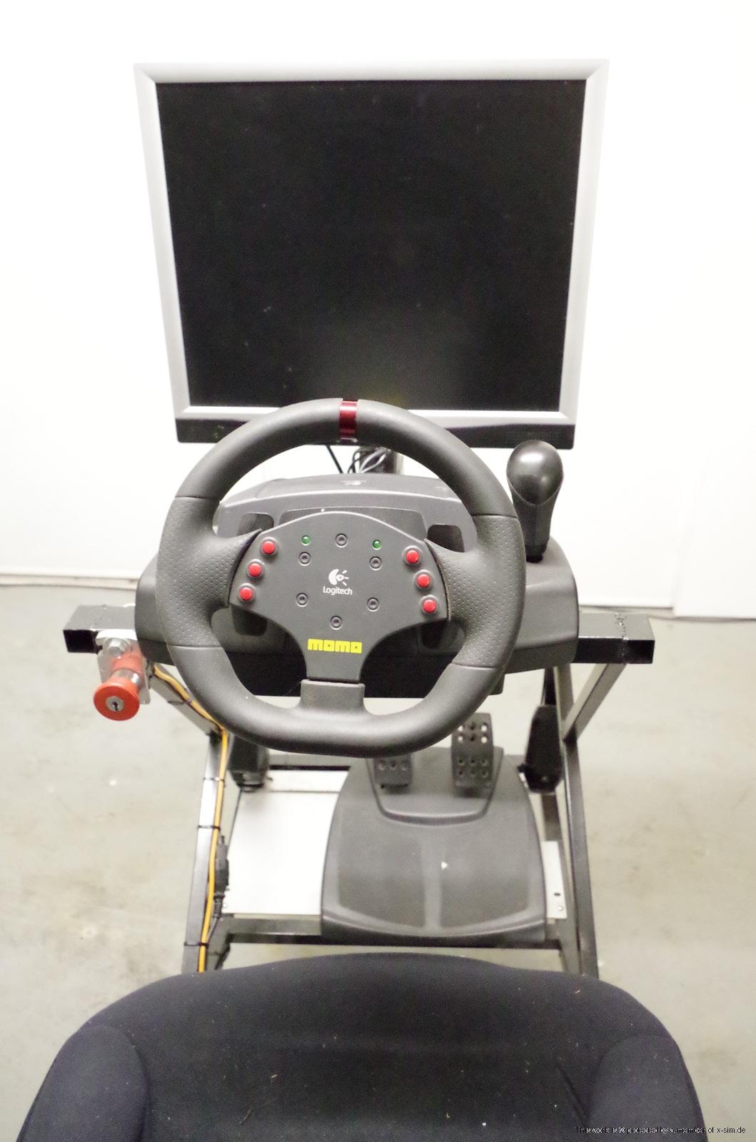

The main part of the chassis is made of steel tube 25x25, it is fixing: steering wheel, seat, pedals and small speaker.
1021 1023 1024 1022

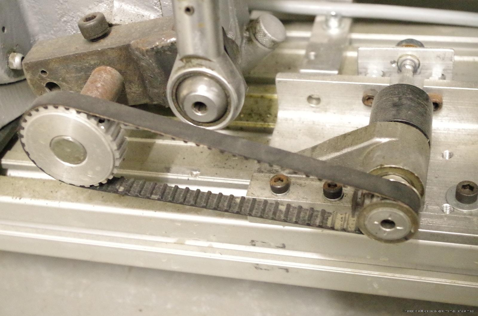

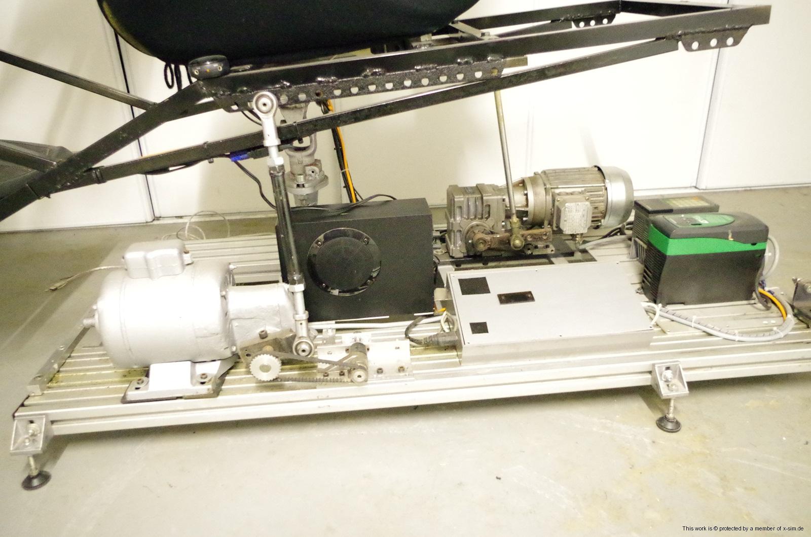

A motor is fixed directly on one of the profiled Bosh, it's comes from metal curtain for the shop. The second motor is fixed by two steel profiles; I redid part of the axis. The motors can be moved on the base.
1025 1026

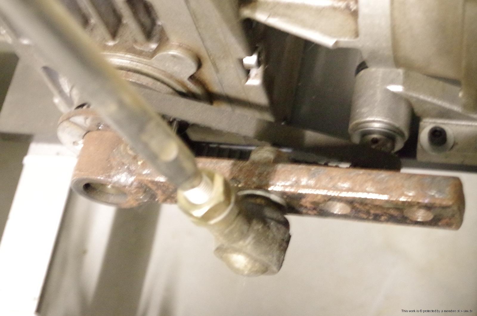

The rods used to move the chassis are made with tube and unibal from an old machine, I will replace because they have usury.

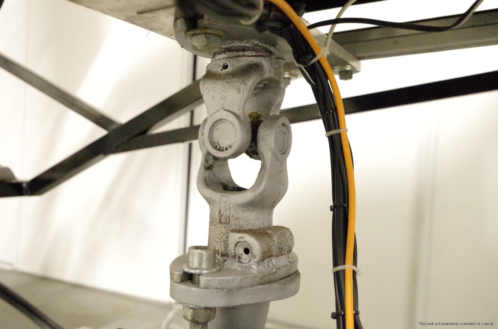

The chassis is connected to the base by a large diameter shaft and a cardan transmission from farm equipment, a gift from my brother, the chassis is adjustable for to adjust the center of gravity simulator.

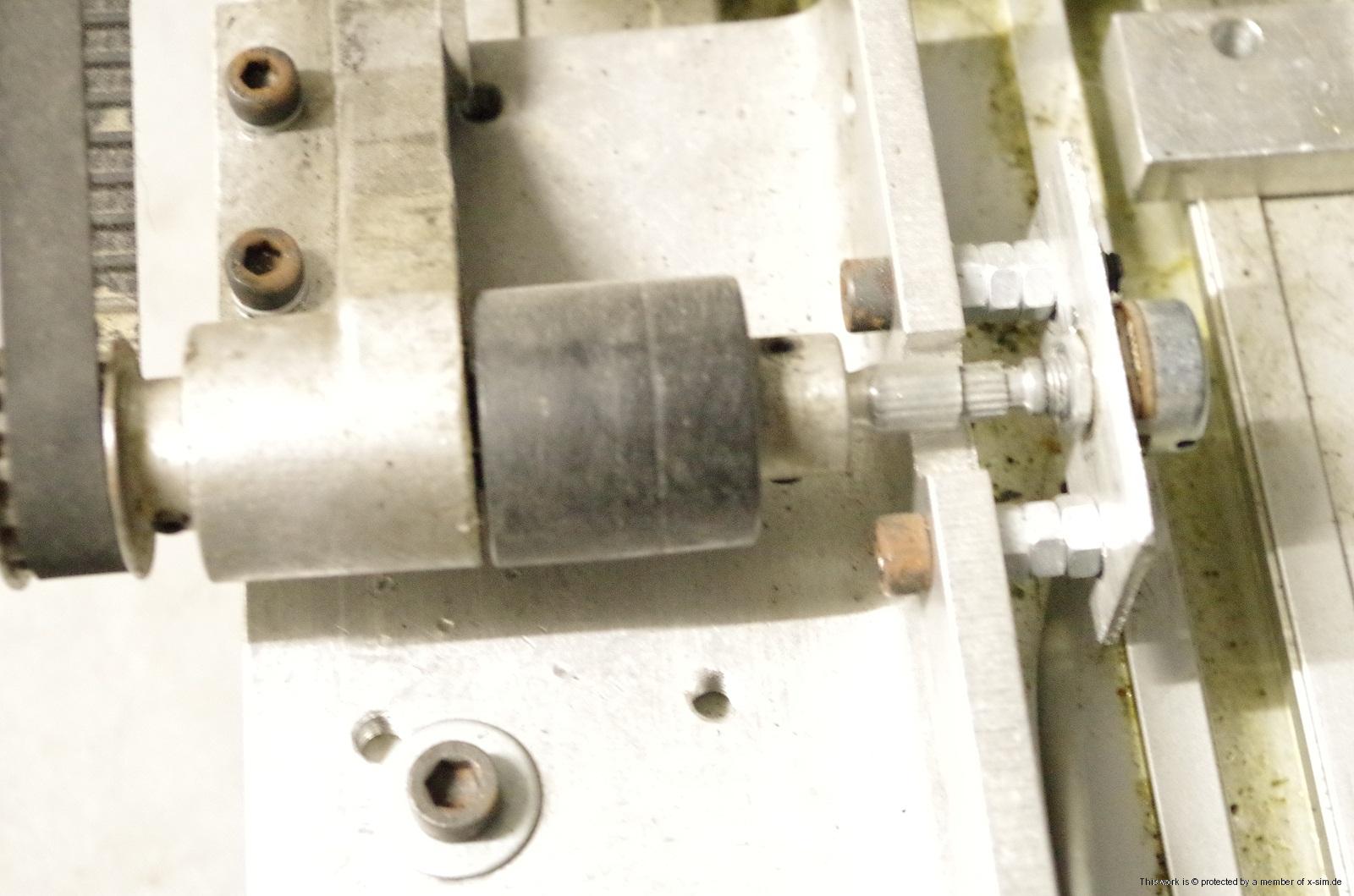

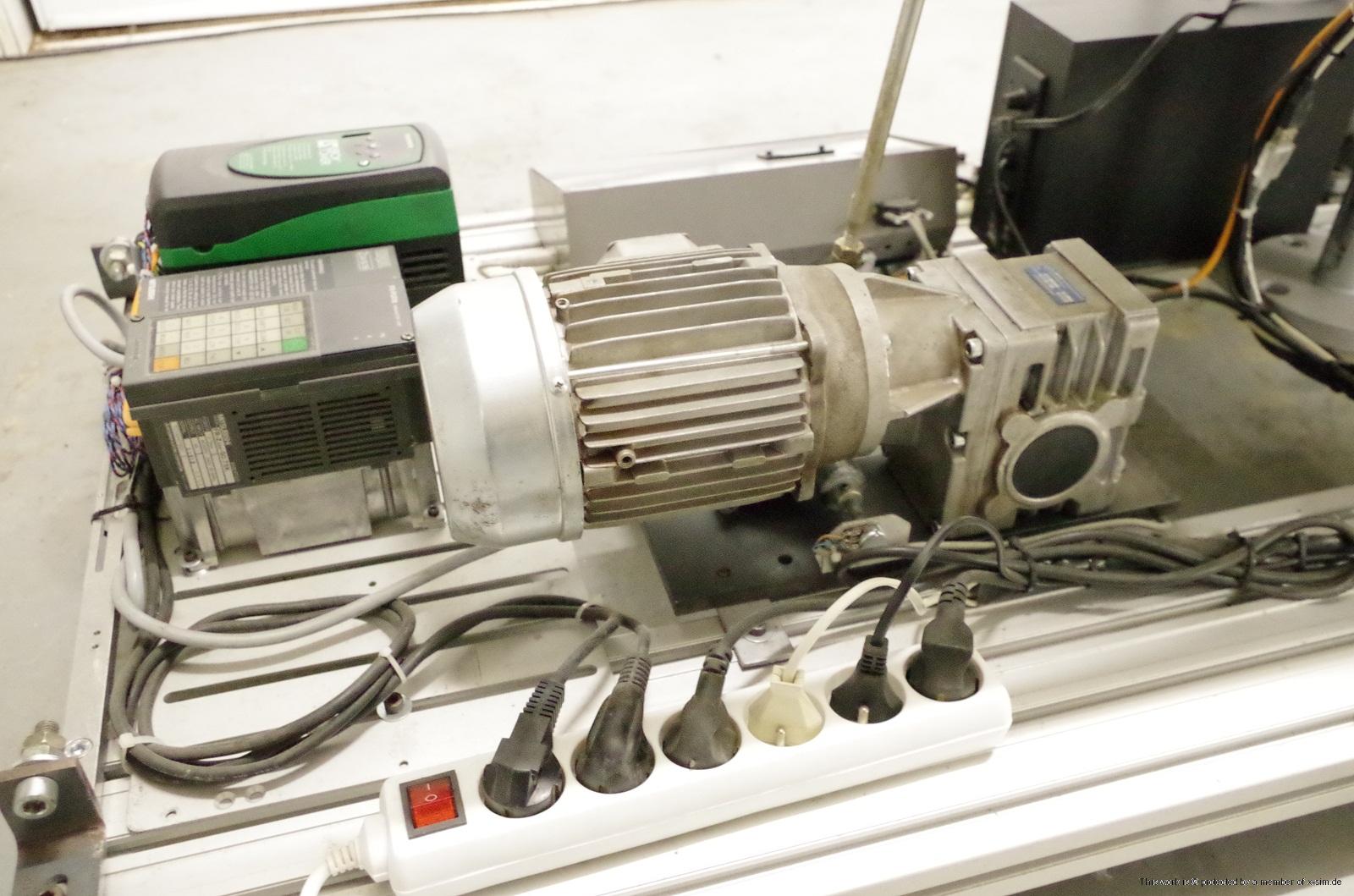

The simulator works by two AC motors connected to two frequency converter. On each motor there is a potentiometer 10 KO connected to belt the axis motor.

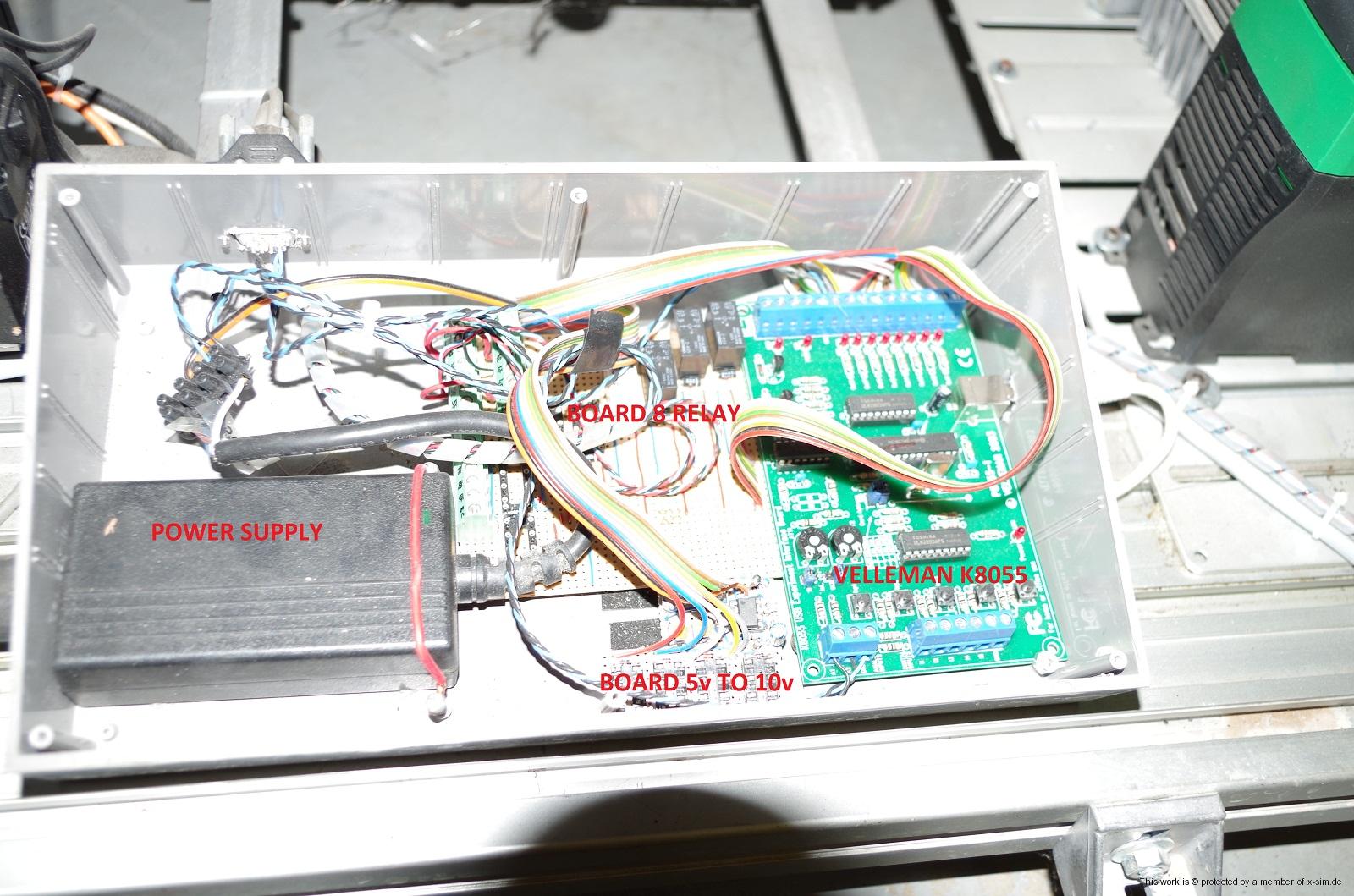

Management is carried out by a board Velleman K8055 and the control relay card that I made, but you can use a relay card Velleman K8056. Action: forward / back.
For analog outputs controls speed of the drives via a small interface that I realized, this interface is used to convert the analog signal 0-5 volts to 0-10 volts for drives.
