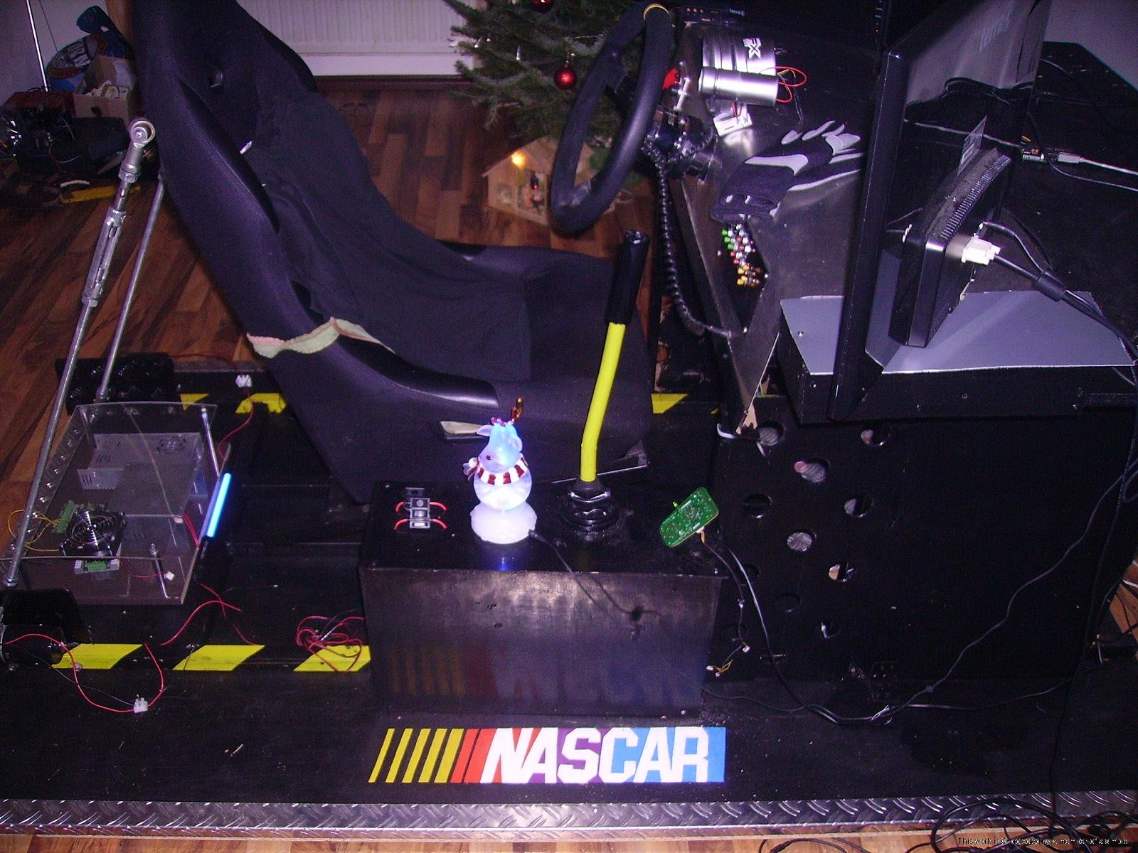

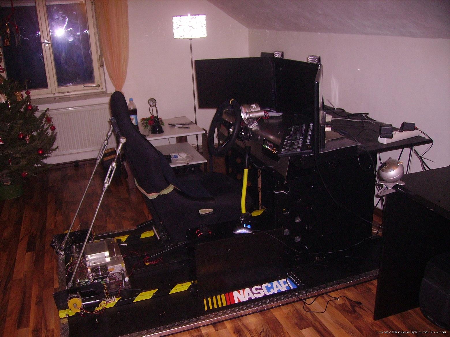

Here is my simulator is finished .. ok not quite. There is still a hydraulic pedals and H-Shifter.
When I am ready I'll post it here!

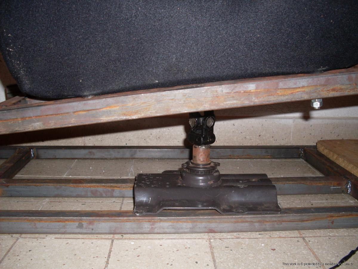

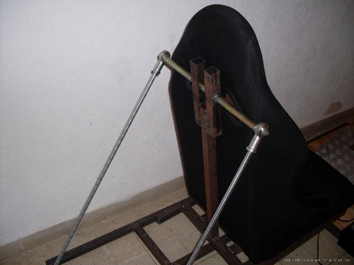

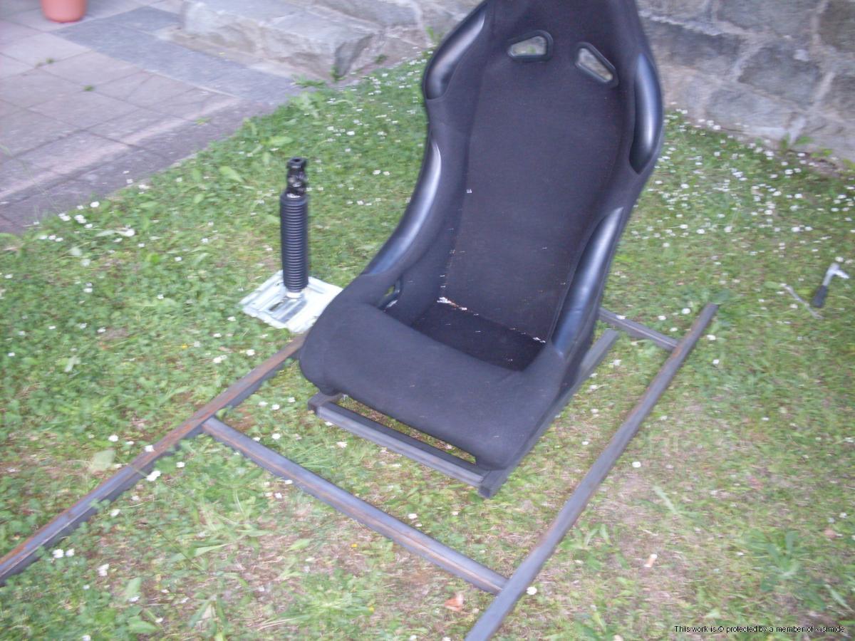

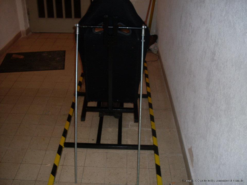

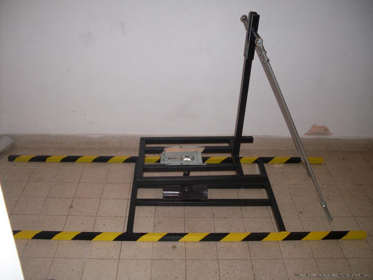

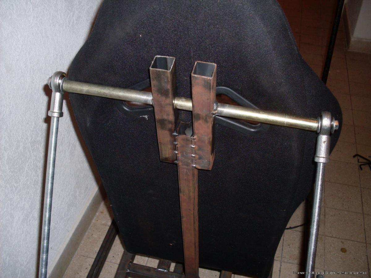

Part List:

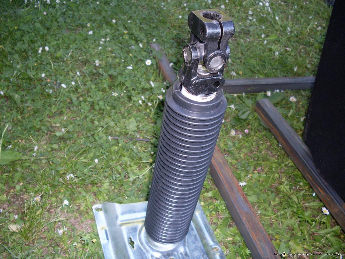

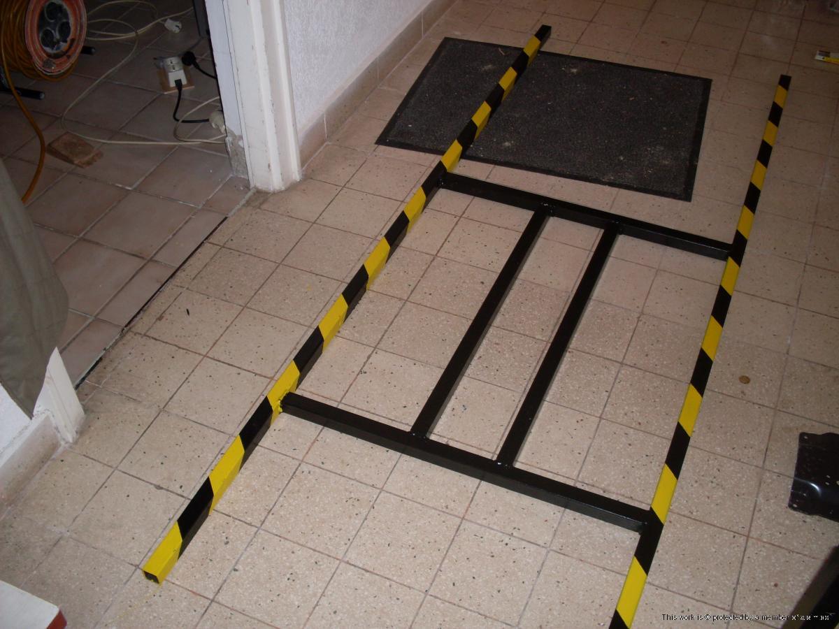

6 feet square tubes /from ebay
Office chair back x2 (picture 5)

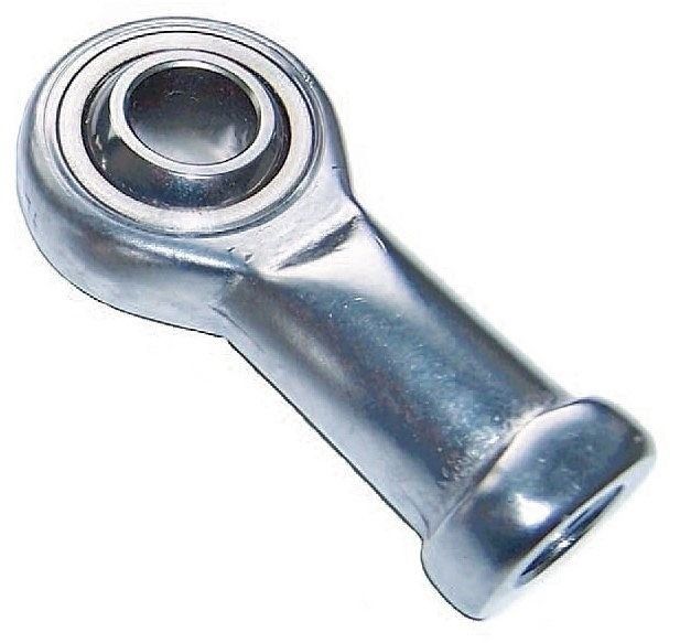

1xRANGE ROVER"CLASSIC" STEERING COLUMN UPPER JOINT/ from ebay
2x threaded rods M12 / from ebay
EMS Steering wheel 75/350 from ebay

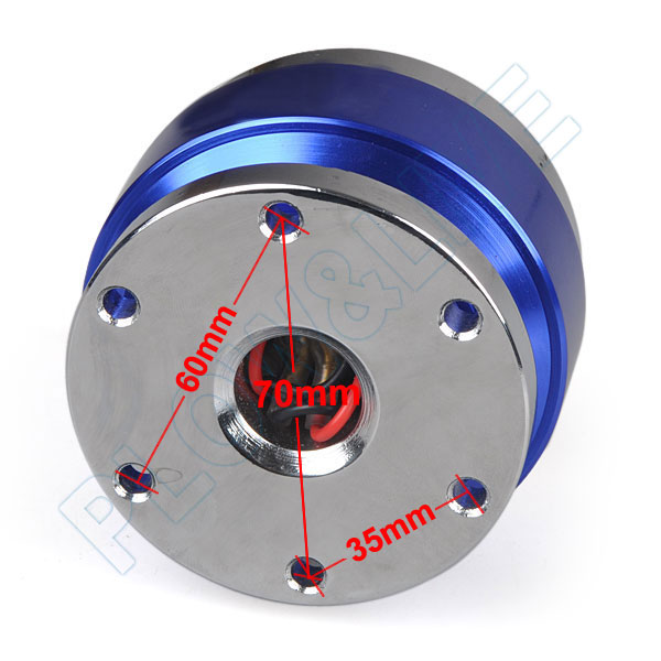

Snap Of from Ebay ( 21 euro) :mrgreen:
Excuse my bad English :!: :!: :!: :!:
......................................To be continued
4x M12

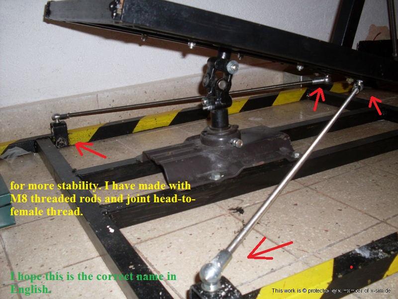

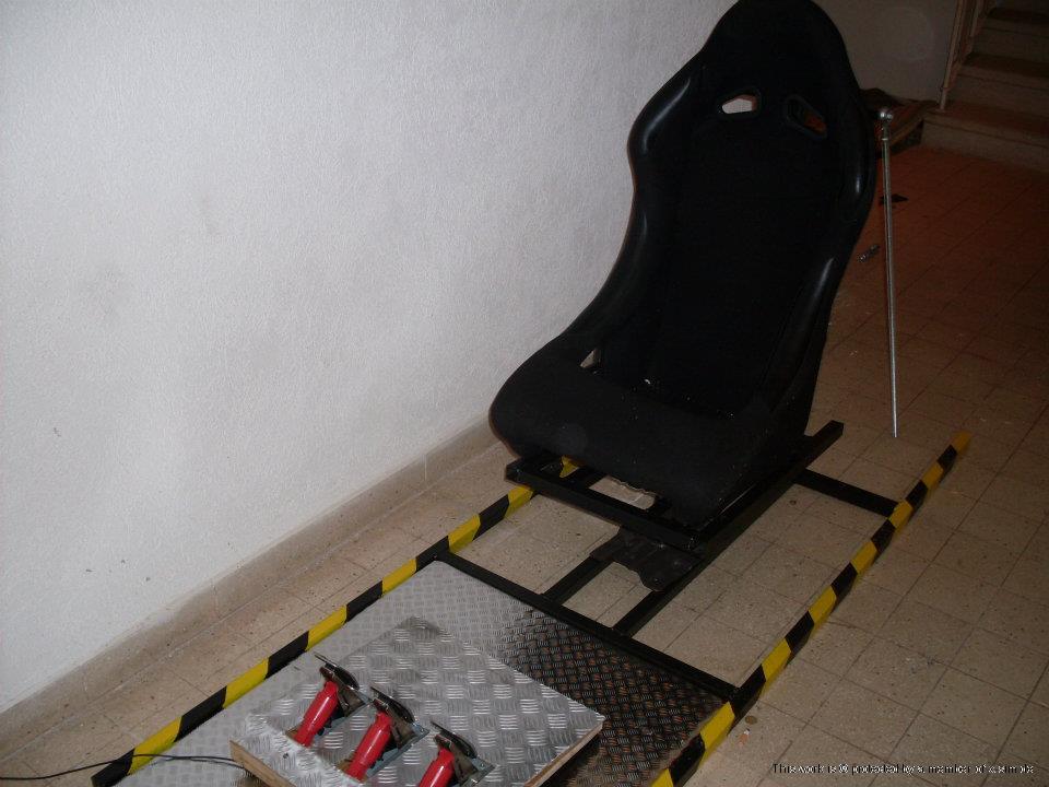

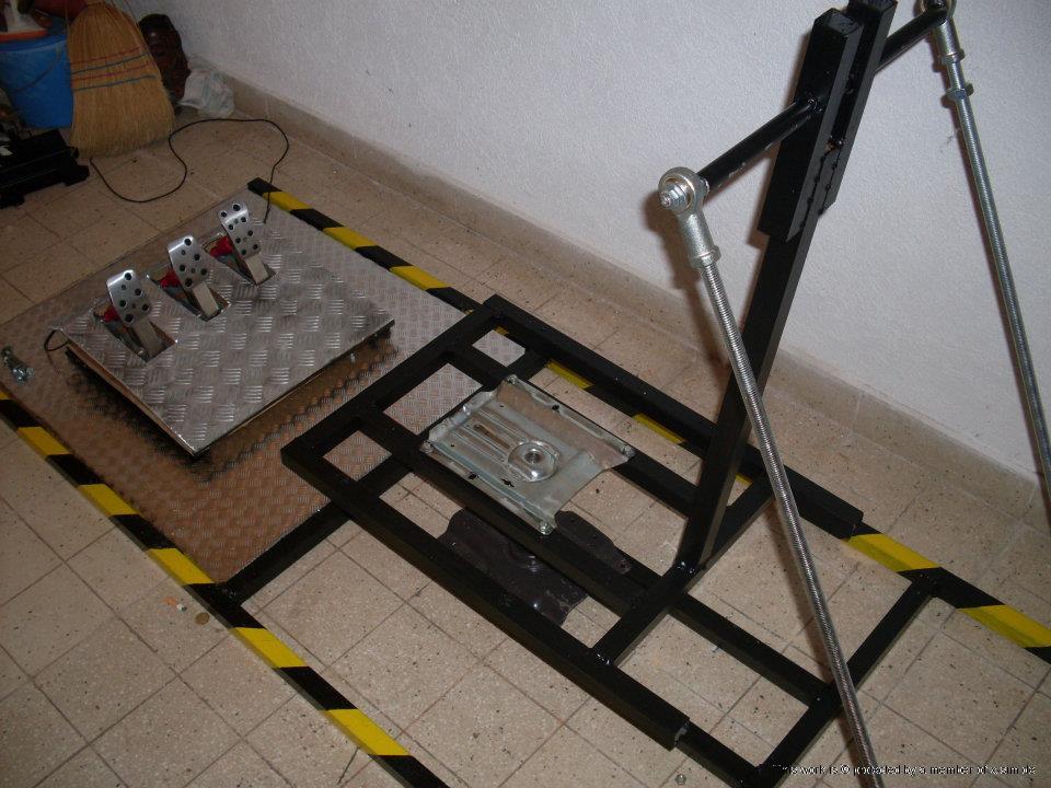

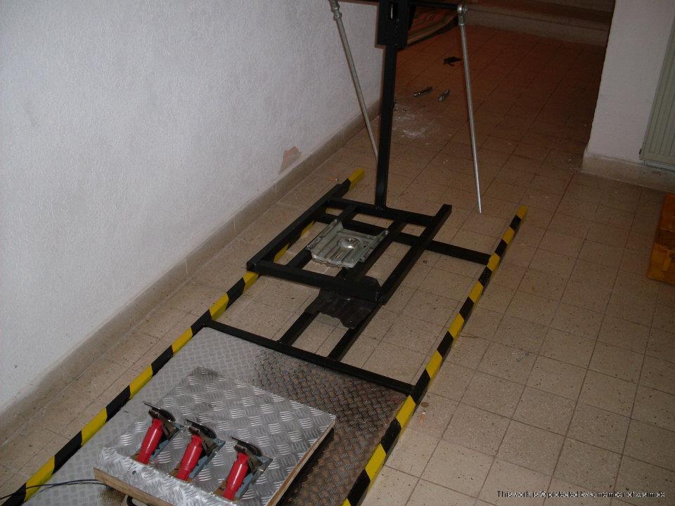

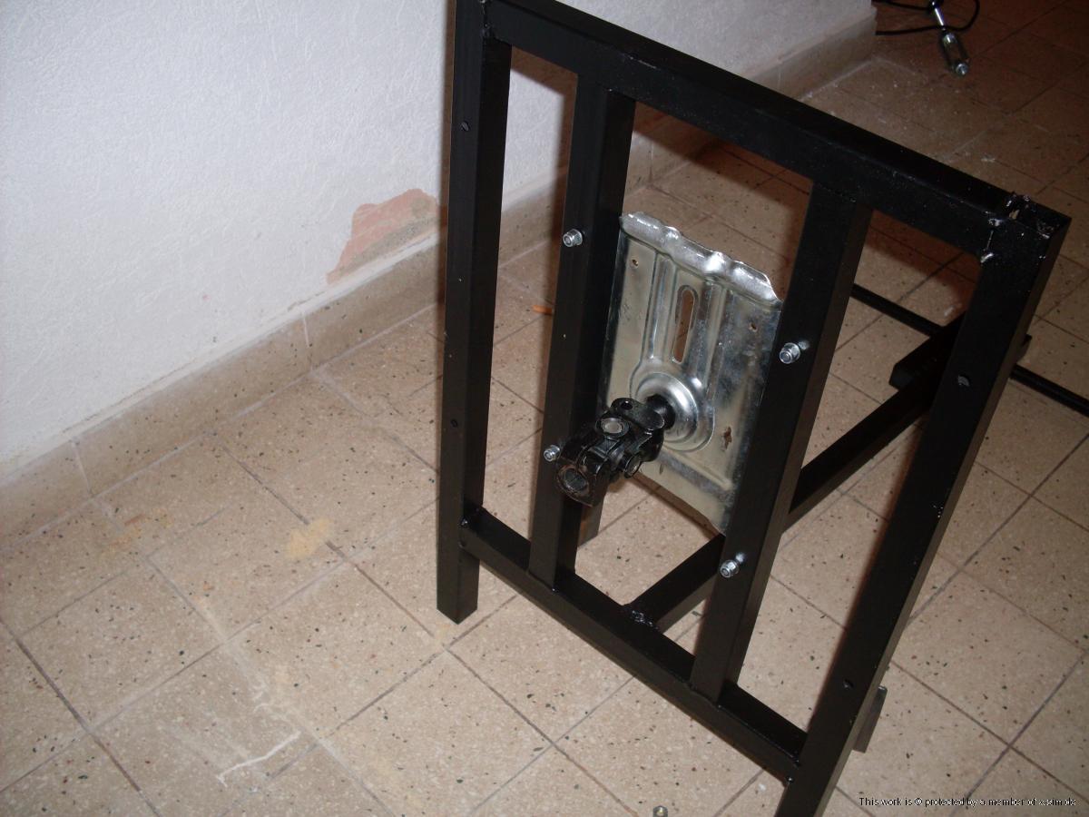

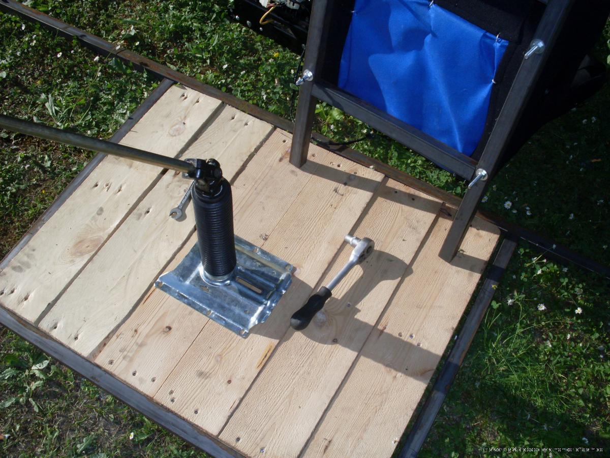

I feel a little insecure in another language to write all but I want to show you how I built my simulator. It may be that maches is not translated correctly, but I'll do my best. I hope you have fun, too, because the construction makes me think of a lot of fun ;)
2 days later I painted everything and adjusted the pedals. Pedals would be still in the course of the next few months (2013) I changed VPP hydraulic pedals :)
But later on the.
Pictures say more than many words!
934933932931935

Next, I made thoughtless about the cockpit. My failed attempts I he-spare you :)
Part List:
1 mm aluminum sheet that I've bent.
1x Rev Burner for the tachometer
2x wire tensioner M12
941944942
926

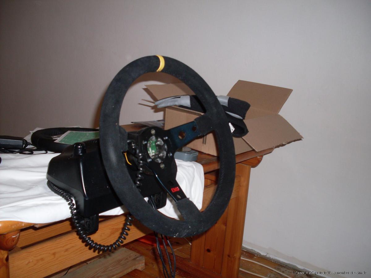

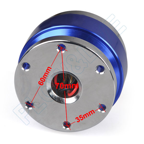

My wheel is an original Logitech G25 electronics. I ordered an EMS steering wheel on Ebay that is dished 75 to 350 cm.
Chilicoke Logitech G25/G27 Steering Wheel Adapter (Homemade) from acrylic glass.
Snap off from ebay

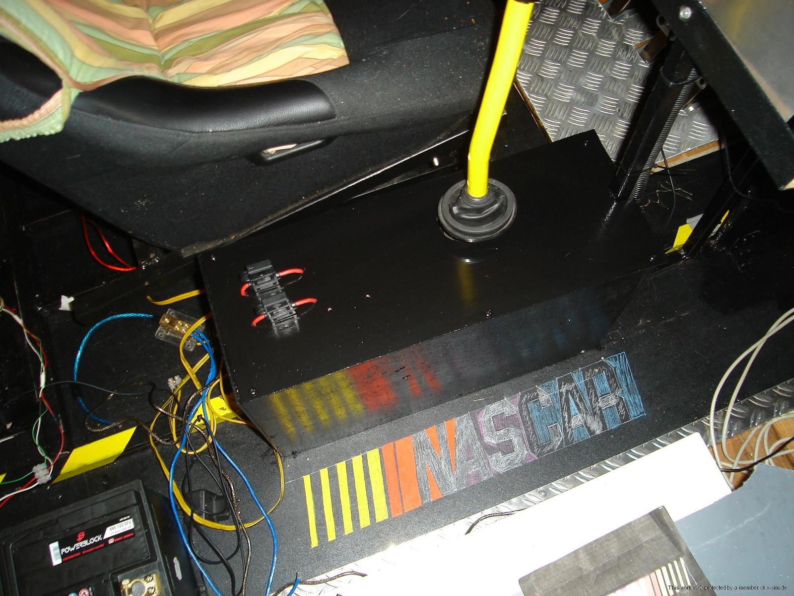

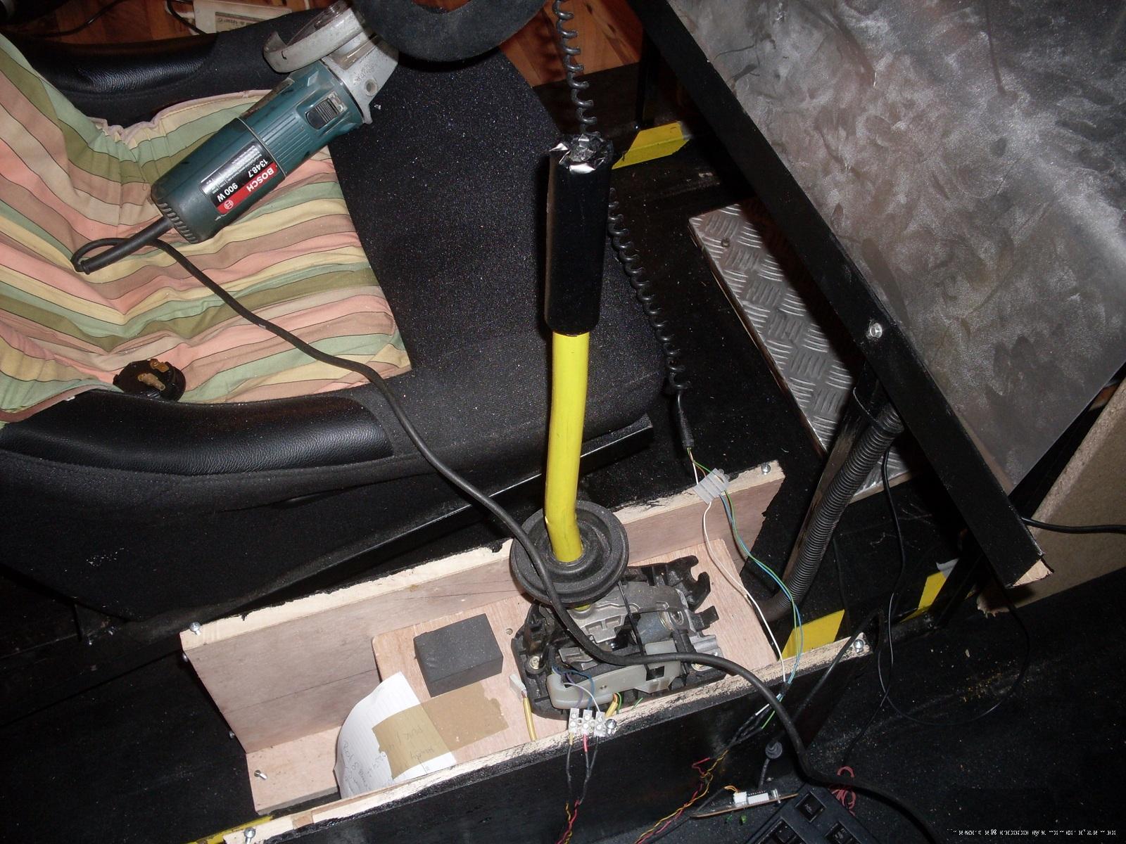

Next,..... I bought myself an E39 circuit on ebay and rebuilt. The circuit looks good as sequential. The circuit fits in the vehicle but not what I'm driving at iRacing V8 Stock Cars.
I'm going to rebuild this is still an H-Shifter then a new project for 2013 !
And the very great Nascar MOTIVE has painted me my girlfriend.
Part list:
E39 circuit
Mini Probe
Logitech board from plastic shift lol :)
958959960

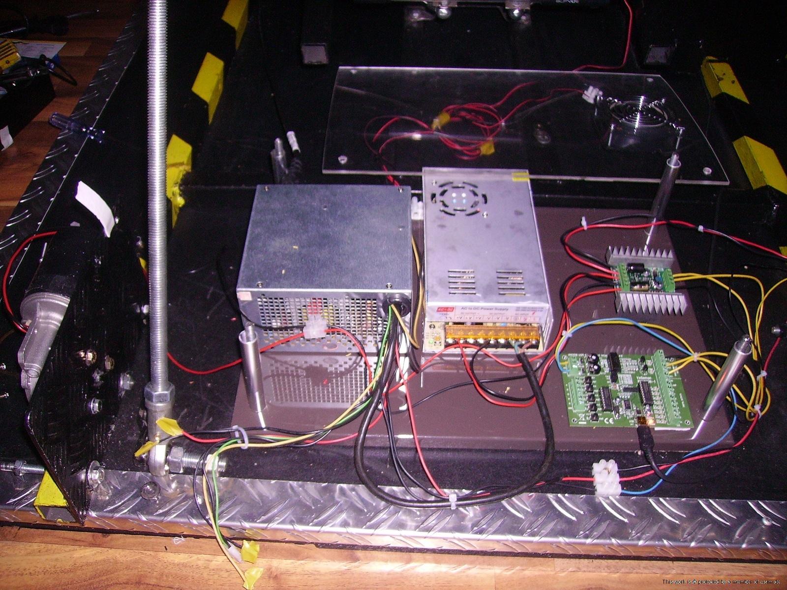

By the way I built the Dual Mosfet H-Bridge by TronicGr. Unfortunately, it's not been able to bring to pass the Avr. So I decided the project Dual Mosfet H-Bridge set, and then I switched to VM110 K8055 Vellmann and Sabertooth 2x12A.
My electronics is exactly the same as from Kevin 123 :!: here at X-sim.de Forum !
Many thanks to kevin123 and X-sim.de!
962963

I also wanted a simulator but should not cost much. So I tried to build the whole project itself.
My AVR • Motion Controller (AMC) by Tronicgr worked great .. makes me the biggest problems • Dual Mosfet H-bridge by Tronicgr. I built the H-bridge 2x and they burned my back when I'm connected through for 2 motor 12v (Isolated).
I simply had no desire to continue to build more so I looked for a new project where I do not have more soldering.
Who my English is not so bad it could be that I would have needed to run dual MOSFET H-bridge.
I then read the X-sim forum of the Vellmann and built everything on it is not a high-end sim and should not be, because for me it's all about fun for the build.
The next video I make the times the engines looks better: I am happy with my homemade simulator! My Sim is Homemade, software is runing Pefekt :D :D
Thanks X-sim
Ps: you can see (6:00 min) my AVR and H-bridge !! but is not working on 12 v Motors : :cry:

Re: K8055+Sabertooth 2x12@ tom
Postby tommy6 » Wed 2. Jan 2013, 14:44
My Vellman and K8055+Sabertooth 2x12 is runnig :)
Not perfect but with 2 x 12 volt motors I have fun with it :)
