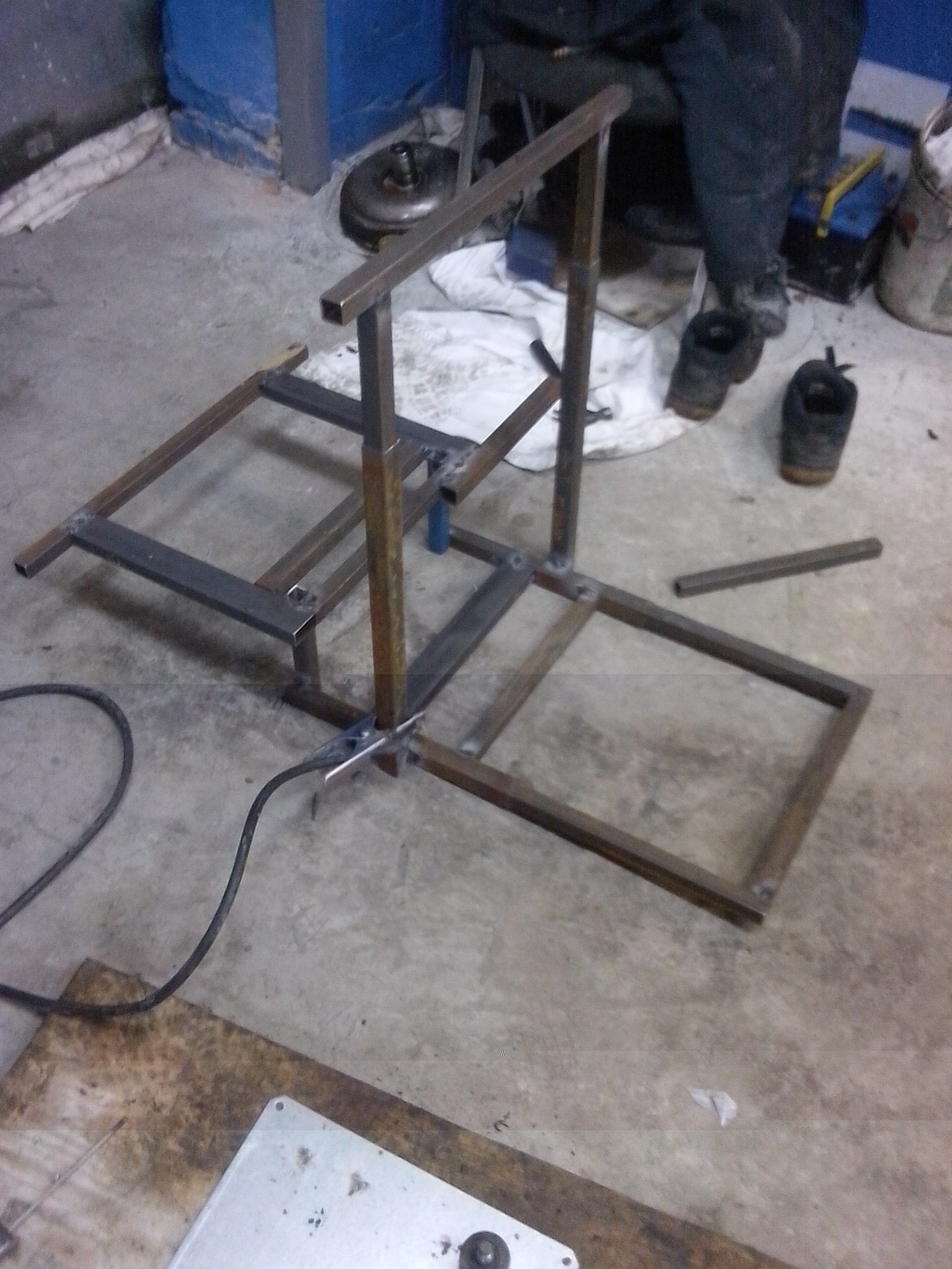

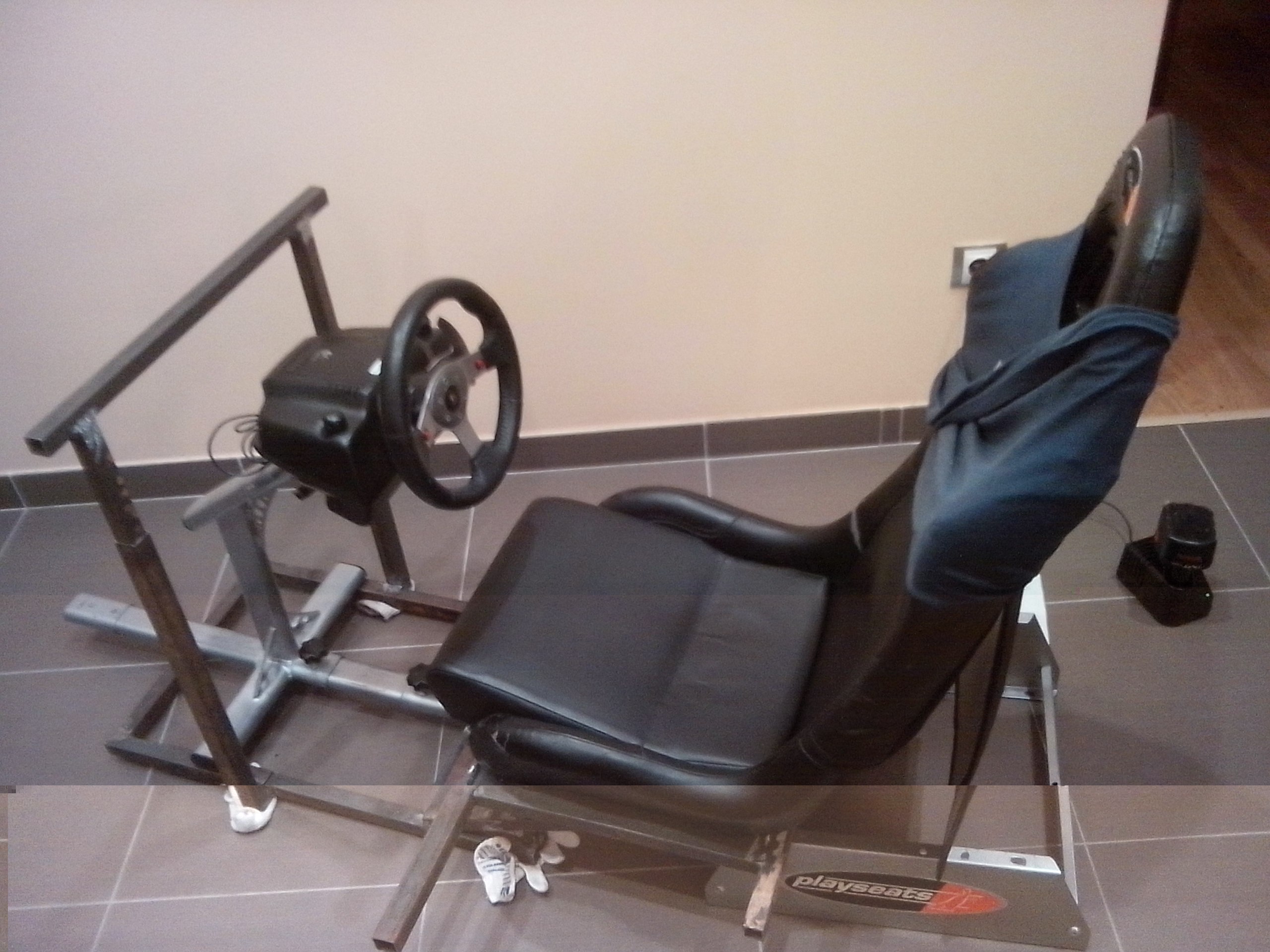

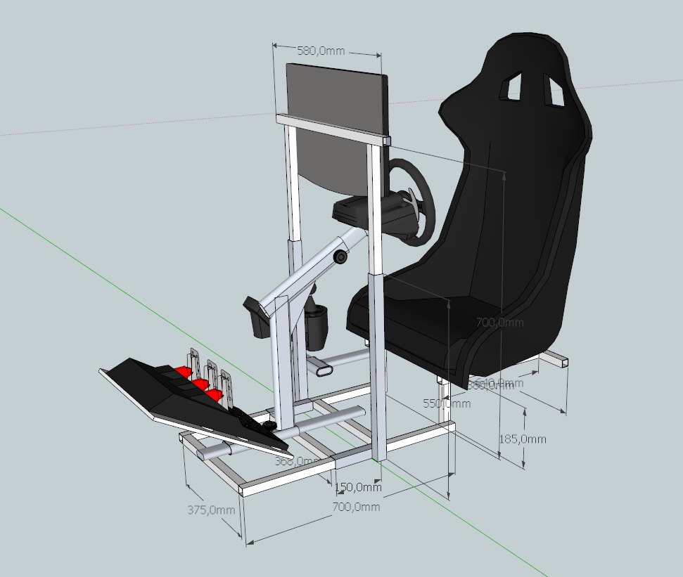

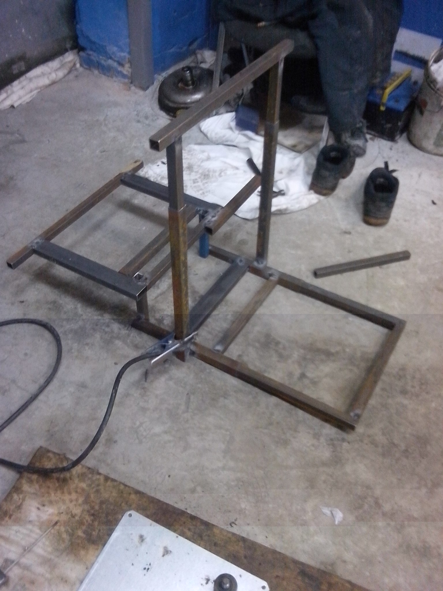

So, I'm in the process of building my sim. I got inspiration from Floriske's and dearn's desings.
I'll be using famous pololu's JRKs. For now, i'm planning to use wiper motors, and then switch to something like wormgear motors. Only problem is that shipping cost of those nice motors from motion dynamics - is higher than the cost of two motors )). Oh, yes, i'm from Russia.
Here is basic blueprint and photos
It wasn't final though. I made some changes, when welding.

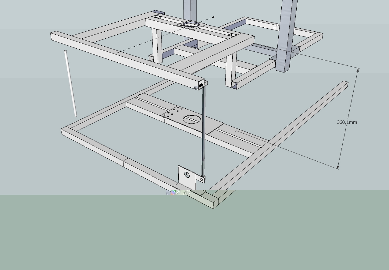

okay, another day in sketchup )
you can see the drive shaft mounting platforms, and mount of the motor and lever arm.
