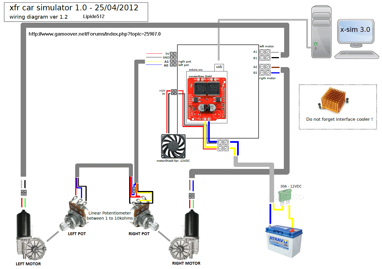

Hi. I am building a 2 DOF simulator. Why do potentiometers have more travel to one side than to the other side? I have the potentiometers in the center, so the motors are stopped up to here everything correct. From the center if I turn the potentiometer counterclockwise it goes towards 0Kom, the motor turns but it stops very fast because I have very little travel on the potentiometer but if from the center of the potentiometer I turn it in favor of the needles The clock goes towards 10kom, the motor turns and faster and faster.
I show a video. As seen in the video, to the left the potentiometer has very little travel and stops very quickly and to the right it has more travel and increases speed. Does anyone know the reason?
Electric connections:
Arduino Uno and MotorShield
......GND <-> GND pin
........5V <-> 5V
.....pin 4 <-> pin 4
.....pin 5 <-> pin 5
.....pin 6 <-> pin 6
.....pin 7 <-> pin 7
.....pin 8 <-> pin 8
.....pin 9 <-> pin 9
Arduino and Motomonster stacked.JPG (12.7 KiB) Viewed 139848 times
cabling
Potenciometros
Can someone help me please

Re: 2DOF Arduino Uno - MotorShield - 2 motor
Postby DangerouS » Thu 2. Jul 2020, 22:59
What code have you used to program the arduino?
Postby flotis » Fri 3. Jul 2020, 15:23
I copied it from the following link: https://www.x-sim.de/forum/viewtopic.php?f=36&t=1617
The code used is the following:
Postby pablobass » Fri 17. Jul 2020, 03:05
Hi,
Could it be anything to do with the potentiometers you are using ( logarithmic or Linear)?
Postby flotis » Fri 17. Jul 2020, 14:09
Hi, The Potentiometers are linear 10k. any other idea?. thank you.
Postby pablobass » Sat 18. Jul 2020, 03:44
Hi,
I'm not sure if this is the issue but this is how I read this part of the code.. abs calculates the absolute value and gap is the current position of the motor as defined by the potentiometer. The code below calculates if the gap tolerance is close enough to stop the motor moving. if not it moves the motor to bring the gap within this tolerance. I am unsure why the code specifies the speed of the output should be different depending on how far the motor is from the target position. As for the potentiometer appearing unbalanced (Small movement one way making the motor turn slowly but a larger turn and a faster response) it does seem to be displaying the characteristics of a logarithmic potentiometer. If you have a test meter it might be worth checking in case they are faulty.

Postby flotis » Tue 21. Jul 2020, 00:23
Hello, thank you very much for your answers. I have checked the potentiometers and I have tried other potentiometers and the same is still happening. I just don't understand what the problem is. I don't know what direction to take to solve the problem.
Postby pablobass » Wed 22. Jul 2020, 14:22
Have you tried taking the potentiometers out of the circuit and supplying the switching 0v (gnd) and 5v manually to the Arduino anologue pins to see if this is still happening? (of course a direct Gnd or 5v will have the effect of telling the motors to run a full speed so caution is advised here). Have the motors got a circuit board attached or are they directly wired (if they have a circuit board this may be causing the issue). You could of course try a different sketch and see if the problem still exists...
