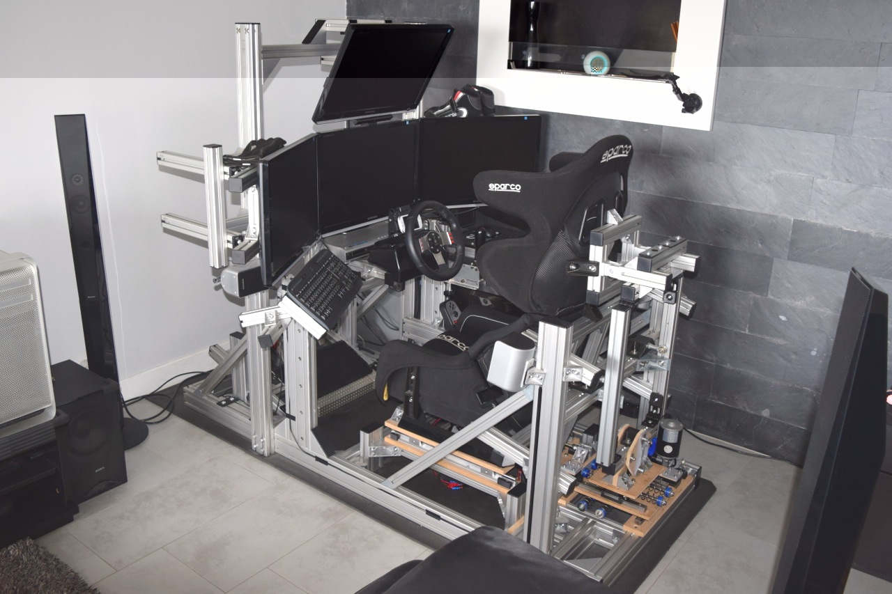

Postby TomKlash » Sun 10. May 2020, 16:54

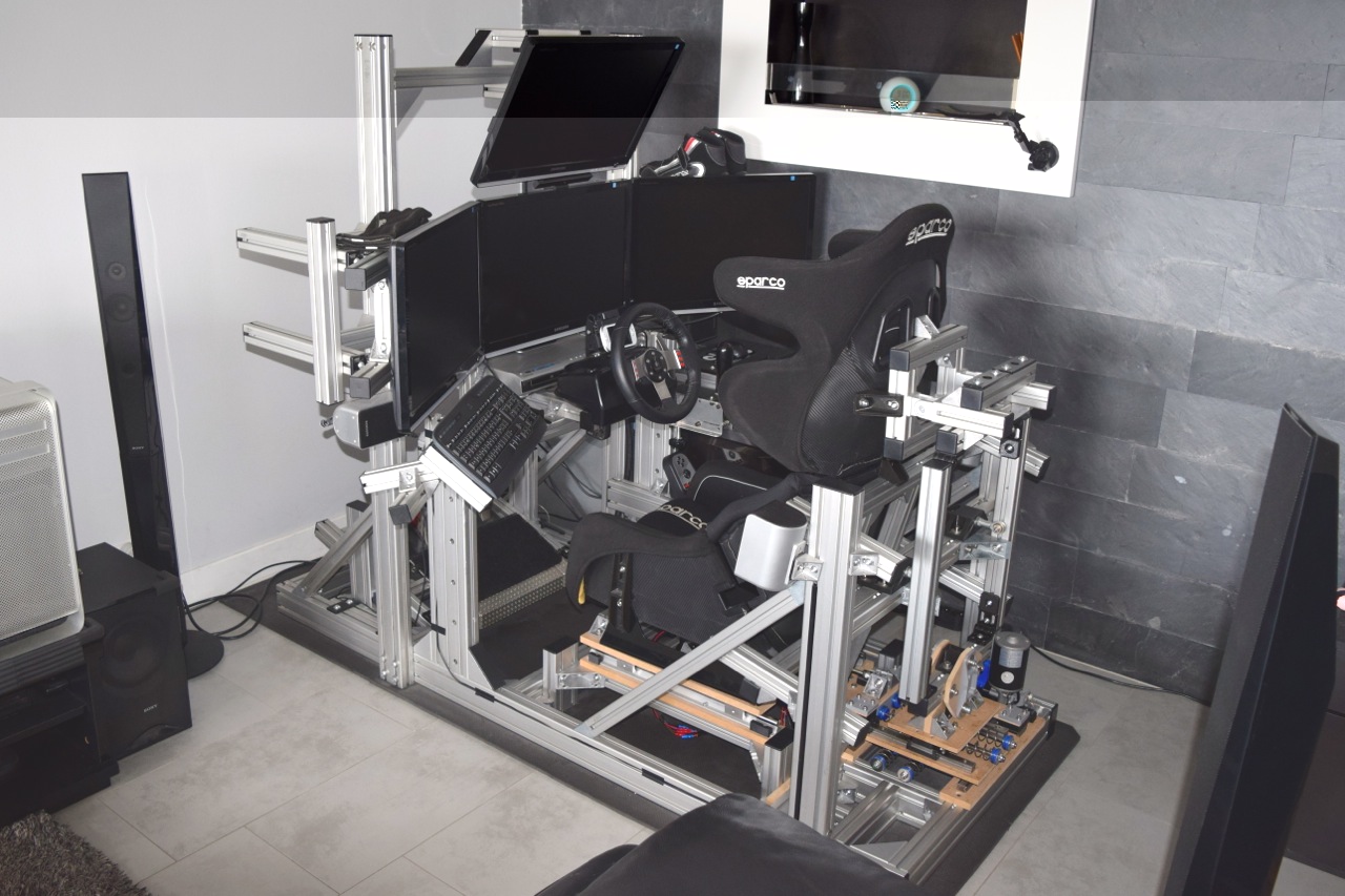

Hi,
I present my DIY G-Seat simulator.
It based on G-Seat system. The purpose is to generate G-force on pilote with almost no movement.
The bucket seat is slice in 3 parts. The backrest is a the only fixed part, seat and the top of the seat (behind the shoulder) are mobile parts.
Bottom of seat transcribe longitudinal G-force, top of the seat combine longitudinal/lateral G-force.
The system is actuated by 3 DC motors of 150 W. The electronic part is composed by Aduino Uno with 3 H-bridges (MotoMonsterShield).

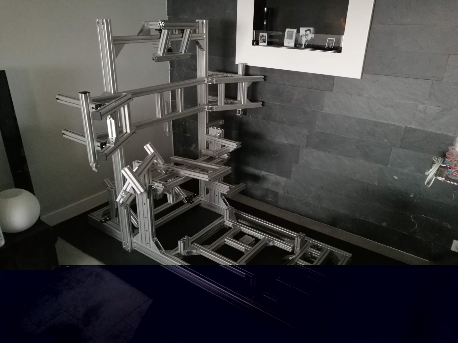

Postby TomKlash » Sat 16. May 2020, 16:12
To begin a CAD study

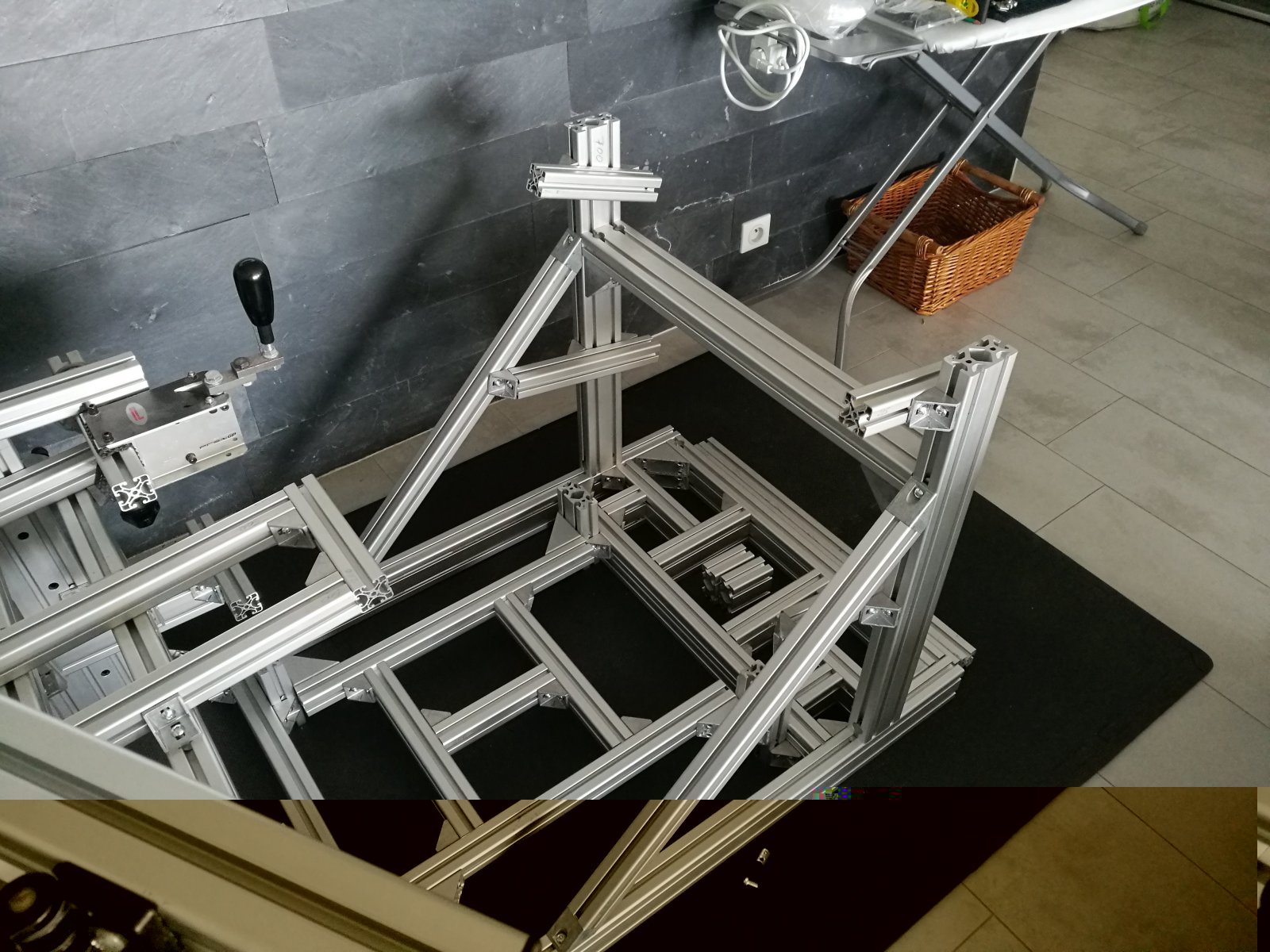

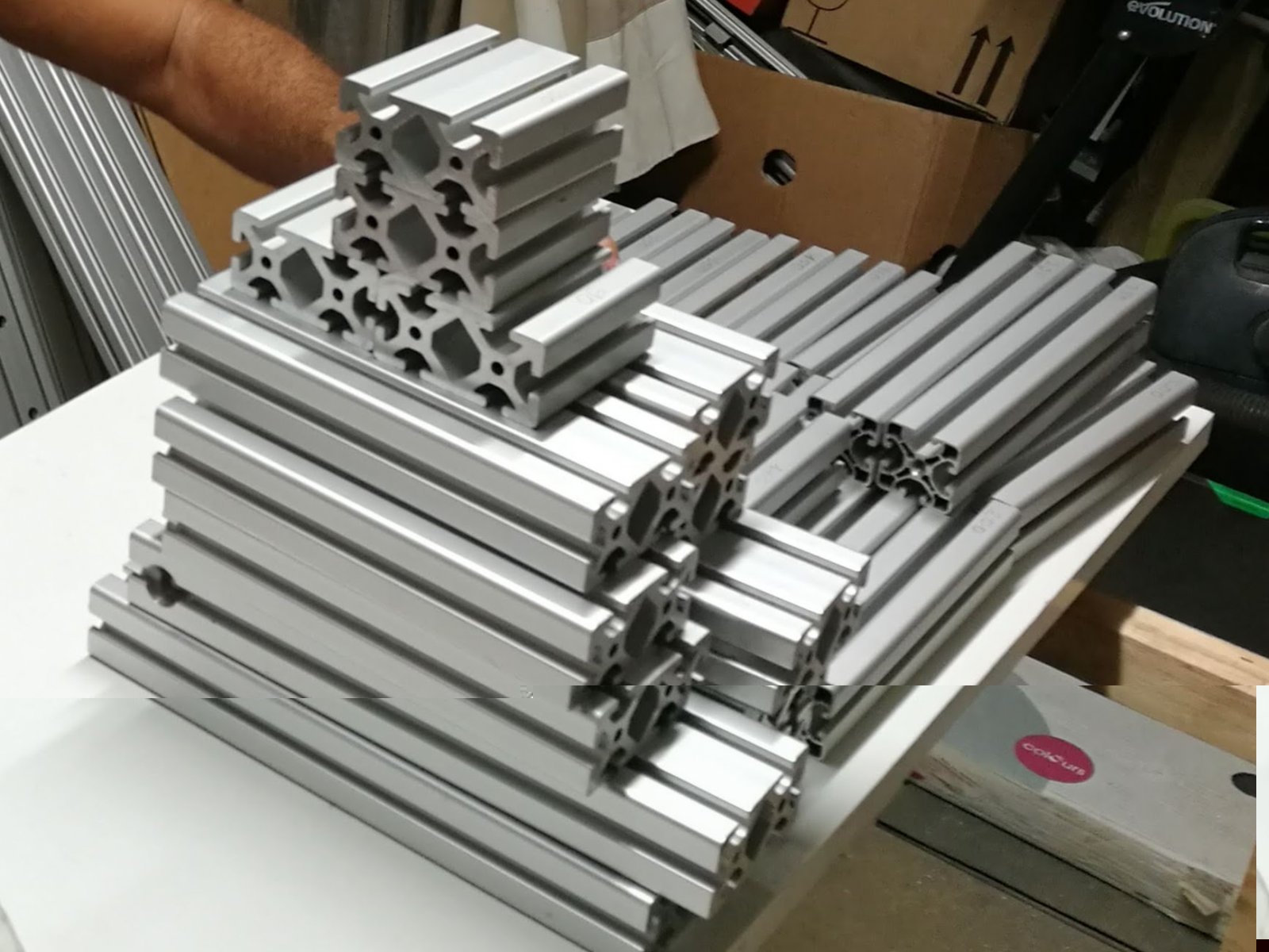

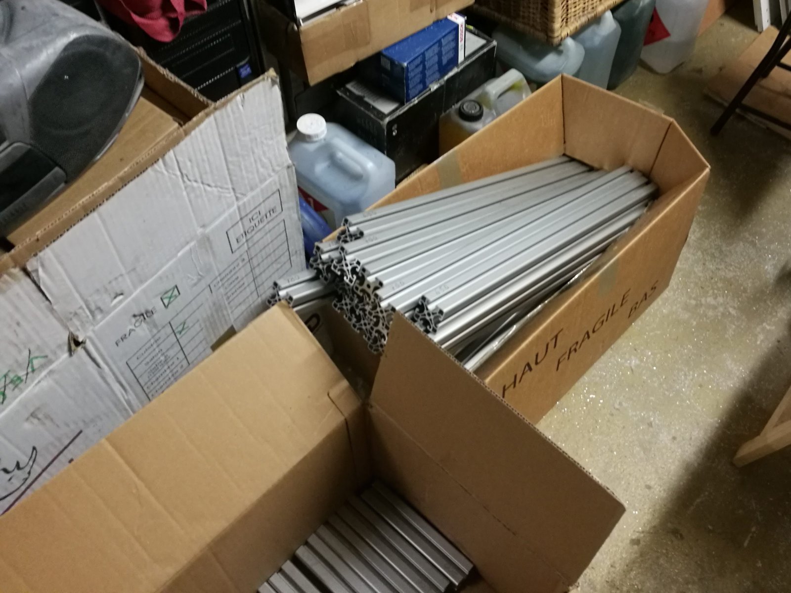

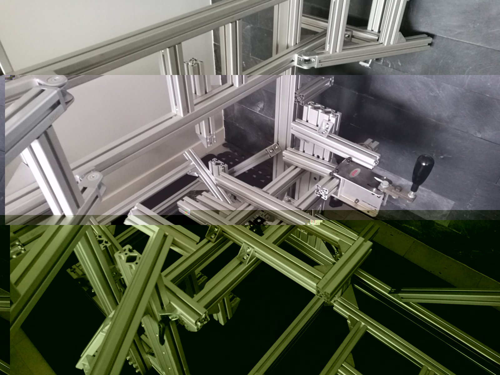

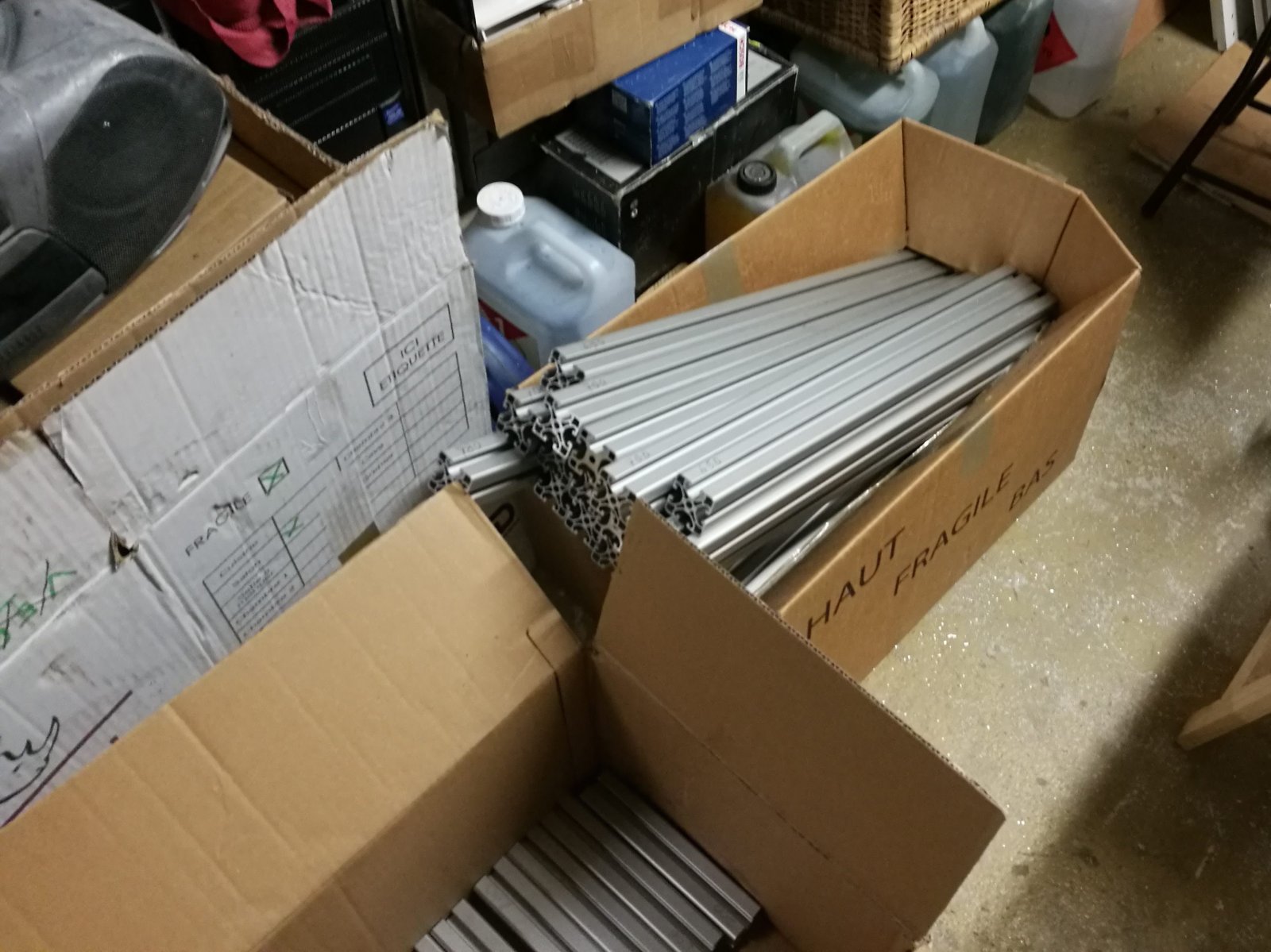

Re: DIY - G-Seat TK simulator

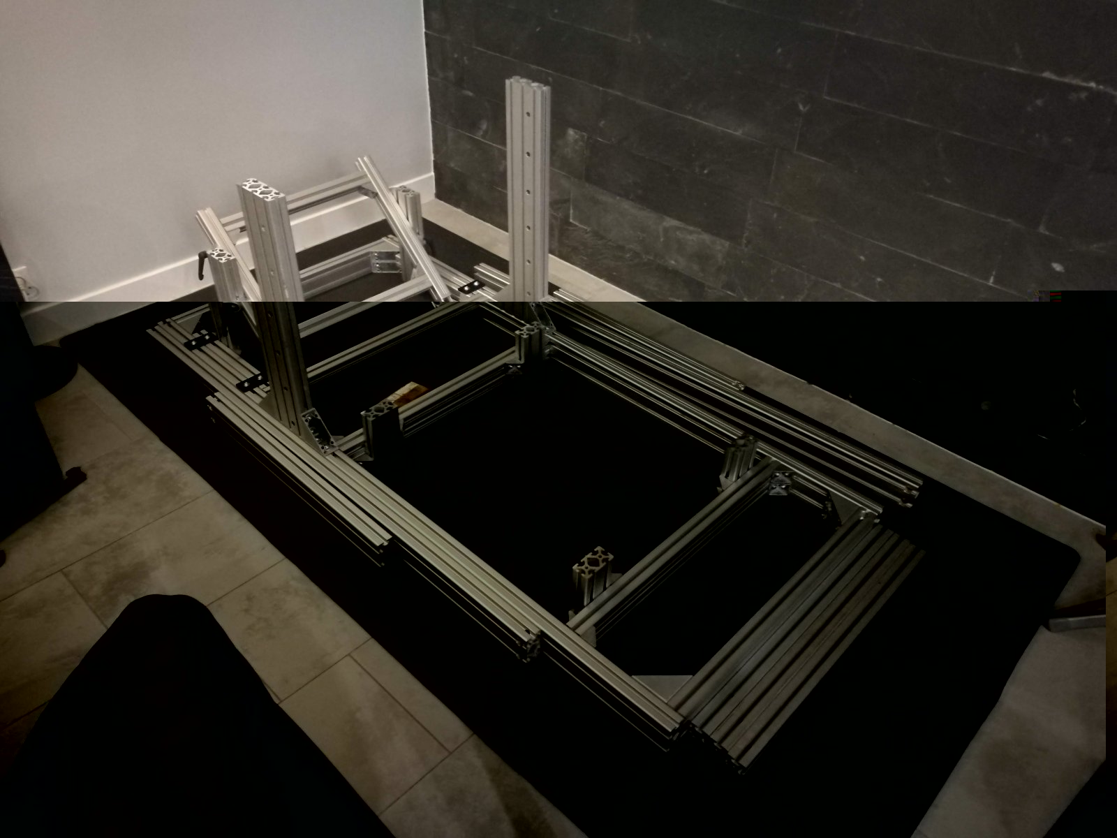

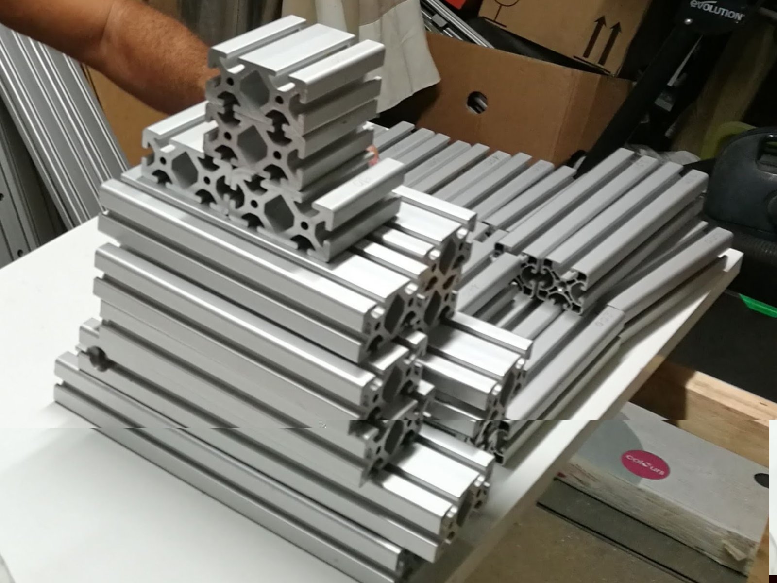

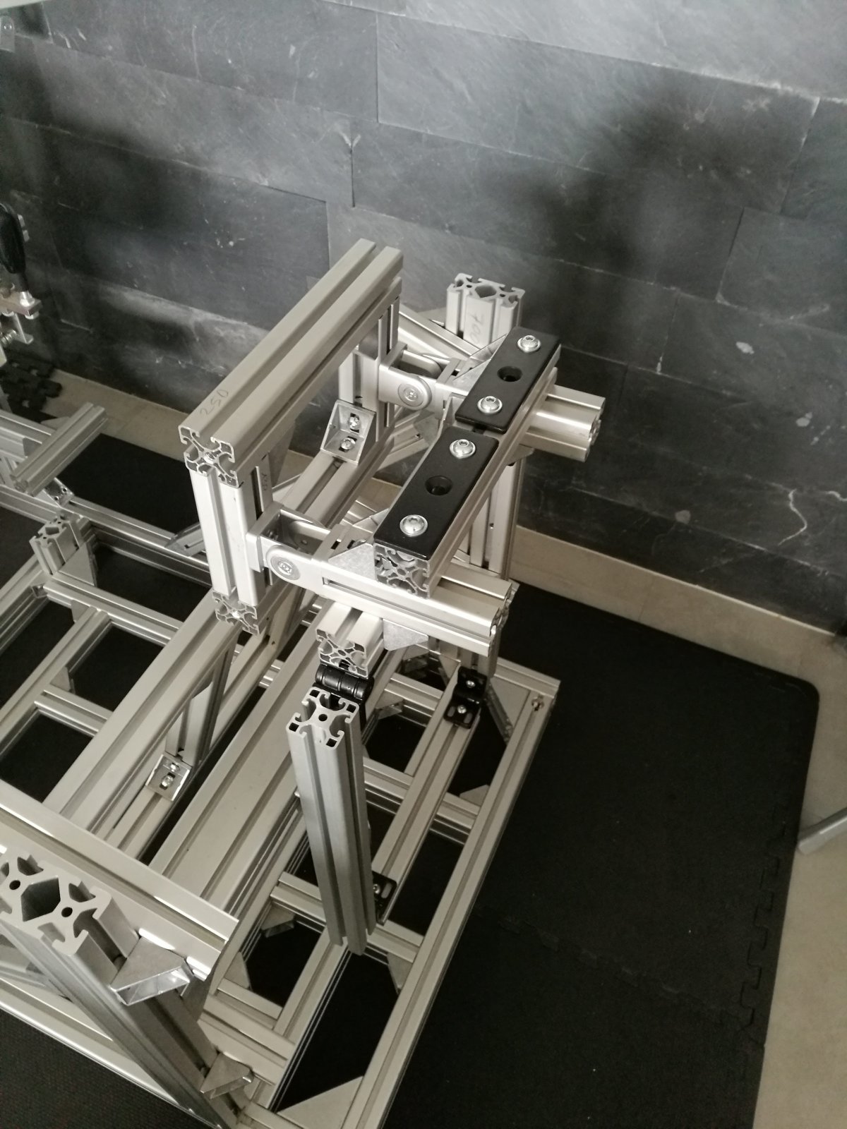

Postby TomKlash » Sat 16. May 2020, 16:17
Fabrication starting...

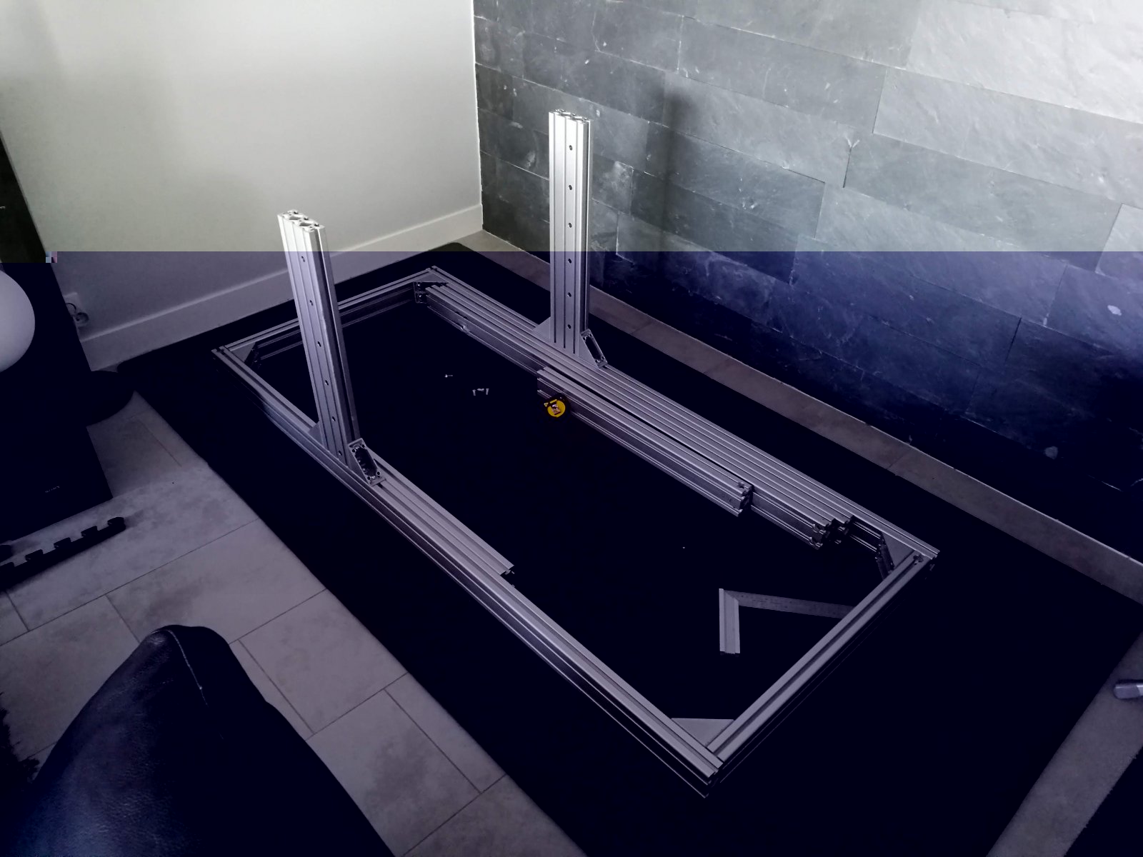

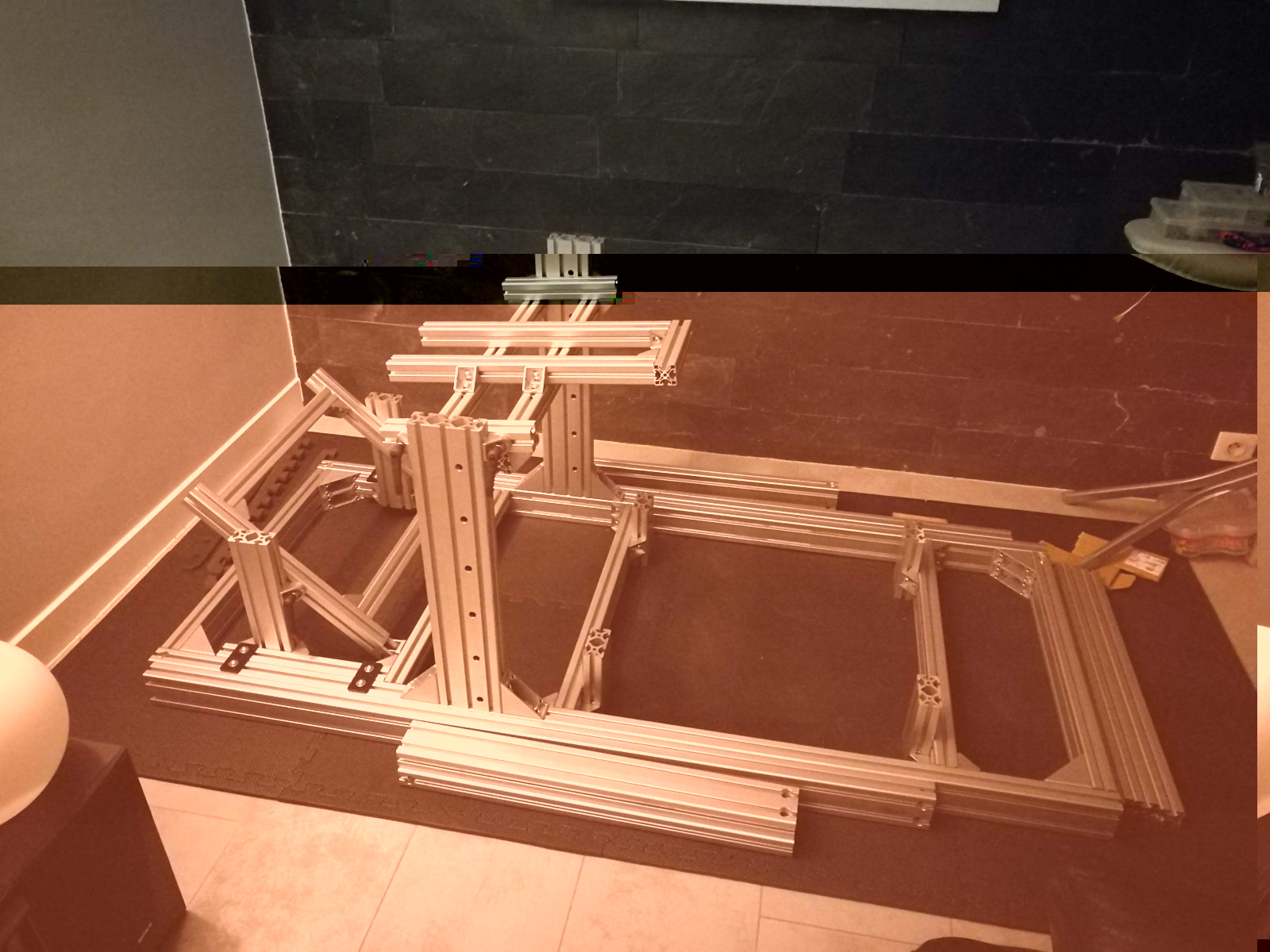

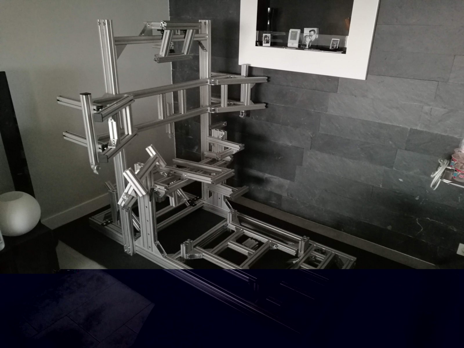

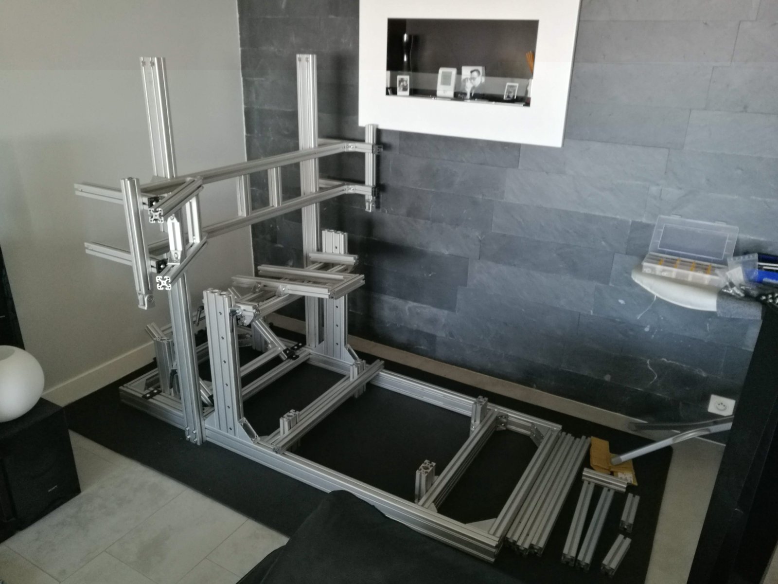

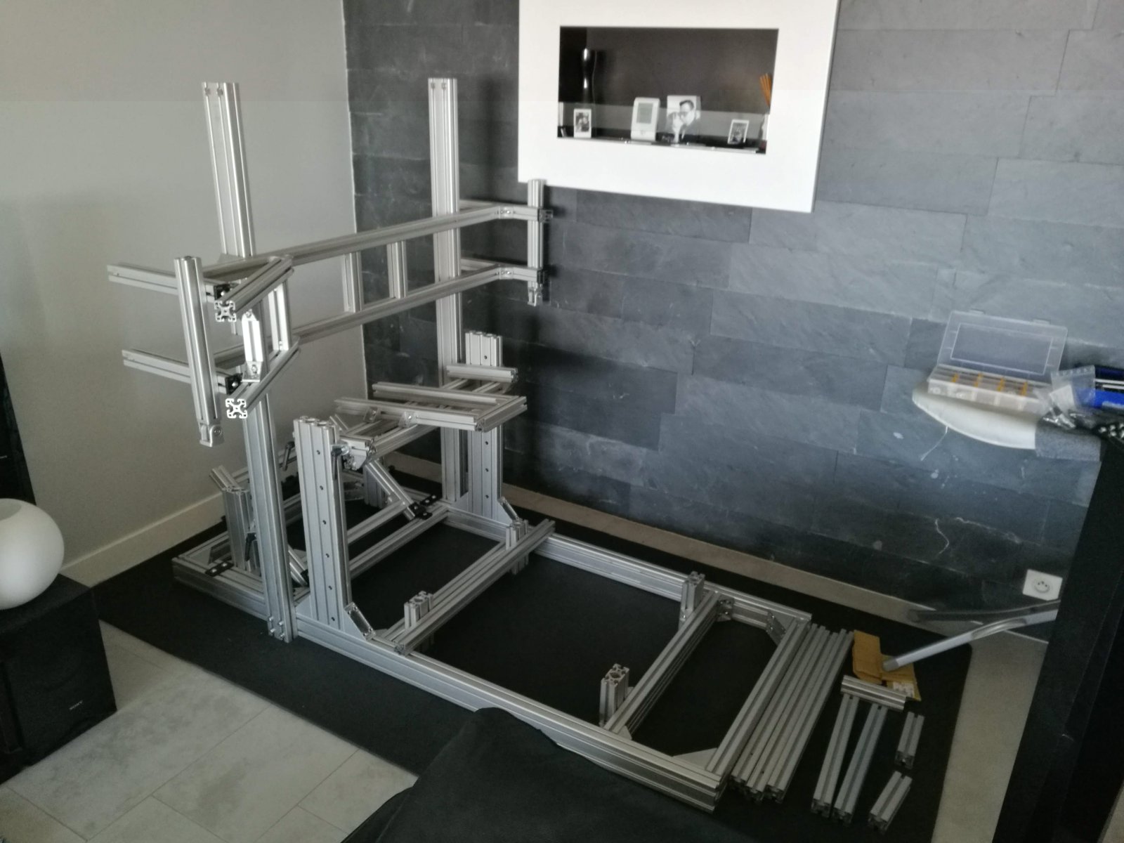

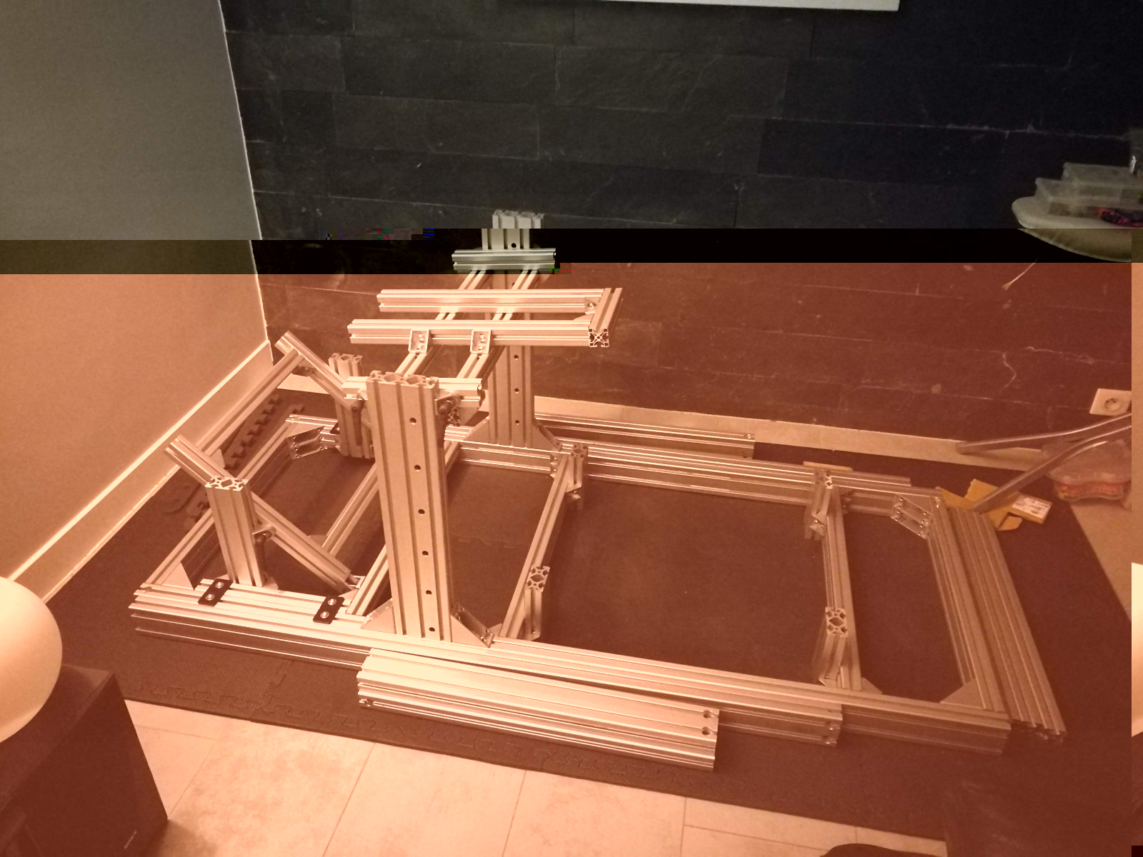

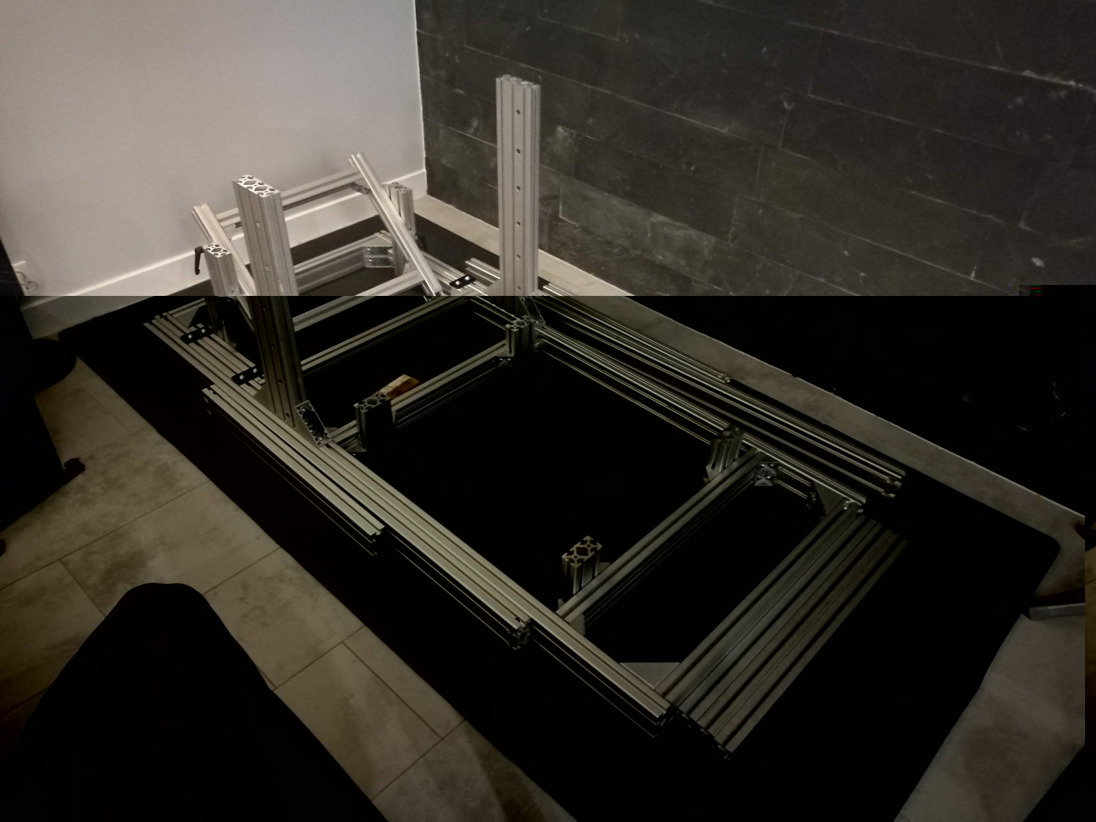

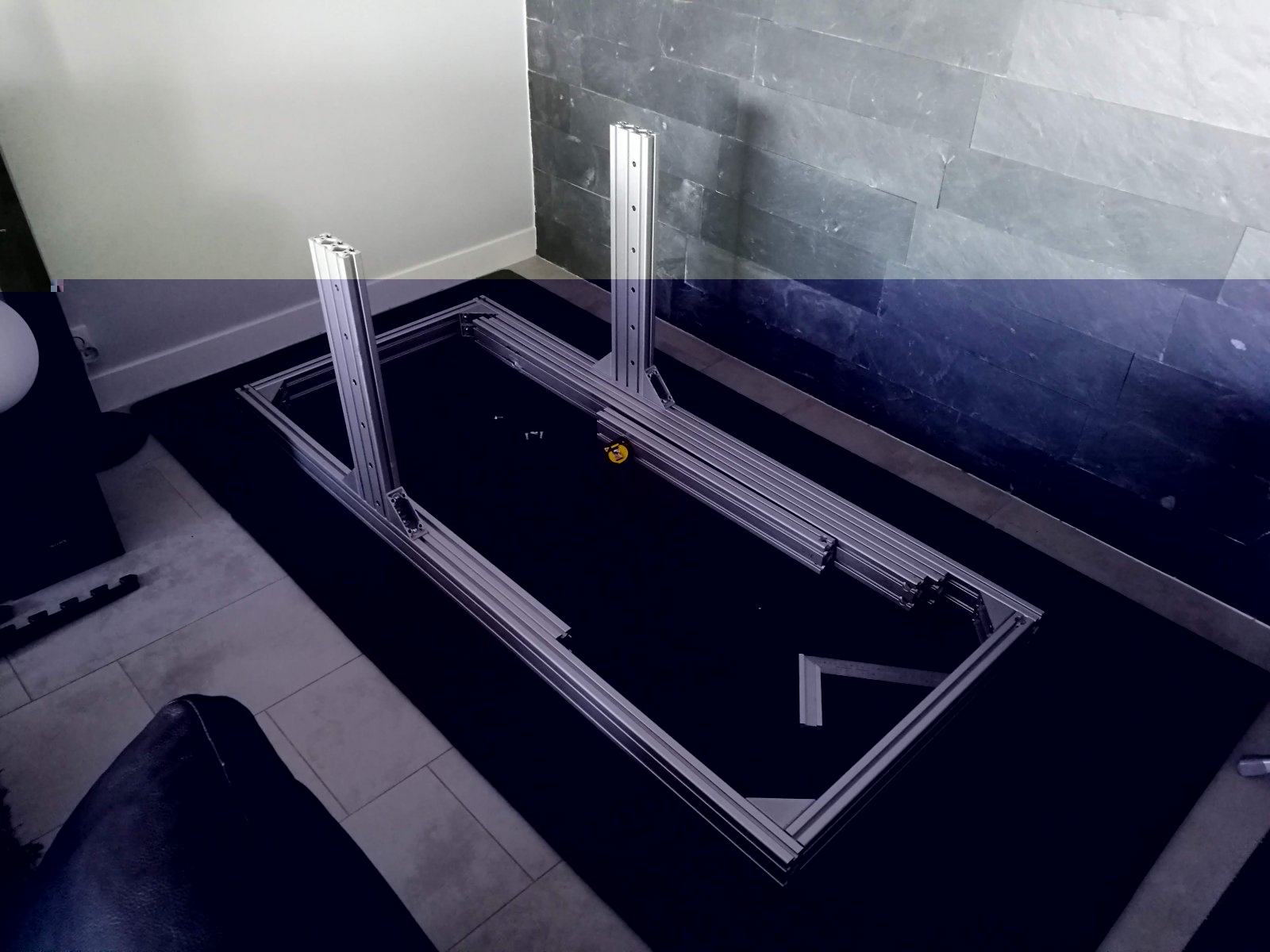

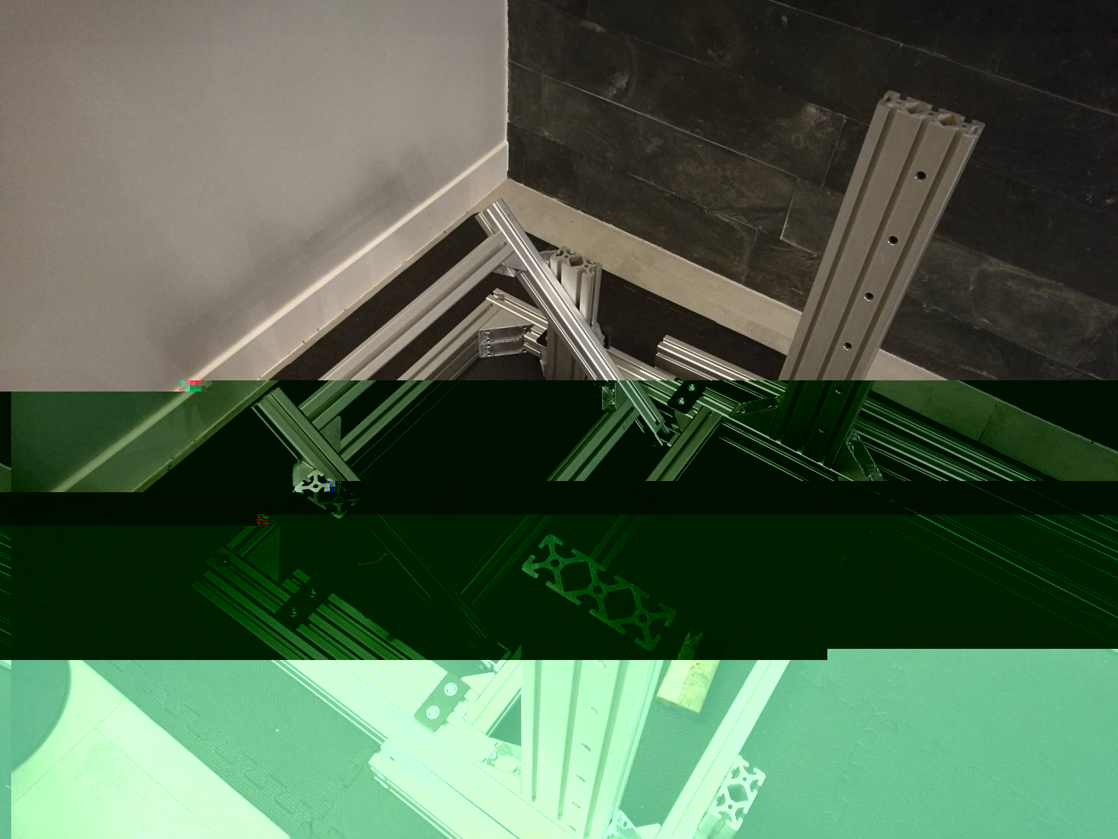

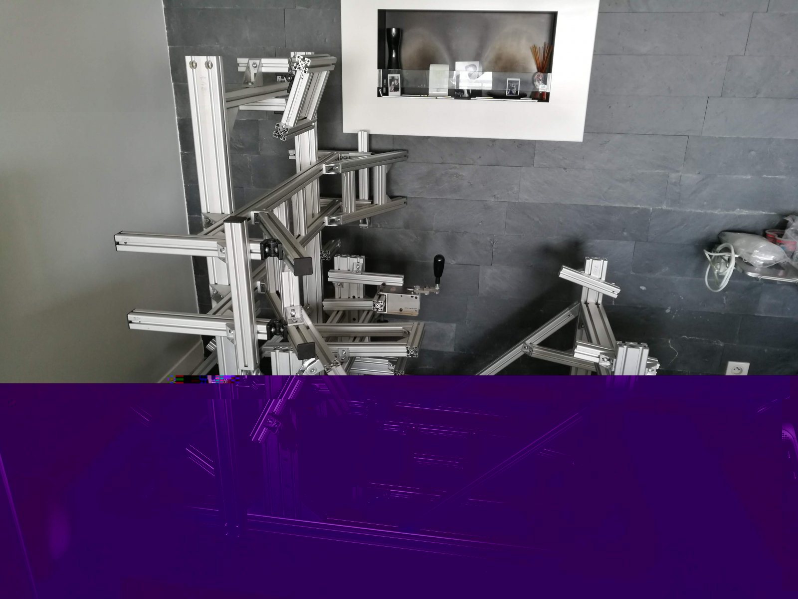

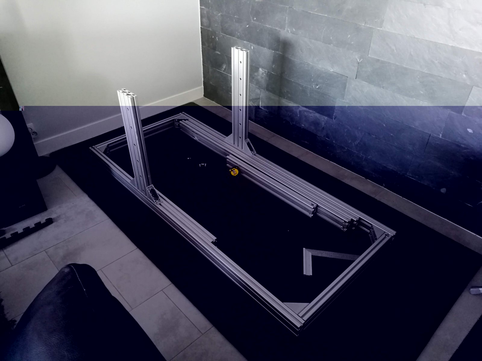

Postby TomKlash » Sat 16. May 2020, 16:31
The beginning of mounting...

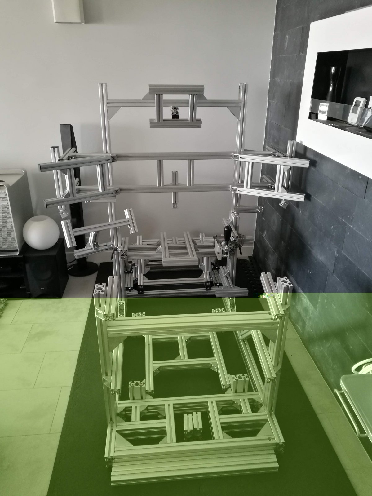

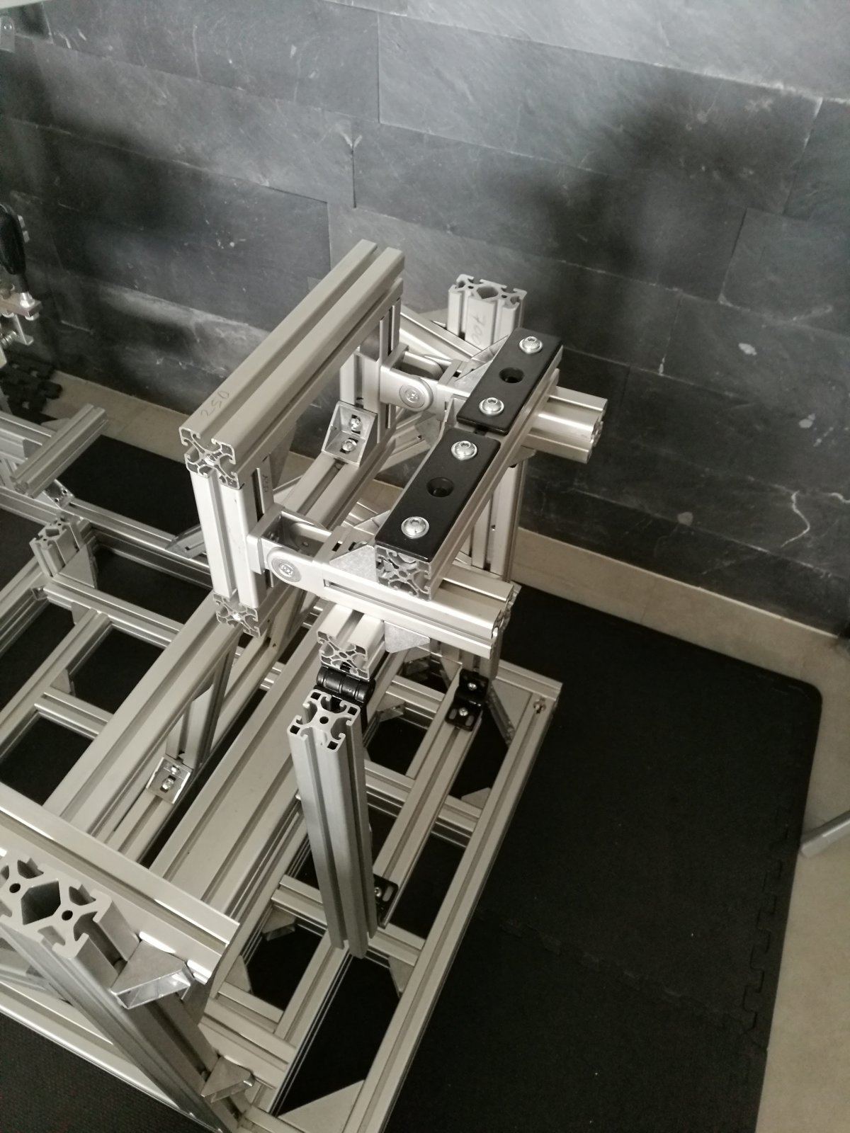

Postby TomKlash » Sun 17. May 2020, 17:12

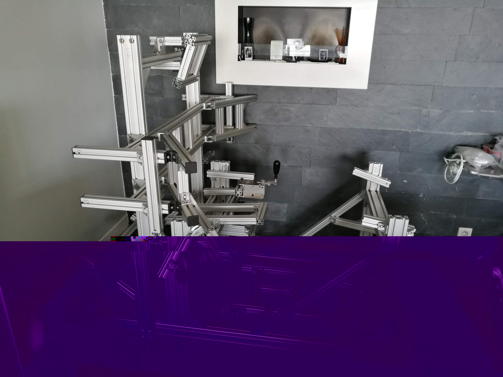

Postby TomKlash » Sun 17. May 2020, 17:19

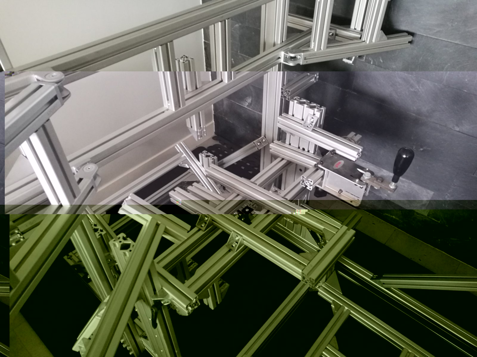

Postby TomKlash » Sun 17. May 2020, 17:52
