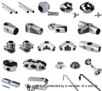

I have started to look around internet and found the solution called Joker / Uno
So basically it is 25 or 32 mm steel tube with set of different connectors:
385

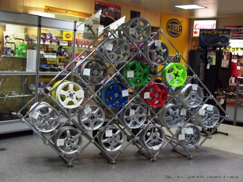

You can build quite impressive things with it for commercial or advertising purposes.
For example:
386

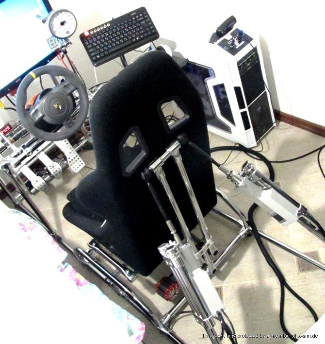

Now it is time to show how finished sim cockpit looks like:
387

This project had started originally as stationary sim rig. But due to modular and easily upgradable design I went to the next stage.

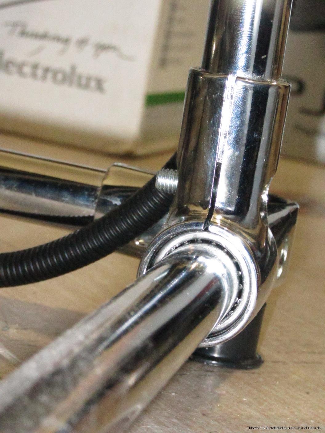

1. I’ve built the pivot myself. Check the video below:
I used needle bearing to make rotation as smooth as possible. Dimensions are ID = 25 mm, OD= 32 mm.
You can use 25 mm steel tube as axis and 32 connector as bearing housing. See picture bellow:
380

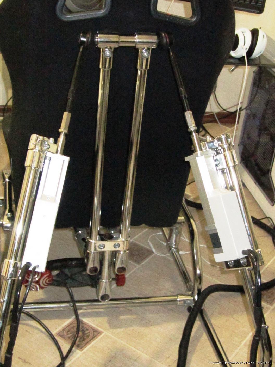

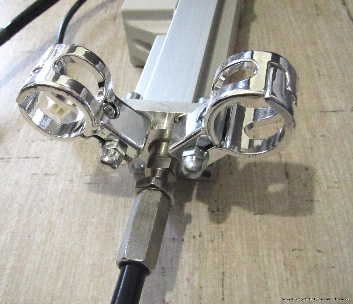

2. Next, I went to SCN5 mounting
I have used:

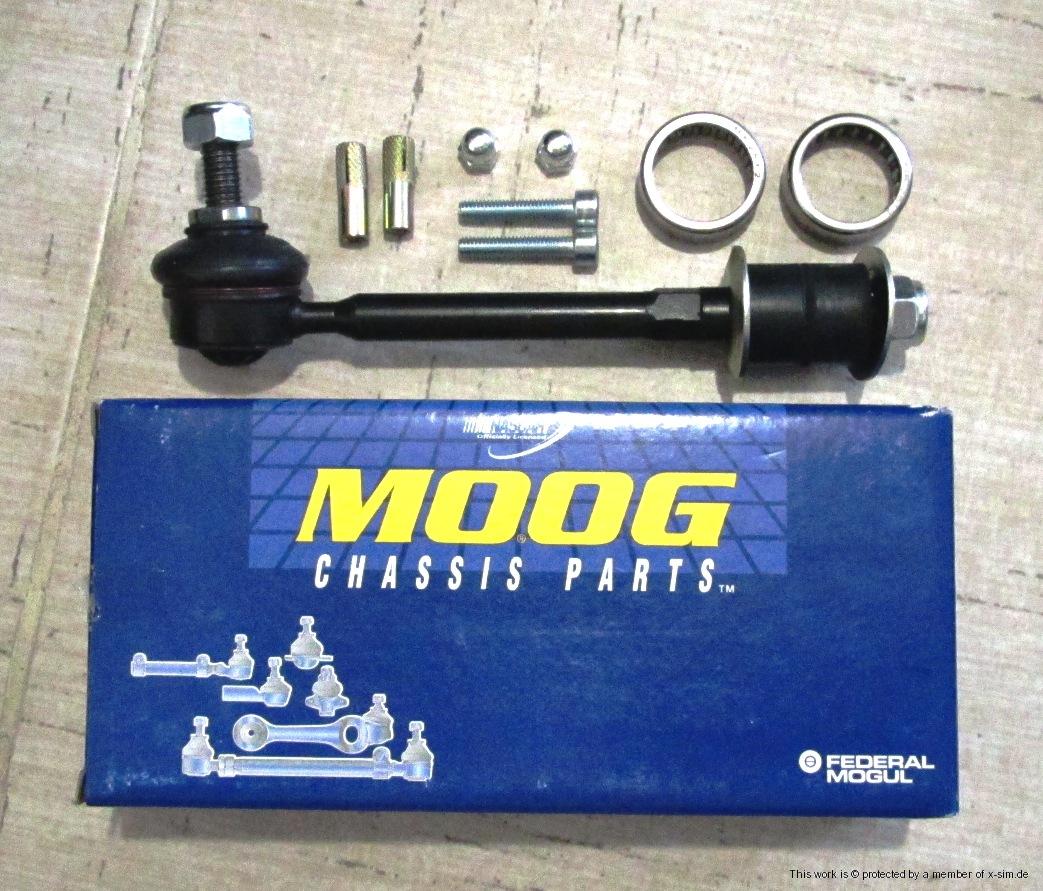

Auto stabilizer linkages + some bearings
383
Few connectors
382

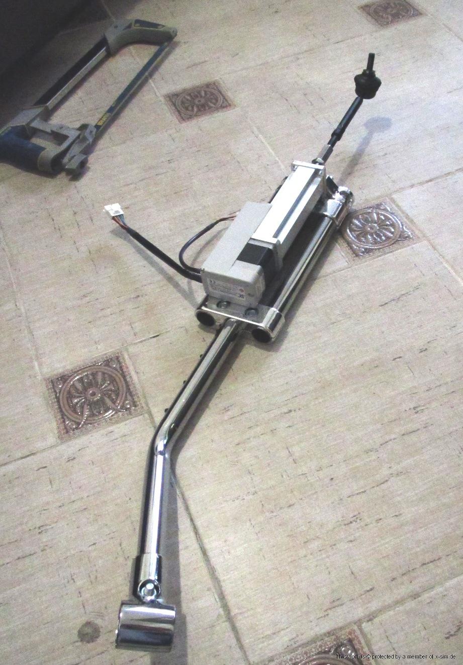

Bended 60 deg pipe
384
Final result is
381
