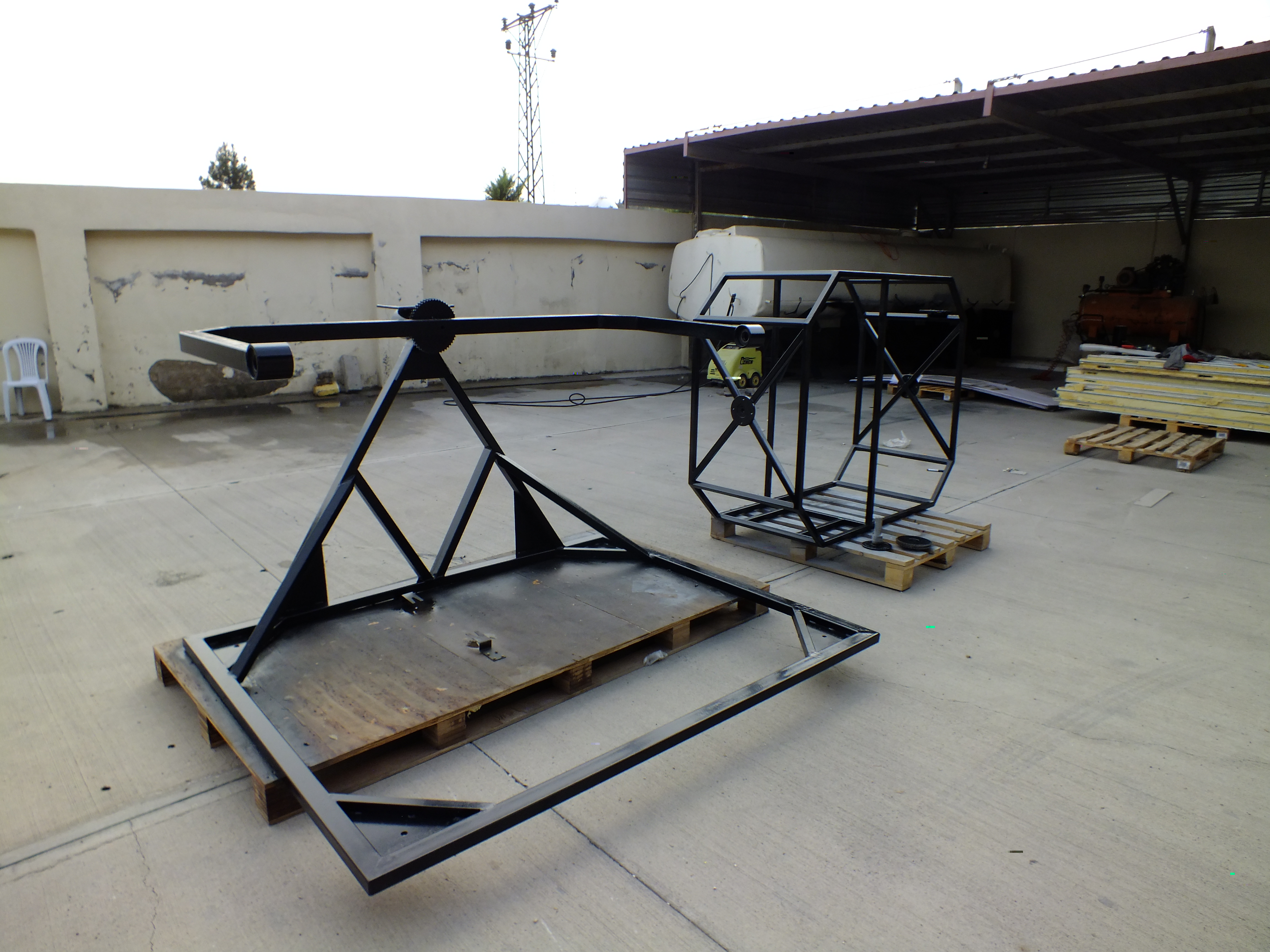

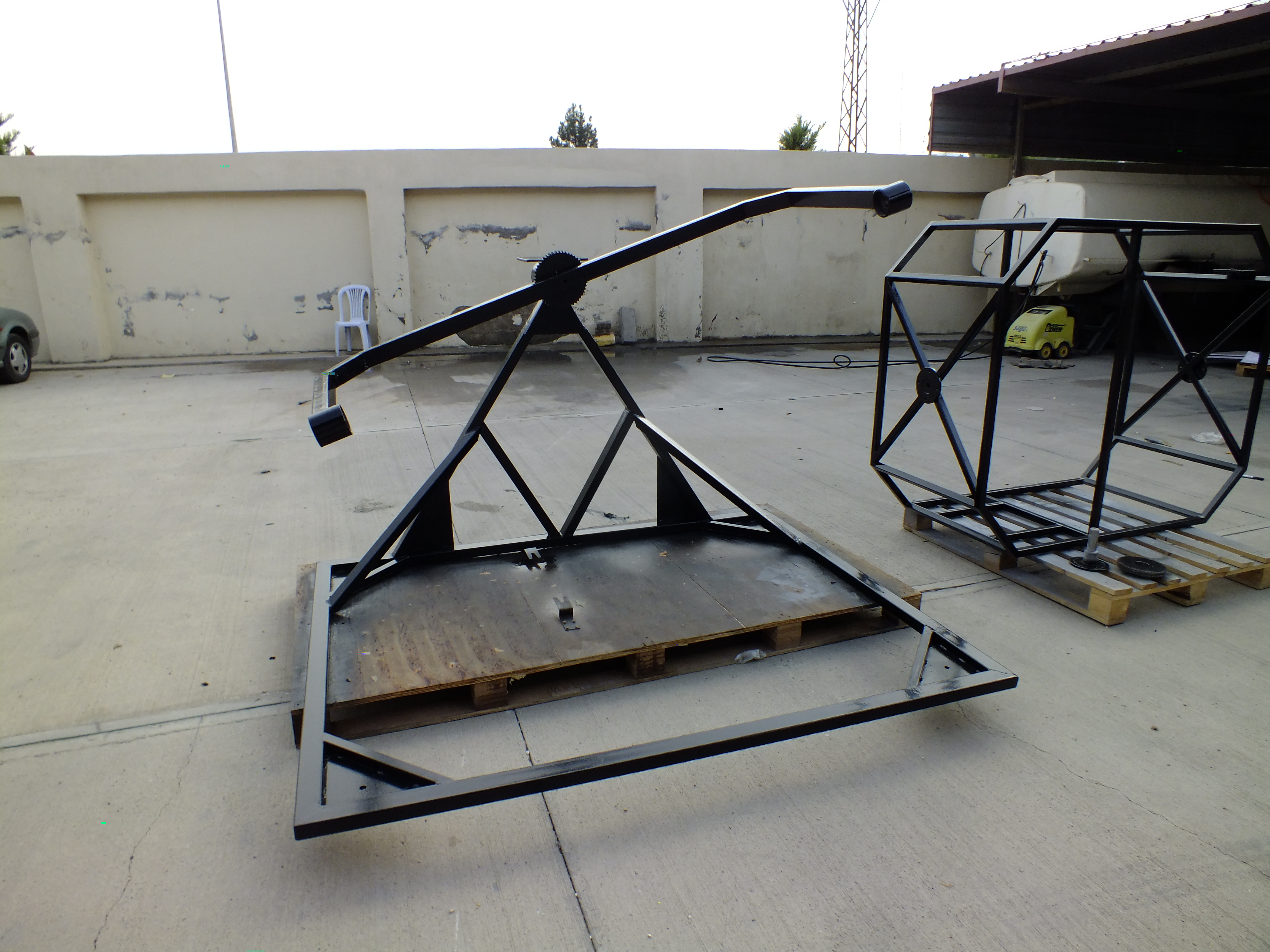

I want to build a simulator for my son.
It is my 2 DOF AC motor simulator.

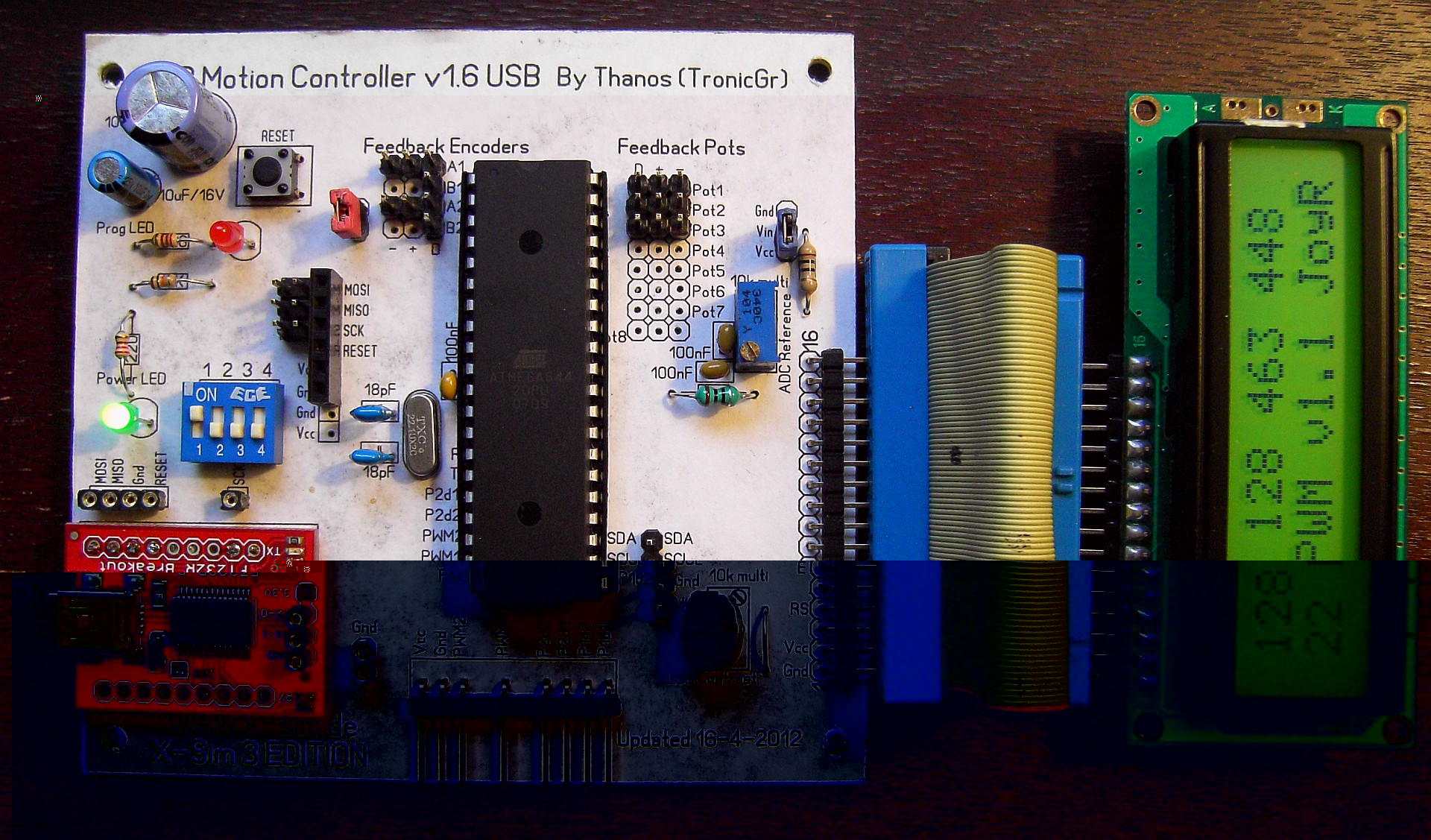

I used for controller :"Thanos AMC1.6 USB 2DOF Motion Controller"
I used Delta inverter and three phase ac motor.
Ac motor: 1.1 Kw
For feedback multiturn 10K potantiometer.

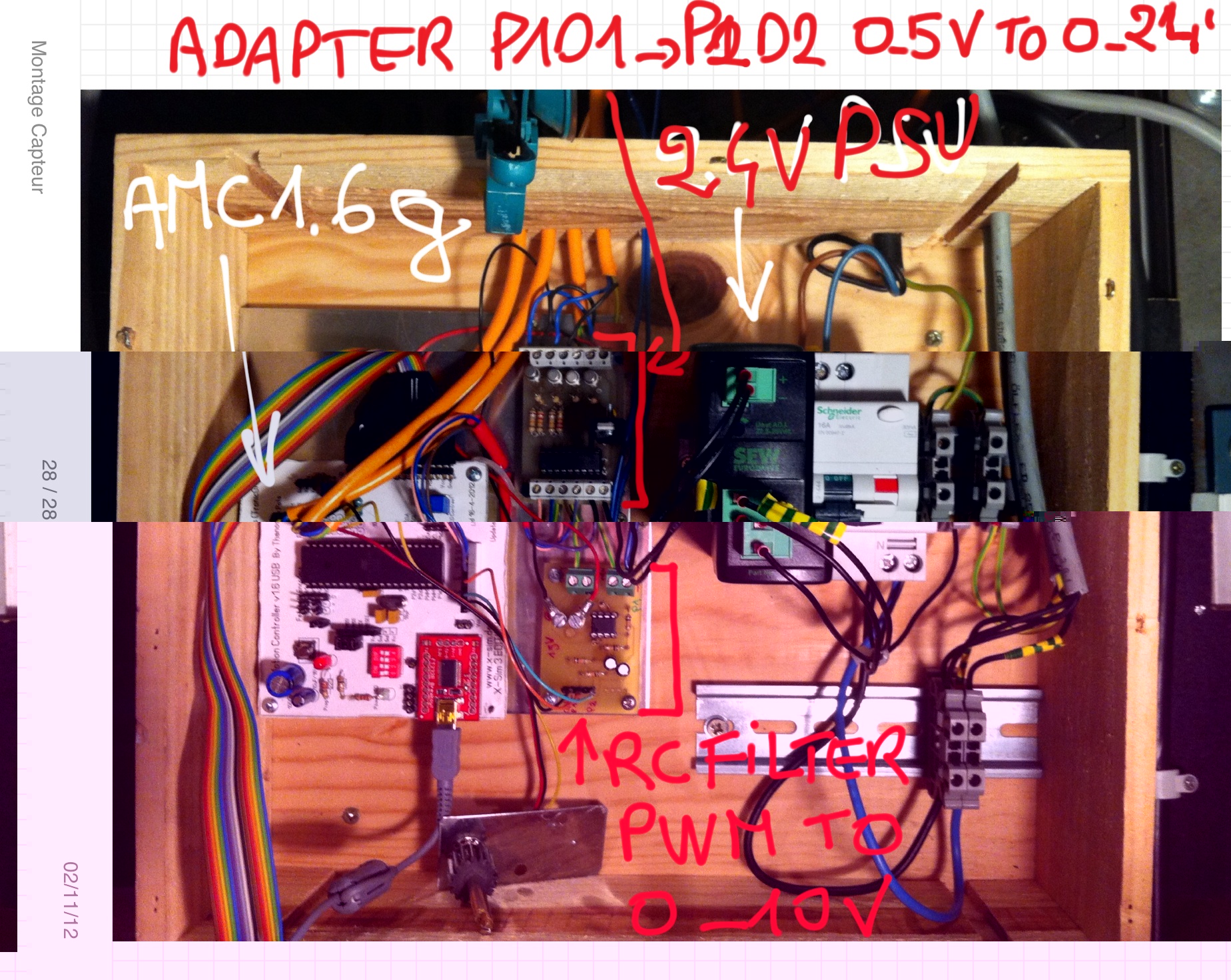

I see you're using a AMC 1.6 and 2 maps based on the map "Adapt"
You seem to have separate map "Adapt in 2cartes.
- Signals reversing the direction drives
- PWM for speed.
:?: Did you just make the change to compensate for a problem?
:?: Have you changed any board components "Adapt"?
