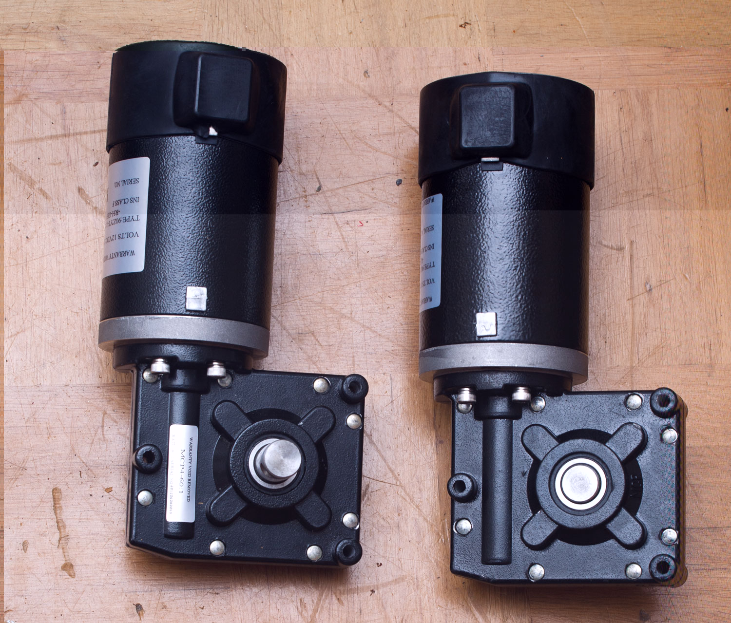

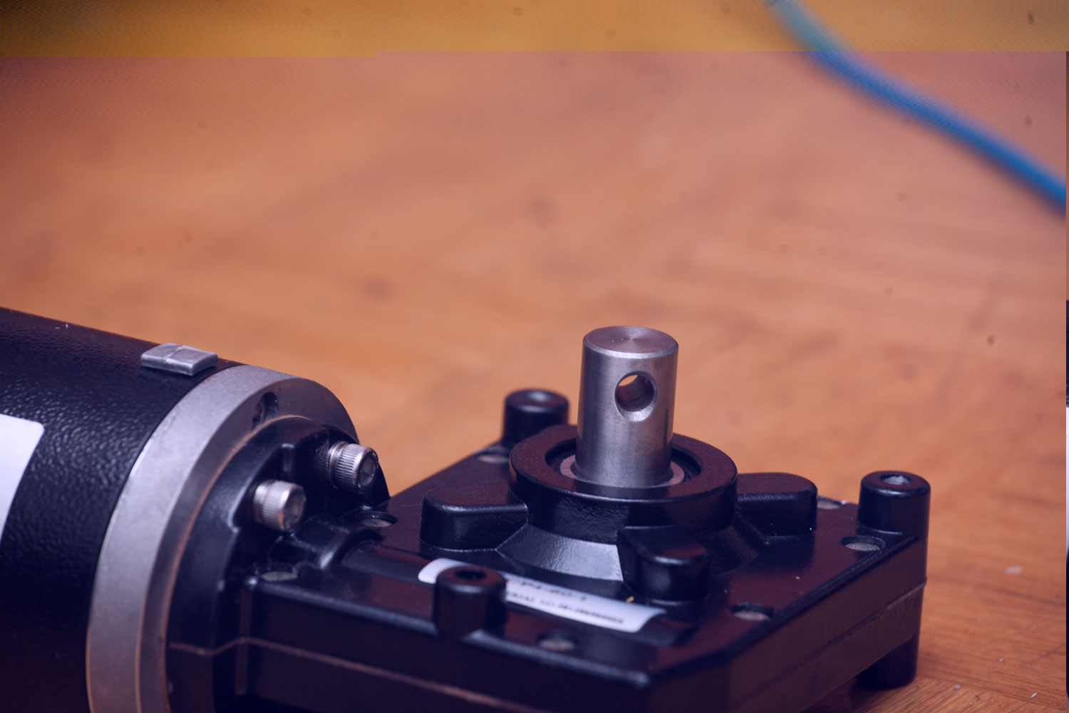

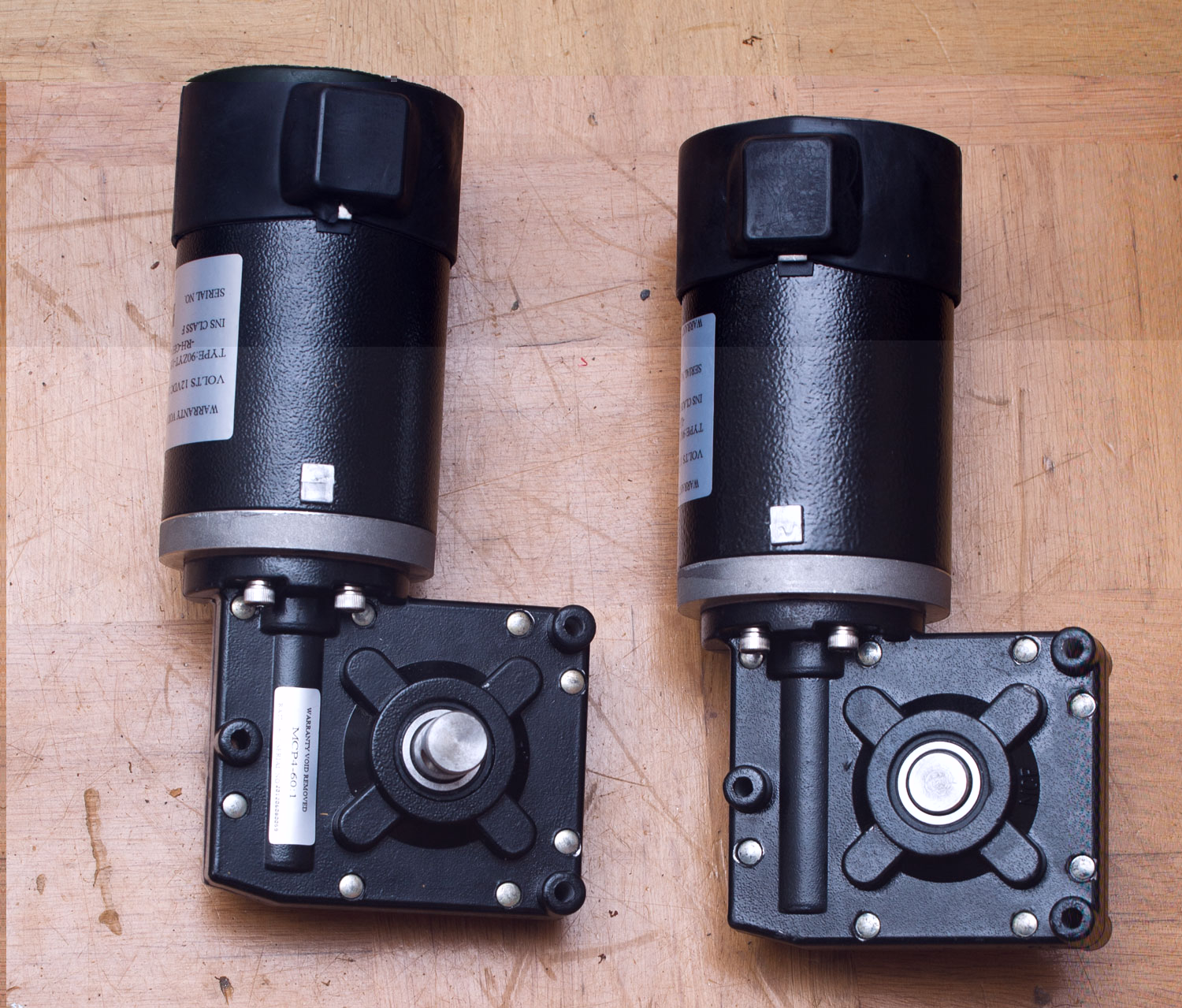

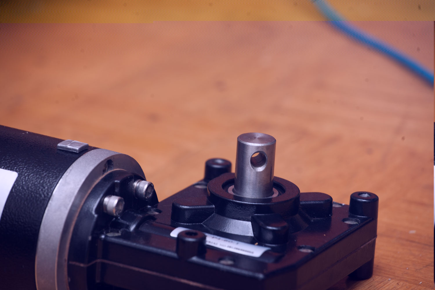

Postby Tombo » Fri 16. Jan 2015, 17:26
Hello, of course i'll do you can watch this thread for updates.
At the moment I'm waiting for some parts to arrive that i can start Building. Today the Motors arrived. The are very heavy, about 4-5kg each. I have to search arounf for my hbridge, i lost it somwhere in my room and the 2 Motomonsters I orderd did not arrive yet.
But note i've read something about this motors that they will draw very much current, up to 70A. Hopefully the Motomonsters in singlemode have enough power.
I made some detail pictures of motor Shaft.Maybe useful.
