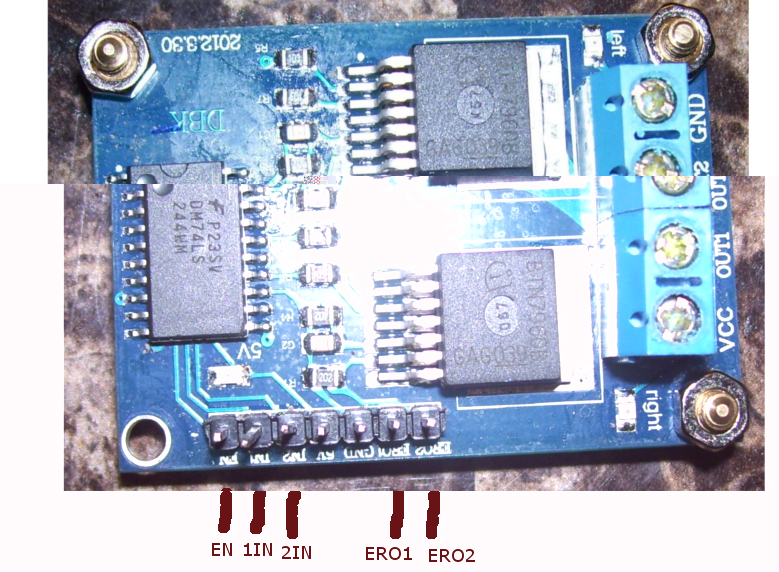

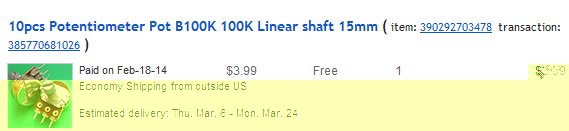

I have looked at yours my problem is that i am i still can't figer a way to wire it. I know where the 5 volt and the ground goes,but i am not sure wher i need to wire my pot up and i don't know what should be in1,in2,en,ero1,ero2 from my uno board to my bridge. I also need to make sure i got the right kind of pot. I am going to post some pictures and thanks for any help you are any one else can give me

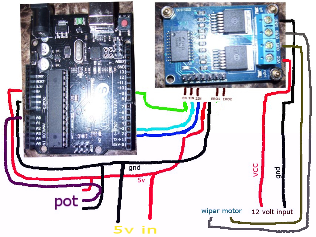

Postby nave » Sat 29. Mar 2014, 08:57
This is the way i think it should be but i don't know,can some one tell me what's right and wrong?

Postby sirnoname » Sat 29. Mar 2014, 10:11
Enable (En) of H-Bridge is mostly used has PWM input.
1in and 2in should be direction pins.
Error outputs should be not connected (or the manual tells you other).
Normally there must be a power 5V and GND connection for the left electronic. This get tied to the arduino.
Send teh datasheet here.
Genereally: this direct connection do work for less power and test. Later in the simulator you must use optocuppler.

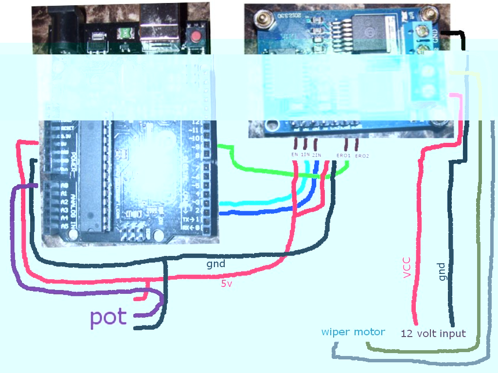

Postby nave » Sat 29. Mar 2014, 17:06
sirnoname wrote:Enable (En) of H-Bridge is mostly used has PWM input.
Is this what you are talking about? I would also like to thank every body for there help. I have wired it up this way but i have one problem both of my wiper motor wires have 12 volts on them at the same time.
