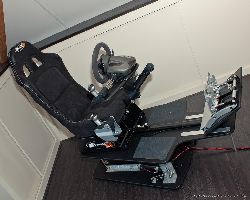

Update 26.11.2012
A few days ago I've finally finished my build :D
The last remaining thing left was to create a decent electronics board and cool the PSU's with more silent fans:
767768769
With this I'm calling this project DONE! (for now at least 8-) )

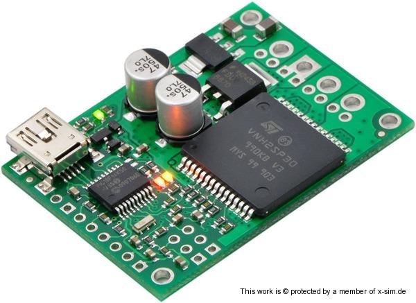

For those interested in the settings:
PID: 6/5 - 13/8 - 3/2
PID period: 10ms
Integral limit: 1000
Feedback deadzone: 2
Max duty cycle: 450
Max acc.: 450
Brake duration: 0
Max current: 30A
Max duty cycle while feedback is out of range: 450
Anyway here's a short 2 min video of the motors in action, as mentioned the profile needs tweaking and I will make a new video in better light conditions soon:

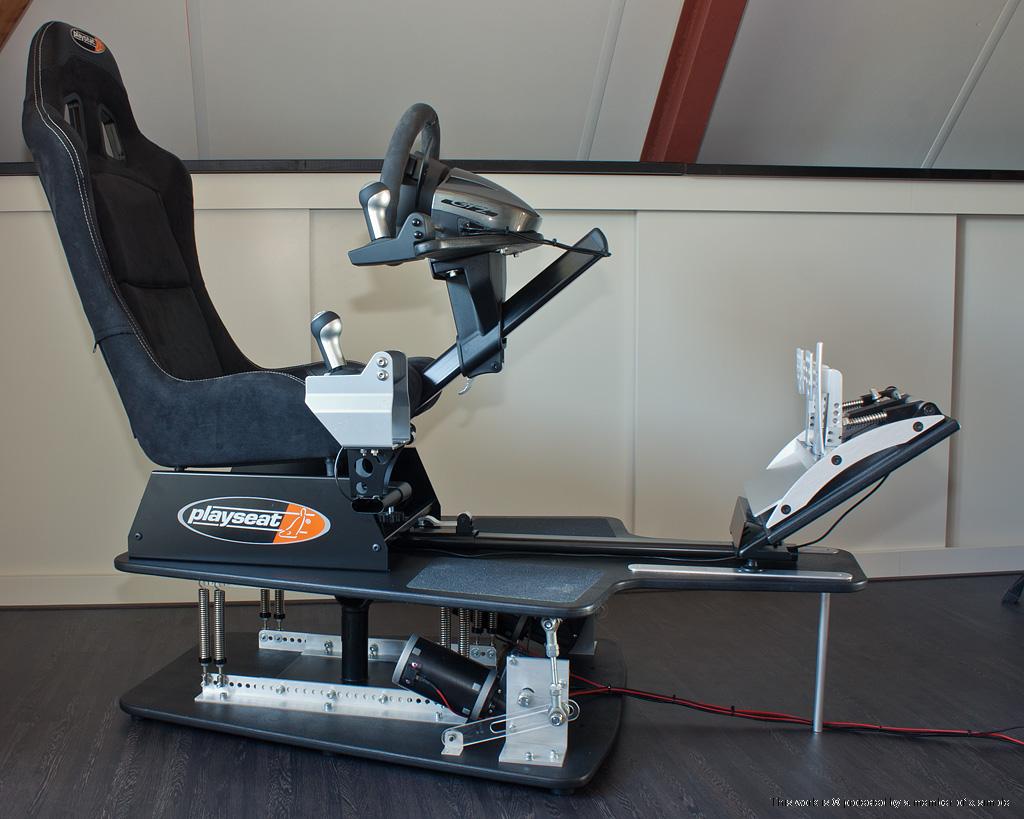

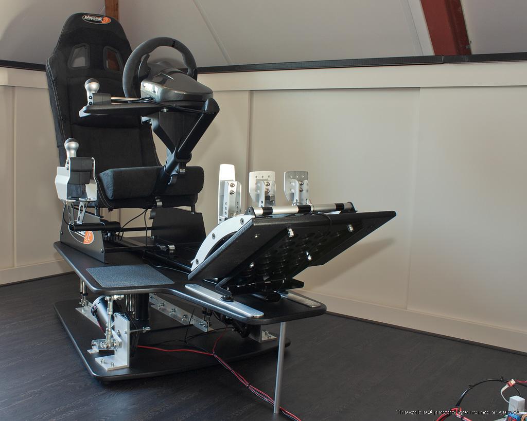

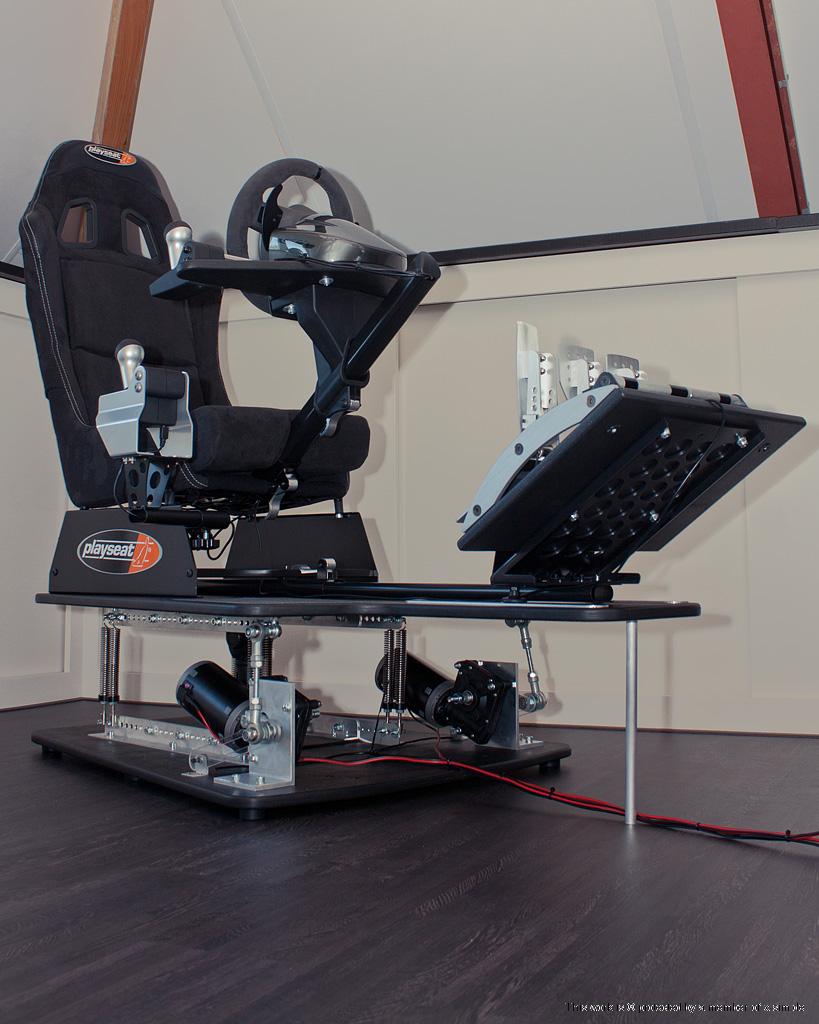

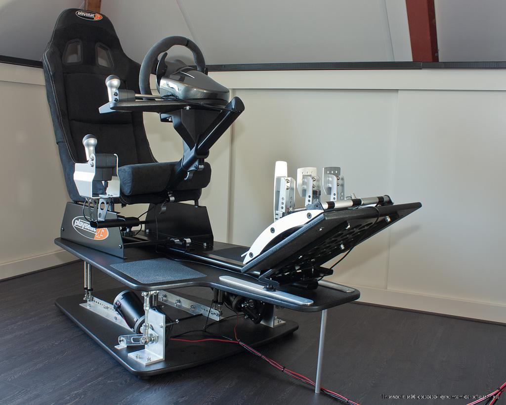

Update 07.09.2012
Shot some quick photo's of the rebuild sim today. Will do a decent photoshoot when it's all finished (with a proper flash set).
As you can see I added some skateboard griptape to prevent skidding and damage to the paint. And also added a few aluminum strips where the feet of the pedal base slide over whilst adjusting it.
Still waiting for my new PSU's so didn't get to using it yet :roll:
249250251252
253254255

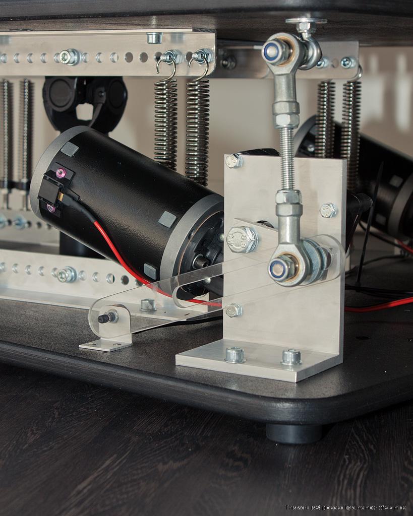

Update 26.08.2012
the last few days I've spend some time on making my new motor mounts.
New against old:
243
Mounted underneath the platform:
244
So far I've discovered onyl 2 minor downsides to the motors:
1) They don't stick to their position if you take the power off (my wiper motors did), most likely due to the gear ratio being different. No major problem though, this just means I have to start the profiler before stepping onto the sim.
2) They kill power supplies :lol: Testing my motors at 27,5A today killed one of the 30A psu's I'm using. I hope I can fix it so I can sell it because to prevent this from happening again I ordered two of these today:
http://www.ebay.nl/itm/12V-45A-600W-Swi ... 5ae92a13a5
I didn't get to testing the advantages of the new motors yet since my test ended prematurely ;)

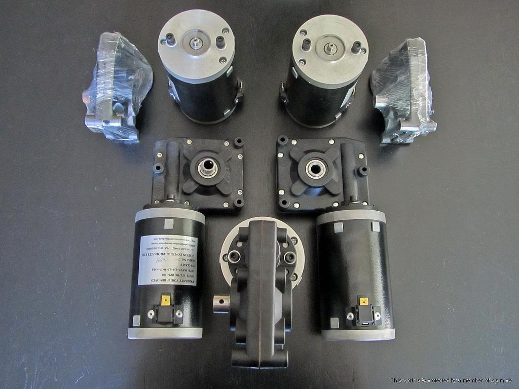

Update 19.07.2012
Today my new motors arrived.
What a difference compared to the wipers :o
165

First of all here's a picture of my electronics board:
141
In a later stage the panel will be painted black and will be mounted in a box with a plexiglass top.
And for the important part without pics: It's allive!!!

The JRK's arrived yesterday :D One of the more expensive parts of the sim, but damn those things are tiny ;)
Finally I can start doing some minor work: Creating the heatsinks for them.
I am planning on modifying an existing CPU heatsink into 2 heatsinks for the JRK's that cover all chips on them.
This requires some downsizing and routing to the base of the heatsink because of the chip height differences.
Luckily I have a column drill/router (I'd rather hava a CNC router, but this will do ;) ).

Just a tiny little status update: Managed to geld hold of two brand new Pololu JRK 12V12's for $ 140,- including shipping today :D
So now, when YoBuddy's package arrives, I have electronics for controlling 4 motors (will still start with 2 though)
80

Next I've mounted the Playseat GT in our attic with my xbox wheel on it for determining the optimal seating position:
89
(the computer in the back is one I got for free (Celeron D 2.66MHz) and has a serial port. This will be my Profiler system.
First thing I noticed is that the seat is quite upright and decided I wanted to tilt it backwards a litte.
So I made some simple aluminum bushes, wrapped in heatshrink to give them a nice black rubbery look:
90 91 92
at first I made the bushes in such length that I could still use the original bolts, but this didn't result in a large enough angle to my likings, so I bought some longer hex bolts and made the bushes about 2,5x longer.
This results in a comfortable seating position (sorry for the somewhat blurry pic):
93

For the motors at first I have been looking at some cheap (€ 55,-) winch motors:
143
They do about 1A/7,5KG and since the Pololu driver can handle 14A/channel continuously this would result in a max continuous load per motor of 105Kg which should be more than enough.
Problem is that the supplier doesn't know the RPM of the motor only that they do 3.2m/min and thus I don't know if they are suitable.
For that reason I decided not to order them and go for wiper motors at first. Currently I'm still trying to find a matched pair of the right type that is usable (if anyone has any suggestions ......).

Yet another update with only a single image, but once again a pretty important one ;)
141
A few days ago I got my sim up and running!
I had some problems with one of the shaft couplers that kept loosening (the same side as the broken thread) and still have to fasten it once in a while, but finally can drive around and experiment with the software.
The problem with the shaft coupling due to my method of mounting the motors and axles made me decide to buy different motors (more W and hollow axle for easier mounting). At this time I'm looking into buying either in China or the UK and will keep you posted on my choice.
No video just yet since everything is connected roughly and the whole setup is a mess that needs to be tidied first ;)
