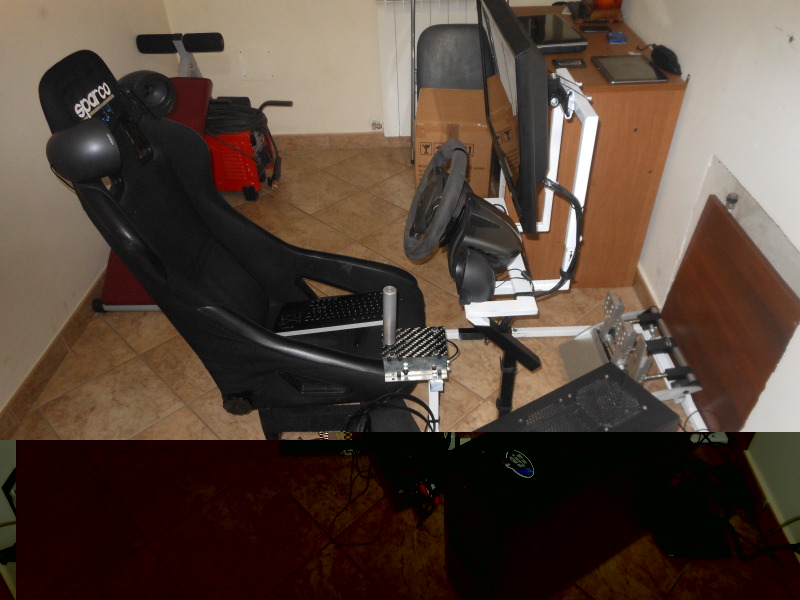

Hello everyone, I want to present my project, but first I want to make the acknowledgments, thanks to this website from which I learned a lot and thanks to the developers of the software x-sim thanks to which my project could take shape, I also thank the 'friend caiubbo84 for his valuable advice, I decided to share my work in the hope that it will be useful to those who want to challenge themselves in a similar project, the everything' was made ​​on a budget and starting from a base made from a telephone style Zalem already 'exists, I apologize for my bad English, google translator is not' good
the project initially planned to set up a station with style Frex movement of the seat only, as I have tried to insert in the movement also pedals and steering wheel, I finally found a satisfactory compromise for me that is to be connected to the steering wheel while moving the pedals remain fixed, this also to avoid overworking the engine wipers

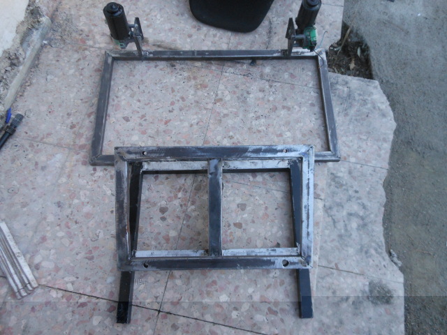

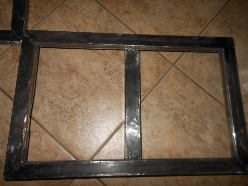

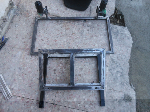

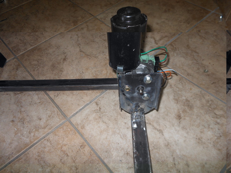

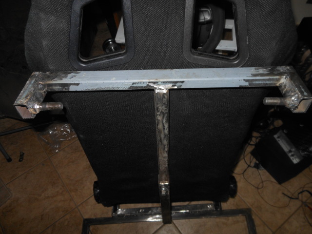

beginning to illustrate the project indicating patterns used, materials etc.
this and 'the position already' existing from which they are party

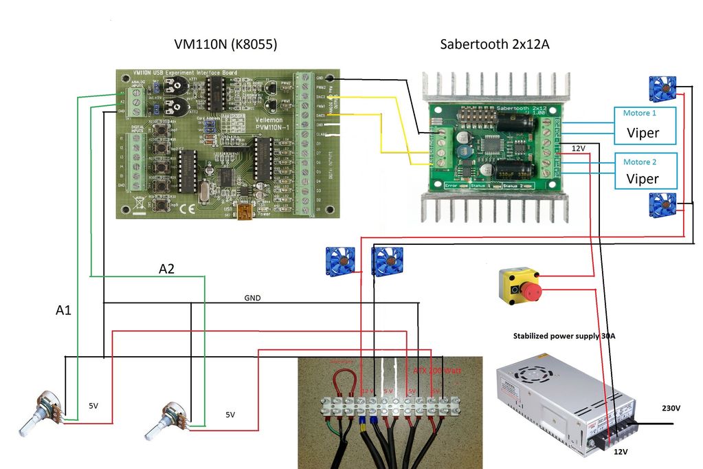

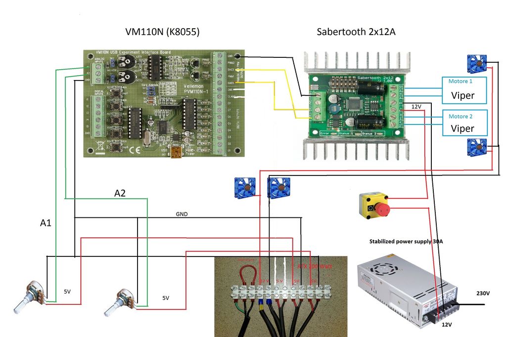

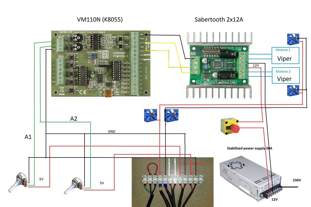

connections

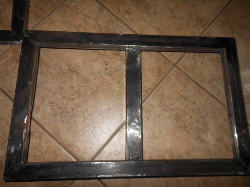

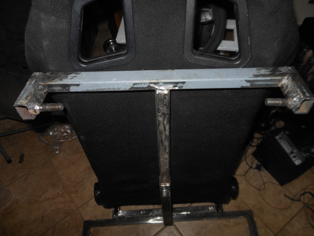

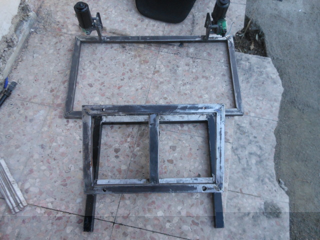

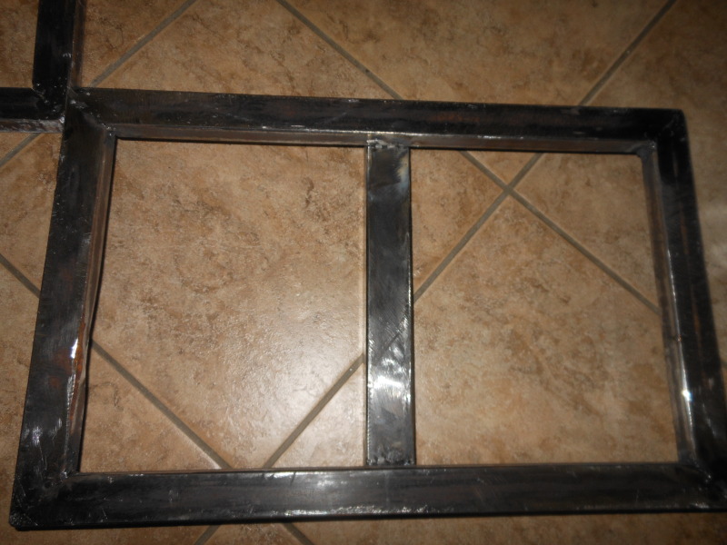

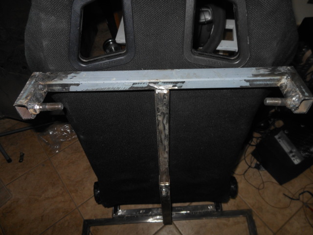

base seat
materials
iron for 2 30x20 bases, so as to make more 'weight construction
2 threaded rods 12 m
n4 rod ends m12
1 stabilized power supply 30a
sabertooth 2x 12 + velleman K8055

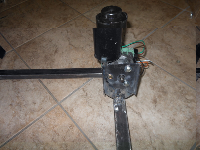

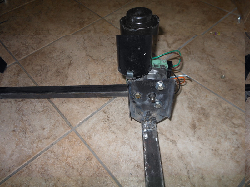

2 front wiper motors fiat panda old type + steering column universal joint
potentiometers 10k
pc power supply atx
seat base
motors
saber+k8055
teste a snodo m12

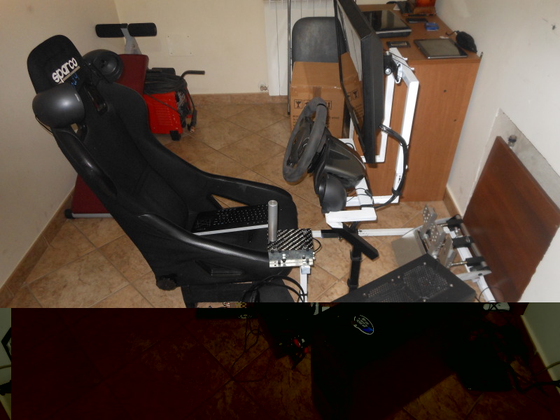

photo of the work

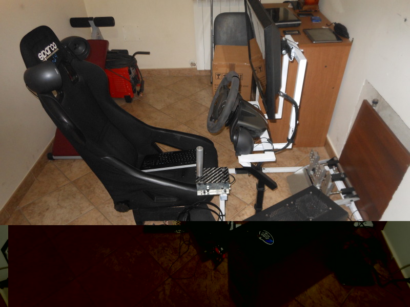

the station has many adjustments in height and in length
this and 'the provisional result, the last upgrade took 3 monitors and change the movement
soon will insert 'new video with the latest upgrade

update 23/07/2013
game :rfactor2
track: lime rock
car :renault megane /formula renault
I painted the structure
fixed the sequential gearbox
adjusted the profiles x-sim to have greater acceleration / braking and vertical force
installed home t. 2.1

Postby gaevulk » Fri 9. Aug 2013, 01:08
update 06-08-2013
game :iracing
track:lime rock
car: radical

Postby gaevulk » Tue 13. Aug 2013, 02:47
last update
the new structure
http://i.imgur.com/9GASBdd.jpg
still in test phase profiles x-sim and structure with the latest changes, I'm 'testing the pedal connected to the movement, but still does not satisfy me' cause the movement is "muted, I'll see 'if I can' always something to change this if it is convenient to for simulation purposes
