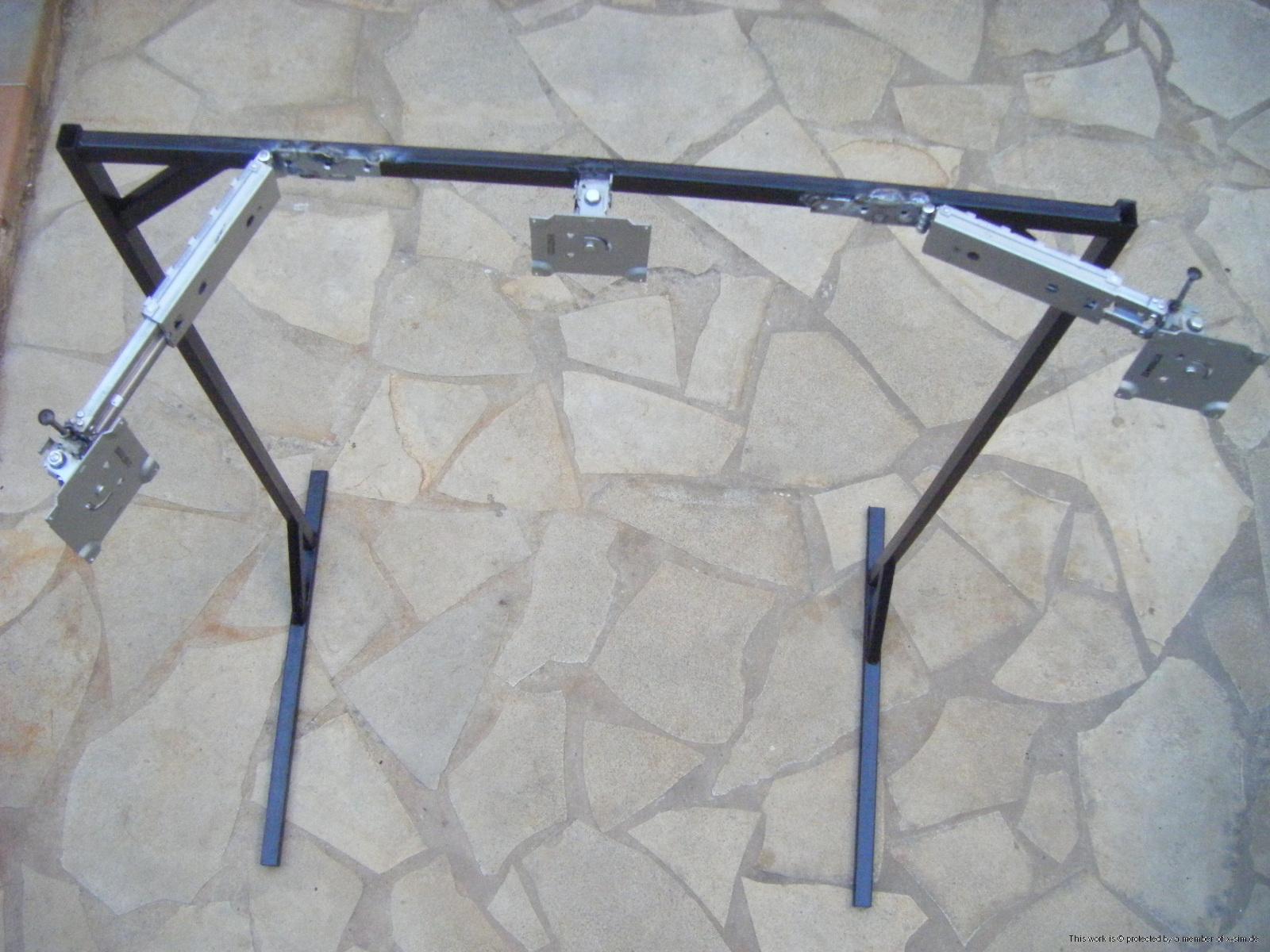

Finally, I built my triple screen stand : http://www.gamoover.net/Forums/index.php?topic=27617.msg447586#msg447586
1725
and I bought a third motor ... to ADD the traction loss :-)) thanks

your monitor stand looks really good. Will the monitors move with the traction loss or will they be static?

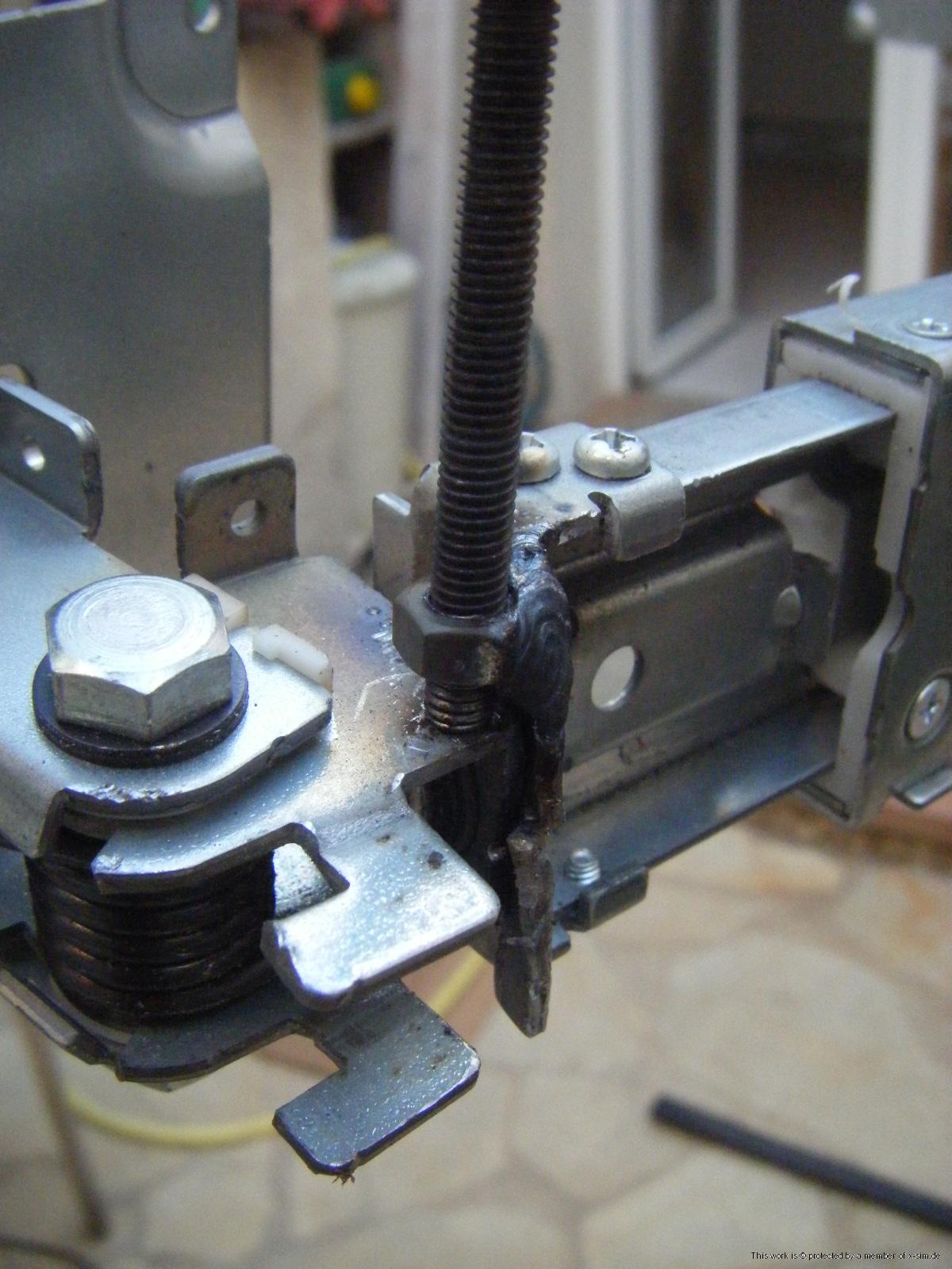

it was tricky because the arms were not designed for been horizontal ... so I had to cope with this pb and add an adjustment bolt
1742
but ... I can test several configuration as drawn before !!! for 20€
yesss
But, no, they won't be moving : too shaggy !
