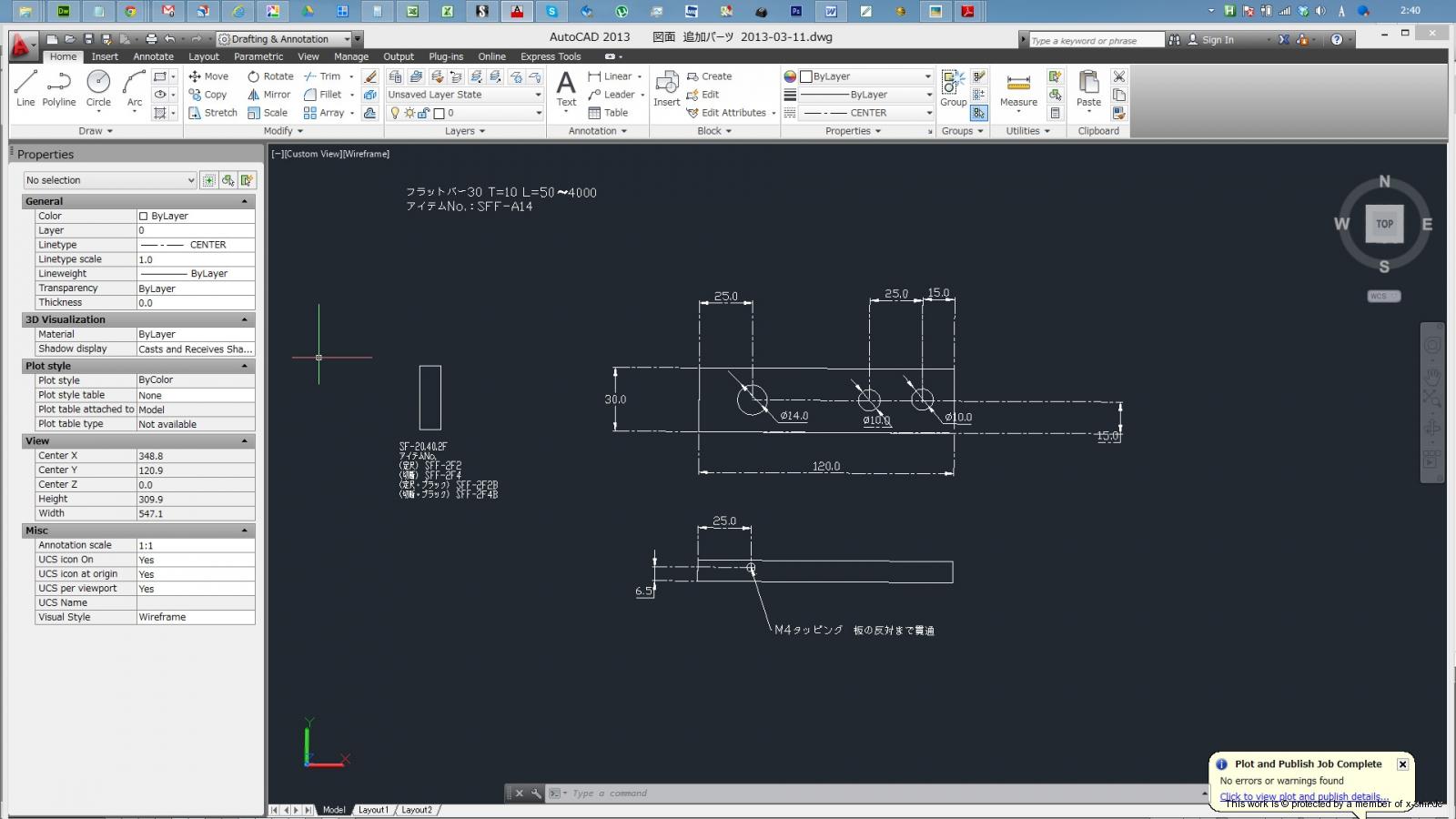

Postby NeoTokyoNori » Mon 11. Mar 2013, 19:57
HI, I have finally managed to decide on the dimensions for my motor arms!
One tiny step towards traction loss ! :lol:
Still so many more decisions to be made..
1279

Postby motiondave » Mon 11. Mar 2013, 23:03
NeoTokyoNori wrote:HI, I have finally managed to decide on the dimensions for my motor arms!
1279
thats good, now time to START YOUR OWN THREAD!!!!

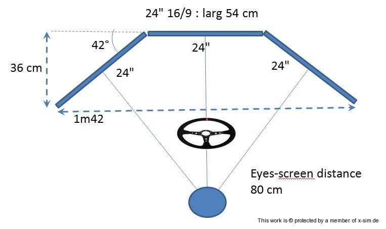

Postby RacingMat » Sun 19. May 2013, 22:19
hi yokoyoko !
Your playseat is great : i'm curious about the feelings given by the third DOF !
Could you tell us what is the distance between your eyes and your screens ?
I'm on the verge to buy 3 screens :P
1629

Postby yokoyoko » Sun 19. May 2013, 23:57
Hi,
the additional feeling given by the third dof is really great. I can encourage everybody who wants to upgrade his 2dof to have a look at this "add on".
A tripple screen setup is great. Mine is not the best at all! I use a very old "hanns g 22inch 16/9" screen in the middle and "dell 19inch 4/3" for the left and right side. I had the Dell's lie around and used them for my fresnel lenses experiment (with which I was not satisfied)... You can get a similar screen setup around 120€ at ebay - very good cost performance ratio :)
Three 27inch 120hz fullhd screens would be better for sure :lol:
I tried to place the screens as near as possible behind my steering wheel!!! My eyes are around 55cm away from the center of the middle screen. I use around 30° angle for the side screens BUT with bigger screens I would use around 40°-45°.
For the near future I want to replace the screens with a Benq W1070 (very good gaming short throw projector). My goal is to get something like this:
--> very impressive I think :idea:
Look at Remco's other great youtube videos... I wonder if you still want a tripple screen :lol: If you have to buy all 3 monitors new the projector setup is cheaper or the same price. And please don't forget the grafic card that is needed to play with a tripple screen setup @ 5760x3240 pixel !!!
Todd Bettenhausen is building a great 3 projector setup atm -->
Let me know what you think,
edit: I will upload a picture later
Best regards

Postby RacingMat » Fri 24. May 2013, 14:07
thanks for your detailed answer !
I found the triple projector interesting but it needs toooooo much place in the room for me !
and I agree with you : the rFactor video is impressive ! but the playseat and the screen configuration is not shown, that's a pity !
