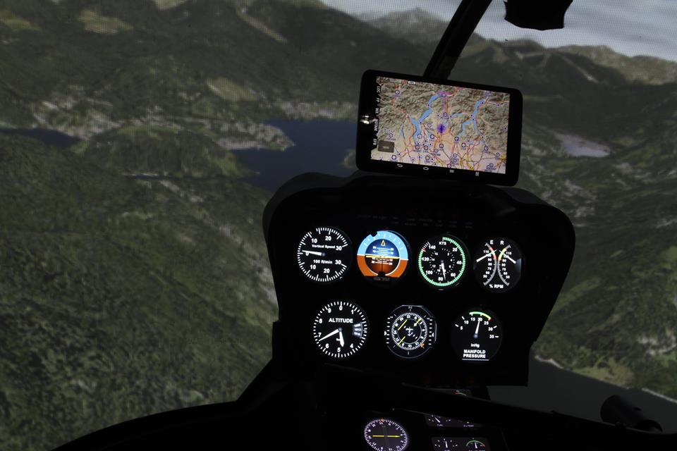

Postby macrokefag » Wed 18. Mar 2015, 10:54
Integrated EasyVFR GPS system. :D
vfr
