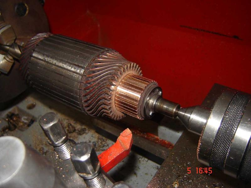

:lol: ;) if you have access to a lathe and you use used motors like me I would recommend to do this:
Don't forget to remove all chopper chips from the slots.
Have a look on the brushes if they are ok too. If not I would exchange it. There are also those with higher silver share but higher wear. Let the motor "run" in at a lower speed until the brushes complet rest at the commutator before power them at full load.
I use the "lower" speed of the wipers - brushes confronting axially.
There are special tools to adjust the "brush slots" like here (just as example)
Also, the brush may well slide into the guide.
