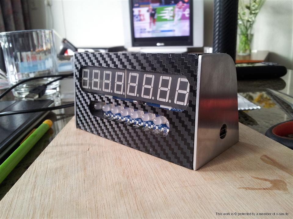

I managed to get an old beamer, emergency stop en made a really nice dashboard with an arduino en TM board. :D The next weeks i will reassamble the sim and i will post it here.
Before testing again i will have to make a lever stop, so the motors will stop turning while getting on the sim. This has damaged a potmeter... :|
Preview of the dash, more pics will posted soon:
1091
