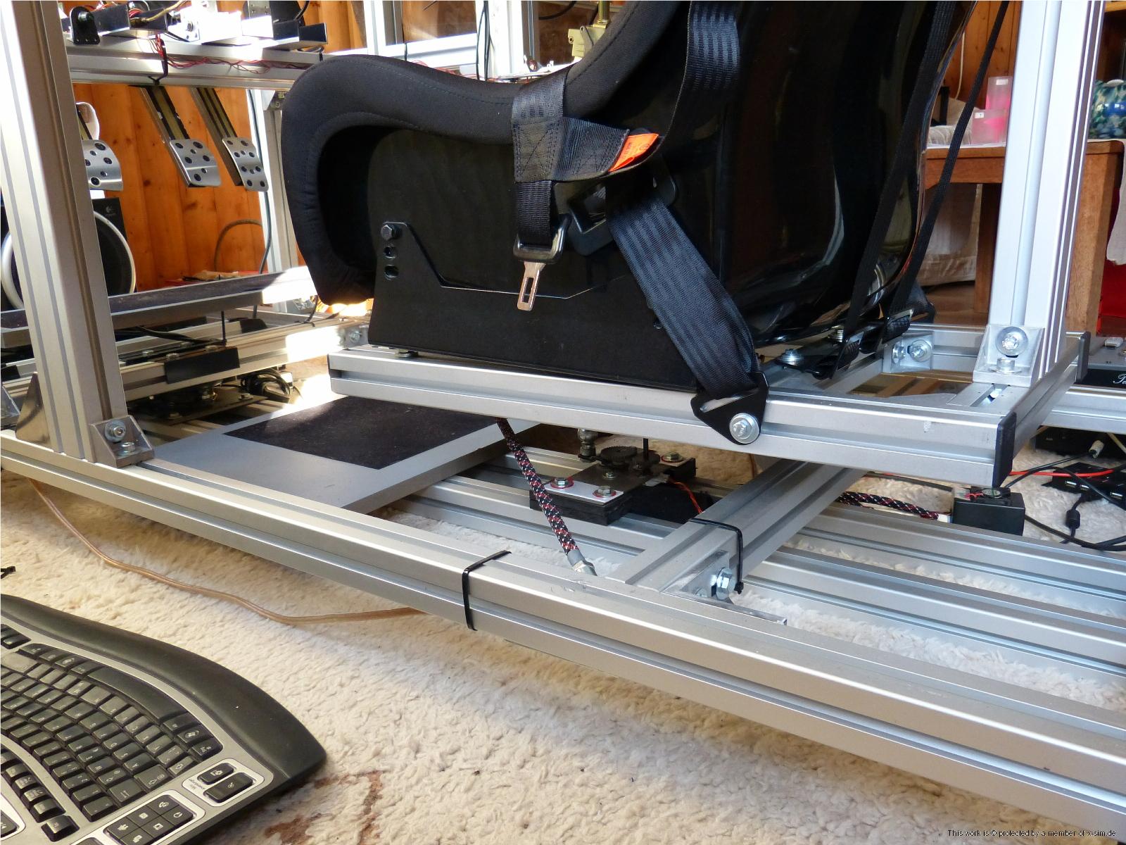

Postby yokoyoko » Mon 4. Mar 2013, 18:56
Hello yokoyoko,
I like your work on the traction loss rig!
Thank you very much! ;)
I am trying to build a similar setup for my motion rig too.
I can only encourage you pursue this direction. I think you will not regret it. For sure I will help you if you need some infos on how to build it :!:

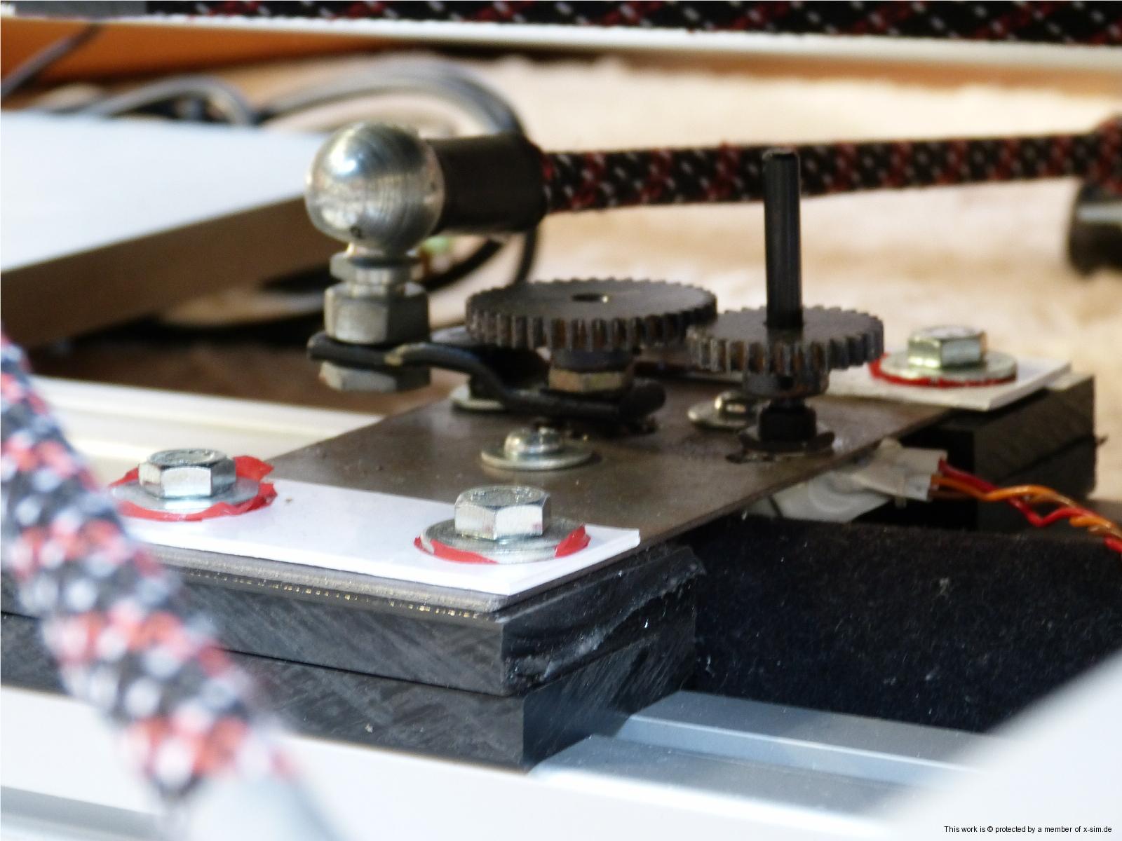

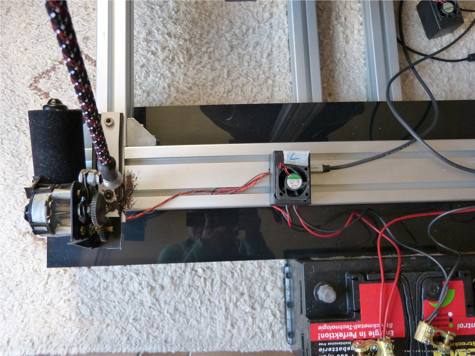

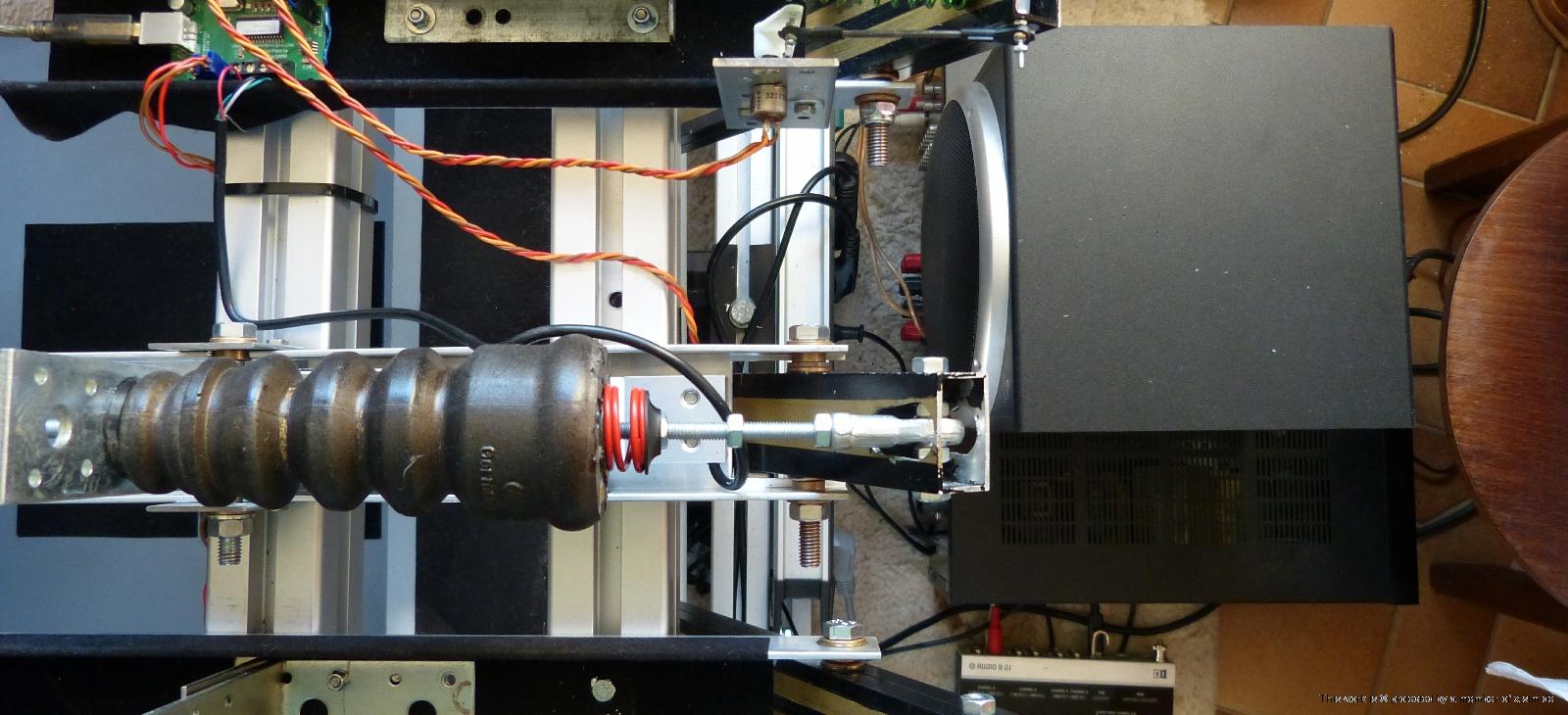

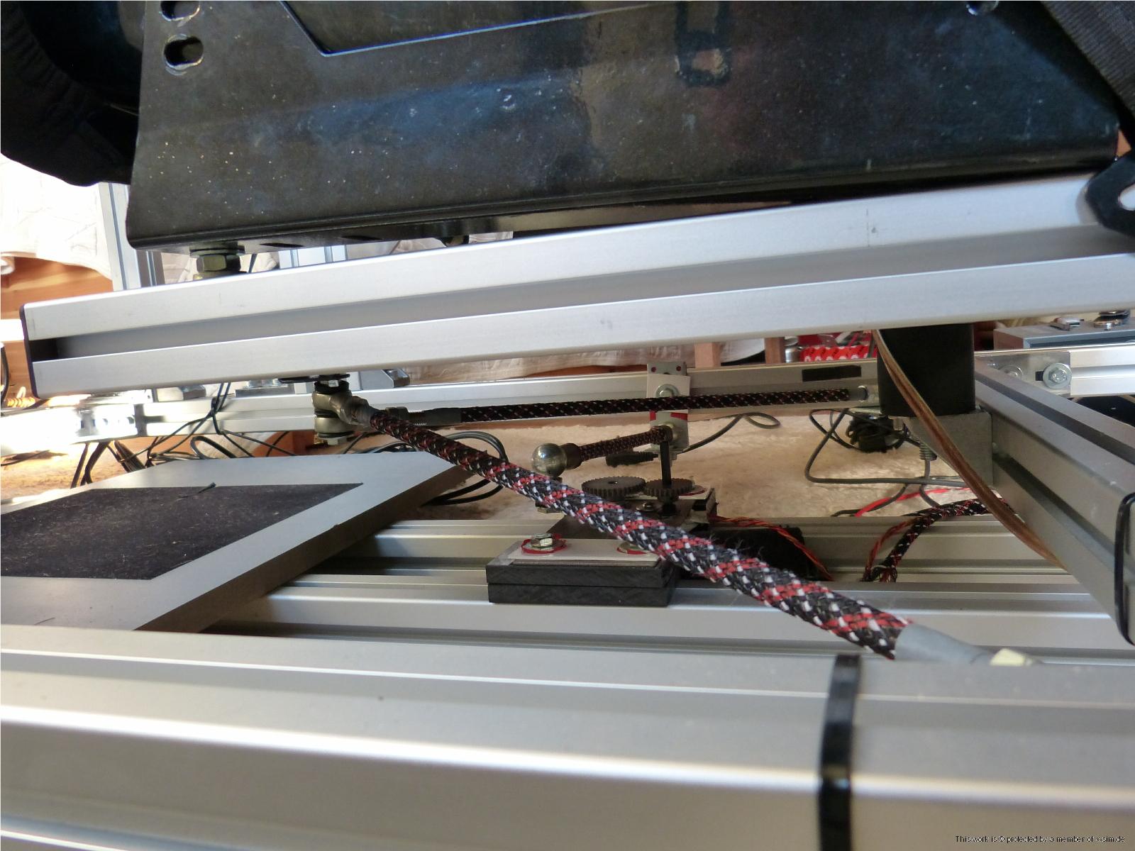

Can you please show how you are using the motor for the sideways movement?
I see that you have a swivel plate at the front, but none of your pictures shows the traction loss motor.
:shock:
I updated my gallery with some pictures. I think this will answer your question
12411233123212311230
At the moment the motor is 85cm away to the front bearing. The distance to the rear bearings is 70cm. The leverarm of the motor is "standard" wiper with a length of 4,5cm from hole to hole.

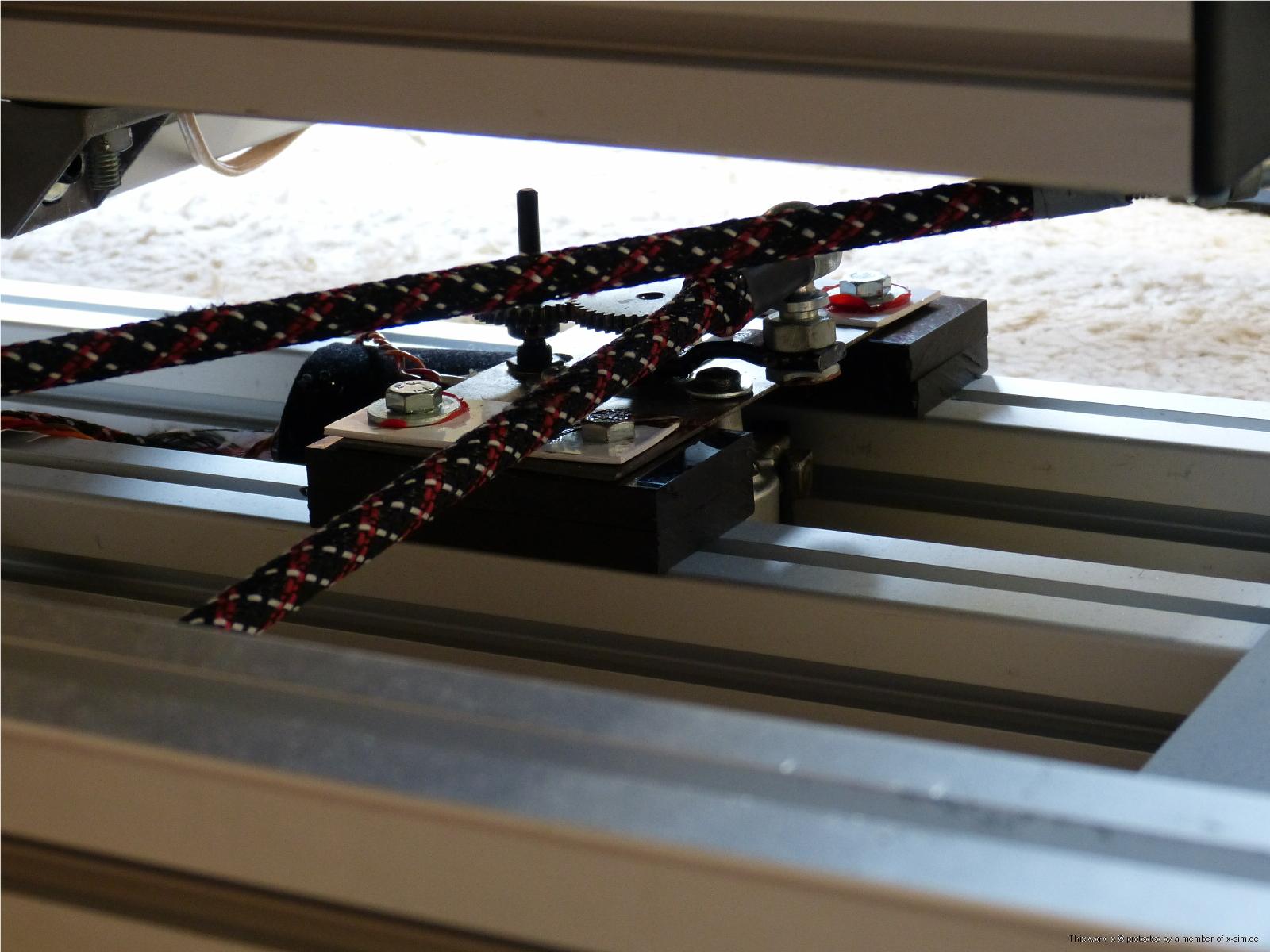

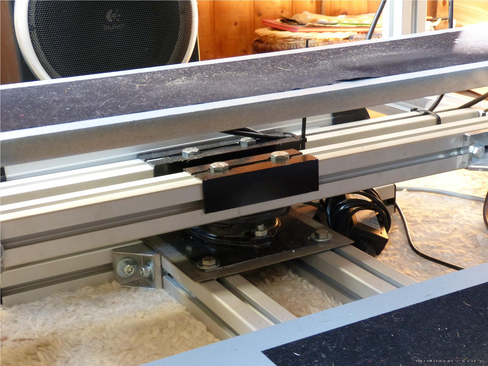

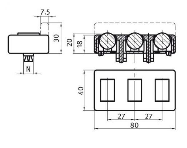

I would also like to see the bearings that fit into the frame slots..
12231222

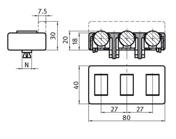

Or you can better look at them in the drawing:
I filled them with motorbike chainspray to smooth the rolls inside.

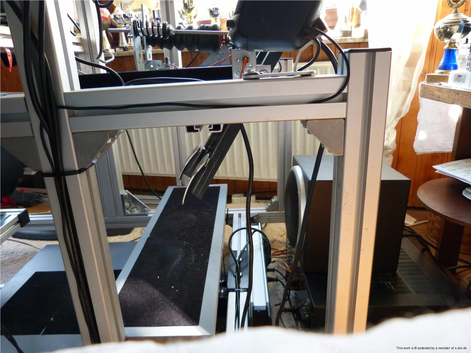

What I like best is if the front bearing is at the same "axis" as the pedals. Like here:
122912201219

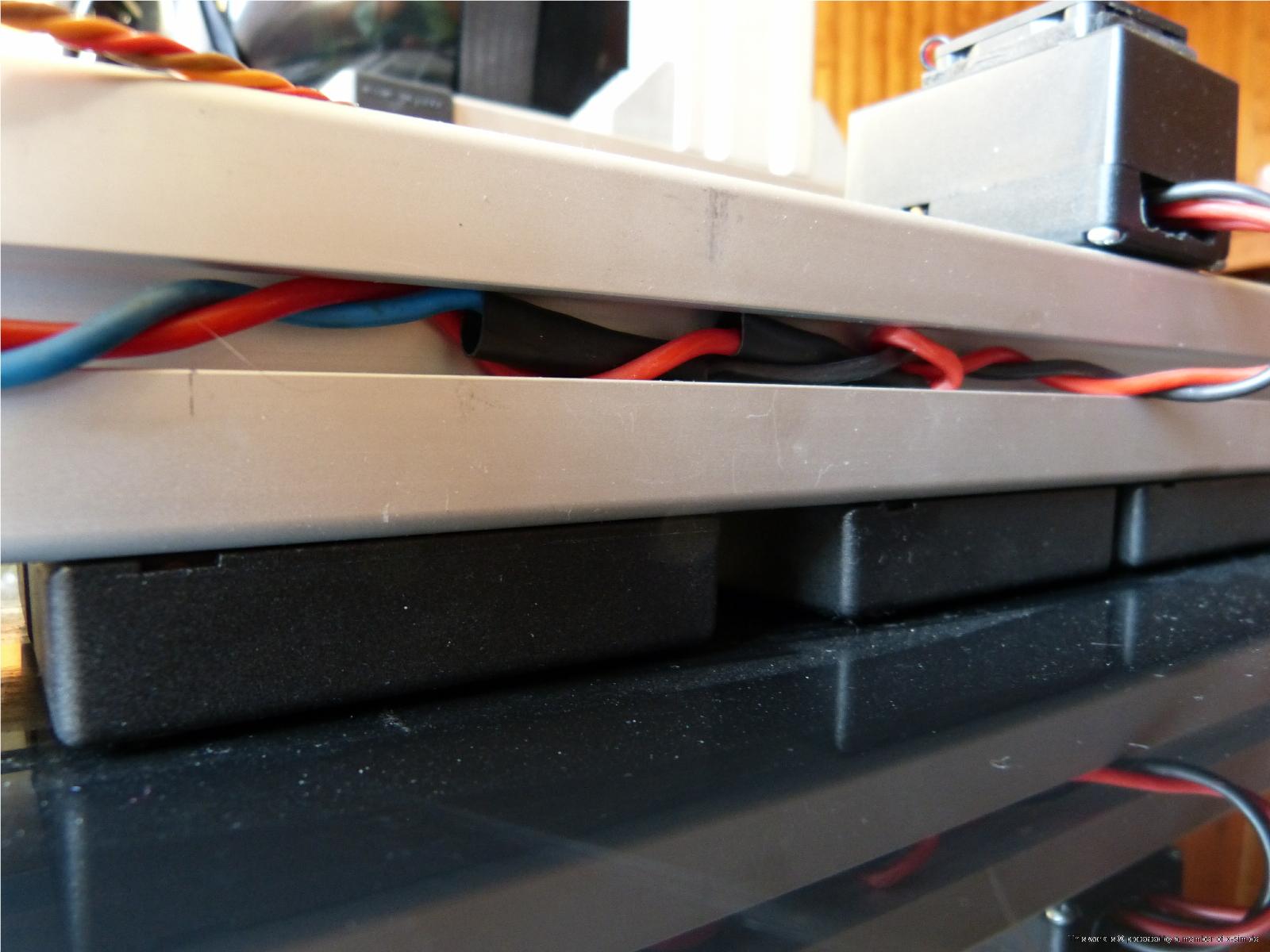

Like said before this plate don't need to be this massive:
1237

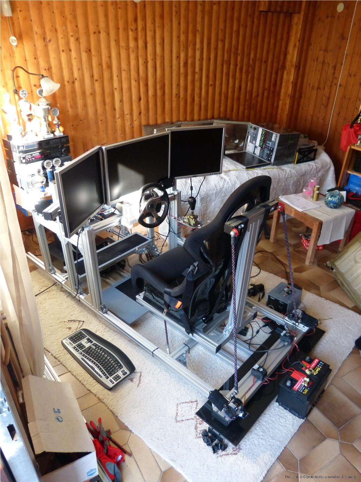

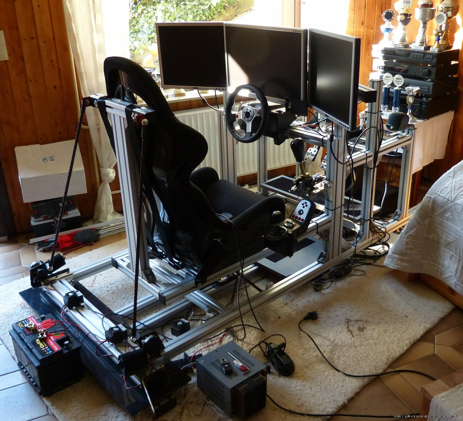

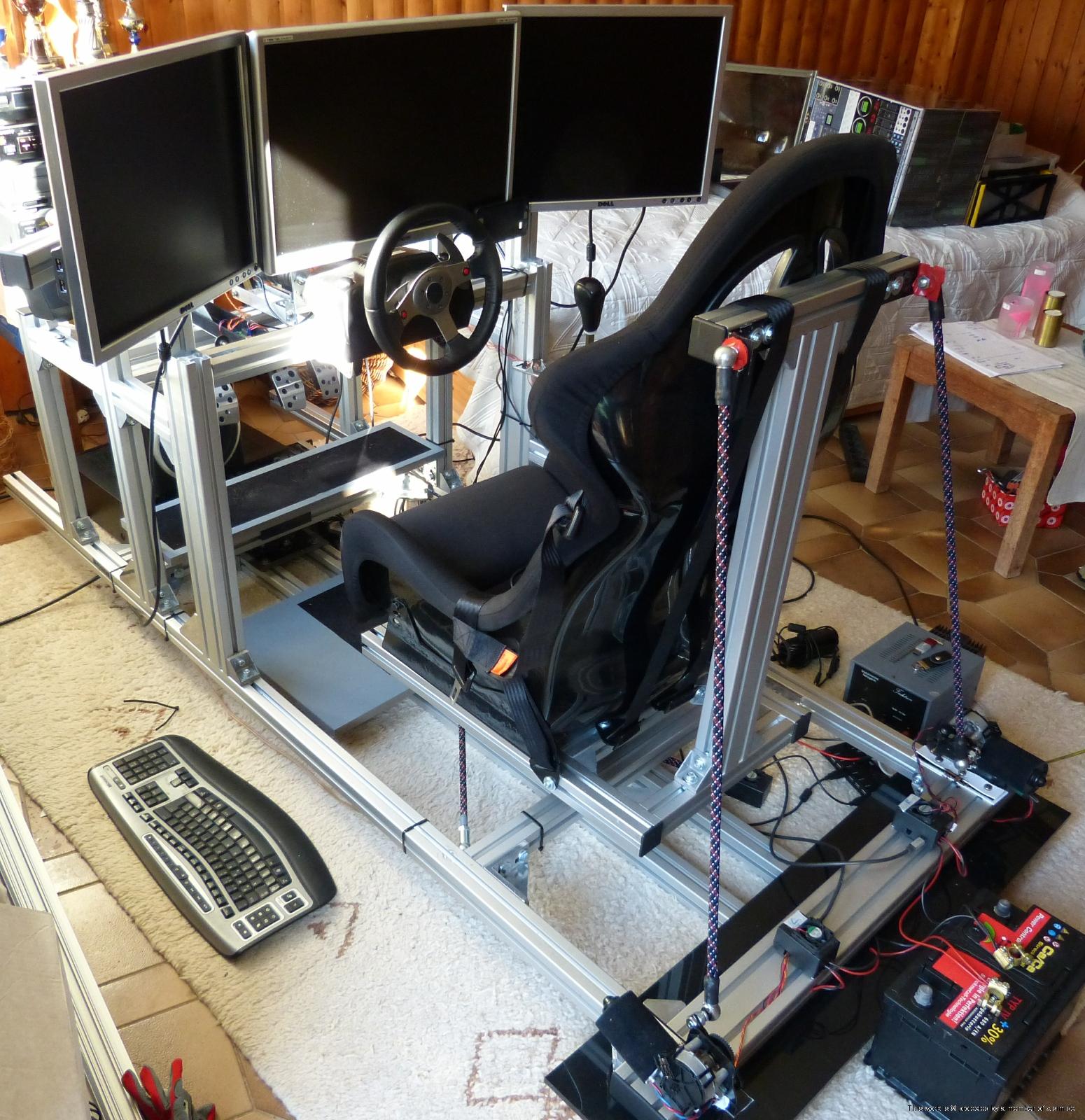

Here is a complete view of the sim:
124012391234
Feel free to ask if I have missed an important info!!!

Postby NeoTokyoNori » Mon 4. Mar 2013, 19:29
I am really excited that you answered with your photos so quickly!!
My brain has been over-heating trying to figure out what is going on down there :lol:
I am going to study your photos closely, and will let you know how it goes ! :geek:
Thanks so much.

Postby NeoTokyoNori » Tue 5. Mar 2013, 16:35
Hi yokoyoko,
I am impressed by how much motion and speed you are getting from those little motors :shock:
Are you using 24volts?
Did you have any issues with fwd/reverse motor speed?
Did you use RC tuning skills? ;)
About the traction loss method
I see now you are using the rod to push against the lower chasis.
I am thinking of using my wiper motor to make the upper chasis "swing" just like a wiper - they should be good at that right? :)
Do you think there is a big difference between the methods ?
my motor will be positioned halfway between the front pivot point and the seat pivot, like yours.
About the seat pivot
Are you using a rubber bushing instead of a uni-joint? if so what type?
i am thinking of using a suspension arm lower ball joint
Bearings
what type of bearing are they called? i have never seen that shape before.
i am thinking of putting raw steel ball bearings directly along the aluminum slots !
and just have a bolt that acts as the front pivot - no swivel plate
Rods
what are they made of, carbon fiber?
why do they look like rope?
Its quite fascinating to watch the rig working.
I would be happy to see more longer videos, showing your traction loss mechanism at work! :P
