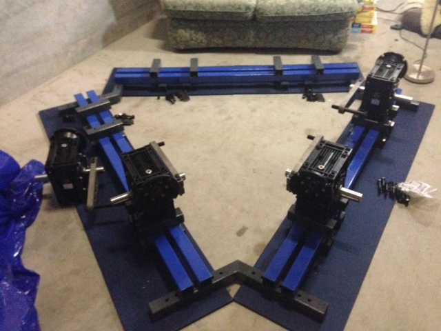

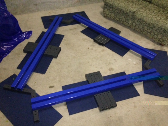

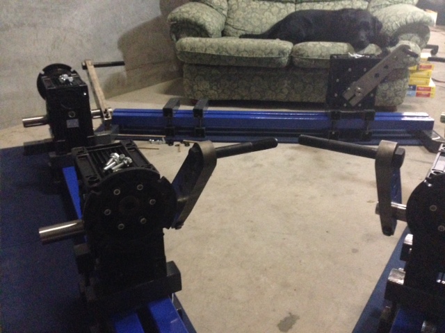

The build continues!

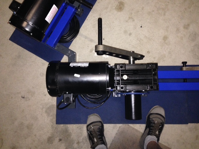

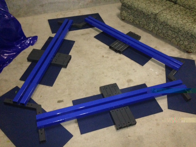

Framing the base and starting to mount gearboxes and motors...

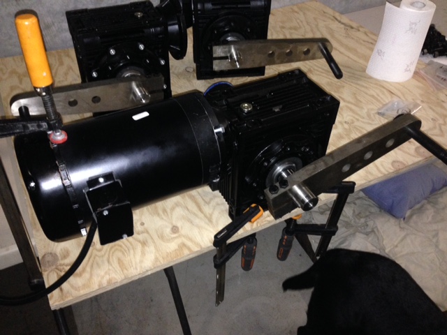

...of course, not without the help of my 'Lab' assistant :D

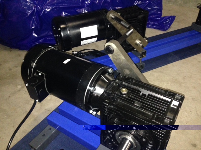

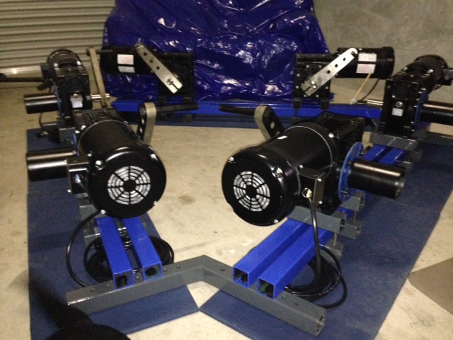

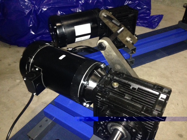

and finally, some motors finding their home
That's mostly it for * I've been having some trouble getting the board to talk correctly to the VFDs, but I have absolute faith that it'll be sorted out.

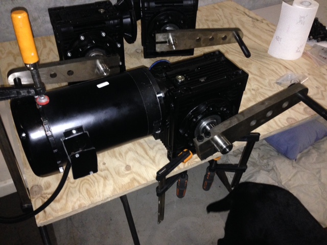

In the meantime I've set up a motor and gearbox for bench testing.

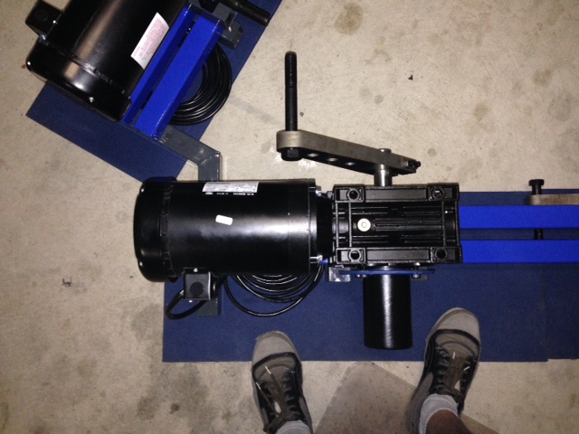

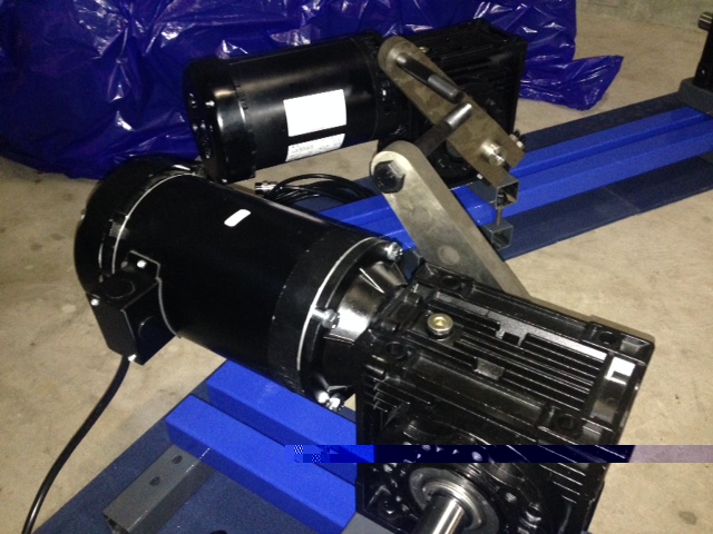

Postby DoctorD » Mon 20. Oct 2014, 12:15

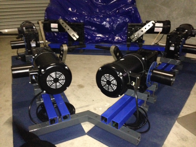

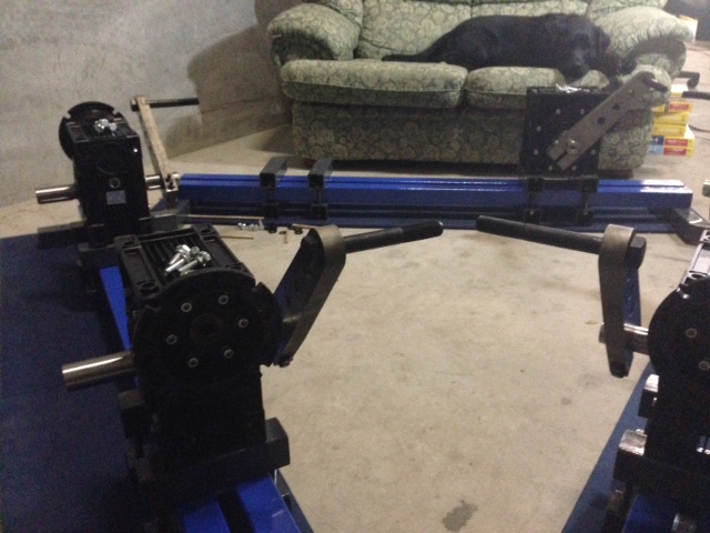

More progress!
The motors and gearboxes are all on board and they are certainly looking like they're ready for business.
I don't know if the photos do it justice, but it's a little daunting/impressive to look at the now 300kg+ base frame and imagine what it's going to be like riding the thing.
That said, I really can't wait until I'm able to offer rides to my friends and get them to step up onto the platform
