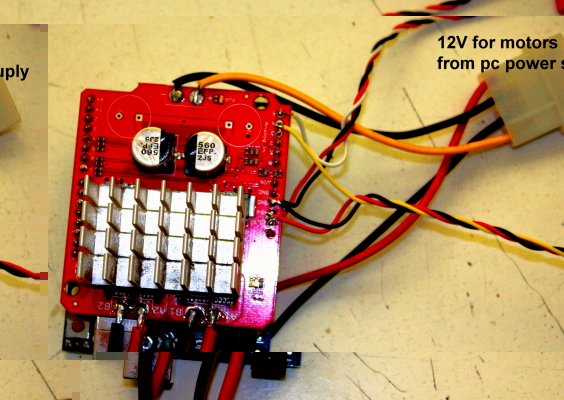

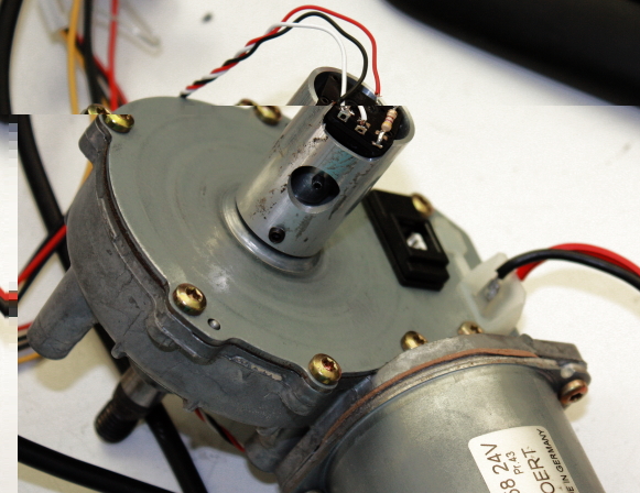

this is my motor and arduino
one motor (left) is with white cable and the right is with the yellow

Postby kalarius » Thu 24. Oct 2013, 08:53
this pcb require the arduino to work
at the begin of this project you will find the code to download at the ardiuno
I have the same to my project and work fine
do not forget to place a heat sink on the chips
the photo above with the red pcb is mine "monster driver"
