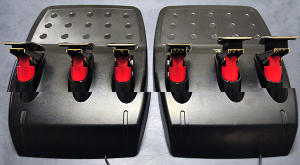

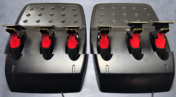

I know how it works :o , but i´ve to modd my Pedals like the G27 look:
G25/G27 pedals
But this i no problem for me 8-)
The blog is very nice, also very clean built.

With g25 just design a wooden block that you put between pedal frame and stick metal.( I made this with a t500 rs pedal )
For the screenshot for the G27 this plastic block have to be removed from the throttle pedal.
