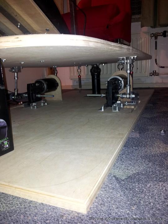

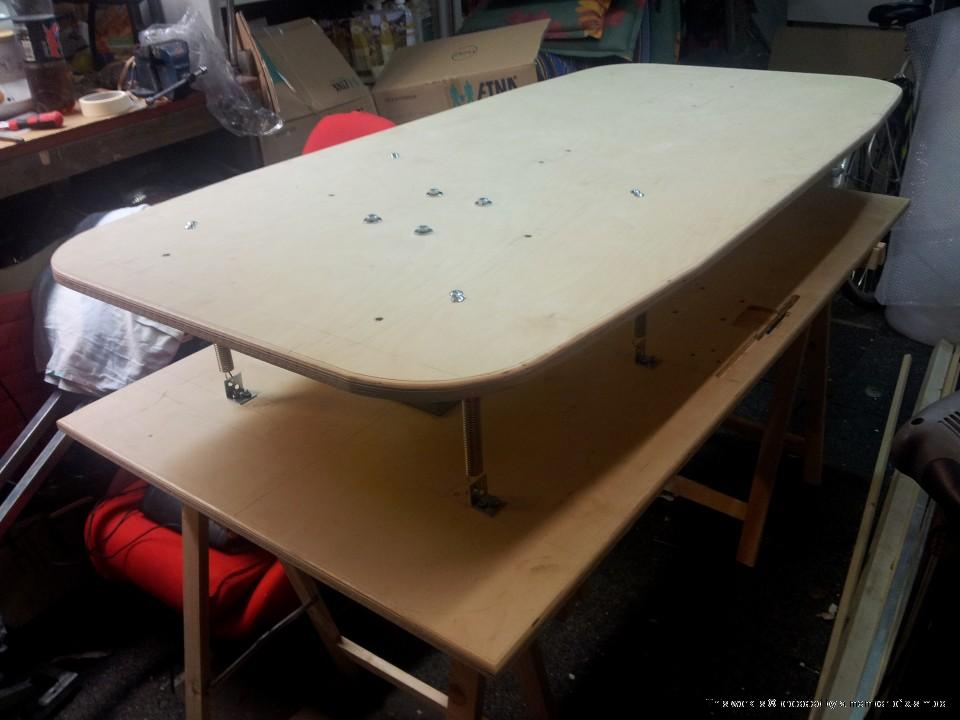

I've routed out some wood so the lever can't hit the base plate anymore:
544 545

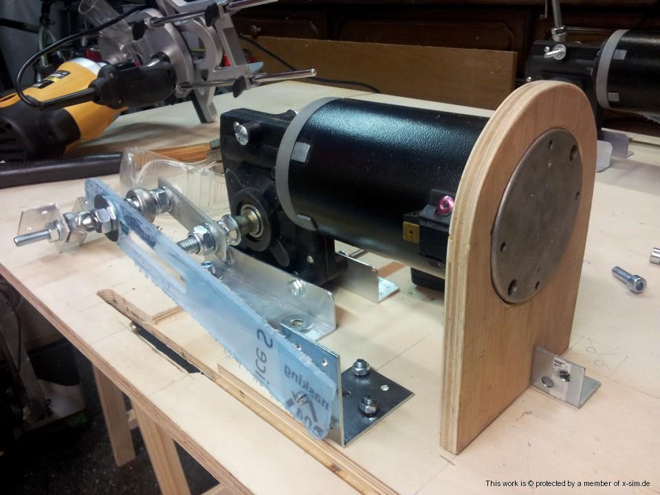

I made a bracket for the potentiometers and a lever from 5mm plexiglass.
546 547

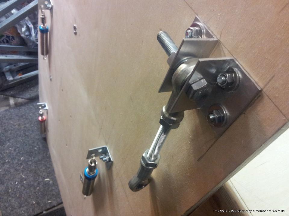

Routed the corners of the wood:
548 549 550

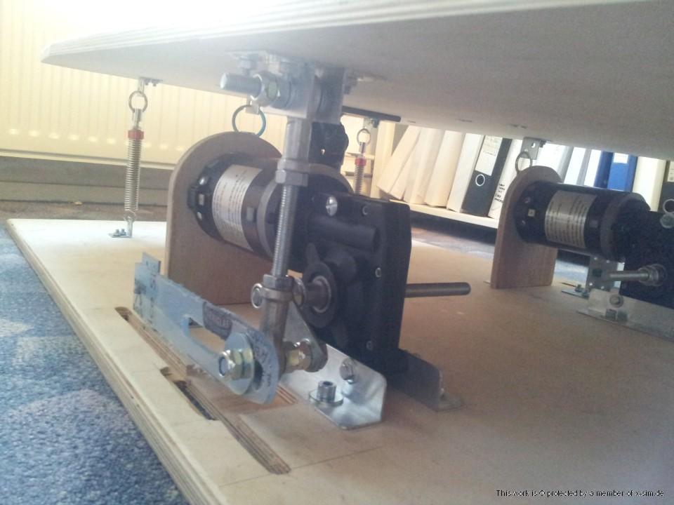

Testing 1..2..3... FITS! :D

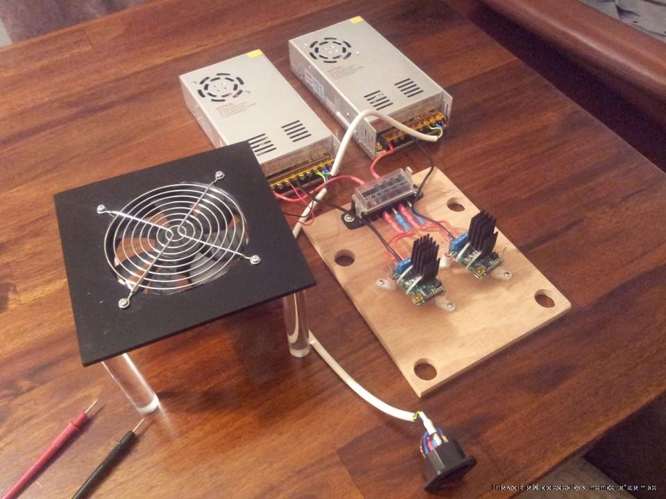

I was reading here that the JRK's need some serious cooling, so I cutted 2 heatsinks and started with a fan housing:
554 555

Fan house allmost done. Also wired up the pots!

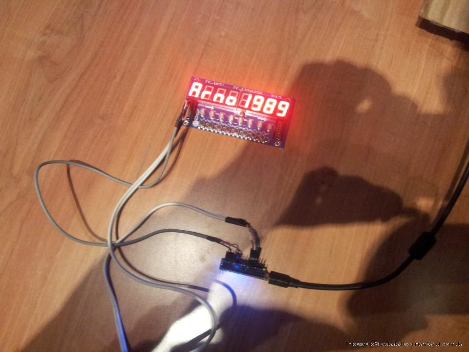

Dashboard project is coming...

Electrical stuff finished :D
566 567
