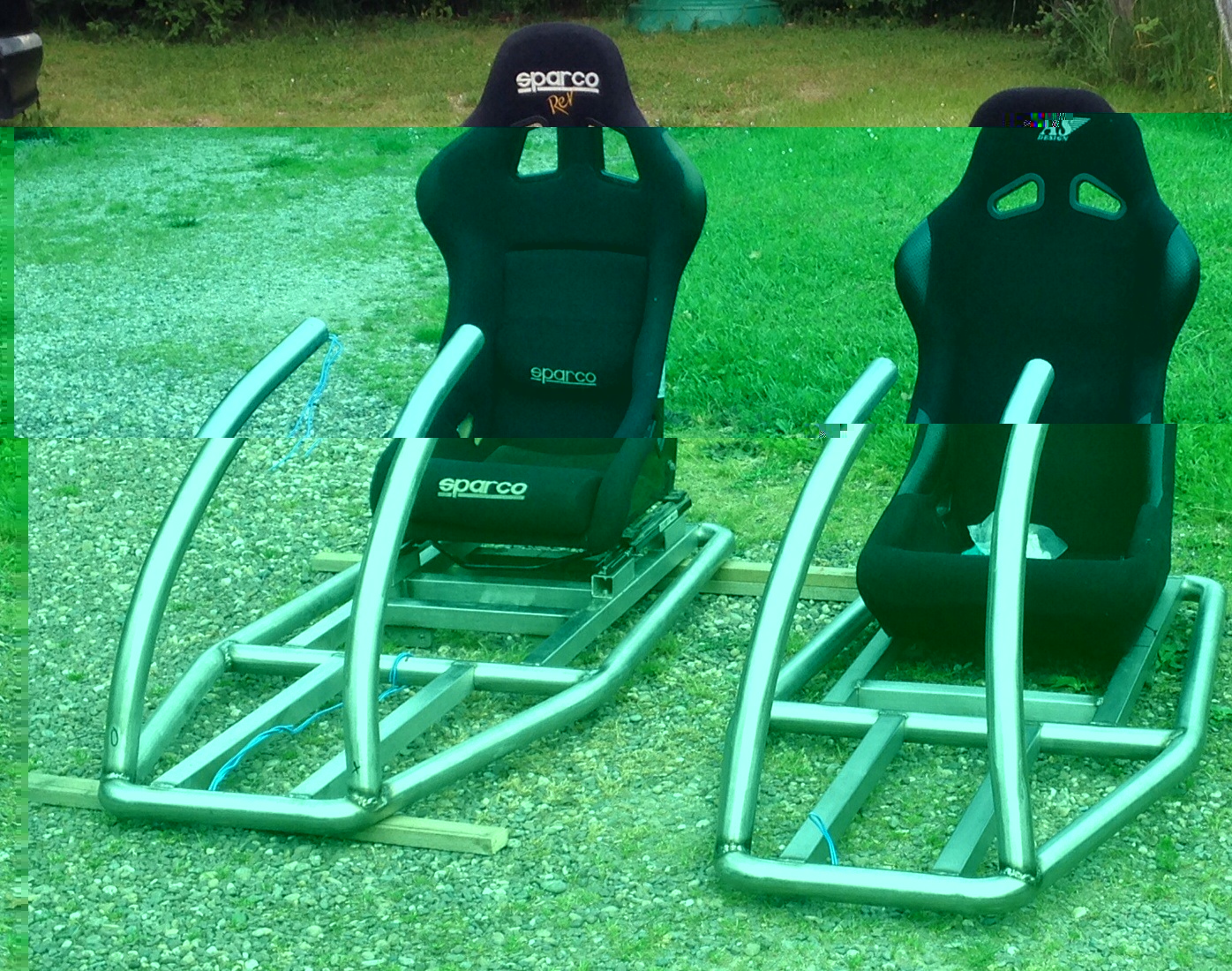

The upper platform is still in progress.As I'm building the simulator with a friend we have 2 plateform in progress.My friend 's building a 2dof.
