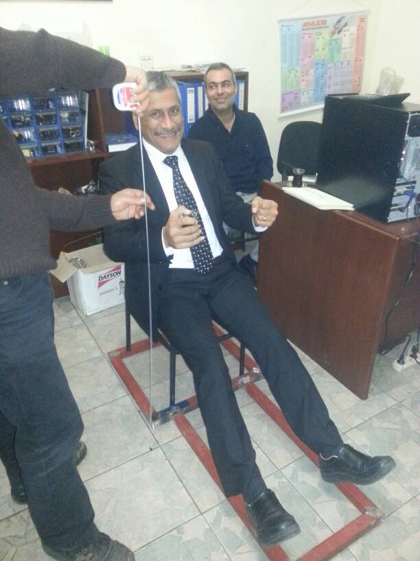

Postby nury961 » Mon 10. Dec 2012, 16:59
Sukruyetisen is one of my friends, who hasnt believe us :) After a while he seen our project progress and asking us to give money to be asponsor for simulator :)
When we are searching fantastic DIY projects, he alwanys says that "here is the money, go and buy it, I will give the money..." Because of that he is our sponsor :)
You can see him at the upper photo who weared business cloths on the chasis and imagine dricing car :):):)

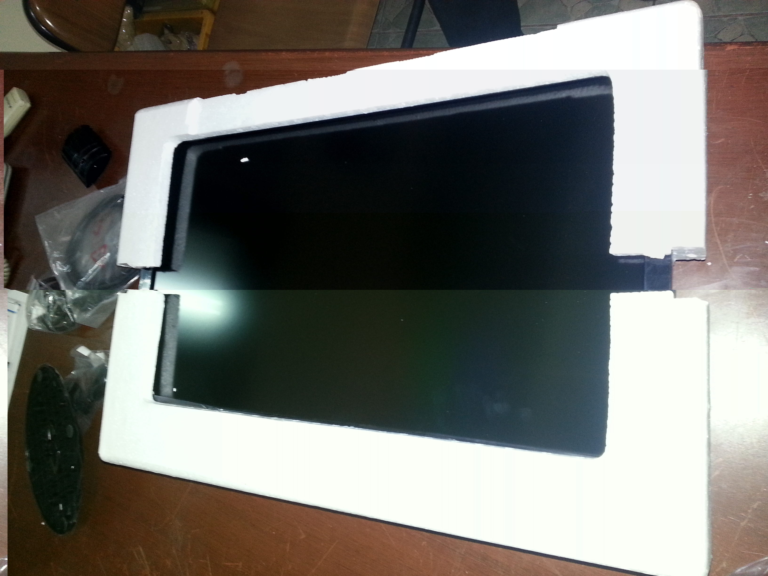

Today I got my new screen which is 23" 3D LED...

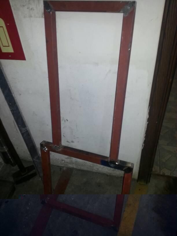

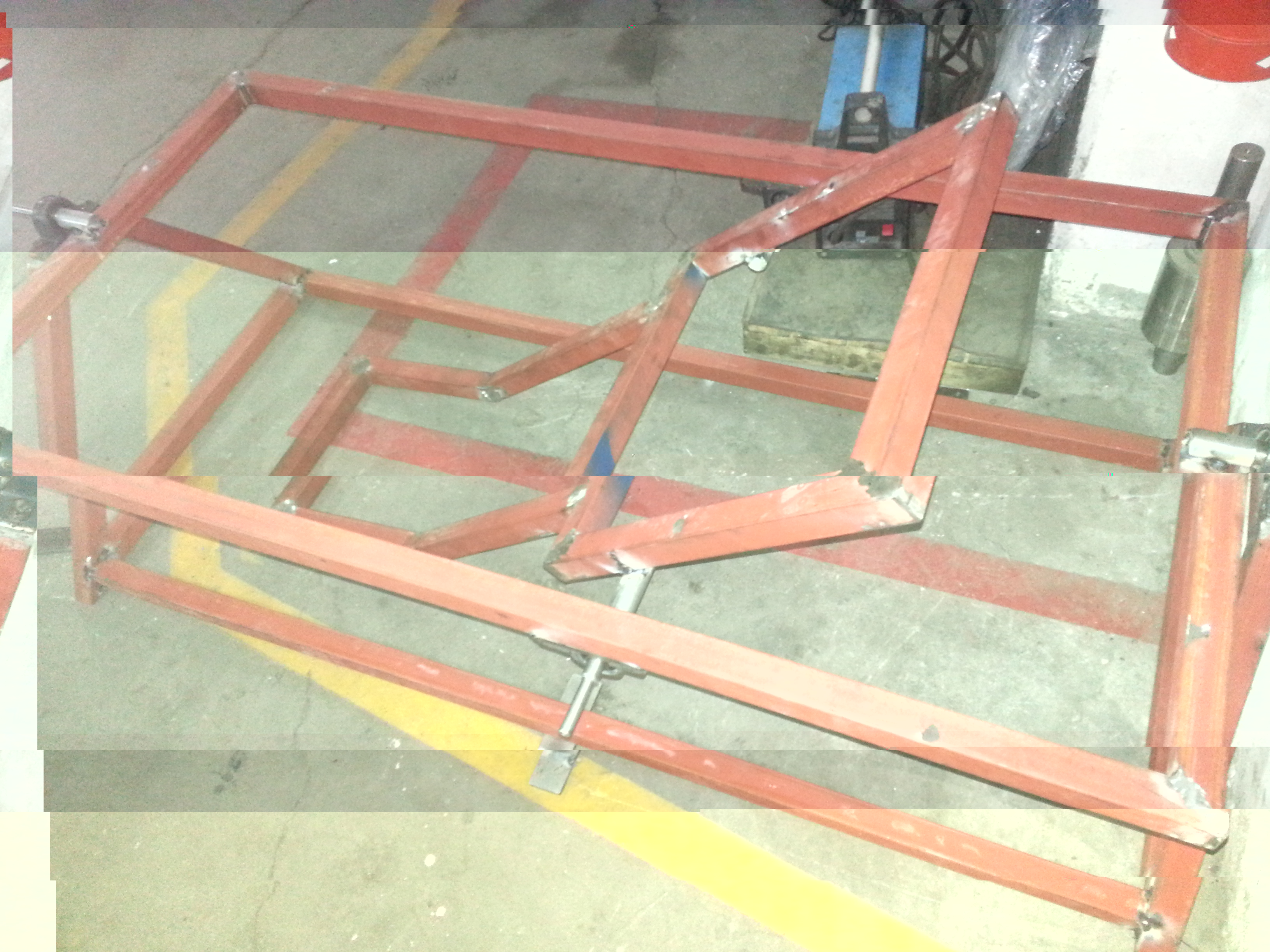

and also I have finished the welding parts of the hardware, firstly I will put the motors direct at the turning axes, if motors will not respond them will change it to the edges and will turn the chasis by belt or arm...

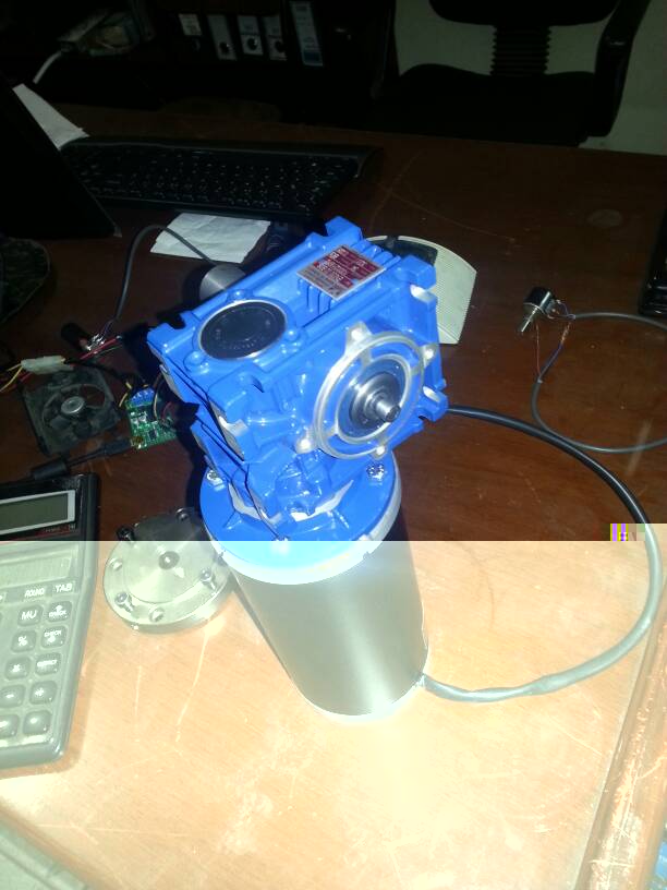

Postby nury961 » Sat 15. Dec 2012, 09:37
Hi everyone;

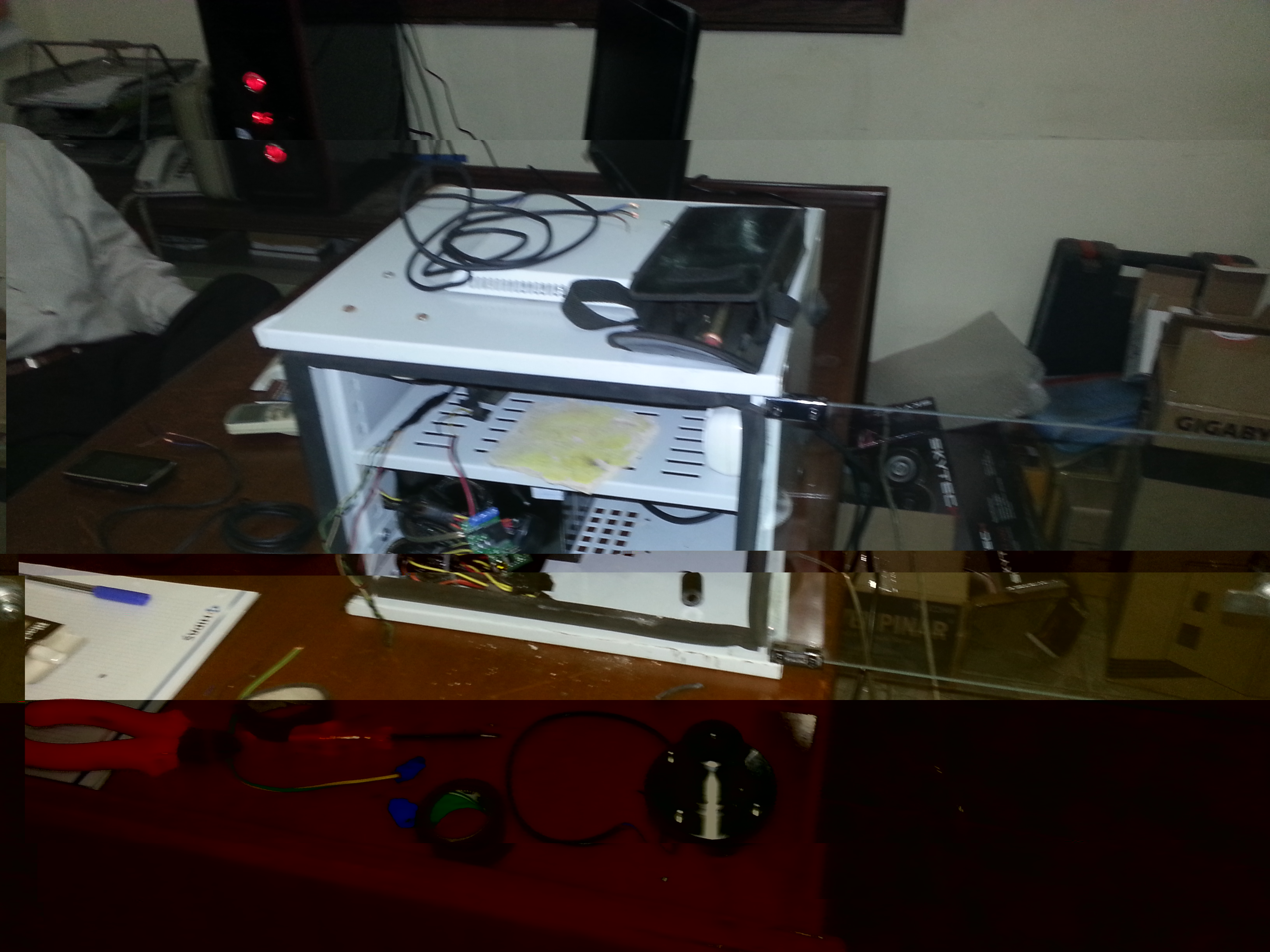

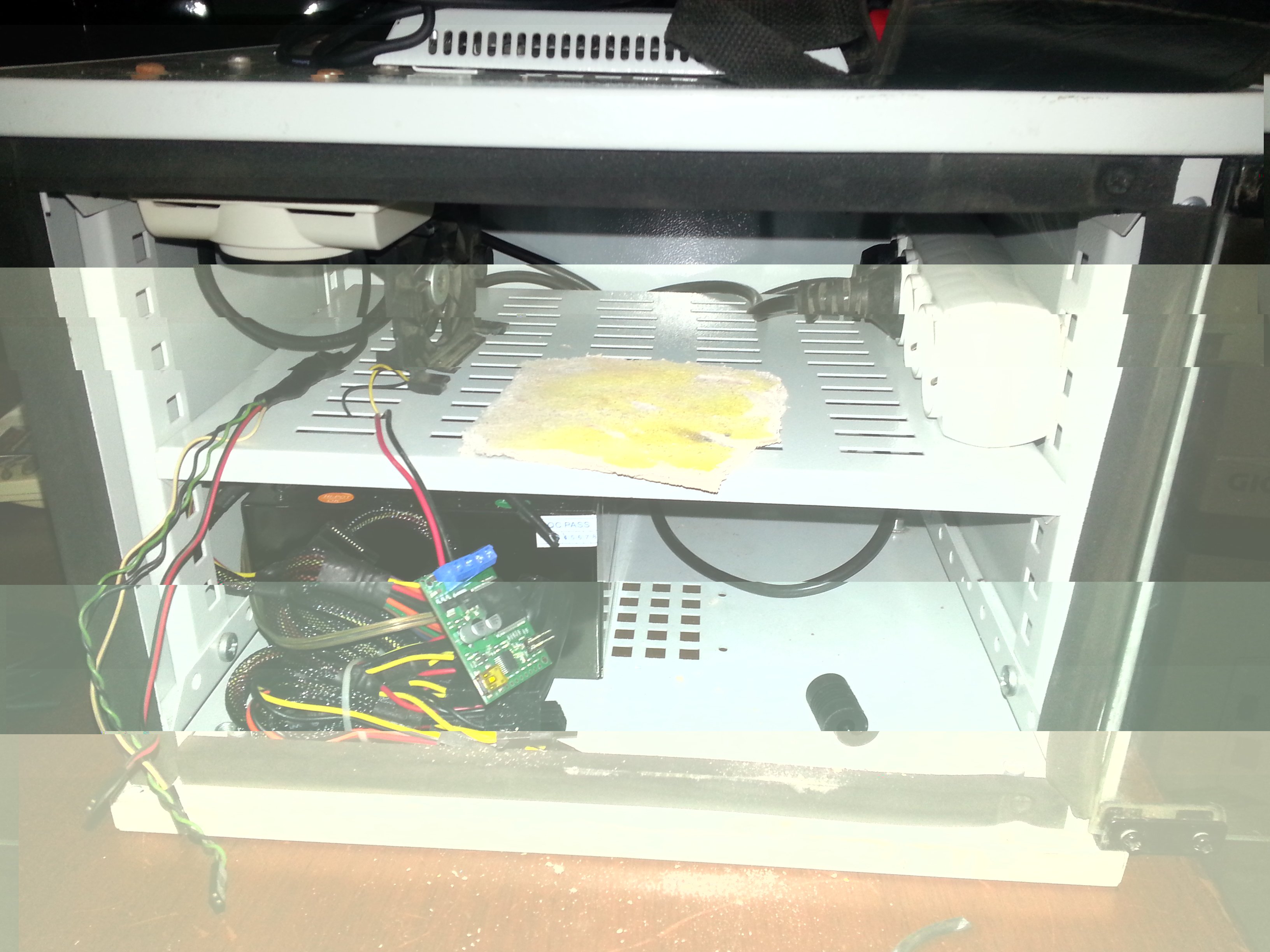

There has been one week that I couldn't do anythşng because of my job. Yesterday we start to do electronic compartment and feedback holder, here is some photos...
