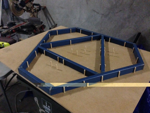

The machinist just sent me some photos of my stainless torque arms.
People might think it's a bit nerdy, but I think they look awesome. I can't wait to see them fully polished and on the gearboxes when they arrive.

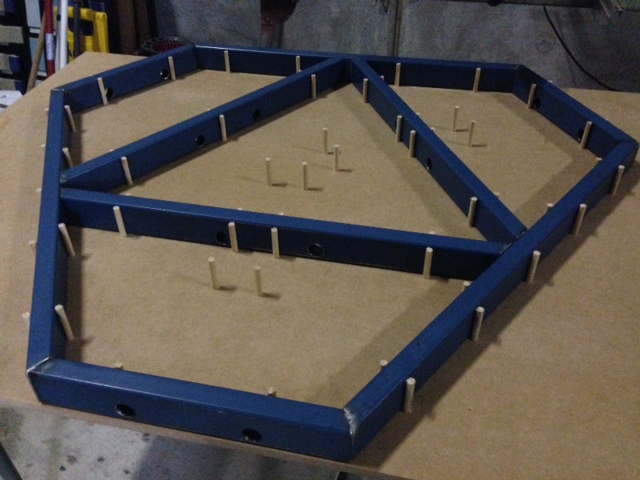

...and here's a quick pic of the frame pieces assembled in the jig. A few 20mm drill holes to go and I'm ready for welding tomorrow.

Postby DoctorD » Sun 21. Sep 2014, 14:21
Wow, I think I really underestimated how much effort it would take to get through all of those 20mm holes. It ended up being 24 holes in total. Each one 20mm diameter into 3mm of toughened steel. There goes Sunday :)
...but worth it
