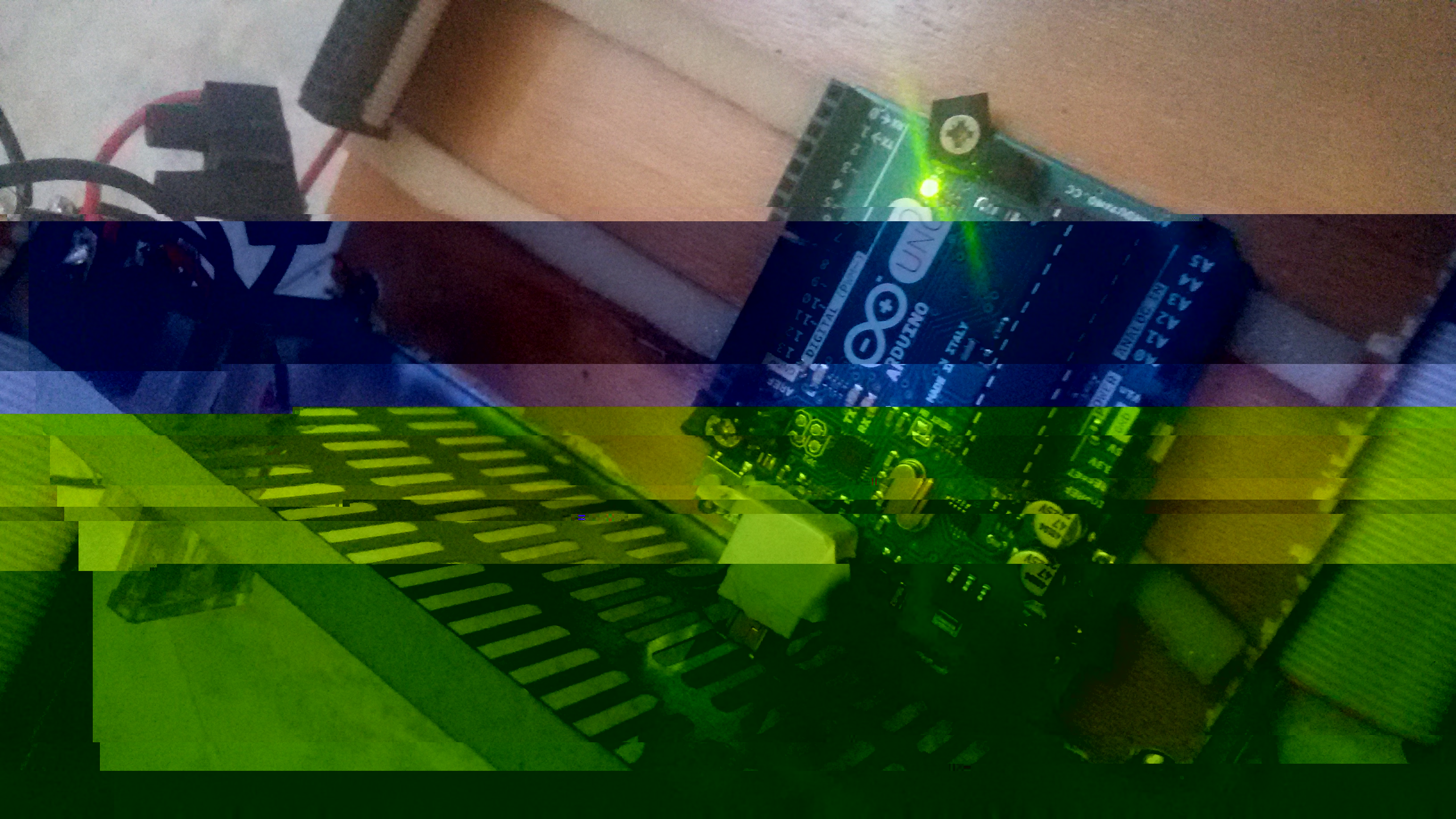

Postby mario9898 » Tue 9. Jun 2015, 21:16
this is the arduino and simply I stack the monstermoto on it
