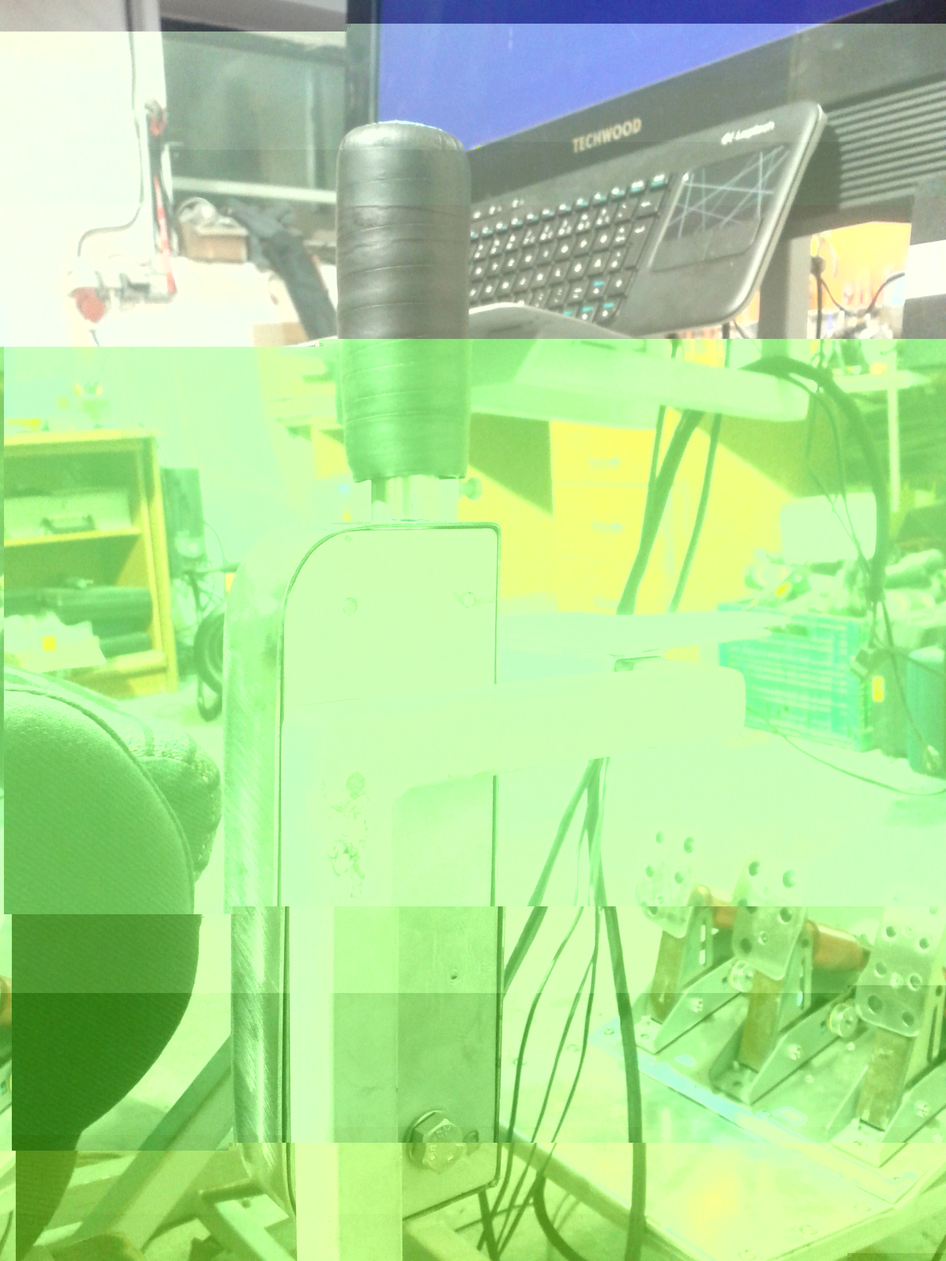

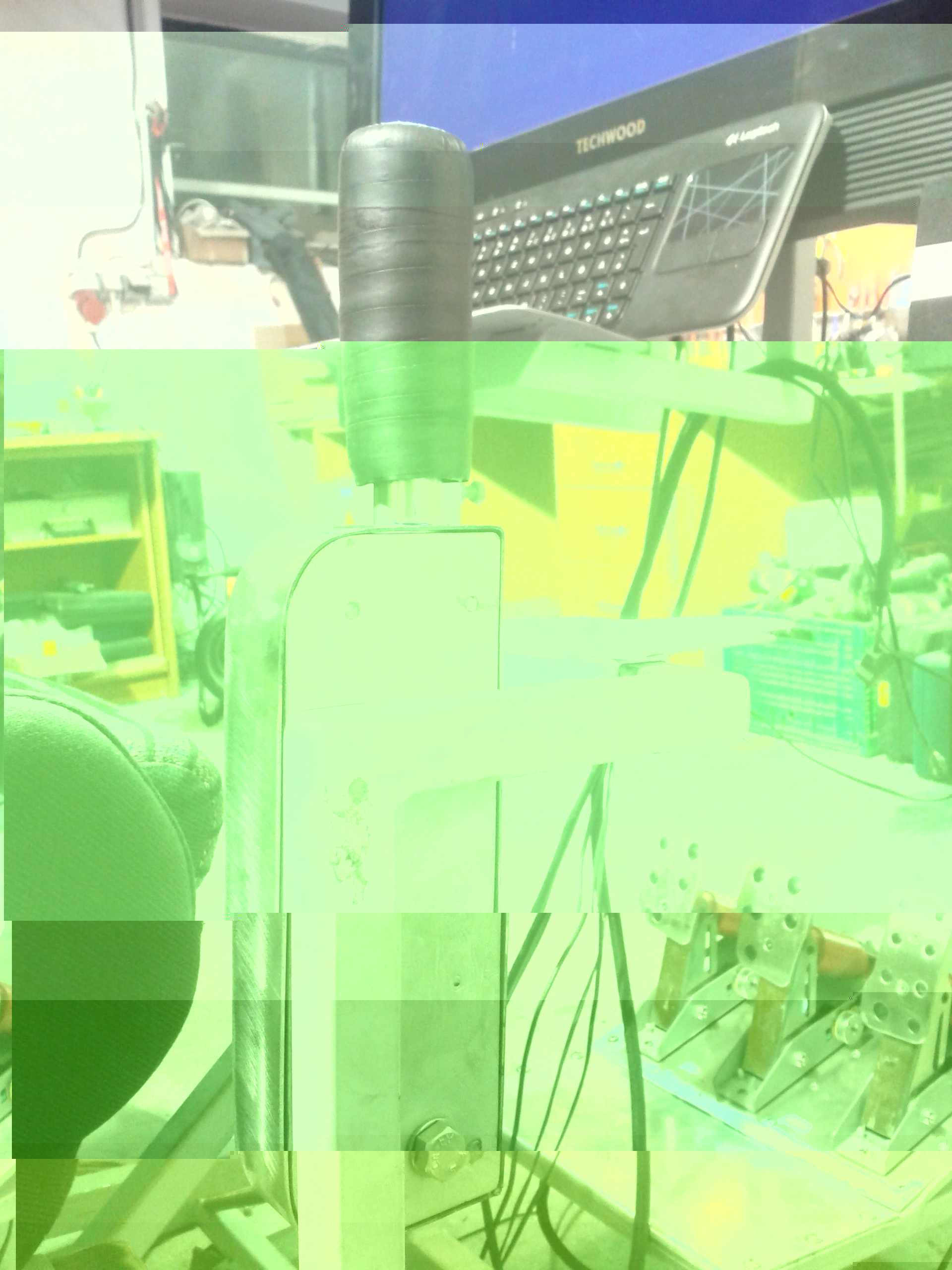

Postby mario318i » Sun 3. Feb 2013, 23:04
The handbreak was very easy to built and it makes a lot of fun! :lol: Also the integration in G25/G27 is very easy; two solderpoints and this is it.
Well, in Dirt3 i use only the sequential shifter. I´ve made a little bit of modifications to my shifter and also to the pedals to make it more realistic.
if so desired, I could make such a small tutorial
my bodyshakers are also integrated now! Hell yeah :twisted: thats so amazing. One under the seat and one under the pedals.
pic´s and videos coming soon!

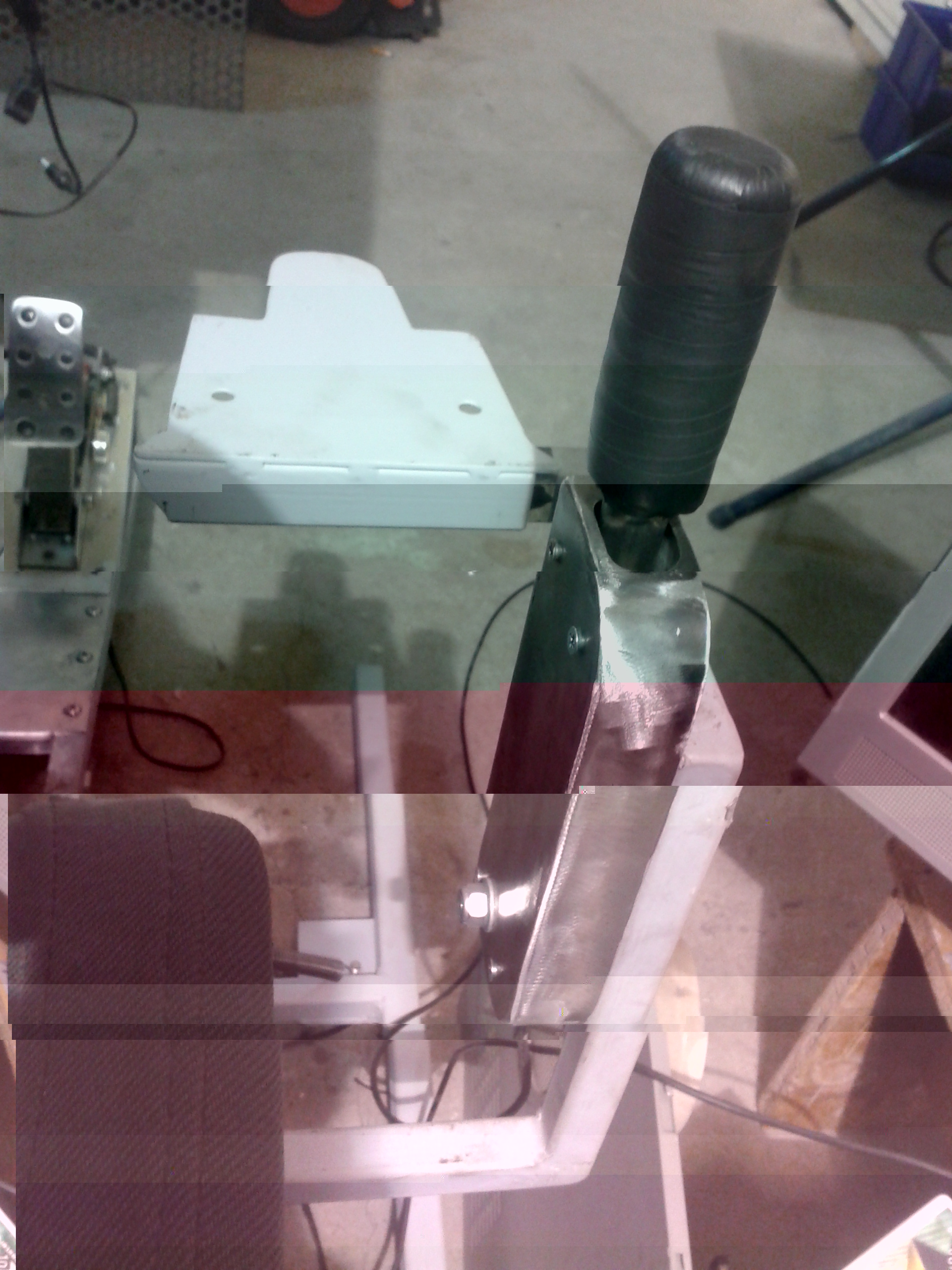

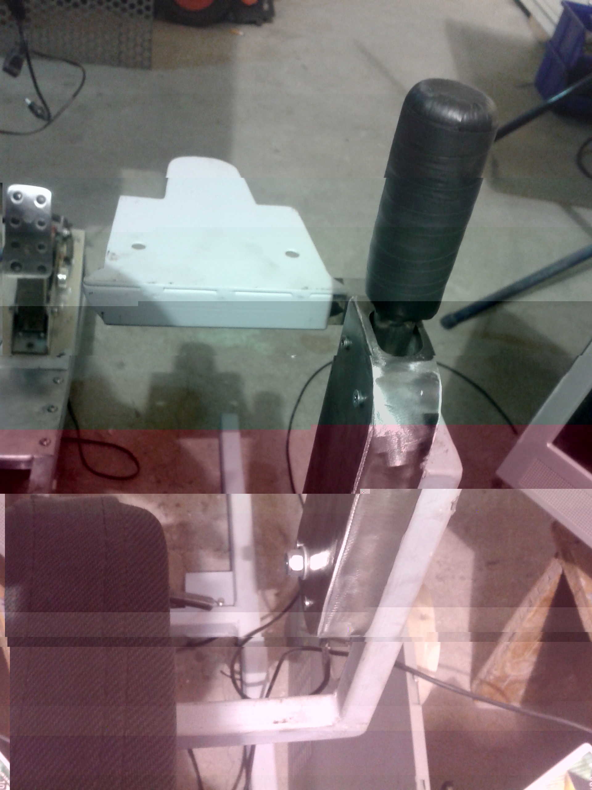

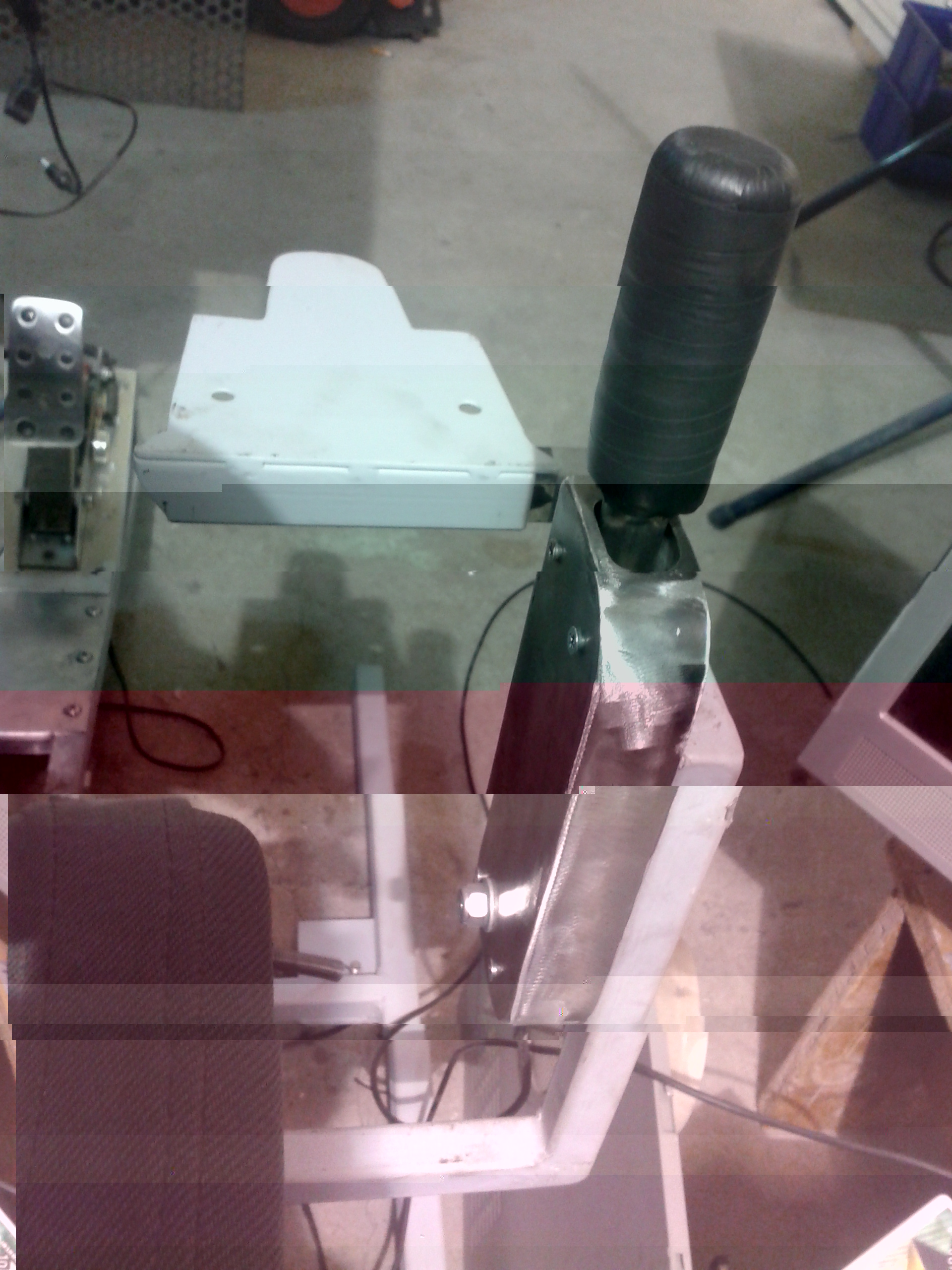

Postby mario318i » Wed 6. Feb 2013, 16:34
Hy!
I'm frustrated :?
Yesterday, my handbreak got his new case, so everything was fine! BUT then i was taking off the case for last adjustments......
i forgot to unplug the G25 and i came with the case on one wire of the e-brake ... the the sequence was a short circuit --> damn :o the g25 was going to sleep and dont want to come back.
